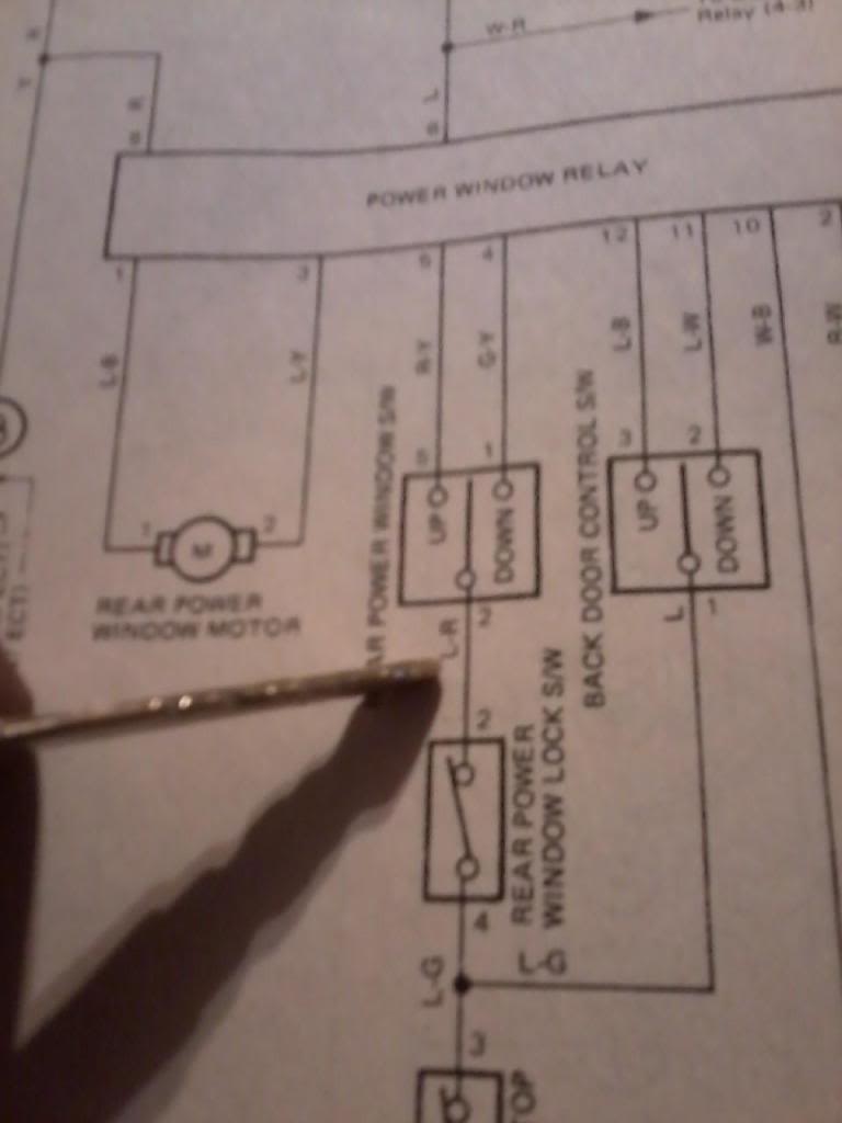

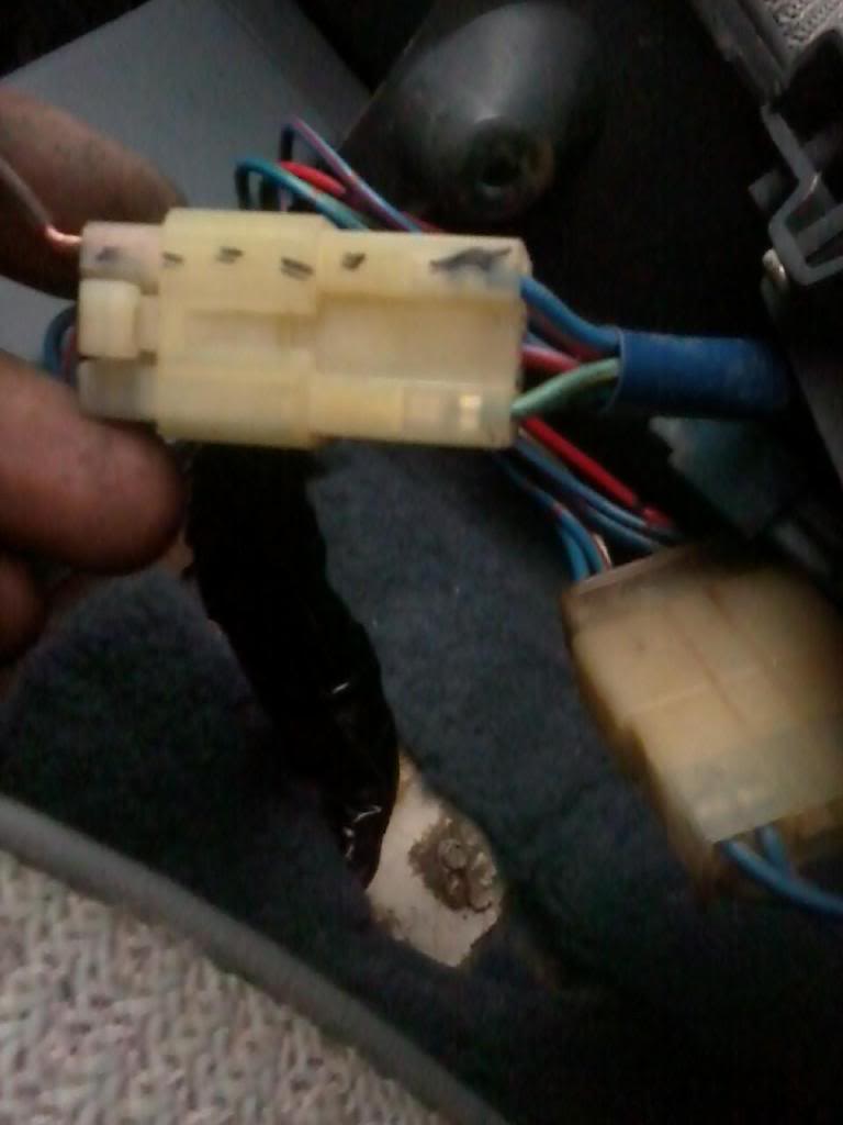

Ok guys, I need some help here. I have been trying to get the rear window switch working from the console since I have owned this thing with no luck.
I picked up the correct arm from Kornhuskerwizard over the weekend. So that end of its good.
I decided to pull off the cover for the rear wiper motor to look at the switch and it does not seem right. I am going to try and get a pic.
But I did not know if anyone would be able to get me a pic of the rear wiper arm sensor.
I cannot see how mine would work with the way it is setup. And I think that this might be my issue, since everything else has been checking out ok.
Thanks guys.

Here is a link to my fix and other info that may help >>> https://www.yotatech.com/forums/f199...l#post51723243 The post above it has some info as well. Is the switch clean? If so and you want to by pass all of the safety on it, I run a ground wire from the plug to a ground. Makes life so much easier. The post above the link I provided as other info as well.
I got my rear window working. Wahoo!!
Some quick and easy test are 1. Make sure your rear wiper is in the stowed position. 2.Back gate is shut good, may even want to lean against it and try your key. 3. The plug in the drivers side corner in the back is hooked up good, by your rear windshield washer bottle. 4. That the bolt/pin on drivers side,by the roll bar is all the way in. There is a safety lock located there.
I wanted to see if my Motor was good so I ran 2 connectors right to the motor plug. It is a PITA to get that plug seperated and ran each wire to a battery. Just reverse polarity to control the direction of the window.

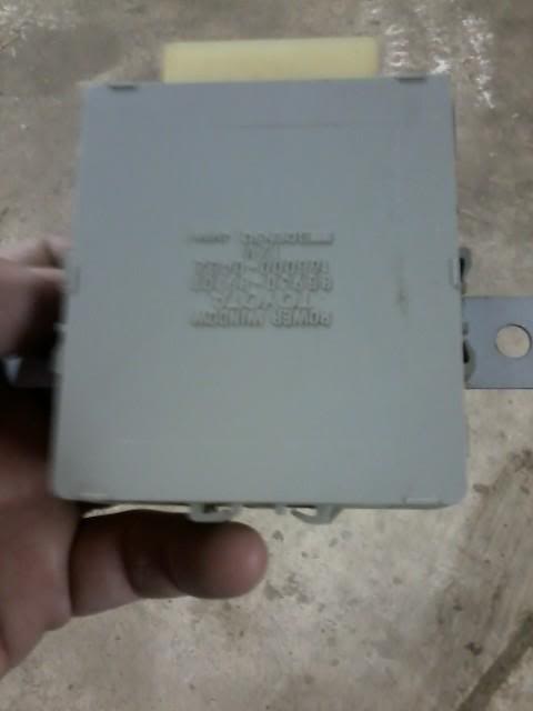

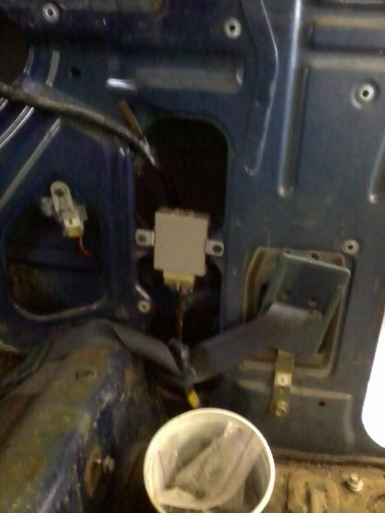

I then replaced the Window Relay Box, I got my Rear Wiper working and Defrost but no window control. Located behind the Drivers seat behind the vinyl panel. If your rear wiper and deforst work this is some indication the box is good, but a relay is in there that operates the window so you cant completely rule it out.

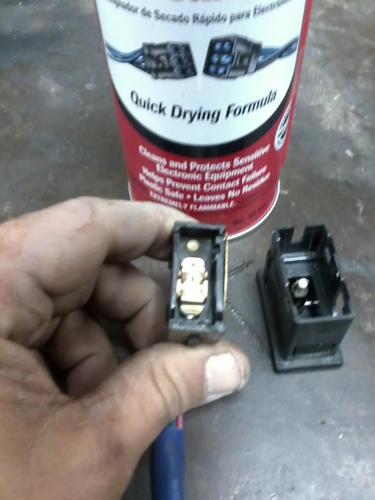

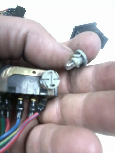

I then took the Switch apart. It comes apart easily if done right. First remove the gray plug. It is the light bulb. Then pull the cover away from 2 tabs on one side and then the 2 tabs on the other side.

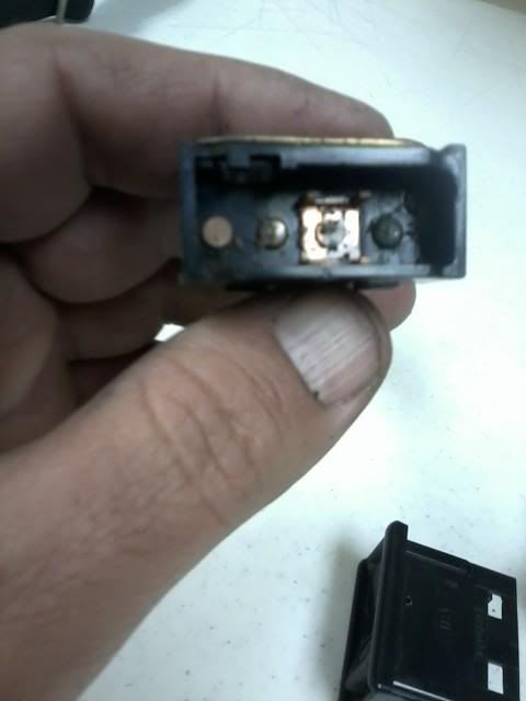

I then washed the button with soap and water and air dried it with air hose and used electrical contact cleaner to get the corrosion, coffe, dirt and who knows what else out of there.

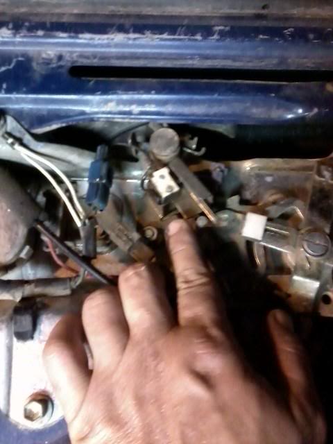

Here is another picture of how it should look before going back together. Make sure you dont lose the little white pin and the metal toggle piece. These are very brittle being 20 plus years old. On the rear wiper and safety lock, they are difficult to get seperated. I just take contact cleaner and hold the switch upside down and spray cleaner in there and blow it out with an air hose.

Located behind driviers seat.

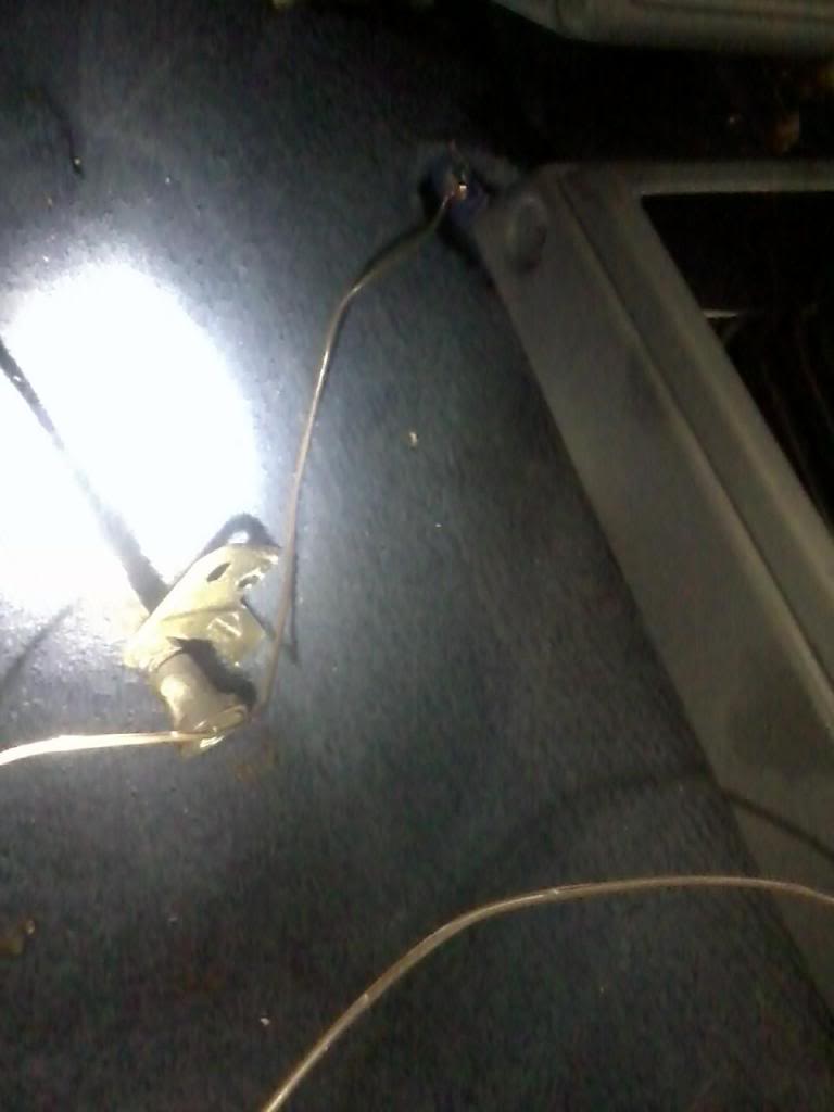

Running a ground wire from this wire on the plug, the blue wire to the place on the pic below elminates a lot of problems.
Ground to center consloe mounting tab.
The ground wire bypasses the following safety switches. Cover Top and Door Lock Detections switch. Your window will roll up with top off. This is on Page 12-23 of the Haynes Manual where the key is to the botom of the page.
Haynes "L" for Blue, "R" for Red. Key is pointing to wire.
