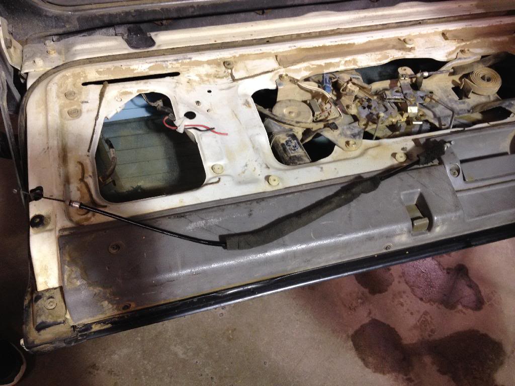

Did some more house keeping with the runner today while I had the time.
I was having some trouble with the cable that releases the latch on the drivers side of the tailgate. It was hung up and not letting the spring pull latch back into place allowing that side to lock.
Here's the culprit.
I ended up soaking the crap out of it with some wd40 and then silicone grease I had for brake calipers. Worked really well and now slides nicely in the housing.
I also decided to grease up the gears and basically everything that moved. Name:  42F70B7A-9E54-4FD4-8D9D-B86C8C819F51_zpsdlxu4vki.jpg
I took some pics of the switch in the rear wiper assembly but am going to have to clean it up and make the photo brighter before I post it.
Still looks like it's missing something.

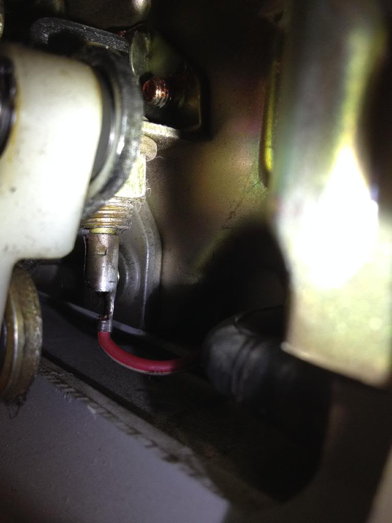

Here's the pic if the switch in the rear wiper motor. It doesn't look right to me like there's something missing. Sorry for te crappy pic. Name:  BEC1EA18-EB1C-4F99-ADFC-8F905E055D6E_zpscb3vbuvx.jpg

Sorry i havent gotten around to get that switch yet Mark but i havent forgot!! As long as your window stays up until it gets warmer!!

Most likely the rear defrost wire that connects to the grid in the window is rusted away or broken off. It wouldn't keep your window from operating. Neither of my defrost work because the cable is just gone and what is left is broken.
Can you hear your relay behind the drivers seat click when operating the switch? I think either your relay or the switch is bad. First I would try and take your switch apart and give it a good cleaning.
You will need to take the light bulb out of the switch first to get it apart. Then carefully separate the covers. The little piece of metal that toggles and contact the switch probably has that green corrosion on it as well as the little post the toggle contacts. These switches get dirty.
After cleaning your switch, see if you can hear the relay working. If not, I would bet you have a bad relay. I have found a link to rebuild the relay but I have never tried building it myself with parts from Radio Shack.
