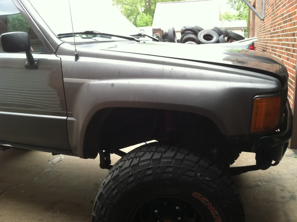

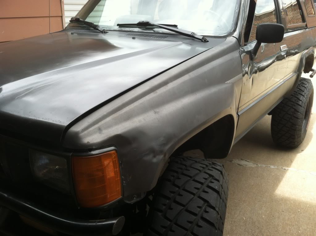

Well I decided to Part out the 88 ex cab. So I figured that my runner needed some fenders. Plus one of my biggest issues was that since the fenders were cut, there was no way to attach factory inner fenderwells without modification. I didnt want to make something that was welded/fixed into place. And without them in there, everything was hammering the cab.
So here we are with New to me fenders and inner fenders.
Drivers side had a dent that I hit out with a mallet. I might do body work to it later on. Maybe.

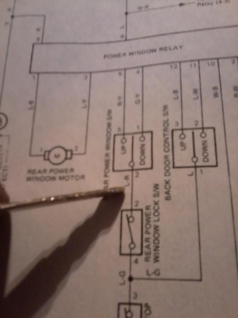

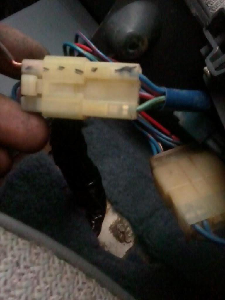

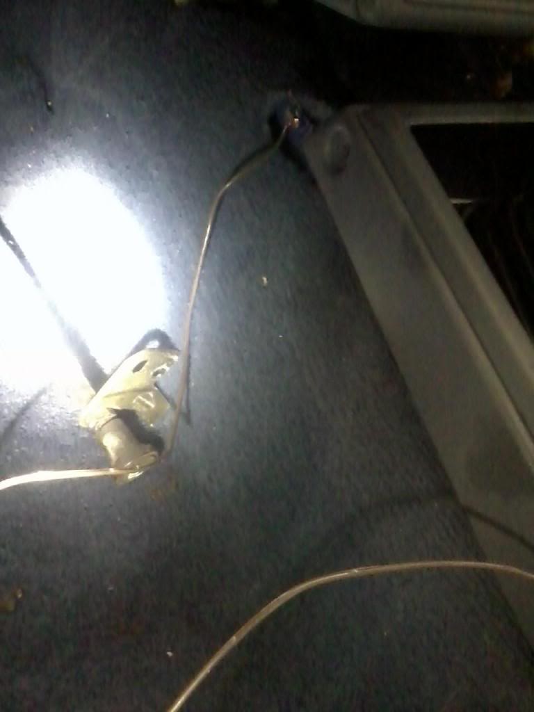

I was reading that it looked liked you were having problems on the tailgate with all of the safety on it. Here is what I found and works great for me. From the Key to the Ground, it bypasses all of those safetys.
Running a ground wire from this wire on the plug, the blue wire to the place on the pic below elminates a lot of problems.
Ground to center consloe mounting tab.
The ground wire bypasses the following safety switches. Cover Top and Door Lock Detections switch. Your window will roll up with top off. This is on Page 12-23 of the Haynes Manual where the key is to the botom of the page.
Haynes "L" for Blue, "R" for Red. Key is pointing to wire.
