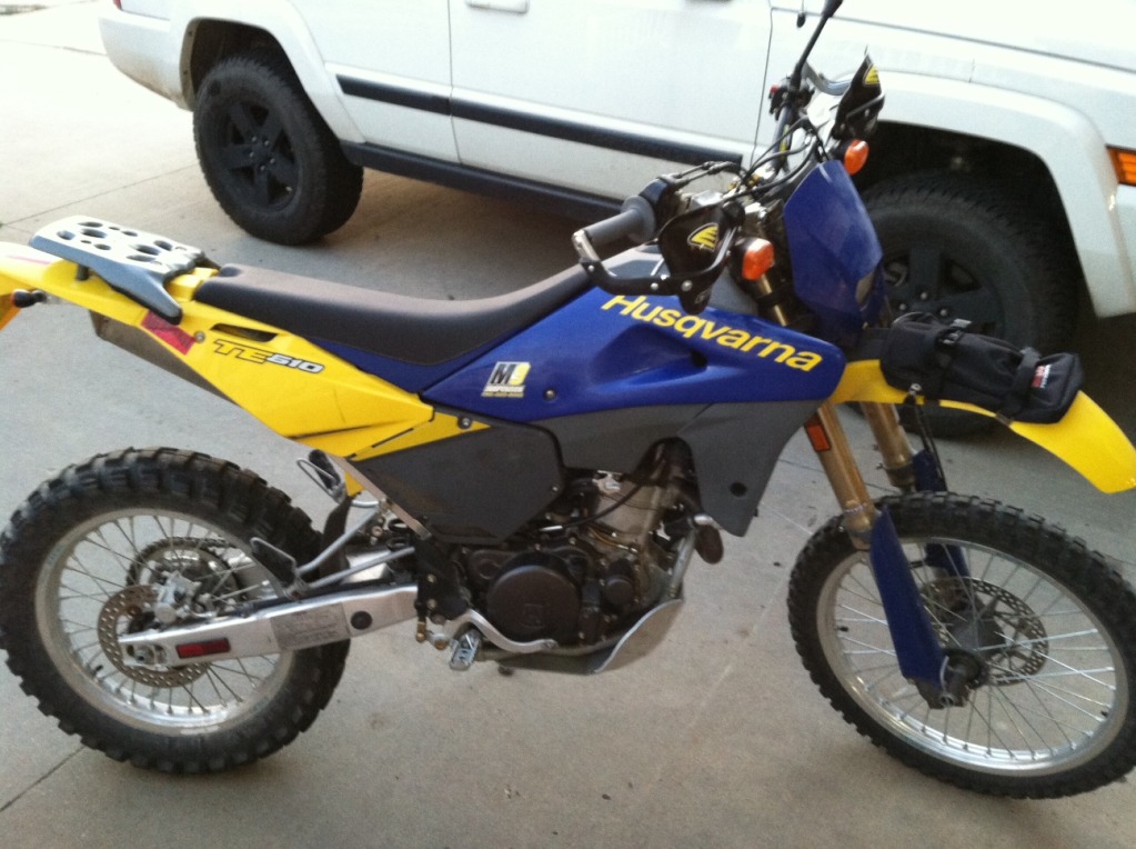

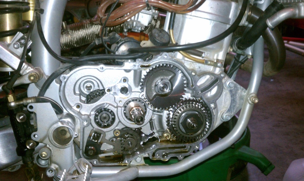

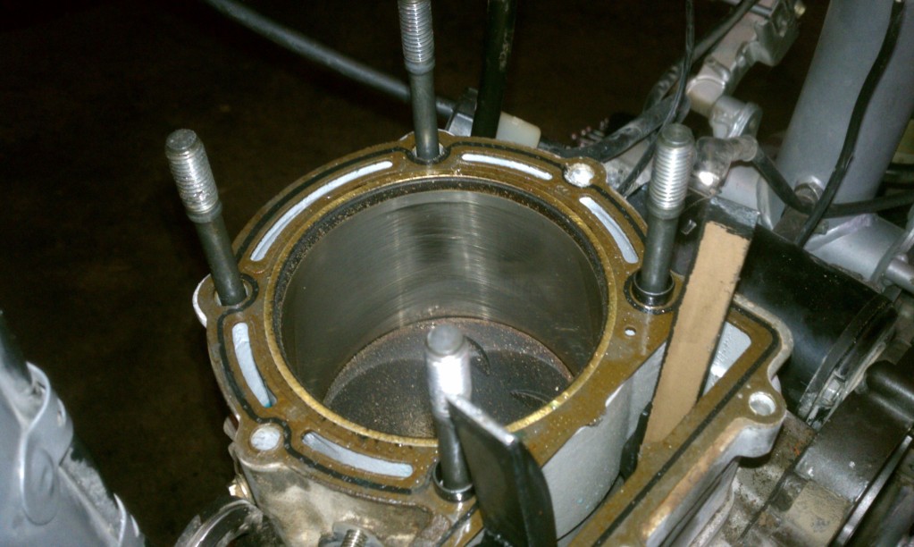

Let me Start from the Beginning. I Had a 2006 Husqvarna 610 that I built and was getting bored of. Really wanted another Yota, but wasnt going to settle for getting rid of the Bike for just anything.
Pic of the Bike

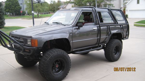

Pic from the Guys Craigslist ad

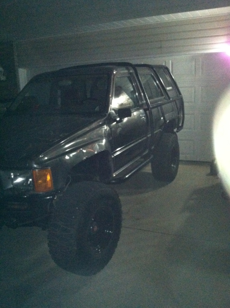

First Night at its new home

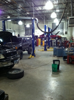

Plus I teach Automotive and have access to a full shop, So bring on the Work!!

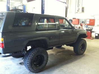

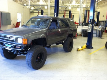

Pic at work Before I started to dig into her.

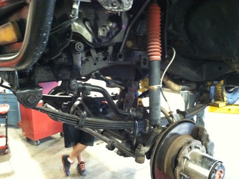

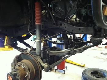

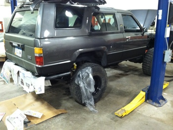

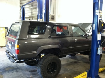

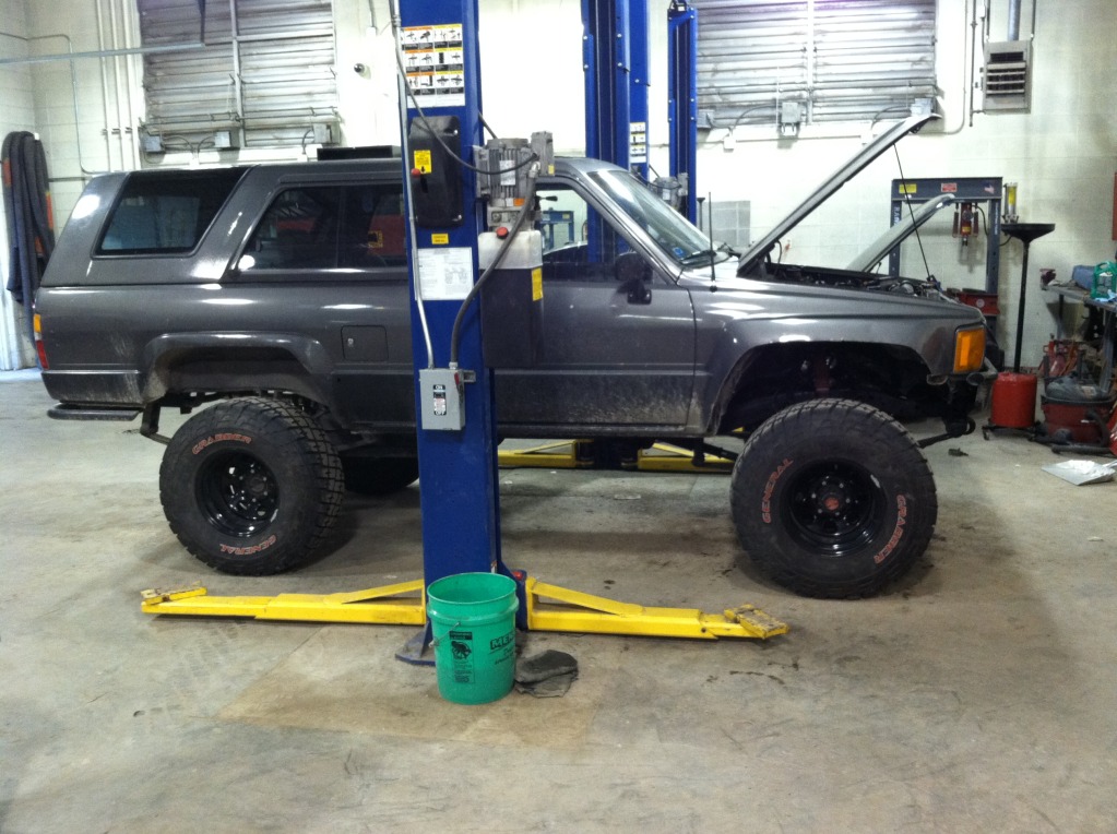

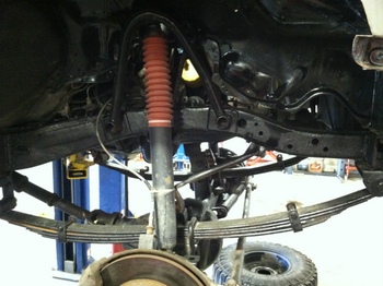

Got her up in the air to check things out.

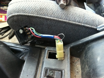

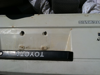

Upon Realizing that the Regulator and motor worked but had a rotted track, I figured a trip to the Local U-pull- it in Omaha was in order.
Scored a perfect working tailgate and glass while I was there for 50$

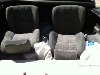

Decided to snag some new to me front seats out of a 2nd gen runner while I was there.
Fast Forward a few months and I finally got the seats in, New tailgate and window in and working, and worked a few bugs out with the Engine.

Super High Tech Window Fix

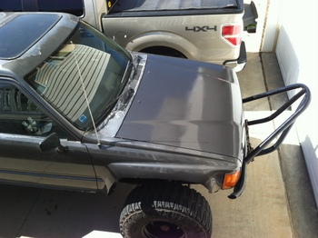

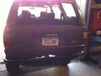

Decided that my feelings for the Cage and enormous Stinger were not going to change so......
Off they went
I think it looks way better without it.

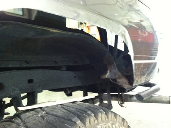

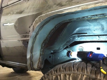

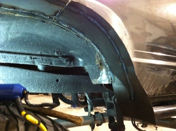

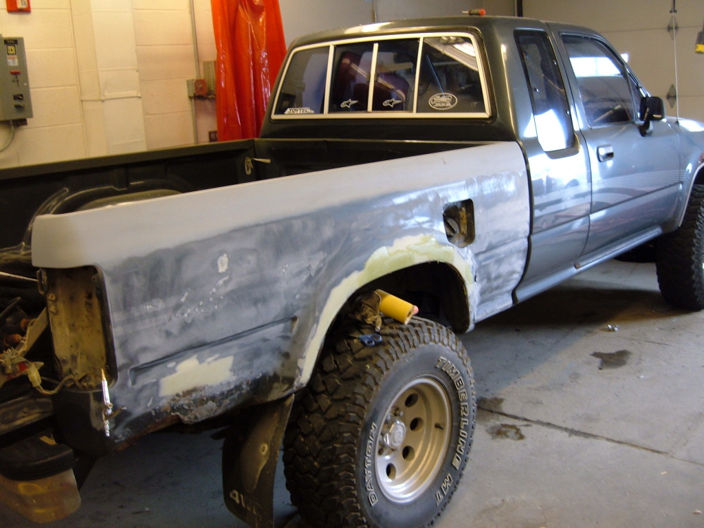

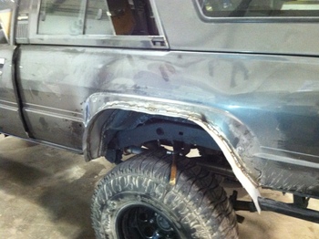

A few weeks later, it started to get cold, and I could no longer take the the exhaust and dust coming in from where the PO left the fenders cut and not tubbed.
So I started to Tackle the job myself.
Now keep in mind, I teach Auto Mechanics not body work. I can do body work but I am by no means an expert. (far from it) My biggest thing is keeping the weather out of the inside and exhaust out also.
Point of no return
Making a template
Welded
I do not recommend doing it this way. It created a very sharp Hard edge on the outside of the fender. And the Toyota panels are sooooooo thin that upon sanding/grinding, I blew through the metal. Plus this method required alot more body filler.
Please again, understand that I was not worried about looks as much as sealing everything up.
I wish I would have taken more Pictures, But snow and cold weather was coming soon, So I was in a hurry.
I did two different methods to each side of the Back. I wish I would have done both sides like I did the Passenger side.
On the passenger side, I used the advice of Wabbit and folded over the Body Panel and welded on the inside of the Tub. This Method is far superior and alot easier to do than how I did the drivers side.

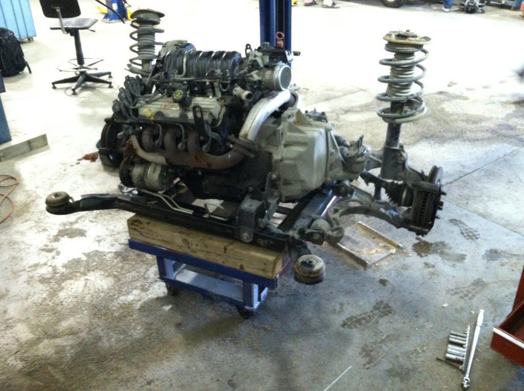

Few engine swaps.

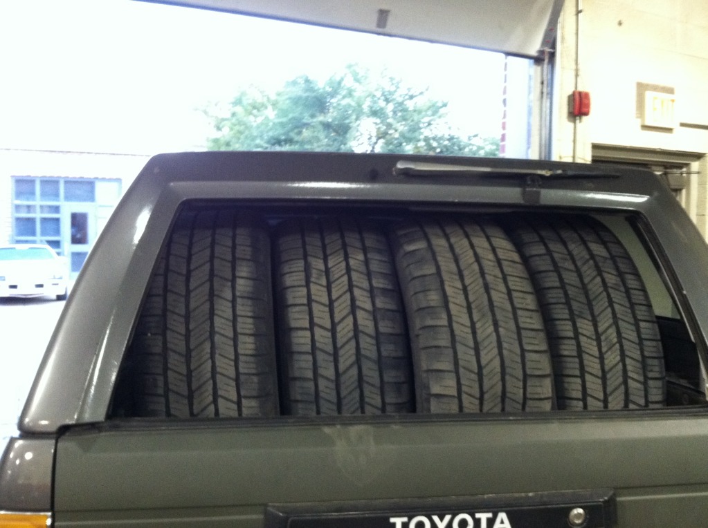

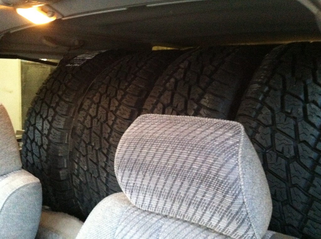

My need and desire for another yota pickup was dwindling. As I quickly realized this thing hauls alot!!
8 tires in back. 4 on rims and 4 without.

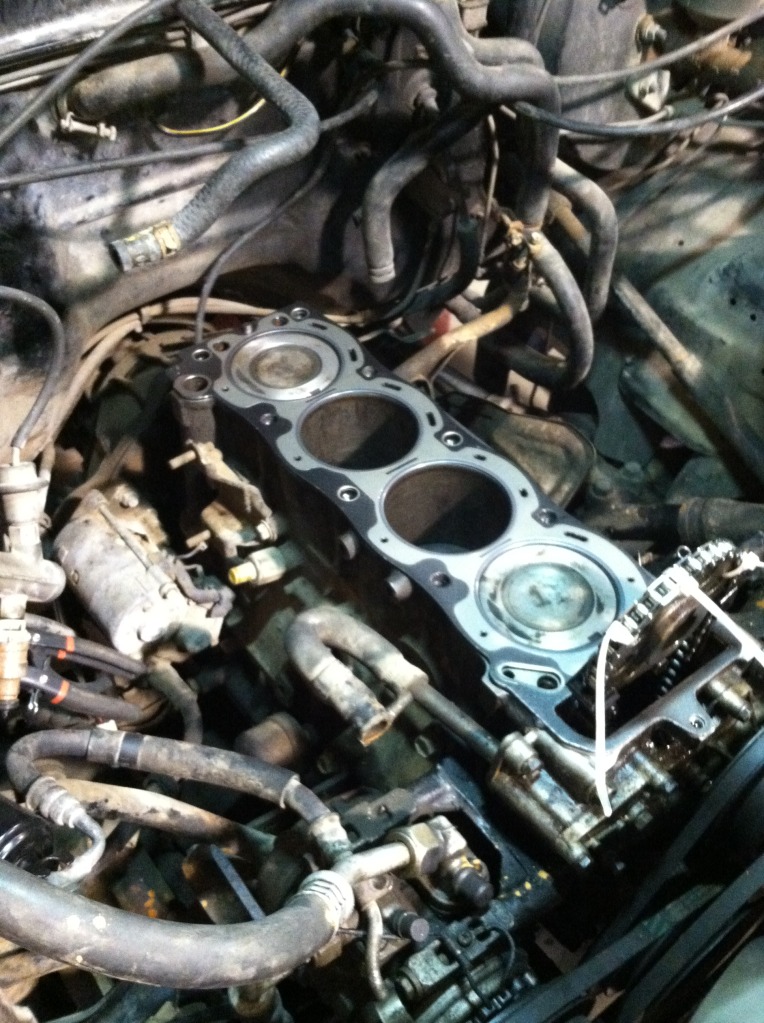

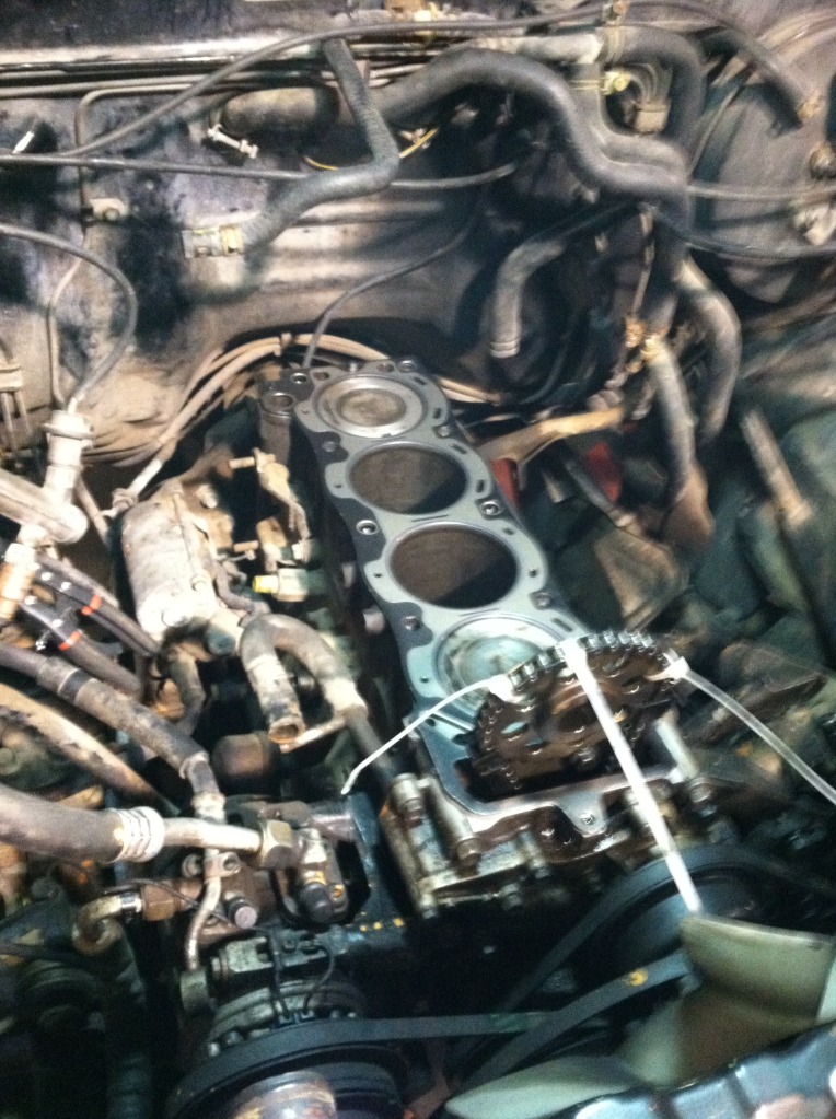

Had the students do a HG job to one of their 4 runners.

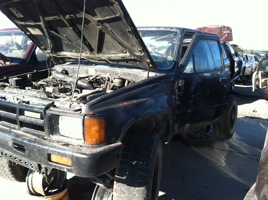

Back to the U-Pull-It

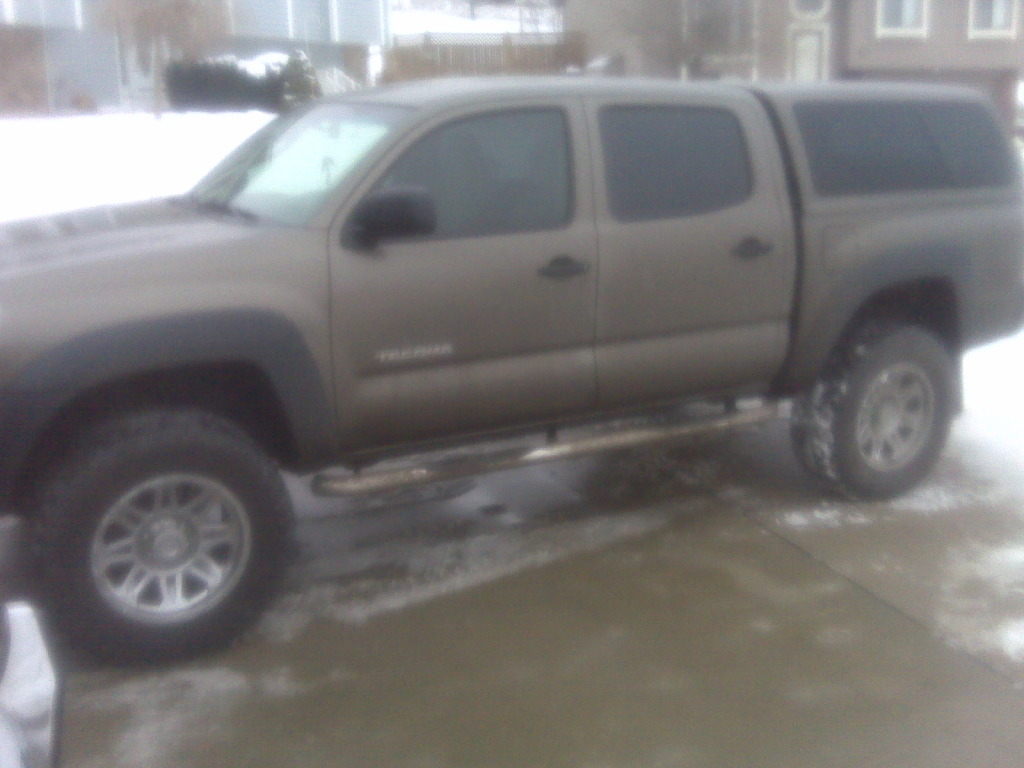

Lifted a Tacoma along the Way. This is 283yotacrawler's truck

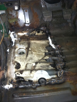

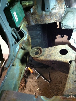

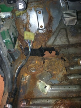

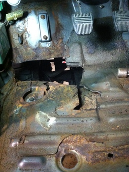

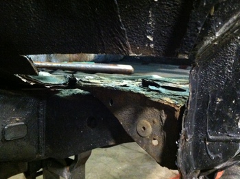

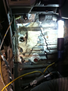

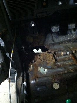

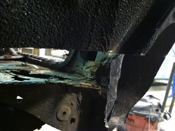

Found some floor rot on the drivers side floor pan.

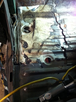

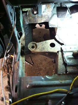

Started to Cut it out.

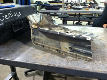

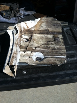

Went to the Yard and Cut out a section from another 4Runner. It sucked to do this to another runner but I needed it. And the one I robbed it from is probably turned into soup cans by now.
So I showed the kids how to use a spot weld cutter and I separated the inner and outer rocker. Because my outer rocker was good.
wish I had more Pics, But again, was in a hurry and tried to get done as fast as I could.
In and fitted
Welded and sealed

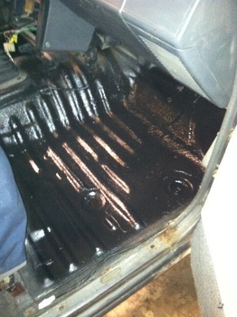

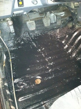

Raptor Lined
That stuff was really easy to use. I sprayed it all in with a U-pol Shutz gun.

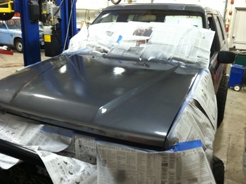

Forgot to mention that I painted the hood awhile back.

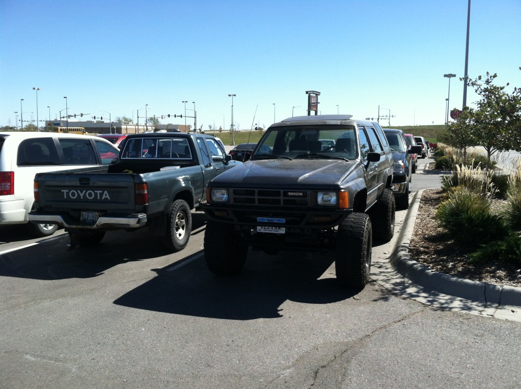

Man that stinger was HUGE!!
Had to park next to fellow Yota guy. Wife didnt like that we were on the other side of the parking lot from where we needed to be. Haha

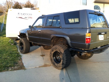

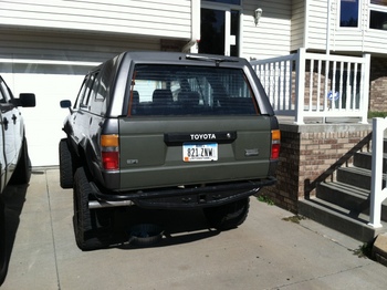

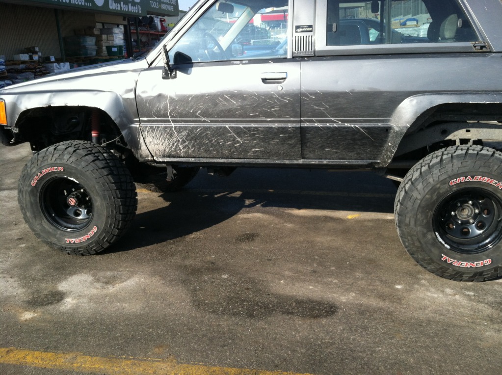

Fast Forward to present day.

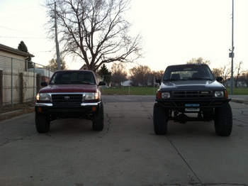

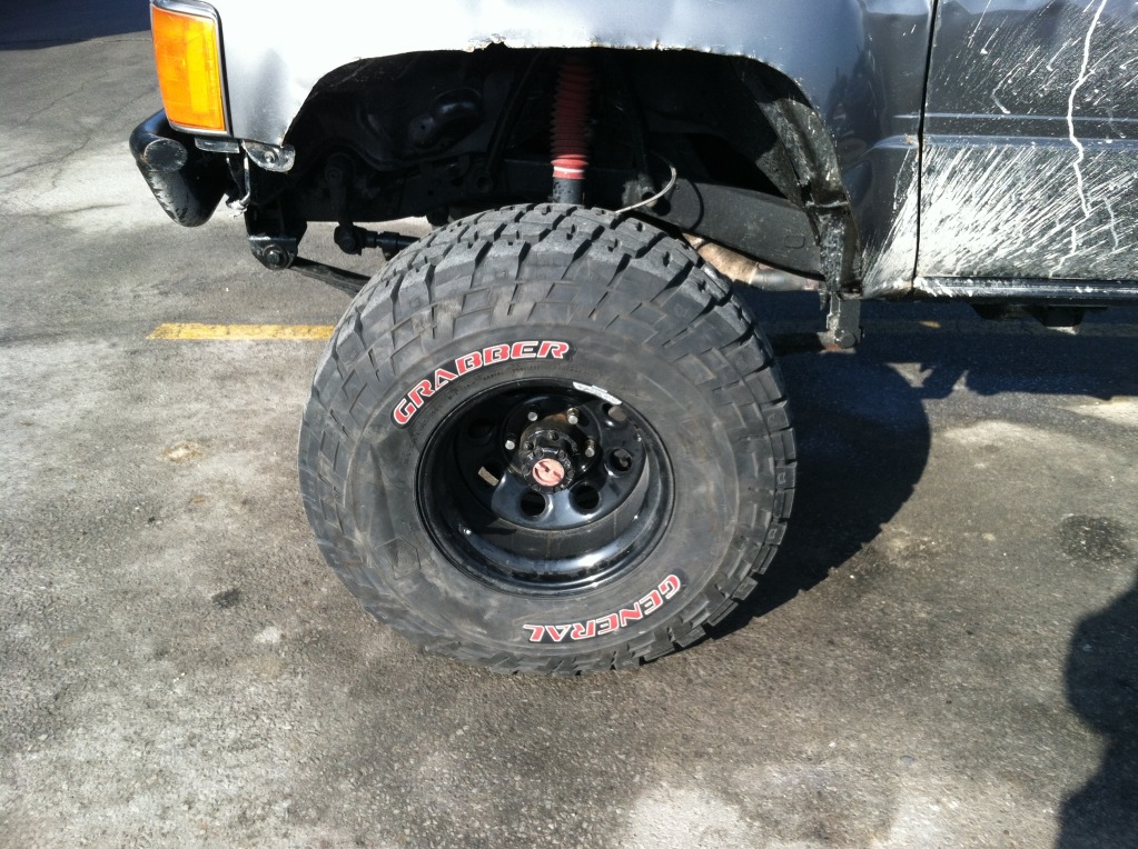

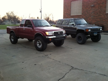

283yotacrawler and I decided to swap tires. He does alot more driving than I do and the Trxus sts's are better on the road and in the weather than his grabbers were. So we swapped them out last week.
Here is the outcome.

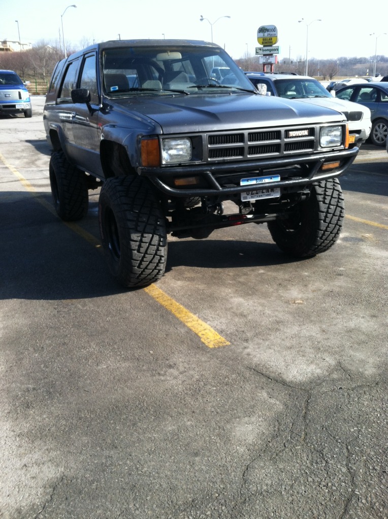

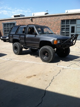

And a few glamor cell phone shots from over the weekend.

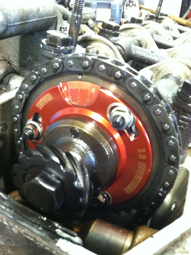

timing kit (sitting on shelf in garage)

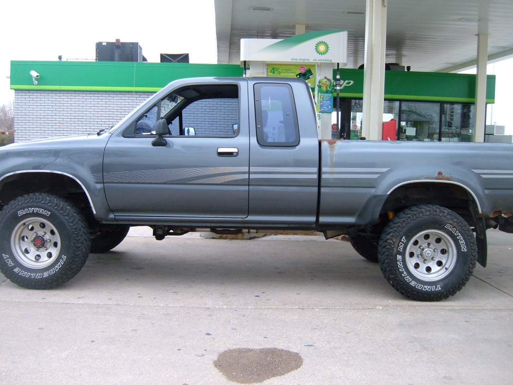

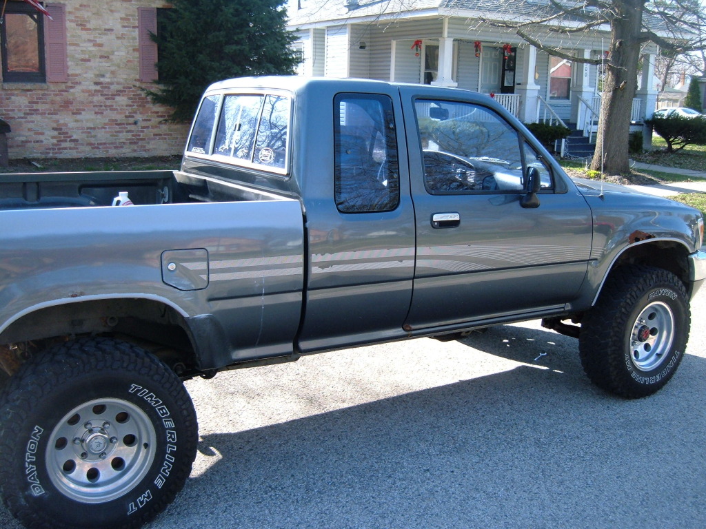

I found a few pics of my old ex-cab while digging through everything for this thread.
Man I miss it.
Day I brought it home. With a saggy rear end
It was soo clean inside and pretty clean outside minus some rust that I fixed.

A pic of my old Tacoma. Crappy Cell Pic

Old Feb 19, 2013 | 03:51 AM
kornhuskerwizard's Avatar
Joined: Dec 2008
Posts: 2,391
From: tecumseh nebraska
Nice pics. Definetely like it minus the exo and stinger. Also am jealous of the liftgate you found at u pull it. white, plus has the automatic decal on it. Good score on the adj timing gear. Love those general grabbers too. Keep up the good work!!

Thanks for the compliments Chris. I have another tailgate that needs some work if you want it. I'll just give it to you. Still has the regulator in it , but one of the tracks that holds the window is in bad shape. And there is some rot on the bottom that can be fixed. But the outside shell is perfect.

haha. much appreciated on the rear gate but mines in great shape, i just noticed on the one in the pic it looks like it has a factory "automatic" decal on it and id never seen one before. Good job on the floor panel swap too. I would like to do that to my rear qaurters.
Old Feb 24, 2013 | 05:29 PM
Gizler00's Avatar
Joined: Aug 2007
Posts: 3,276
From: Pennsylvania
Thanks for the Compliments Chris. I was a little concerned with how the Floor repair would go, but im pretty happy with how it turned out. I'm still chasing down a leak in the Passenger Side floor. I think that its coming in on the seam between the cab and fender support. But will find out for sure when I tear into it tomorrow.

Nice score on the LCE head! Always great when that happens. And definitely no cage/stinger.
Look forward to your progress!

As far as tubbing the rear goes, I used some metal I had around the shop. Cut out the remaining rear inner fender and pieced up the new stuff. It was a wide open hole before. It used to be a dust storm inside when going down gravel at 40mph. haha
Thanks man. I really do like the look of it now without the cage. I wouldnt mind another stinger. It would just have to be a little more tasteful.(smaller)

You did get a LCE head with that engine?? Or the adjustable cam gear?? Either way good score. Need another red letter hanging off the back with swing gate bumper. Awwwwwww YEA!
