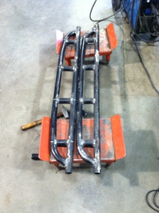

Well, I finally got a new tank of welding gas today so I could continue working on the sliders. They coming together pretty good for what Im working with.
Heres a quick pic right after I got the supports welded in, and cut the ends so I can cap them.

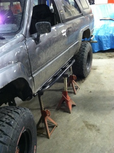

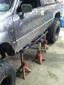

So now I need to figure out my support legs that weld to the frame. So I decided to get a few floor jacks and prop it up to where I think I might like it.
What do you guys think about the mounting. Straight out or tilting up at an angle? Im leaning more towards having them angle up but far enough away that they are not riding on the rocker panel.
Will post more the further along I get.

Angled up slightly but still have some distance from the rocker
Thats what im thinking. I just needed to hear it from another person. Thanks chris.
