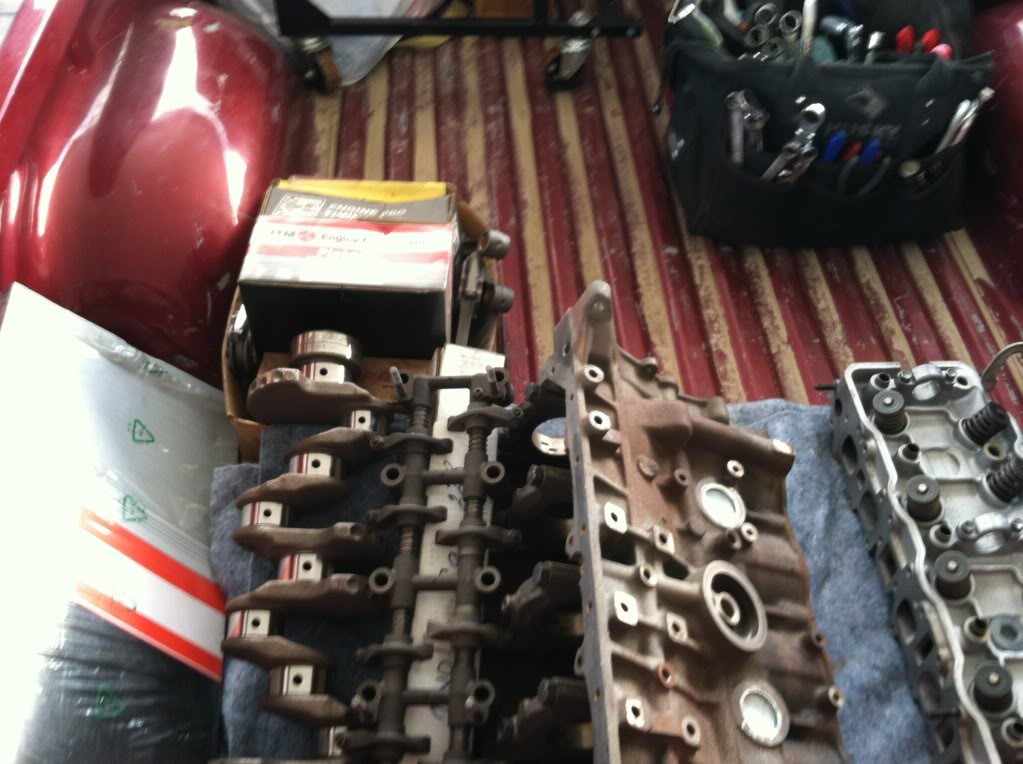

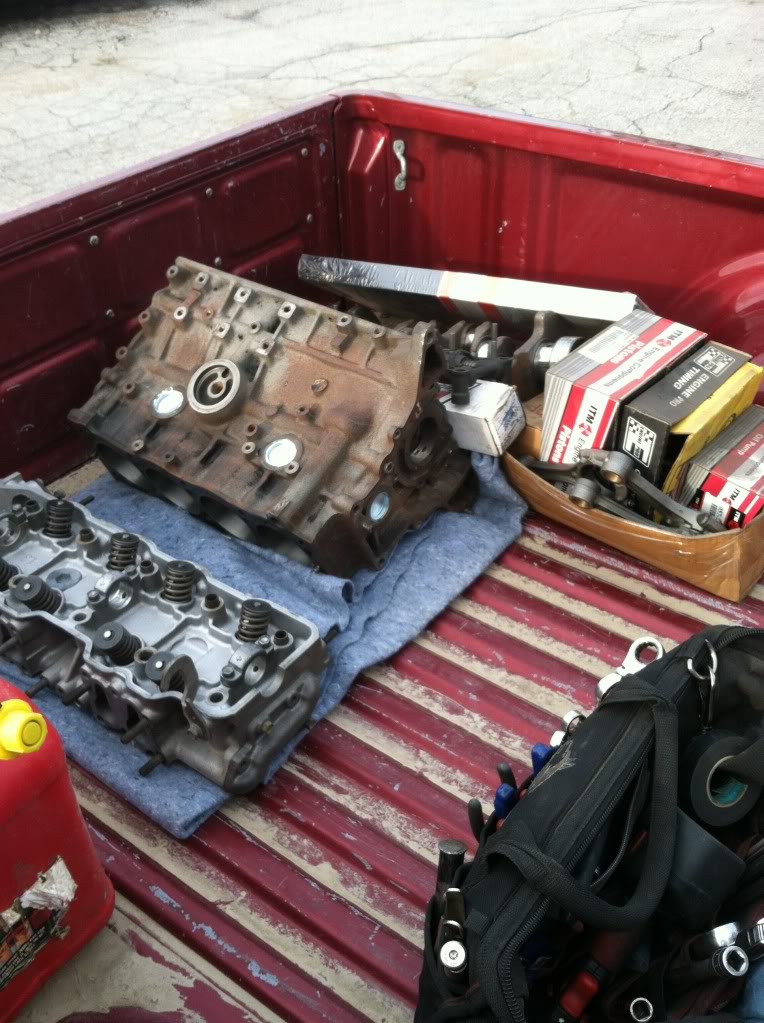

Well I finally picked up the engine (full rebuild) for my runner yesterday. Not sure on the exact year of the block but It's a laser block so its 85+. It was a 22r but I will be converting it to a 22re with all my fuel injection. I got a pretty good deal on it all. .040 over block, new pistons, rings, rod and main bearings, oil pump, itm timing kit, cam(which I'm going to sell and get an engnbldr), new head bolts, full gasket set all for 500$.
Here's a few pics

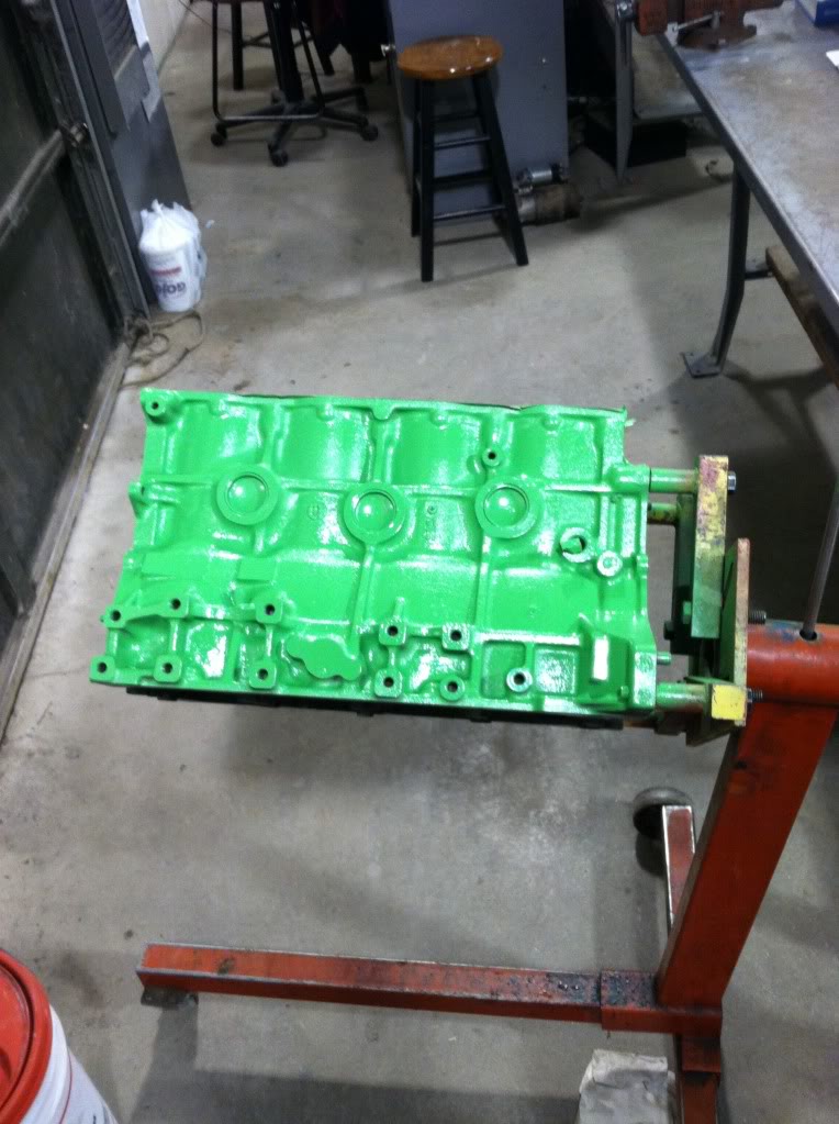

Started painting the block shorty after.

Make sure on your new block that there is a small allen plug in the oil gallery by the main caps. If thats overlooked and not installed, youll have no oil pressure...Ive done it
Not that you wouldnt catch that yourself but just tryin to help.
Thats a hell of a deal for all of what you received for $500 i think.Good job!
As for the tranny, ive ran them with alotta noise and only had one that finally wouldnt go into 5th.

Thanks for the advice Chris. I would have probably over like that Allen head. Glad you got to take a look at it and show me.

Just got through reading your build thread, nice work on your 4runner, I like the color choice for your block, looks good! I bet your getting anxious to get the motor assembled and your runner back on the road! Look forward to seeing some more pics...

Thanks for the compliments. Im really trying to make it my own. I was a little unsure on the block color, but the more I look at it the more it grows on me. I wanted something lighter so leaks and what not show up a little easier.

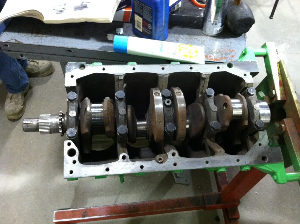

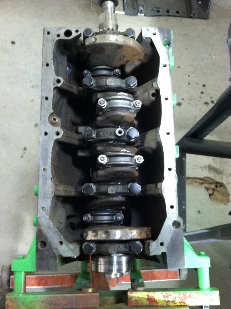

Thanks Terry! I appreciate the encouragement. I have been getting a little bit of work done on the engine as of Friday.
I test fitted the Crank and checked oil clearances.
All is good and torqued! Rotates Like butter. Me likey

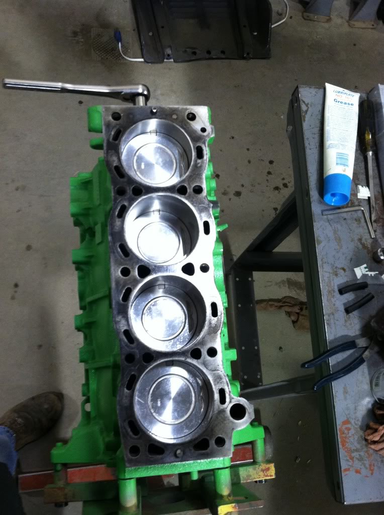

Well Actually had some time today to get the pistons on. Took me a lieelt bit to remember the orientation for where to stagger the gaps but eventually got it squared away.
Here is a shot from the Crank side. With pistons installed

Coming together nicely man. Really diggin' that color. You're gonna be able to tell if u have leaks easy with that color.
