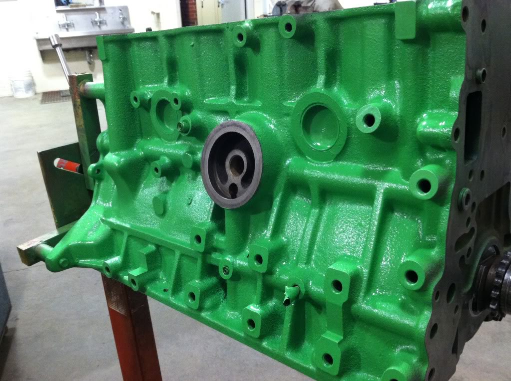

Originally Posted by Redeth005
Coming together nicely man. Really diggin' that color. You're gonna be able to tell if u have leaks easy with that color.

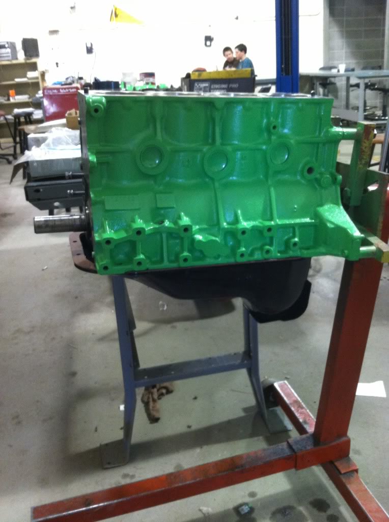

Thanks for the compliments. I wasnt really too keen on the color at first but I wanted something that would show leaks easy. I used to always paint my blocks black and always had a heck of a time trying to find exactly where a leak was coming from. Im hoping to get the timing kit, pickup tube, and pan on tomorrow. Then order a head gasket from Toyota then pull my runner in the shop to start the transplant.

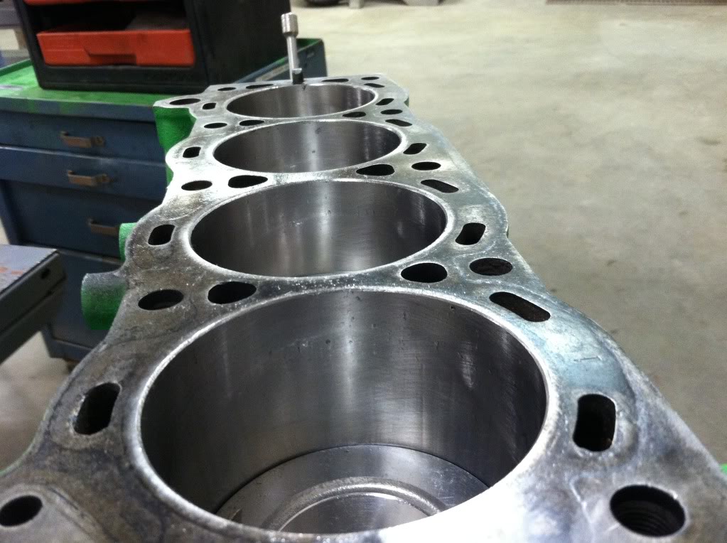

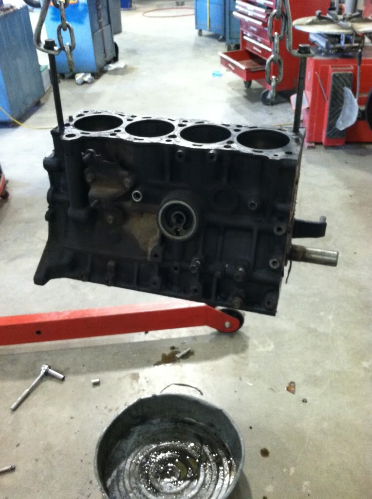

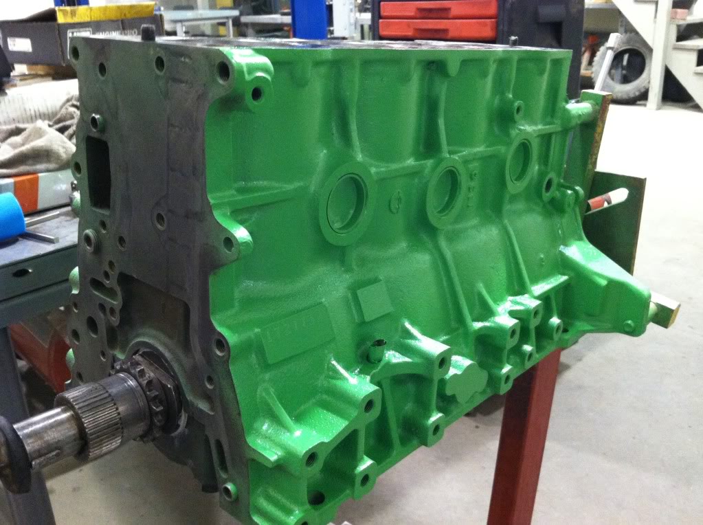

Here's a few more pics from this afternoon.

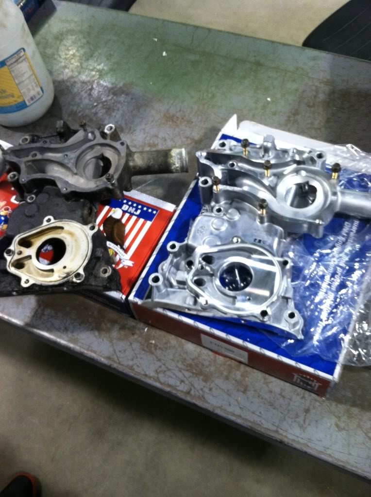

Snapped a few more pics

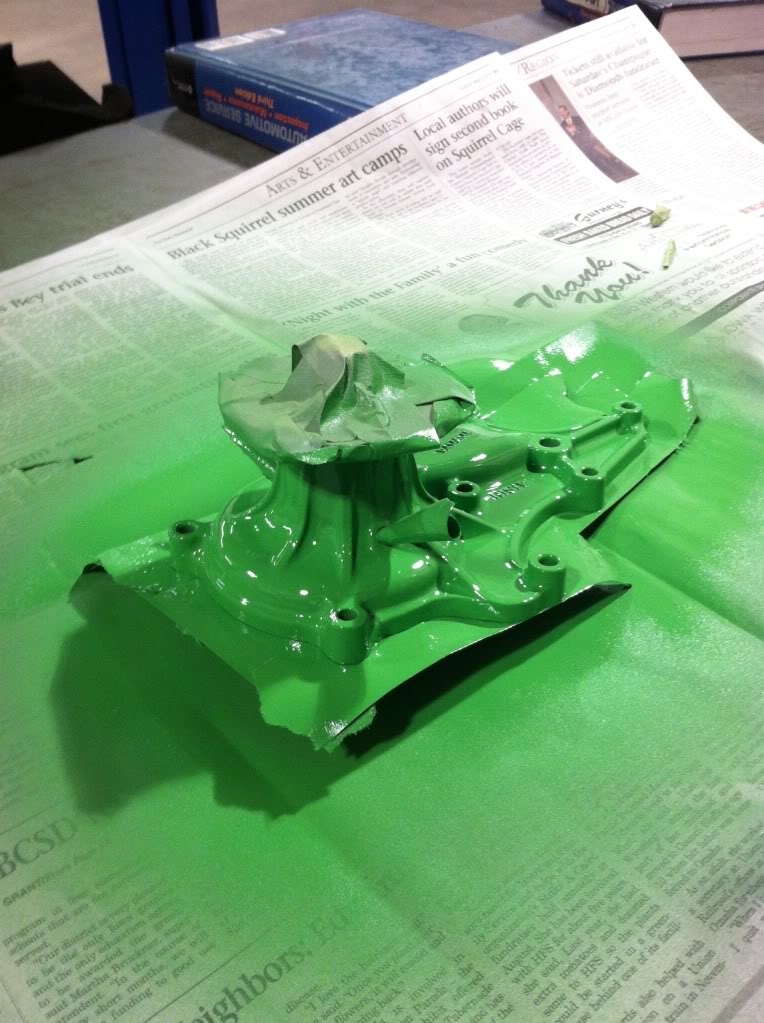

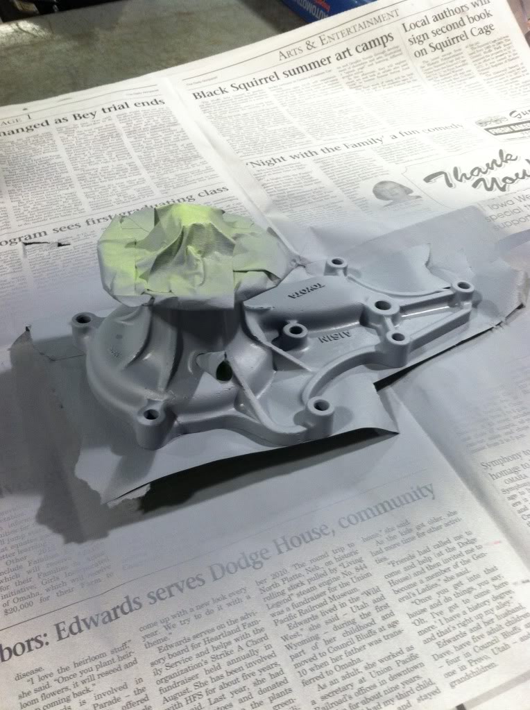

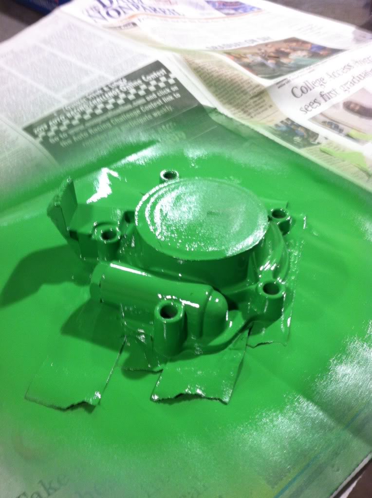

Decided to do the water pump as well
Old VS new Timing cover. Actually just robbing some bolts.

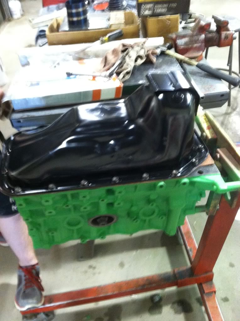

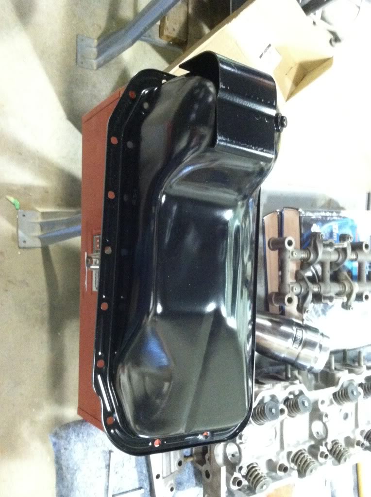

Put the Pickup tube on. Today. Also ordered a New Oil Pan. Decided to bite the bullet and Pay the 53$ instead of trying to reuse and paint the old one.

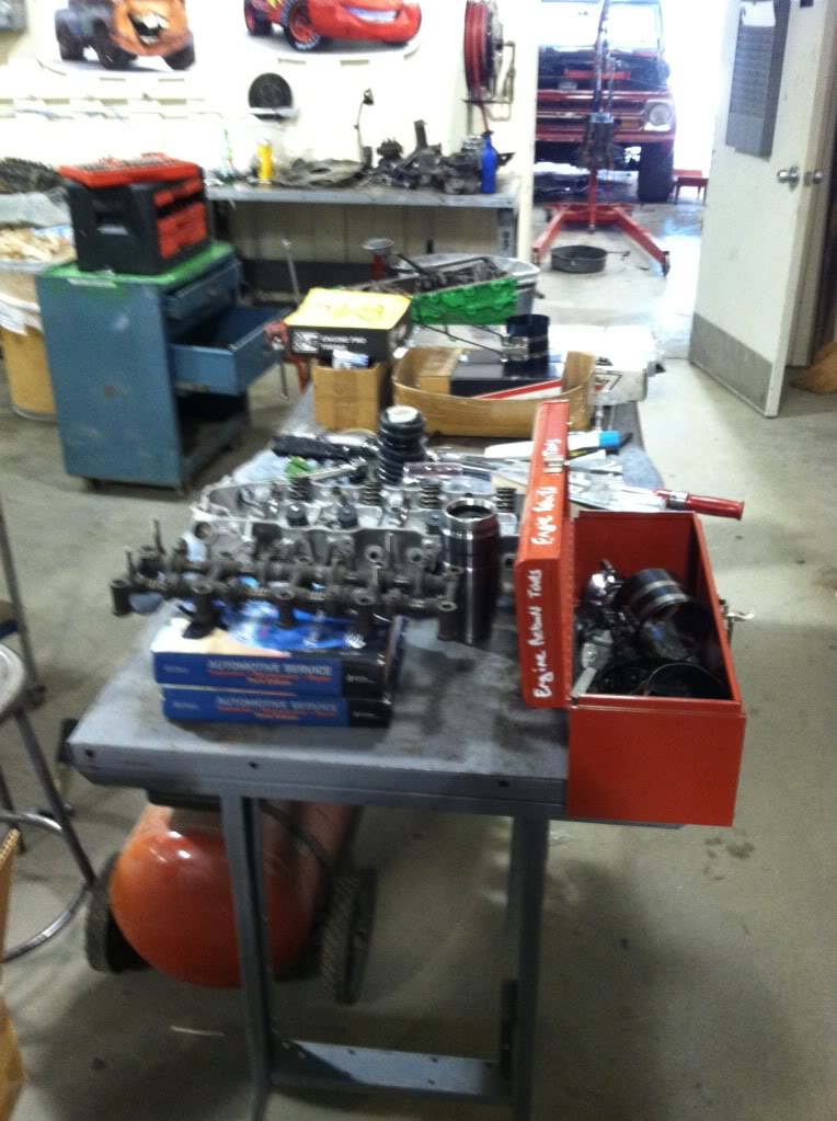

Messy Work Area

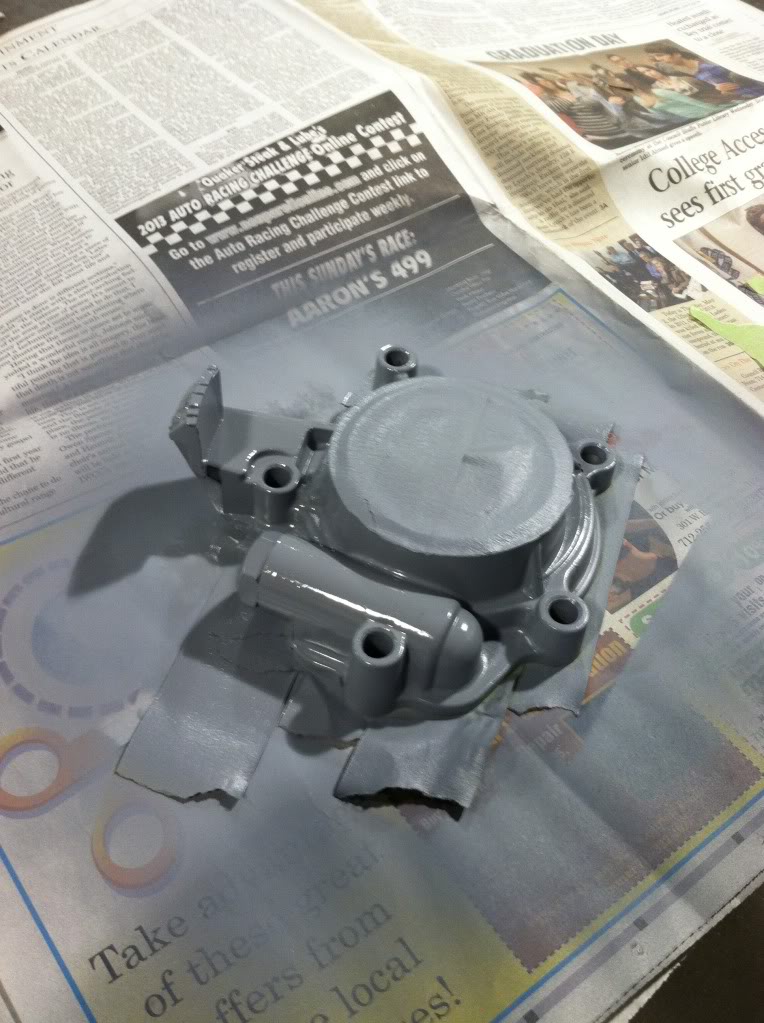

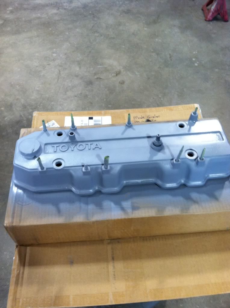

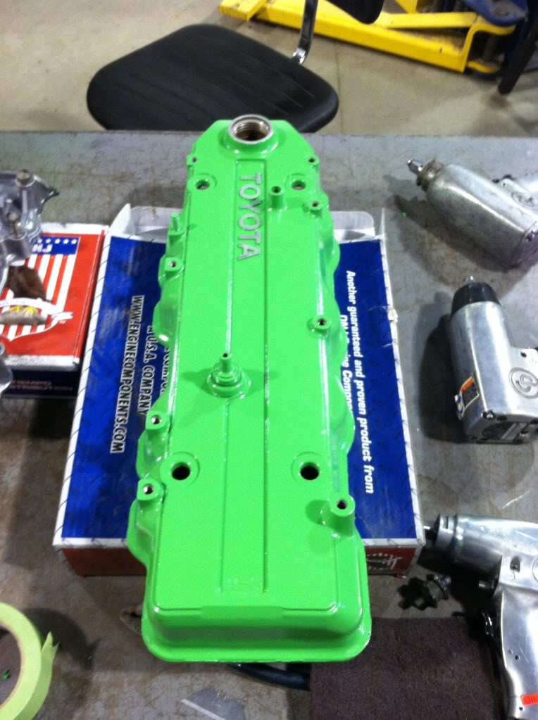

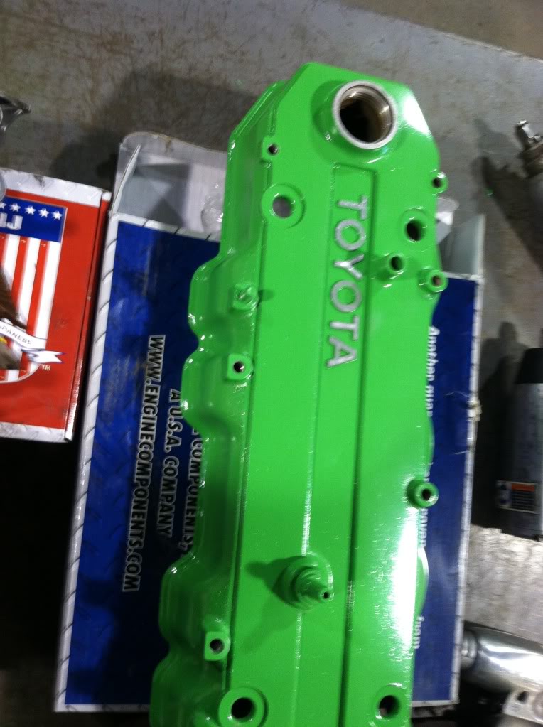

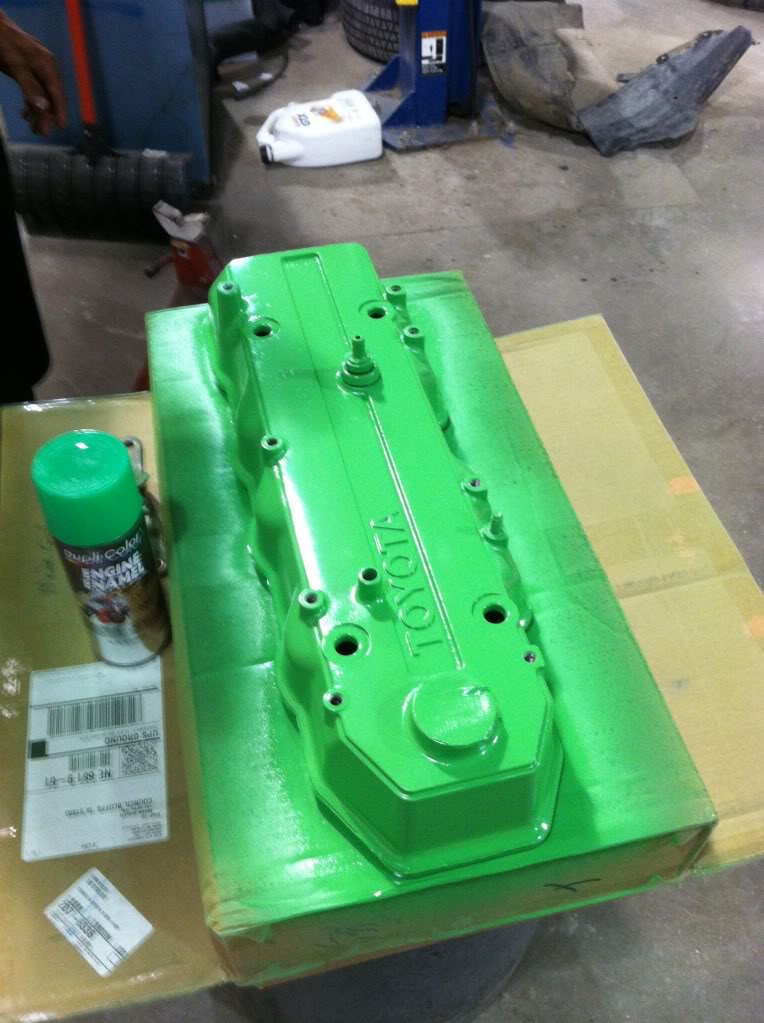

Decided to pain the Valve Cover Green like the Block. Was going to do a darker color but didnt think that it would blend together well. In primer now

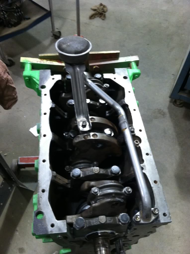

One of the Three donor Engines. Robbed the pickup tube, and the rear main housing.

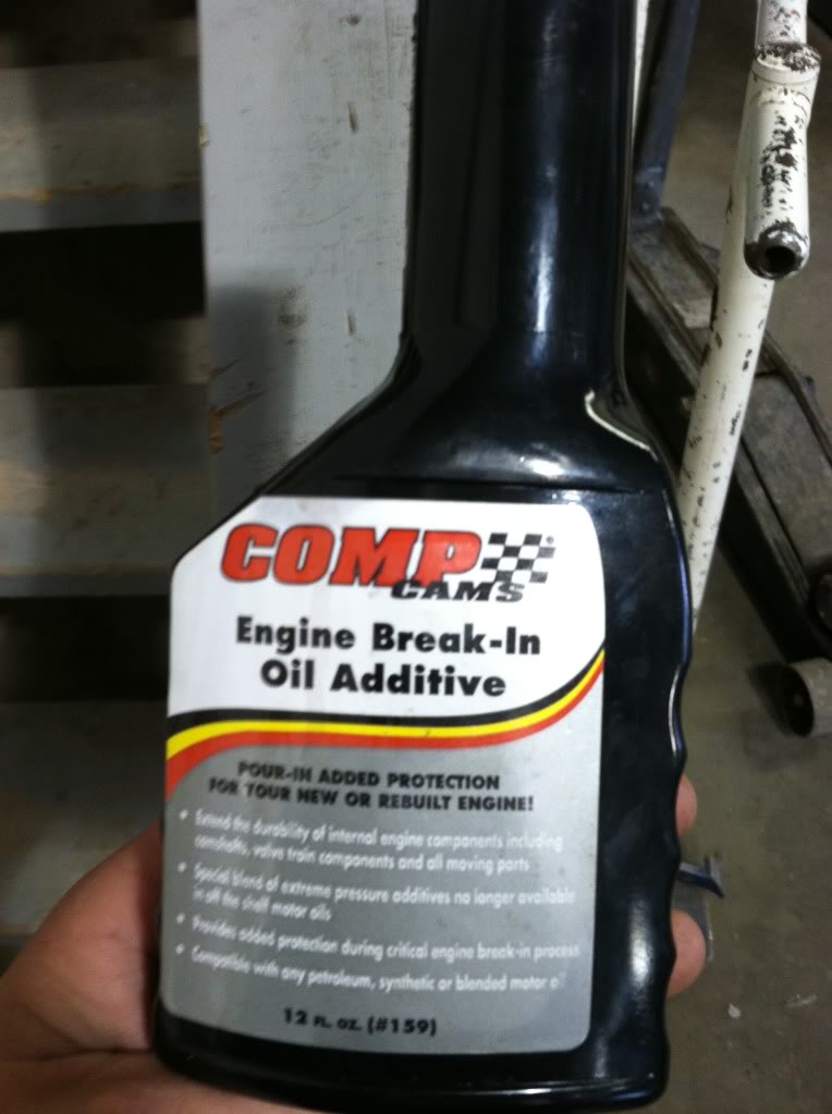

Also picked up some Comp Cams break in additive.

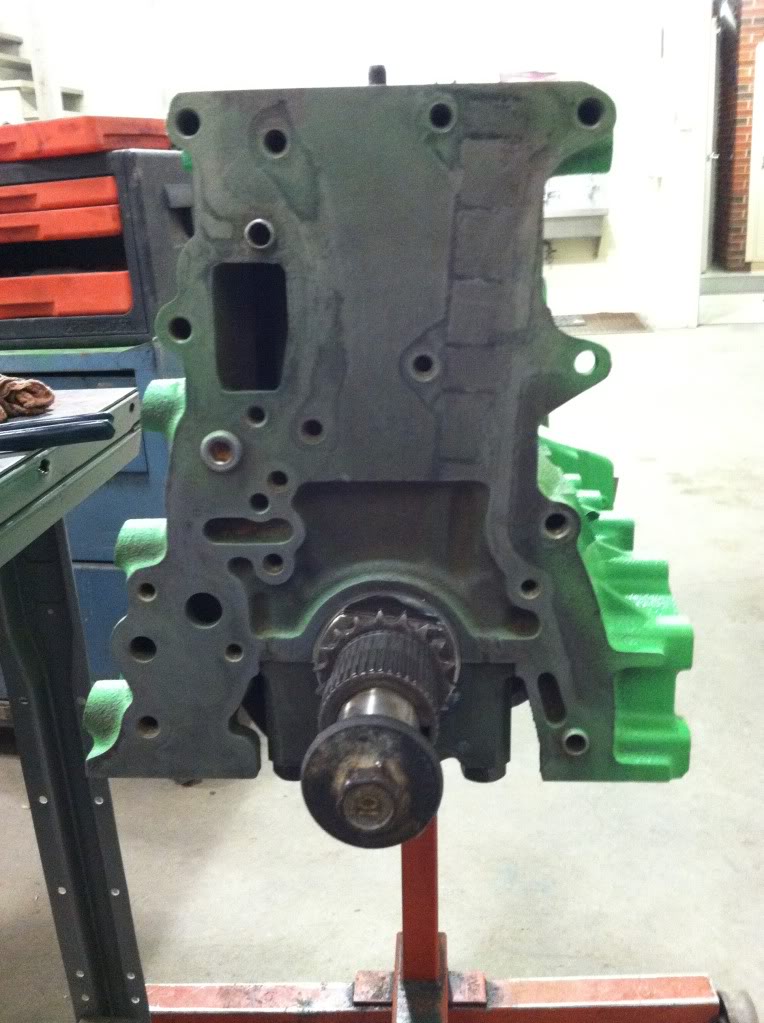

Looks great! How did you keep the Toyota letters silver when you painted it?
Old May 14, 2013 | 08:09 PM
  #109
Gizler00's Avatar
Joined: Aug 2007
Posts: 3,276
From: Pennsylvania
Thanks! The first time I ever is that , I spen some time taping of the letters. But the last two VAlve Covers I painted, I simply scraped off the paint with a razor before it was totally cured.
Old May 14, 2013 | 08:28 PM
  #110
84 yota dude's Avatar
Joined: Mar 2013
Posts: 1,060
Likes: 48
Ok, thanks thats a good idea to remove the paint before it dries all the way.

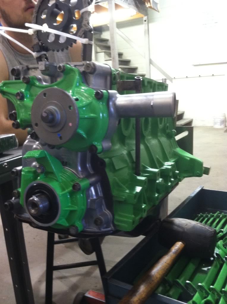

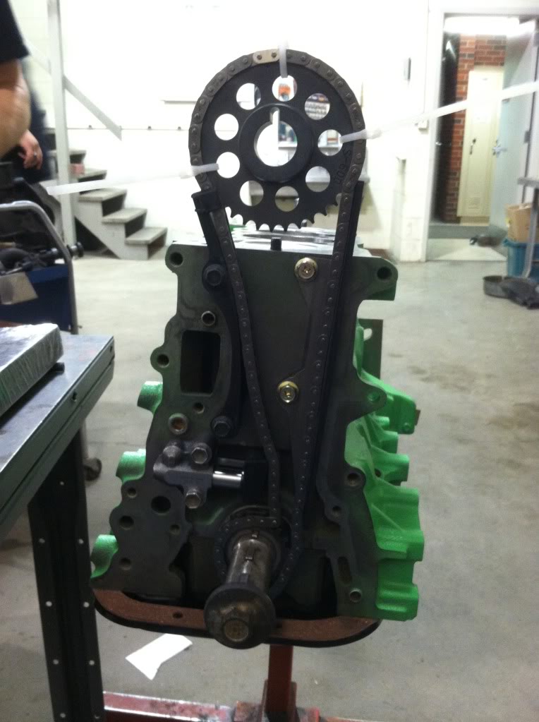

A few more photos from today. I got the new oil pan on, timing set, an timing cover on. Im going to put the oil pump and water pump on in the morning.
New oil pan
Installed

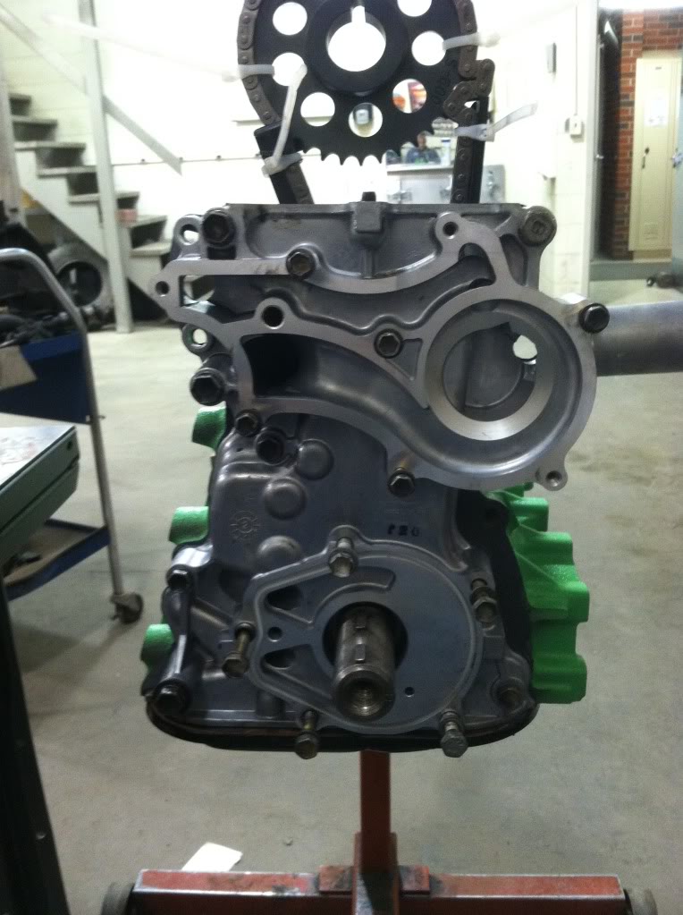

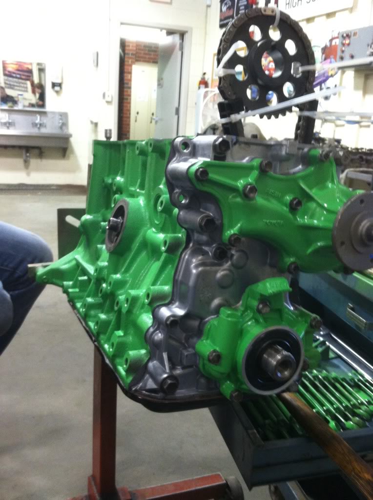

Timing chain on
Timing cover on

Your moving right along!!Im curious if the timing cover went on easily with the pan on?? were the pan bolts torqued when you put it on?I usually have a hard time getting the t cover on with the pan in place. Anyways looin good! Love the color!
Old May 17, 2013 | 04:25 AM
  #115
Gizler00's Avatar
Joined: Aug 2007
Posts: 3,276
From: Pennsylvania
Definitely hard to get the cover on. Because of the dowel pins that slide into the cover from the block.
I didn't torque the pan down until I had the cover on.
Color is really starting to grow on me.

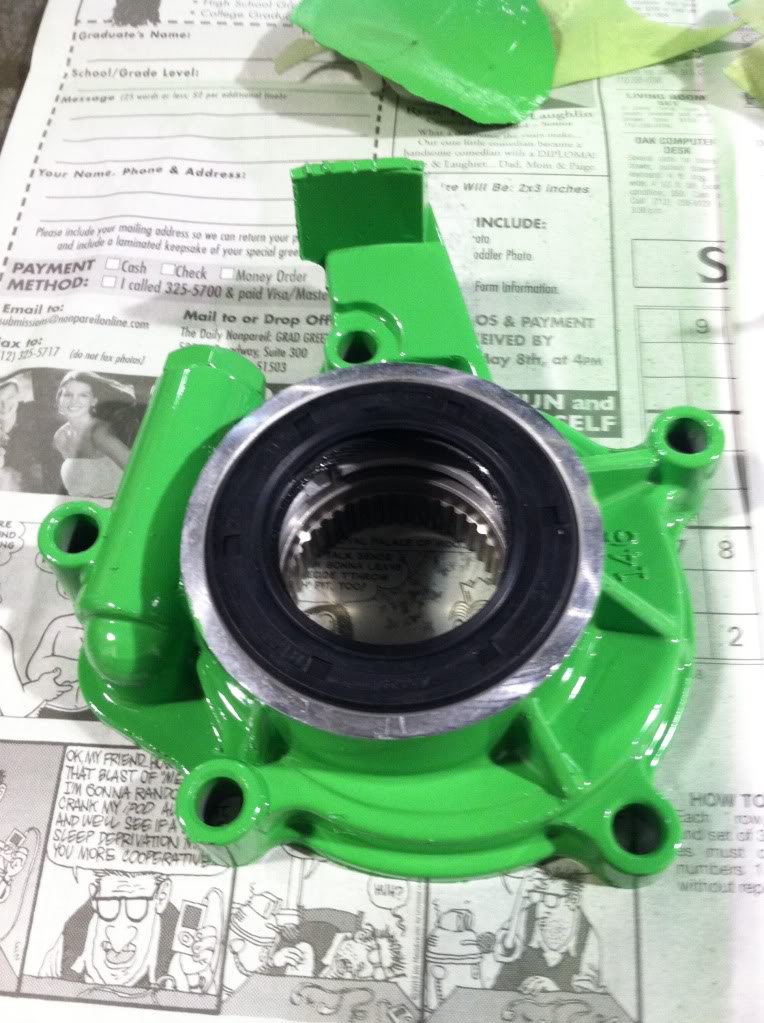

Few more pics. I got the water pump and oil pump on. Picked up my OEM HG and ordered the engnbldr 268 cam and valves.
Have to do valve guide seals and install valves and cam. Then bolt head on.
I'm going to pull the runner into the shop this week comin to yank the engine so I can swap all the EFI components.
Any how. Enough talk. Here's the pics.
