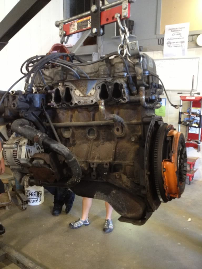

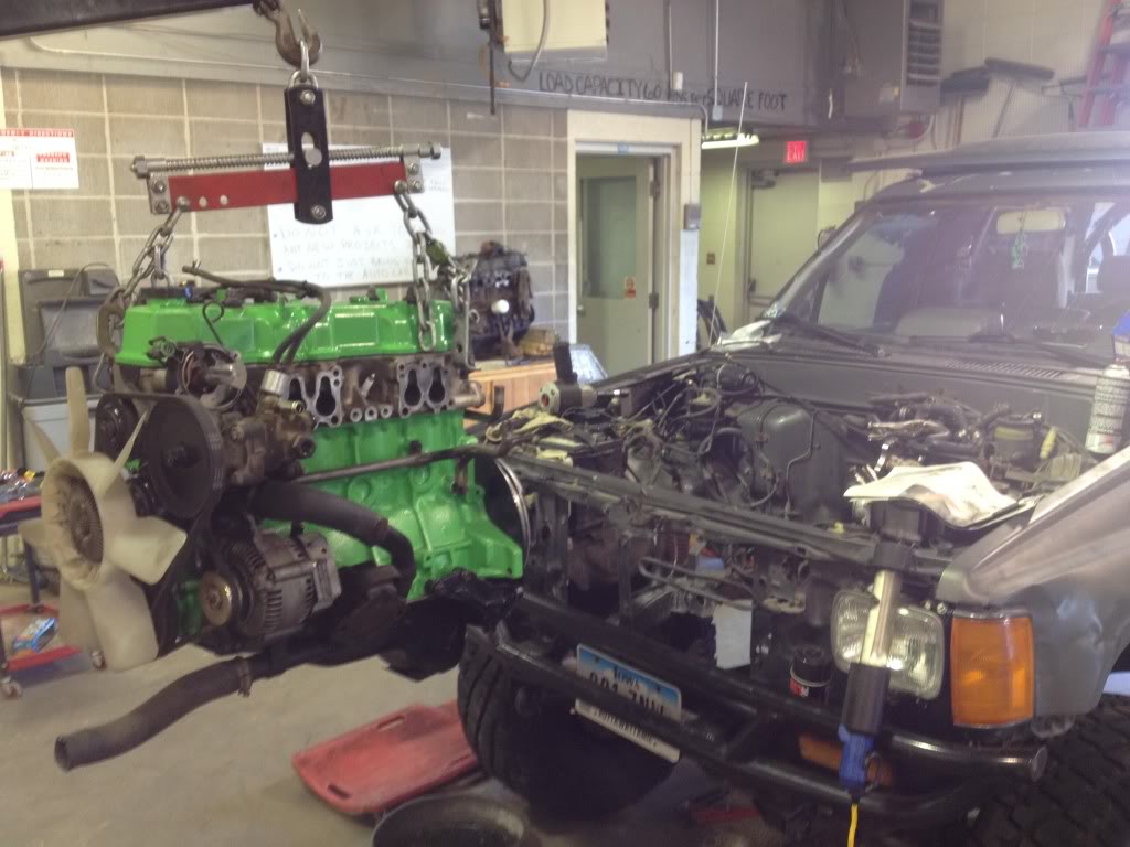

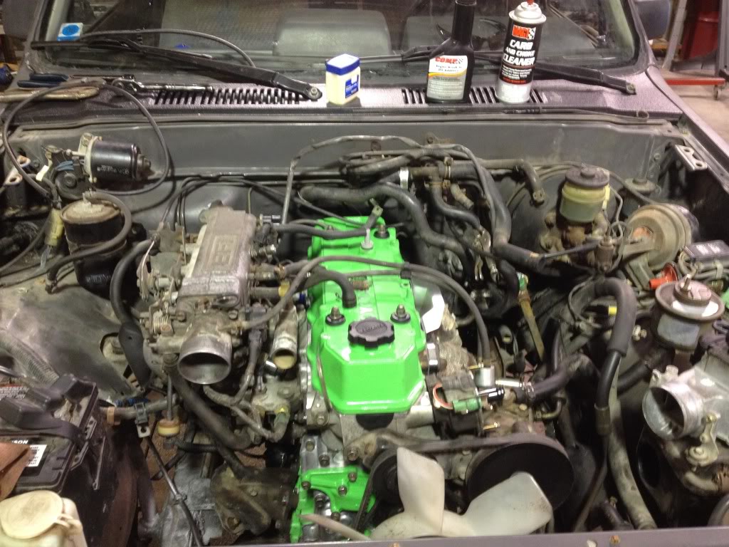

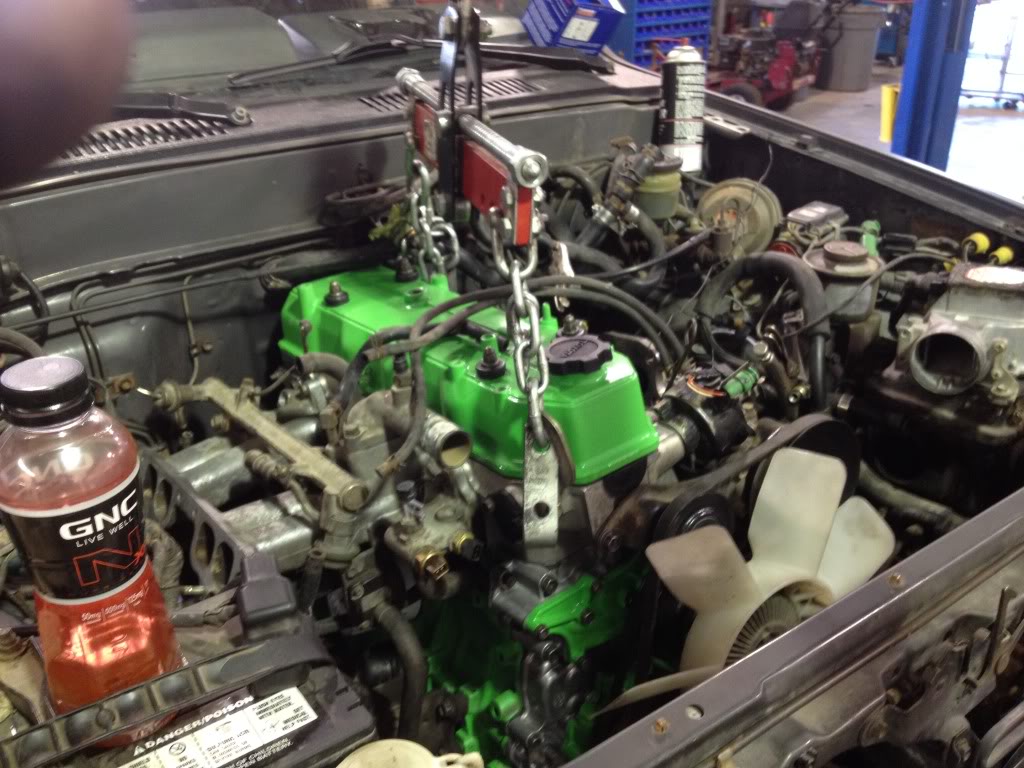

Finally got the engine out today! !!

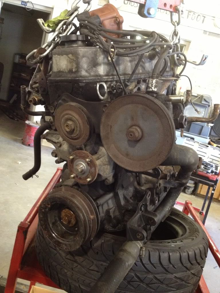

After the engine was out, I found something interesting.

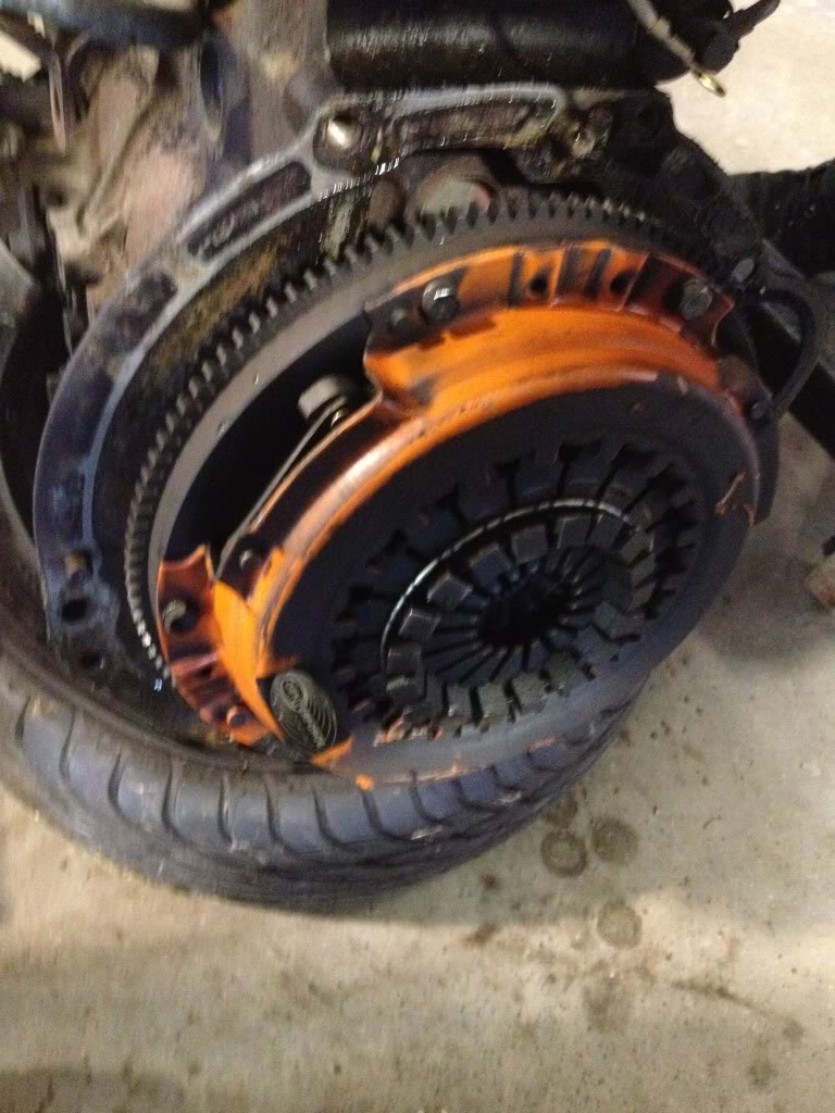

A. Centerforce clutch! Never knew it was in there!

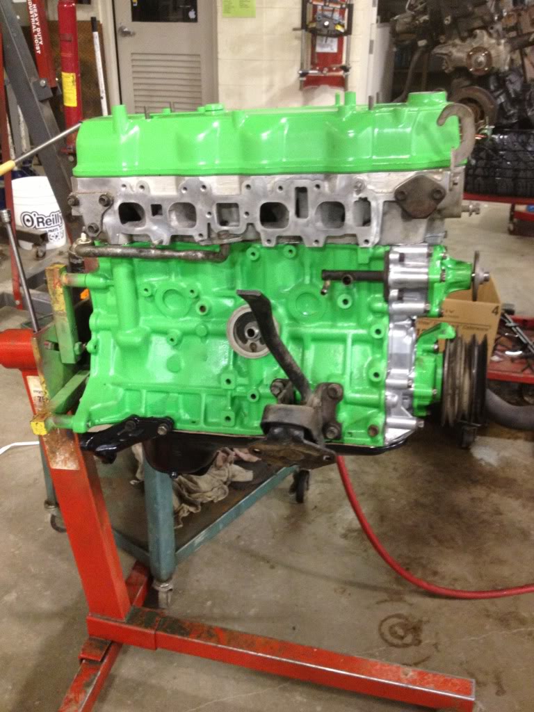

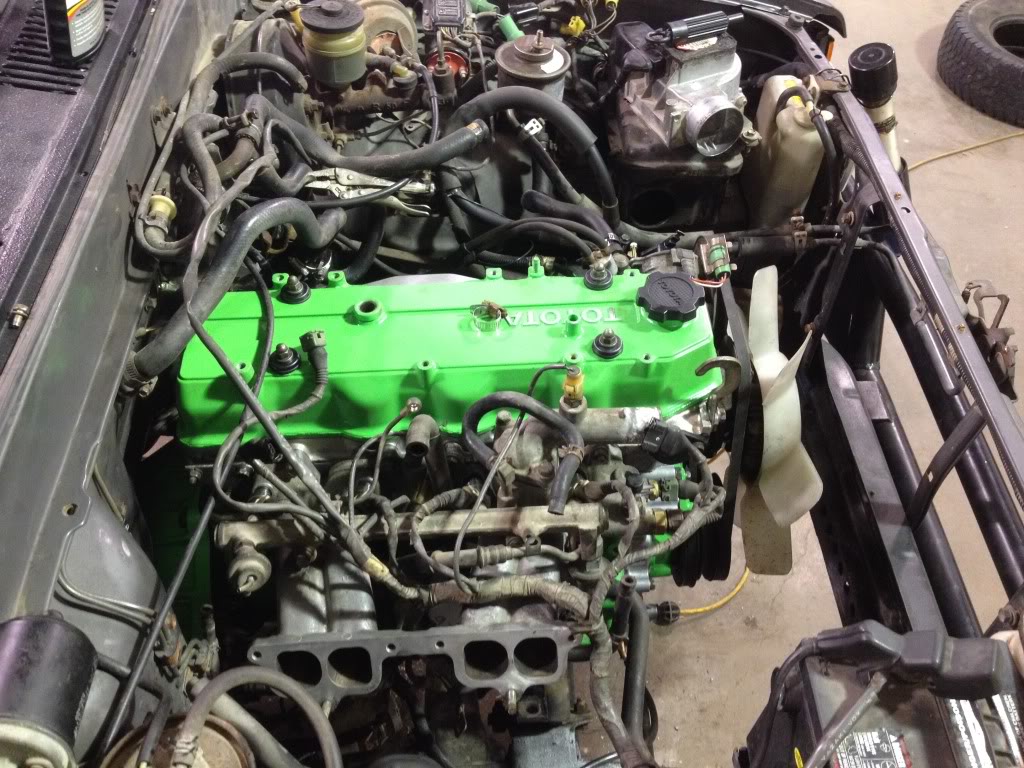

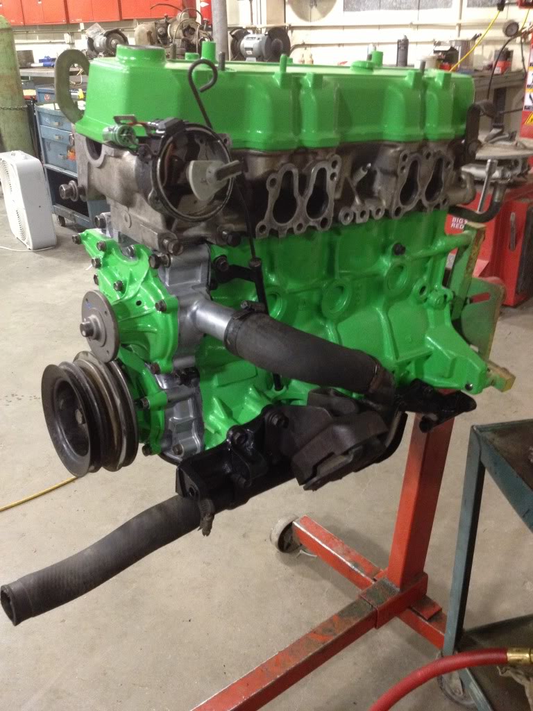

Started stripping parts from the old engine to prep and install on the new one. It's coming along good so far , just slow.
I'm going to pick up some new radiator hoses for the coolant outlets on the back side of the timing cover(pass side). Just have this fear of one blowing out that's all crusty.
All that's left is to get the lower intake on, injectors sent out, new clutch and flywheel on, and bolt her in.
Here's a few quick pics.

I also got the new throw out bearing pressed on to the housing, so that's ready to go. It's getting closer!

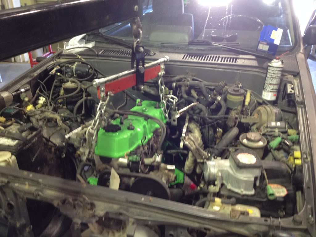

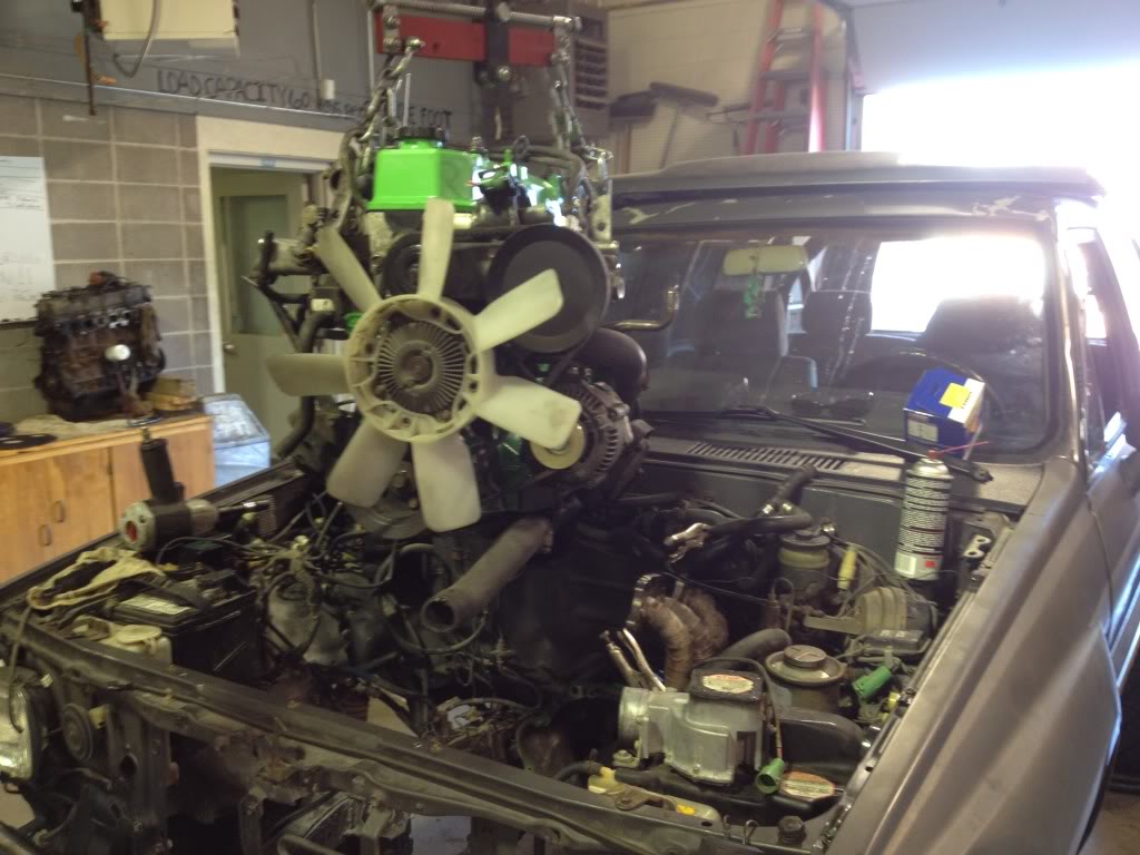

Well I'm finally getting some time to update a little. I was waiting on some parts that felt like they took forever to show up. I needed to get two new throwout bearing clips. And because mines an 85, I have the old style with the two crappy clips.
I had to order them from the dealer and the fella in the parts department accidentally only ordered one, so I had to wait another day. Wasn't a big deal since I have been waiting all this time anyhow.
Then last week I was pulling out my injectors to send out. And found that my #3 injector had a busted nozzle. So I found my rich condition. I never really dug into this as I new I was replacing the engine. So long story short, I ordered some rebuilt ones from auto value, and to my surprise they ended up being rebuilt oem injectors!! I figured I would get some crappy off brand.
Anyhow here's a few pics.

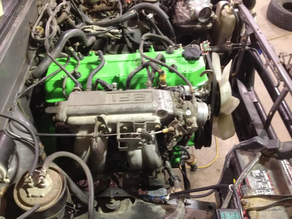

Here the engines bolted to trans and frame mounts. And have lower intake on

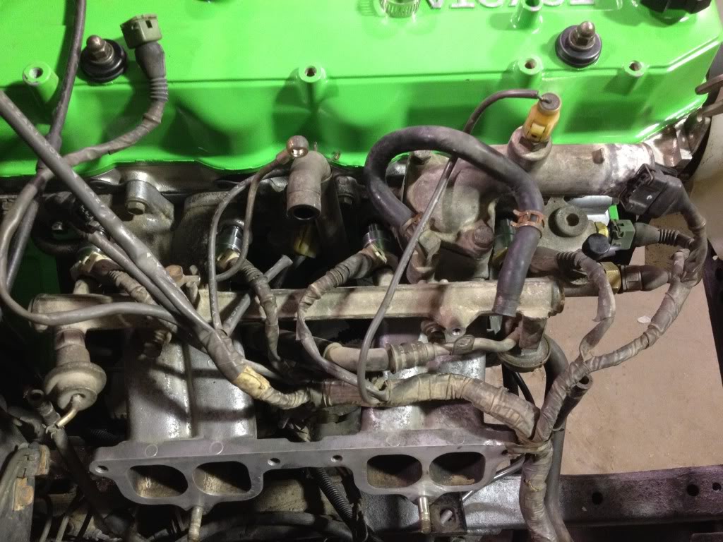

Finished up the day today with all the EFI installed

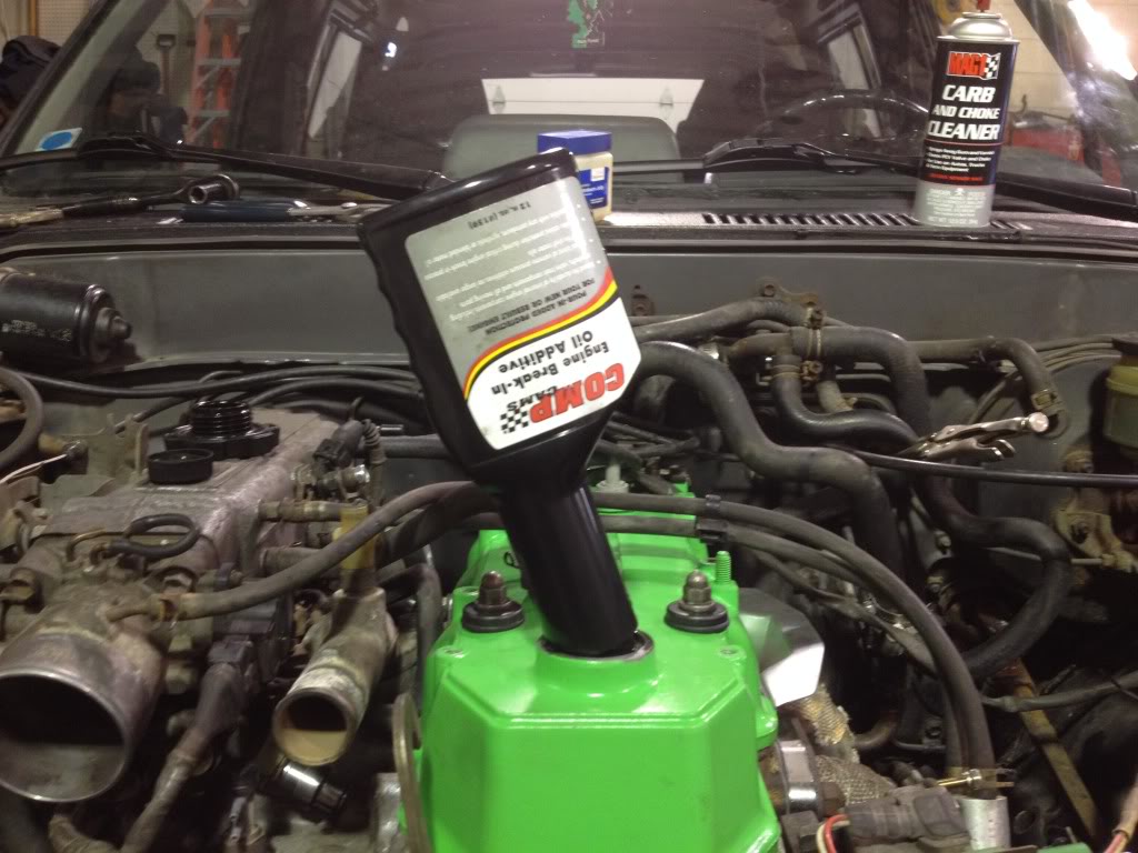

And now with the comp cams break in additive along with the valvoline

Having issues. Does not want to start. Had to tap the distributor in to place for it to seat in the head. Pulled distributor out and found that the gears were ground off!! Not sure whats going on here. Any suggestions would really help.
Heres a picture.
