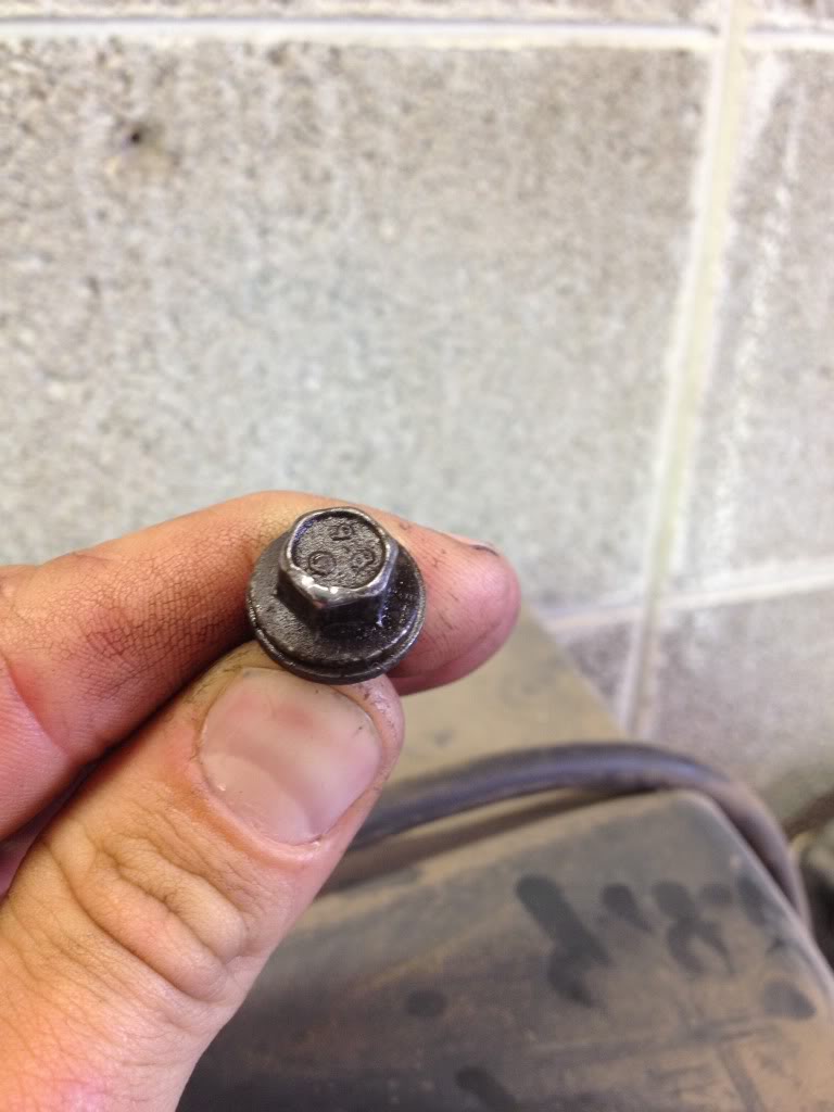

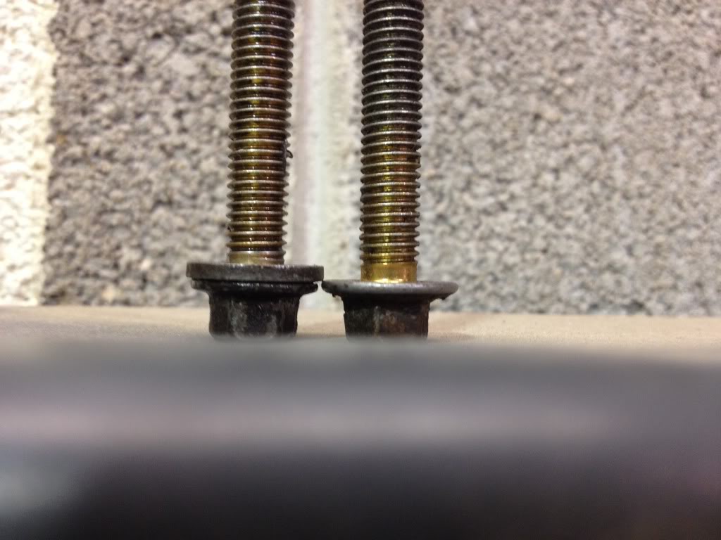

I figured out the problem. After a few hours of installing the distributor into my new engine and then the old engine, then the new engine again. I found that the distributor was always sitting 1/16 of an inch out away from seating in the cyl head. I ended up draining out the puddle of oil that collects where the hidden timing cover case bolt sits and Voila!! I had a bolt in there that had a washer on it, causing it to sit about a 1/16th of an inch to high.
Just enough to cause the dist to stick out to far.
What was happening was that the distributor gear was getting bound up between the cam gear and the Timing cover bolt. Therefore causing the gears to be shaved off.
Here are a few pics of the bolt that was the suspect.
Thanks for all the help guys. This was driving me crazy.
Here are a few photos.
The bolt with the washer causing the issues on the left

Heres the top of the Bolt where it was getting worn down from the distributor gears.

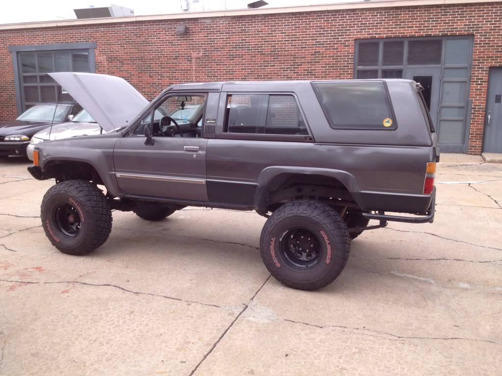

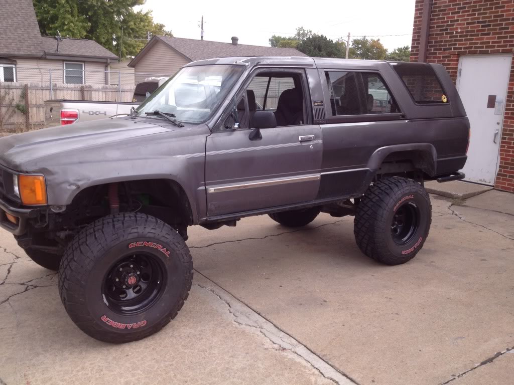

Running and driving

Excellent pics! Also the oil that collects around the hidden bolt could not be seen until you soaked up the oil that collects in the valley where the bolt itself. I was also literally thinking constantly but your the one who figured it out so I definetly learned something new. Im glad your driving it already and i hope after its broke in you can rip on it with 5.29s and climb something, or over a heap for that matter.

I think its amazing how that washer made it just tall enough to cause that!!!
