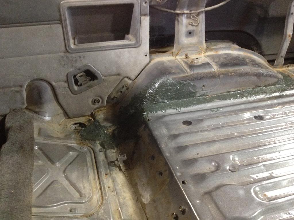

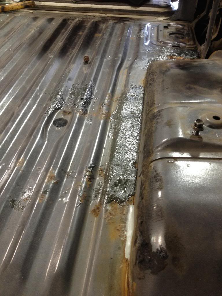

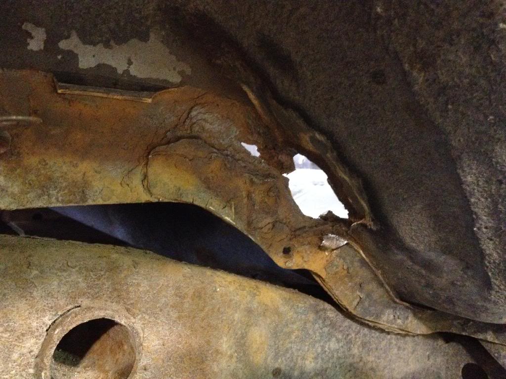

Well in my rush to get things done, I reluctantly did not take as many photos during the process as I would have liked.
However, I wire wheeled out all the rust and scale, then dug out the rest with a screwdriver. Kind of scary what I uncovered for a mostly rust free, so I though, vehicle. Makes me wonder about some of the other vehicles I have owned and never pulled the carpet back.
Anyhow, I cut out and welded metal in every where I could then decided to do a top coat with fiberglass reinforced filler to seal it up. Im hoping to day to get everything prepped to lay down some bedliner.
Here are a few pics from after.
Here was one hole that I dug out with the wire wheel.
It seems as though the extra piece of metal that holds the inner fender well was holding all kinds of crap in it and had to be partially taken out. I ended up welding in a piece of 3/16's steel and then putting some filler over it to seal it. I will most likely then use some industrial undercoating that I have with a schutz gun after im all done.

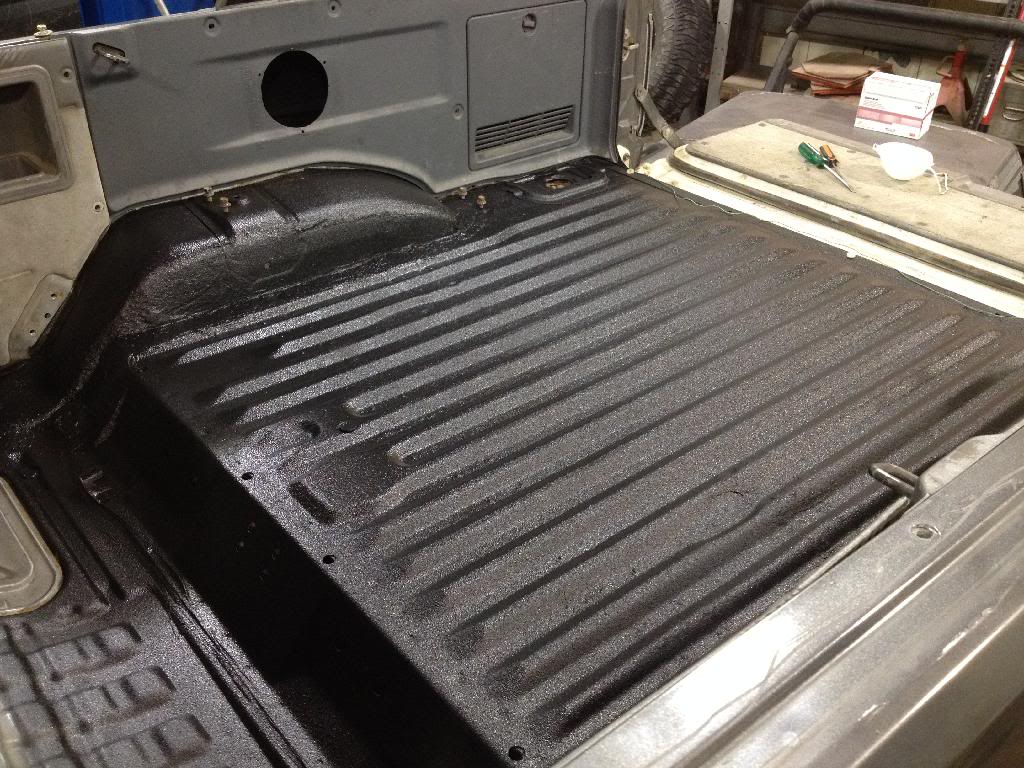

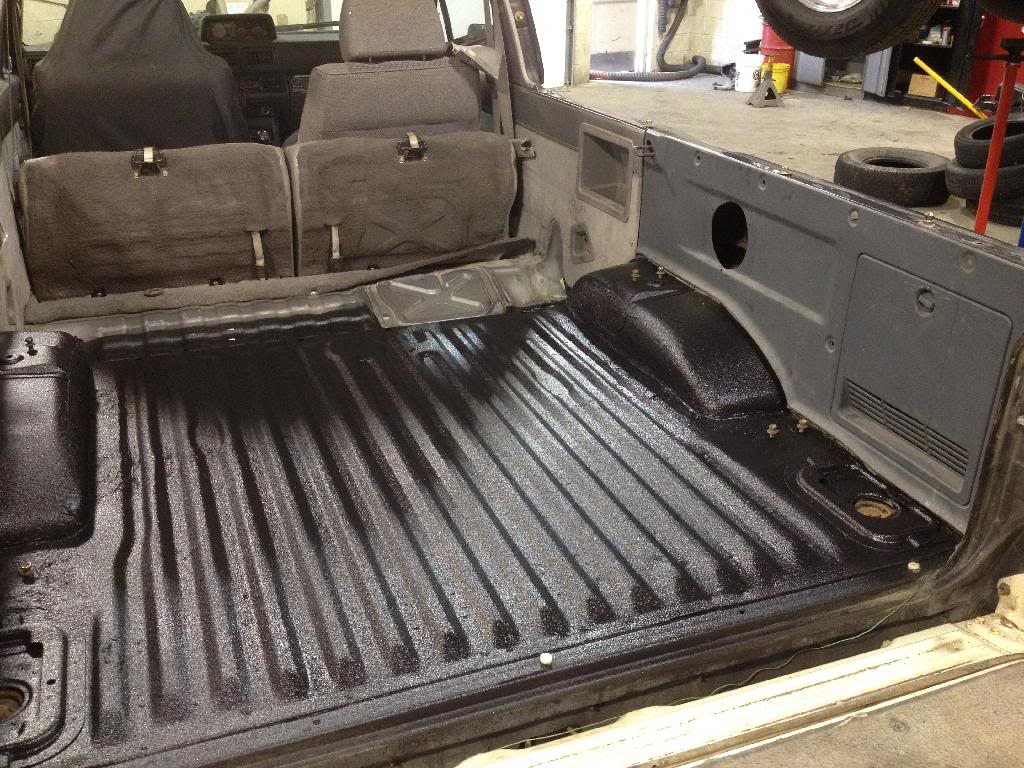

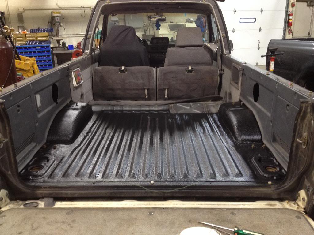

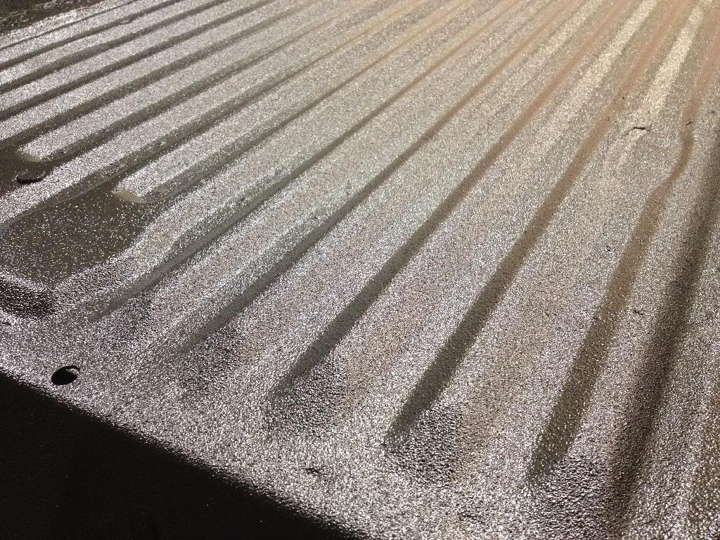

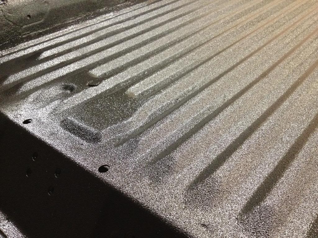

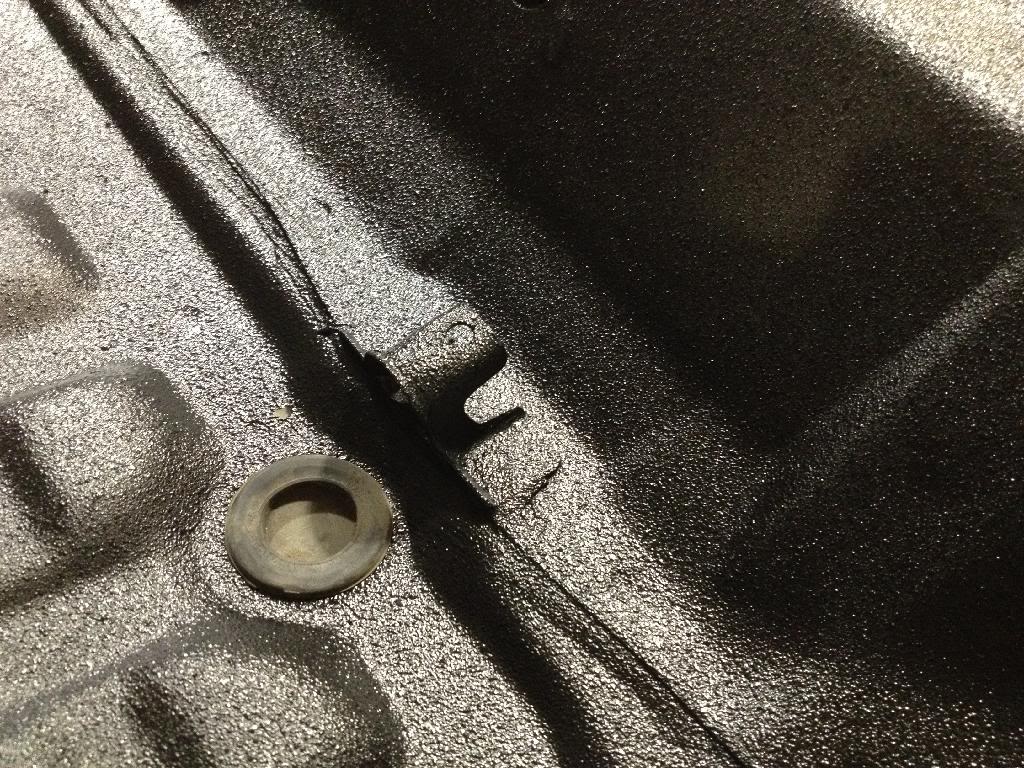

Ok guys, here are a few more pics from the final product. And a few details about what and how I did it.
Few close ups
All back together.
So if some of you are wondering... I used the UPOL Raptor Liner. I sprayed it with the UPOL gun that you have to purchase extra with the kit. I typically use the highest psi I can through the gun to get the finest texture. I like it this way because it does not tear up your knees.
I hand sanded everything down with sand paper between 80 grit and 320 grit. I then vacuumed out all of the dust. Washed it out, then proceeded to use a Wax and Grease remover. (the one thats in a pic I posted a few back).
Let that dry, and then sprayed some adhesion promoter in areas that I found difficult to sand. waited about 15 minutes then sprayed on the liner.
I then let it setup overnight and cure before I put everything back together.
I opted to put the carpet back over the whole thing for now. Maybe if I can lay down another bottle of it later on, i might opt to leave carpet out. But for now shes covered back up.
Very very easy to use ans spray on. I want to take the front seats out and do the rest of the cab when I have more time.
