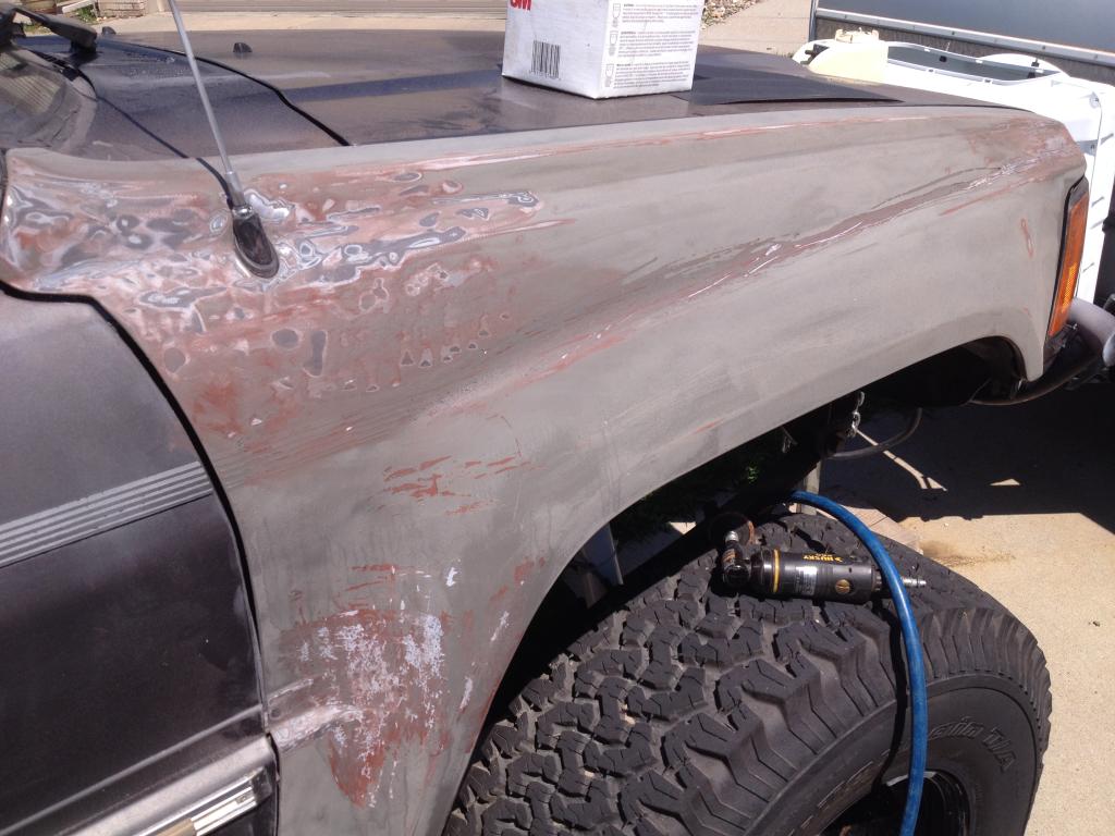

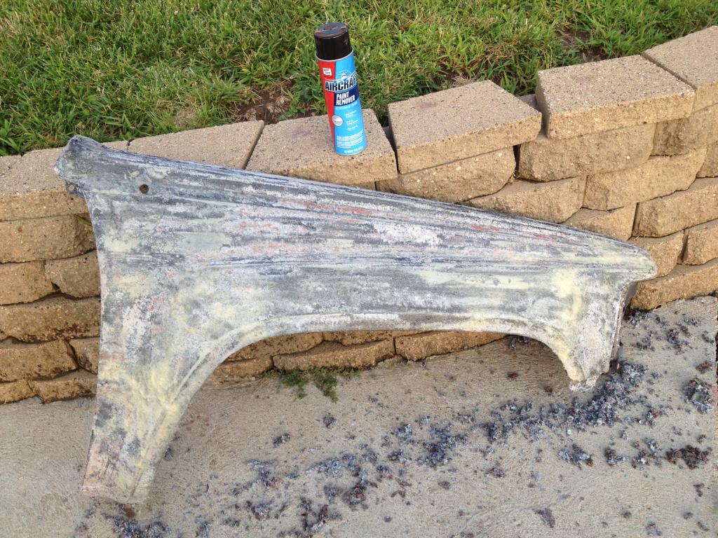

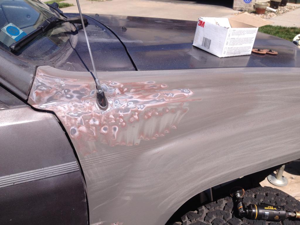

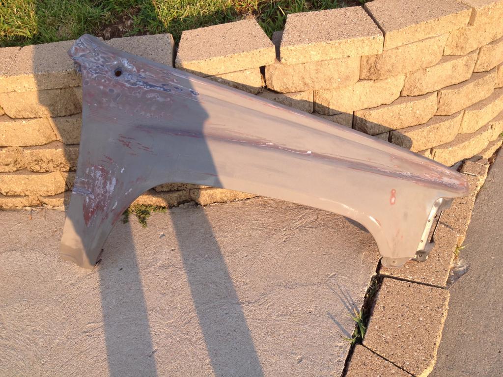

Well......The paint was a bust. After three days if drying out in the sun, it was still soft. Soft enough to take my fingernail and scrape it off.
In top of that, there were a few areas that it wrinkled and stayed almost wet and never cured.
I learned my lesson.
The last time I painted part of this truck was when I did the rear tub. When I did that I went with quality paint from D&R paint supply that ivy my shop. It's expensive, but color matched and top quality paint. Still holding up.
This time I thought I would do it on the cheap and I paid for it.
Needless to say I'm very frustrated.
Stripped all the paint off of the fender tonight. Have to do some finish sanding on it, then lay down some primer.
Here are a few pics of the mess.

I will now be going with the paint that I can get from the supply house. Going to cost more, and will have to mix it but it's worth it now. Especially after this.

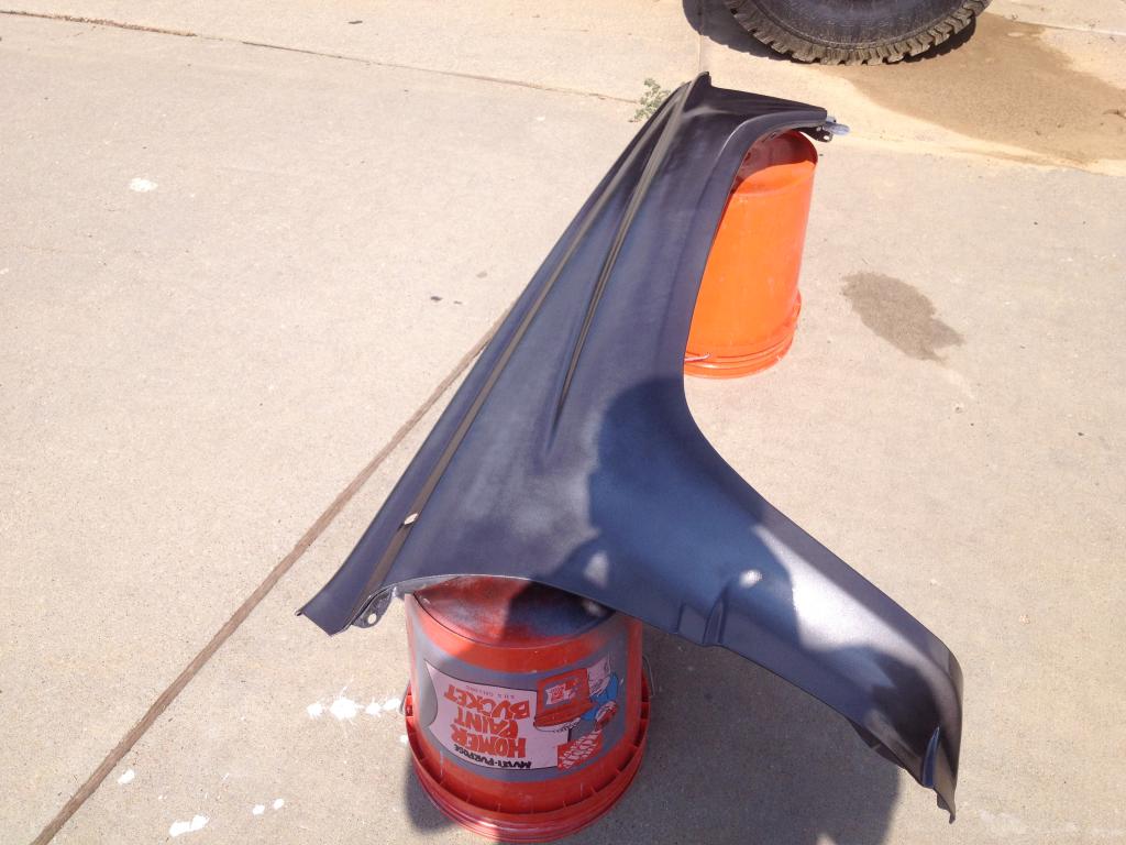

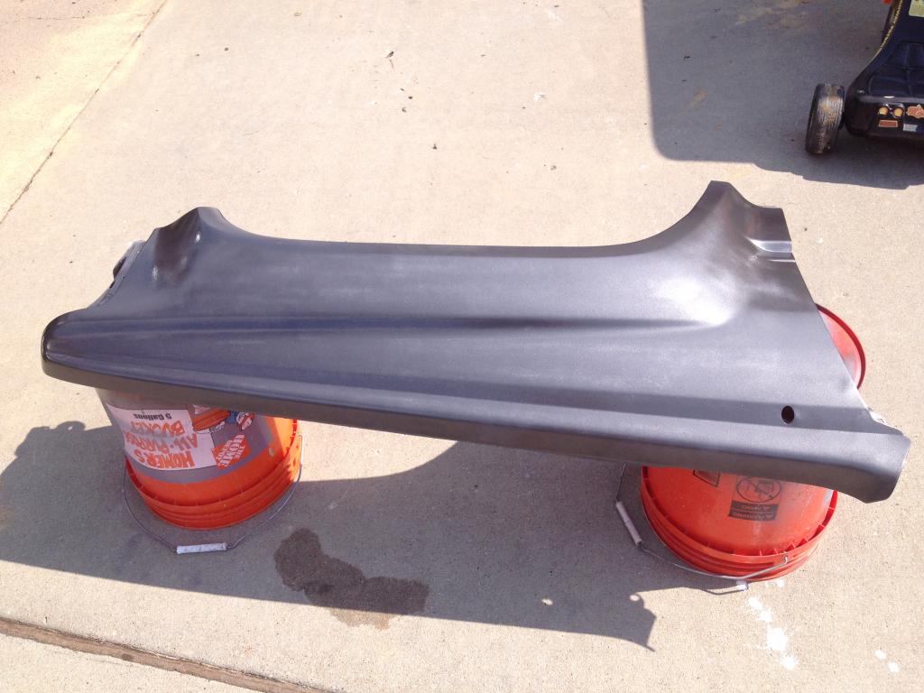

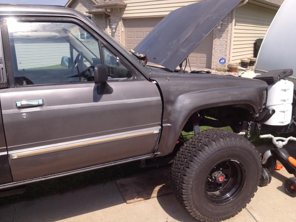

Finally getting somewhere.
I fully stripped the panel, two coats of primer with wet sand in between and after.
I only had a little left of the OEM paint that I got from the supply house. But it was enough to throw a light coat on the fender, and cover the primer until I can get more.
Temporarily hanging to dry

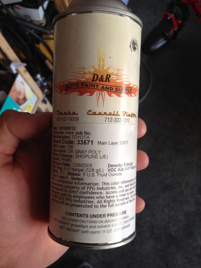

Clearly needs more paint, but I have to get some made in the next few days.
Here's a pic of what it is and the info. In case anyone is interested.
The OEM code is 138 Dark gray poly
