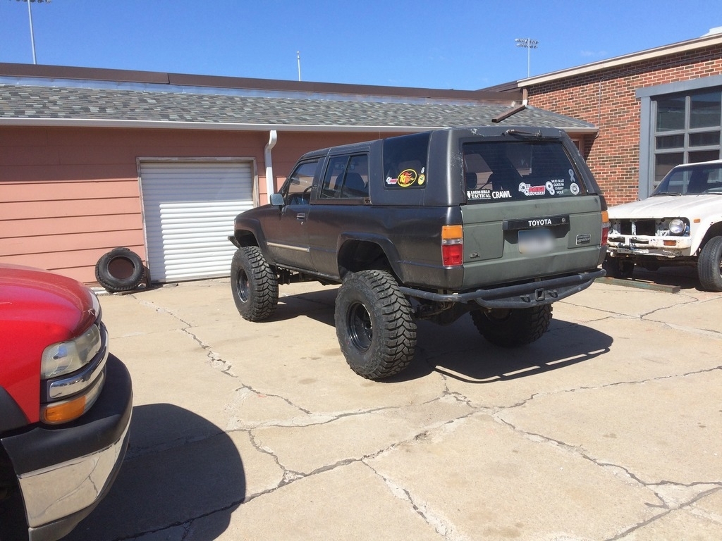

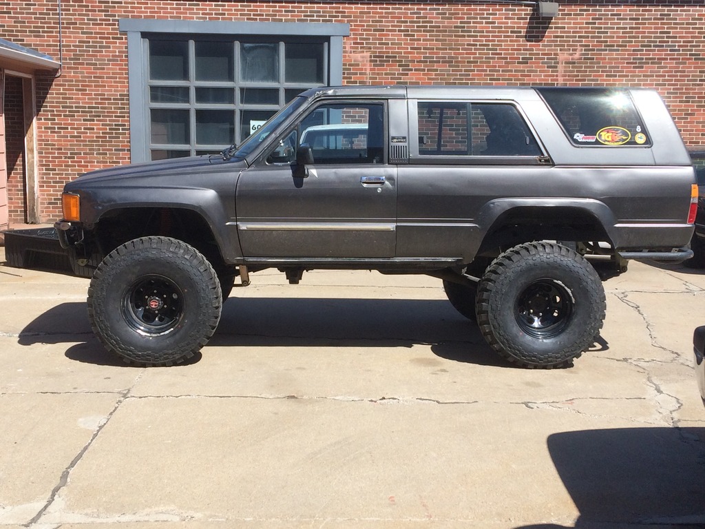

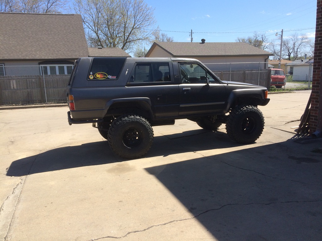

Definitely drives a lot different. Now that I have the right size tires on for the 5.29's....its definitely not as peppy as before (I expected this), but still drives great. Definitely a lot taller than I thought it would be.
I did not realize this until I opened the tailgate to load something and the gate was hitting my legs further up on my waist than before. By a few inches.
Here are a few pics I took just a few minutes ago.
One thing that I need to figure out is the air pressure. You can see in the pic above^^ the air pressure was set to high and only riding on the center of the tread.
I dropped it down to 30psi and its still not hitting across the full tread. I am hesitant to drop it below 30 but looks like I might have to if I want them to wear nice and even.
Anybody else have any input on the PSI for 35's they have ran, possibly the Trepadors?

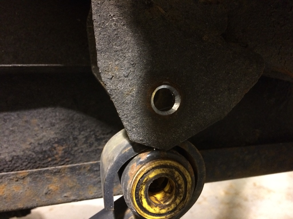

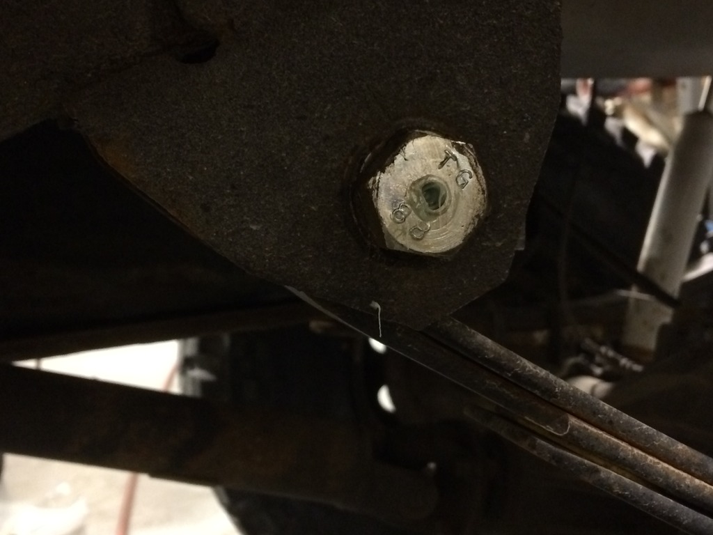

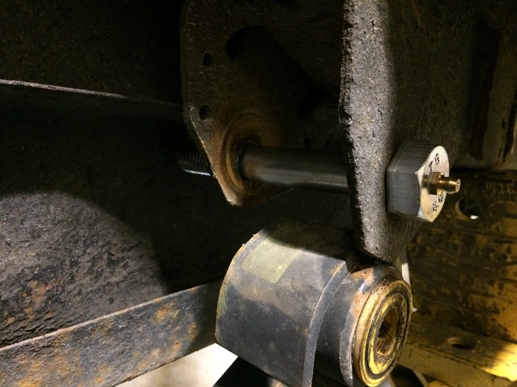

I finally ordered some grease-able bolts from TG for my front bolts on the rear leaf springs.
They only offered them in 18mm diameter and 120mm,130mm,and 140mm lengths. I decided to go with the 120mm length, although I think that they sent me the 140mm ones..
When I removed the old bolts I realized that I forgot they were smaller than 18mm. I have been meaning to do this since I installed the new springs.
I ended up drilling out the factory bracket to accept the 18mm TG bolts.

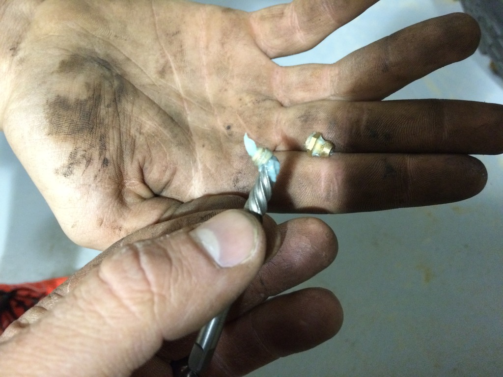

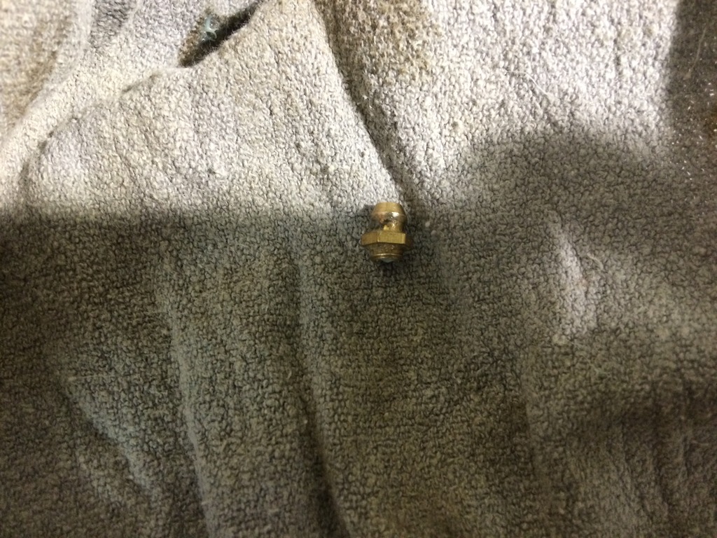

One thing I have noticed with these TG pins is that the Grease zerk's are so fragile.....they literally break in half when you look at them. Both sides broke off as soon as the grease gun hit them. This is the same thing that happened to me with a few on the front.

All went smooth and now I have the correct size for the Bushing in the rear springs.

Nice work on the greaseable shackle bolt install! I noticed the same thing when I bought some greaseable bolts from TG for the front of my 86' it seemed like the grease zerks broke really easily.

I dont understand it. They are so fragile!! I cant wait to test these tires out on the trails.

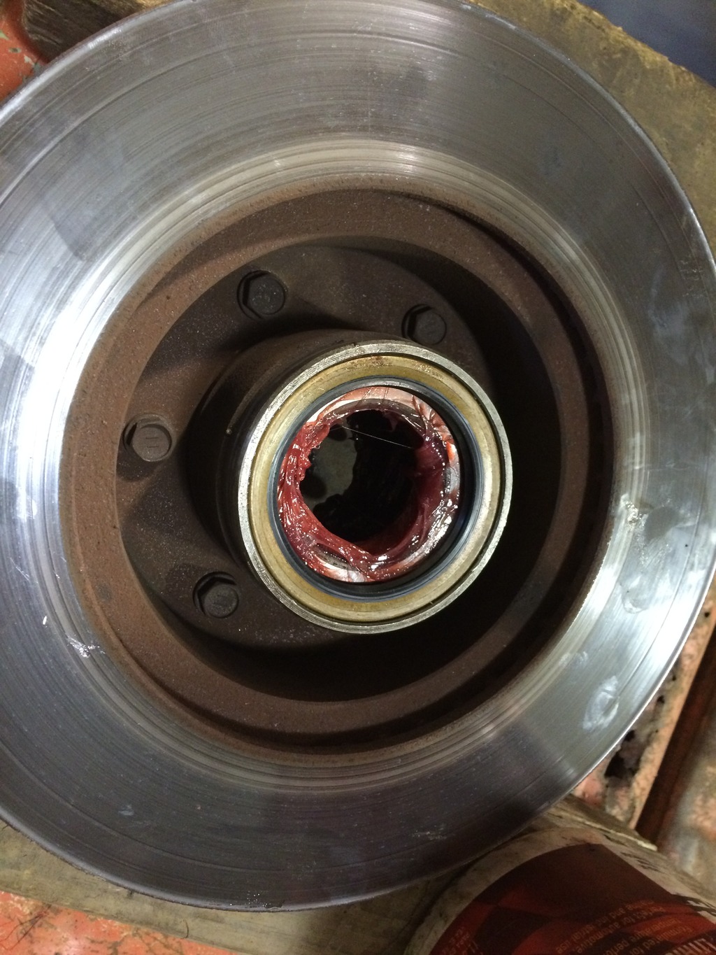

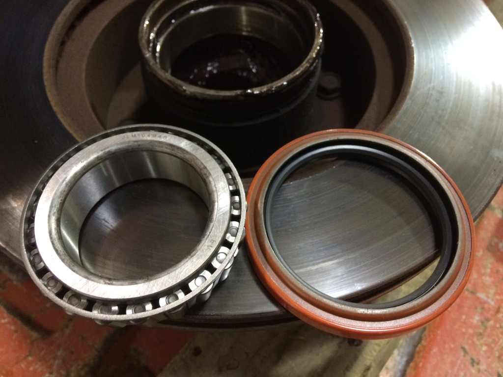

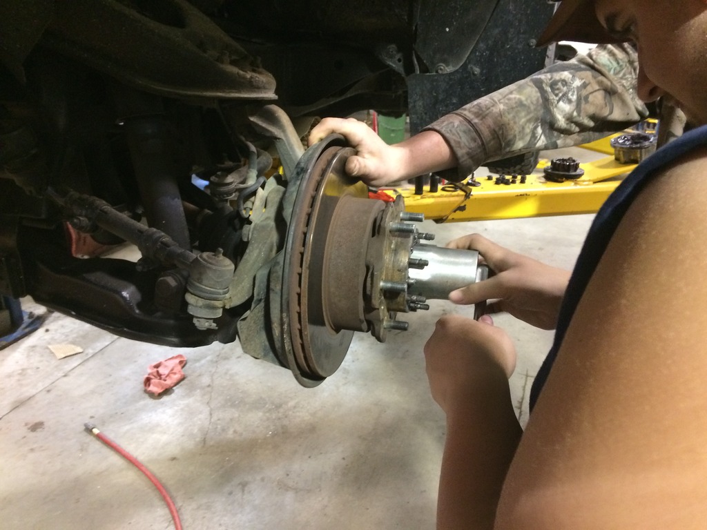

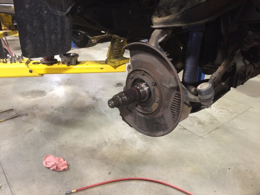

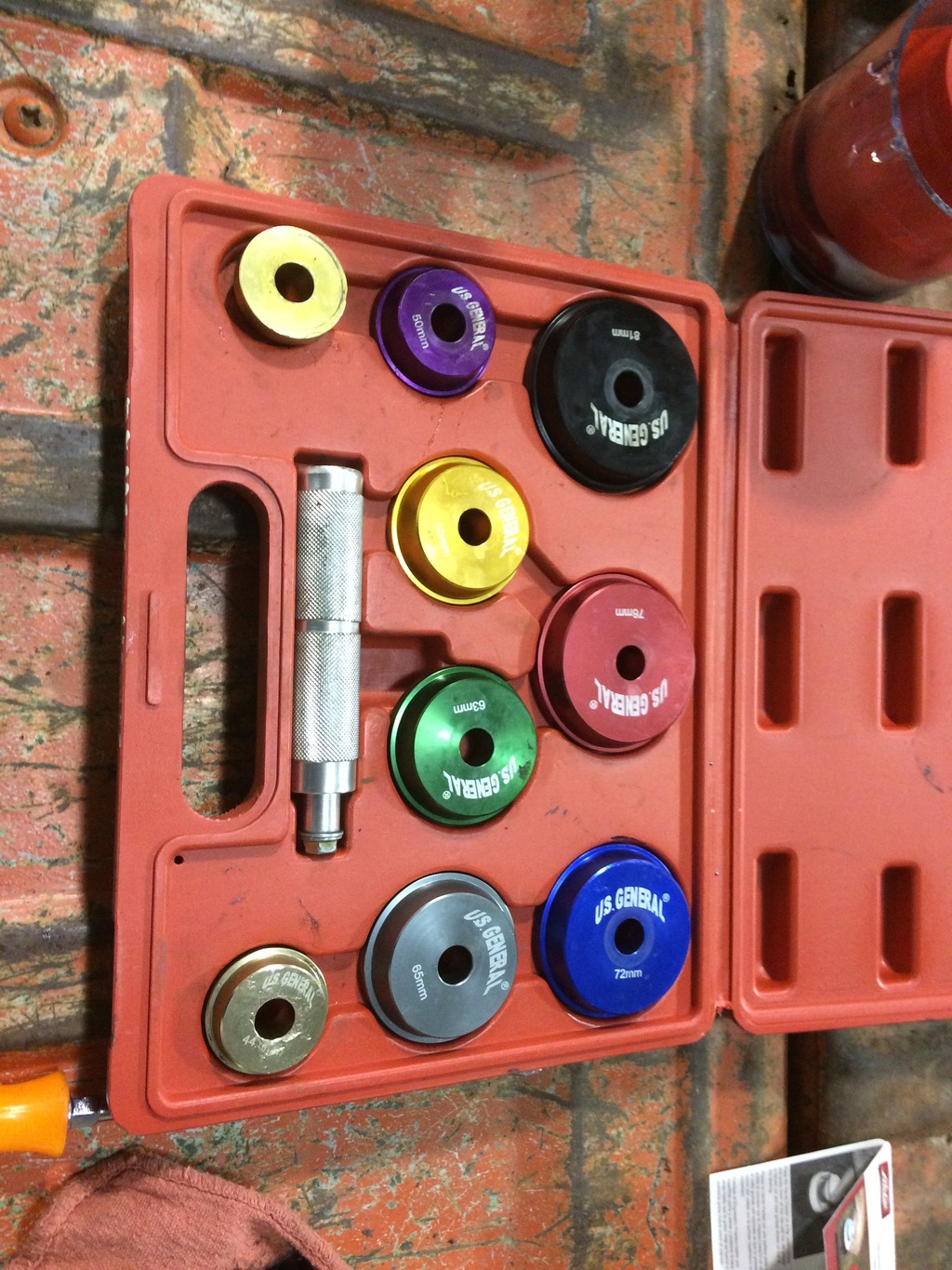

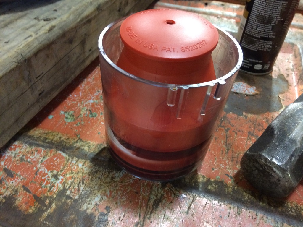

My bosses new truck developed a growl from the passenger wheel well, and I convinced him to do both inner and outer bearings and seals.
Busted that out today. Showed the kids how its done.

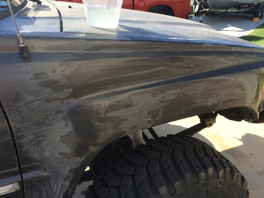

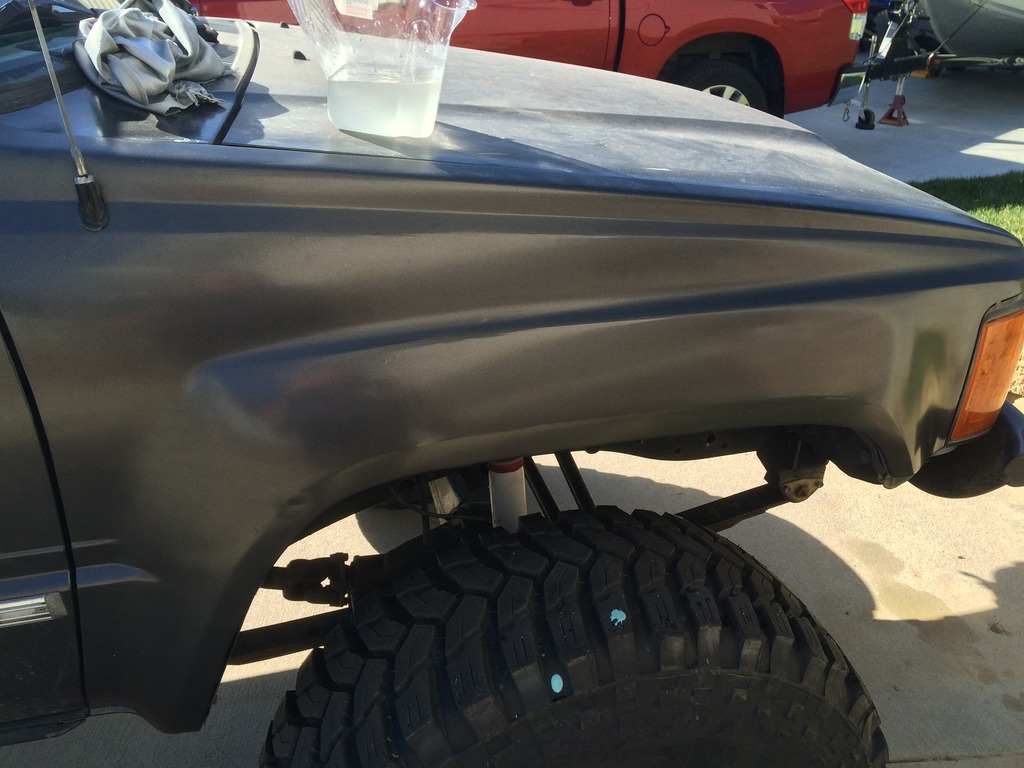

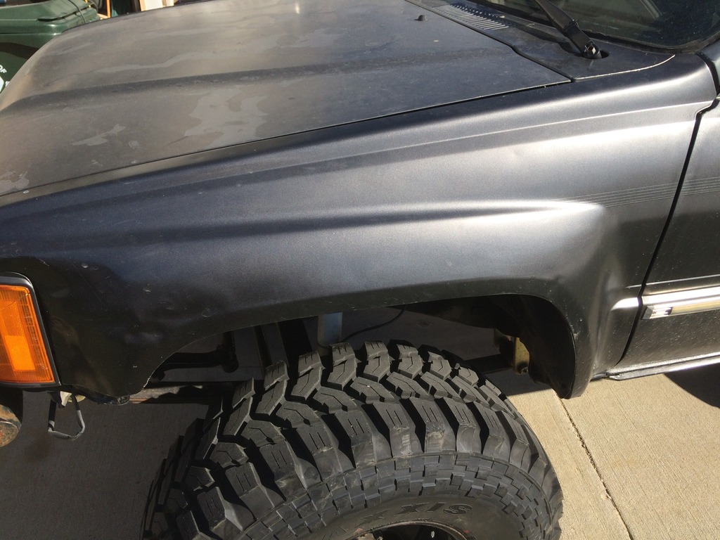

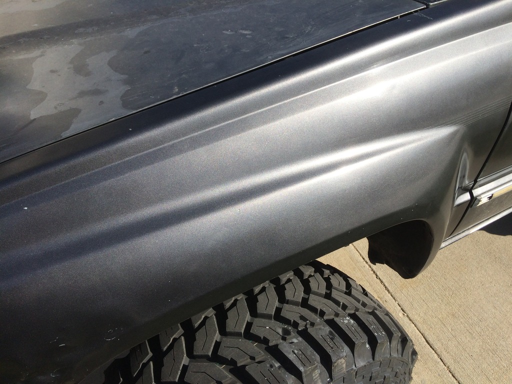

Had a wild hair up my behind and decided to try and wet sand my front fenders to see how the paint would turn out.
I only spent about 4-5 minutes doing this, and I do not have a buffer......so it came out just okay. I think I might take some more time on the whole body and actually try to wet sand it down and polish it up.
Here are the pics. Its really hard to tell a difference from these. The edges of the panels are very clear and you can see your reflection in them. I just need to spend some more time and get the whole thing like this.
I forgot to take before pics.
