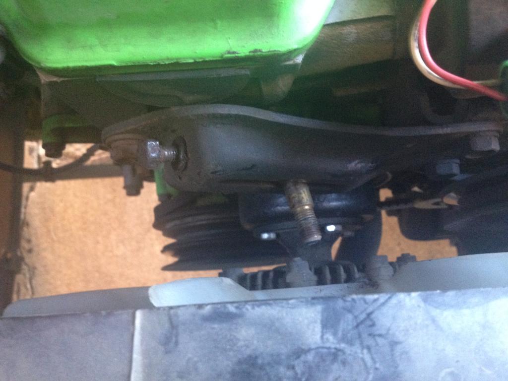

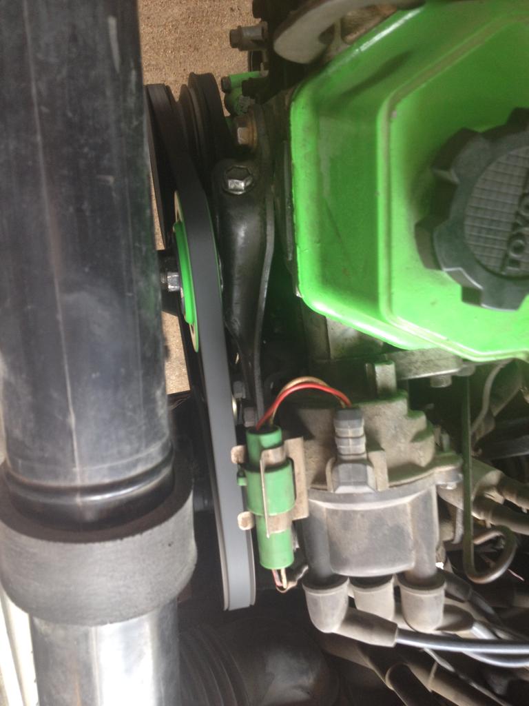

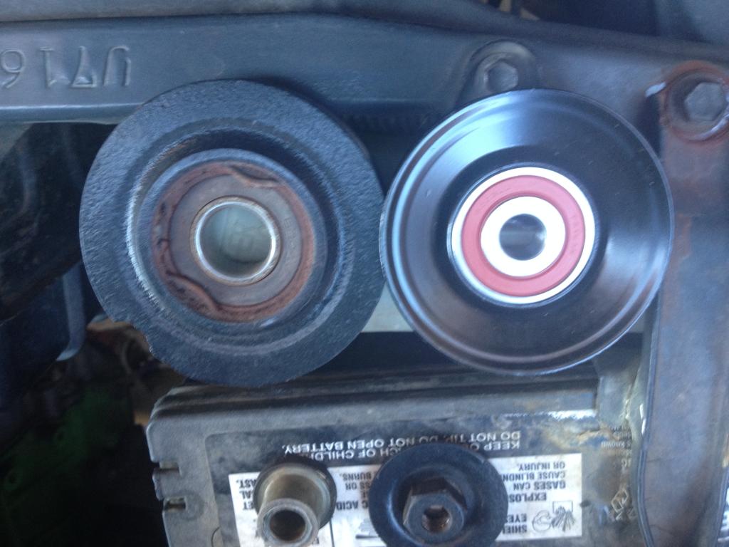

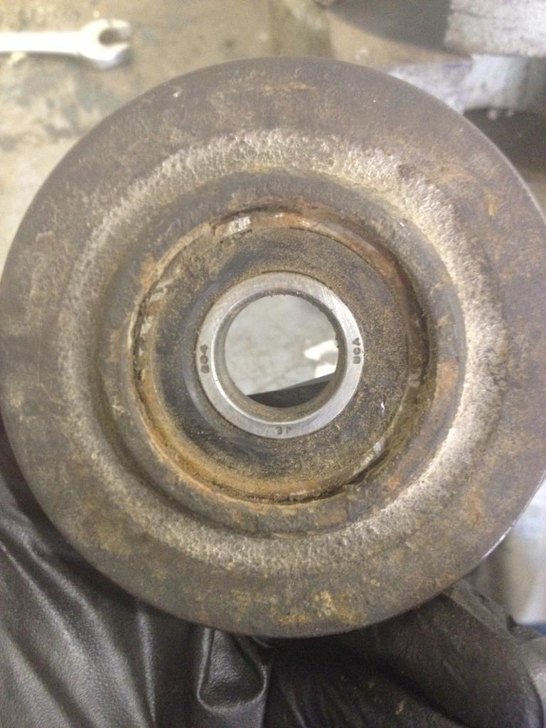

Well last week I started to get a frequent squeal from the drive belts. I figured it was one of the pulleys up front. I have been overdue on replacing my belts for some time now, and figure I would dig into it.
I started to remove the power steering belt and found the tensioner pulley was locked up solid.
It had no movement at all. So that was a quick find I thought.
Here is a pic of it. On the older style, you can actually service it and remove the bearing and install a new one. Kind of nice, rather than having to get a whole new unit.

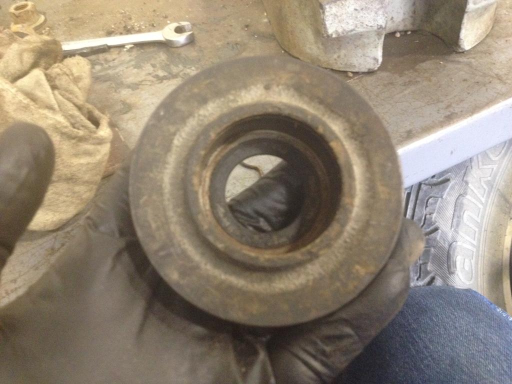

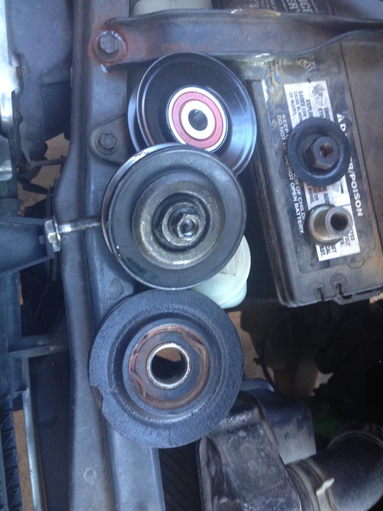

So when I called to get the bearing, they said they had a whole new pulley. Hmmmmmm. So I had them send one up.

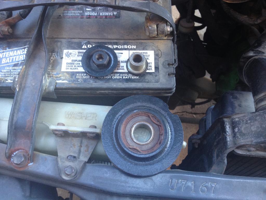

It was the newer style without the removable bearing. Has a smaller inner diameter. This can work, as the arbor/bolt that holds the pulley uses a bushing spacer to make up the difference.
I tried to get the new one to work but just could not seem to get it spaced right, and was taking forever. Plus I had to drive it home in a few hours.
Here you can see the bushing sitting on the battery.

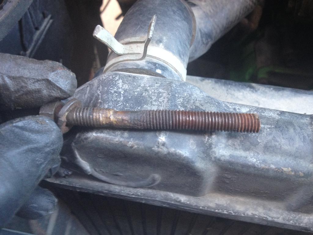

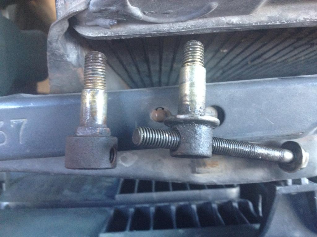

Check out the tightening bolt. It was all chewed up. So I went ahead and replace that.
Two different bolts, old style on left and new style on right. It's hard to tell but at the base they are different.

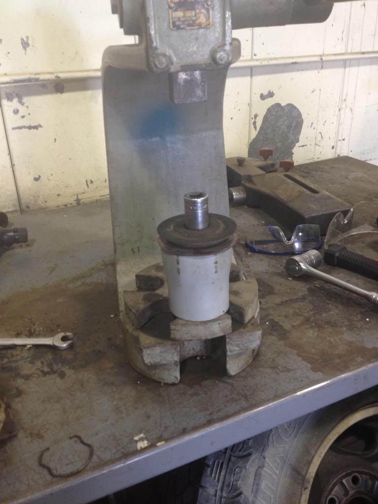

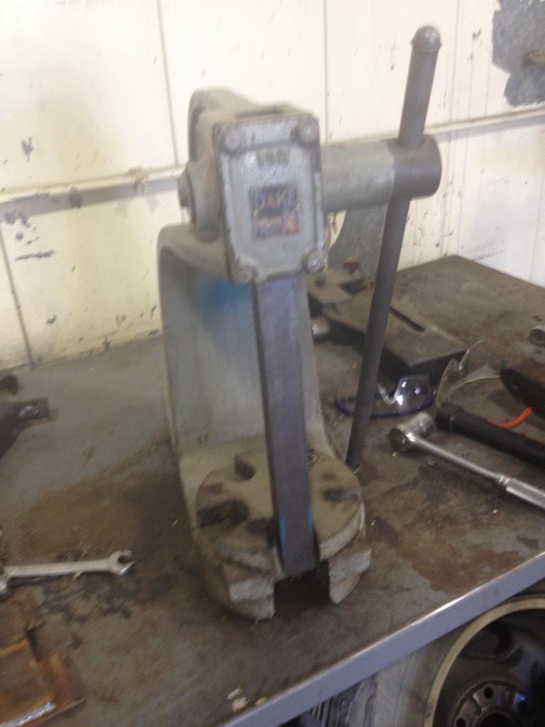

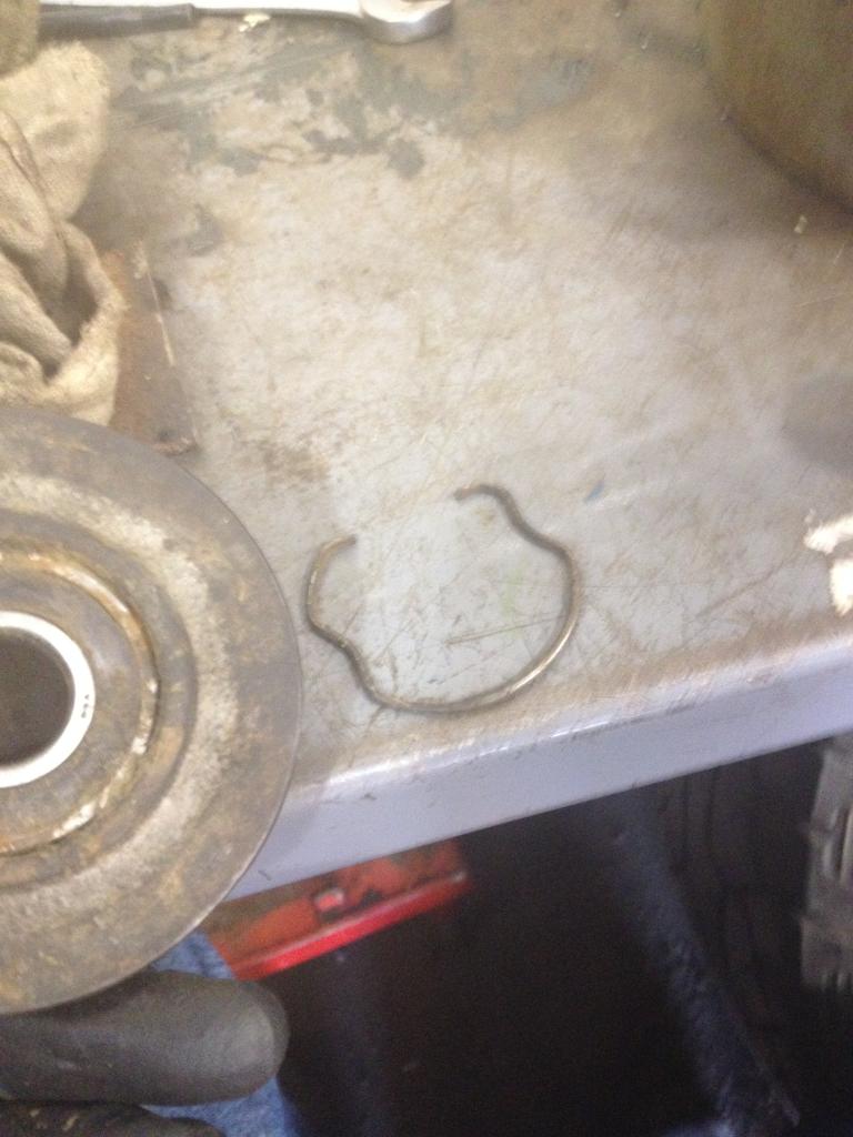

Got the arbor press out.

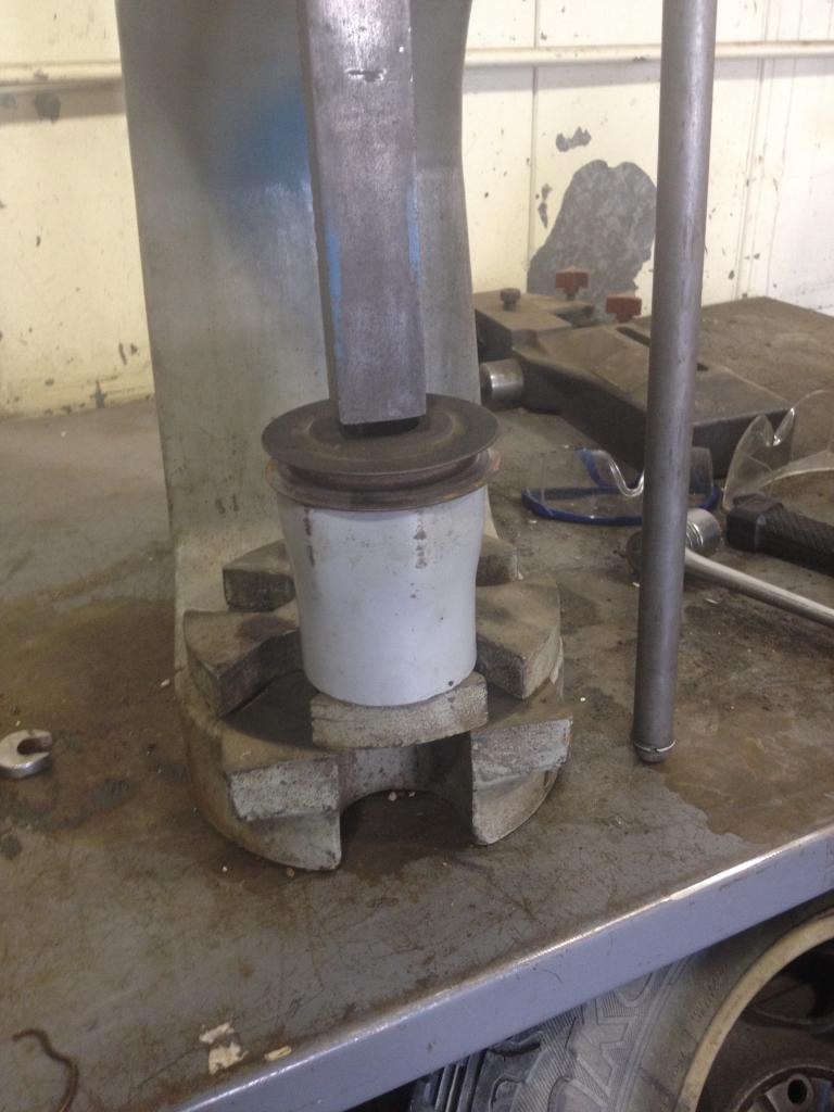

Removed the retaining clip

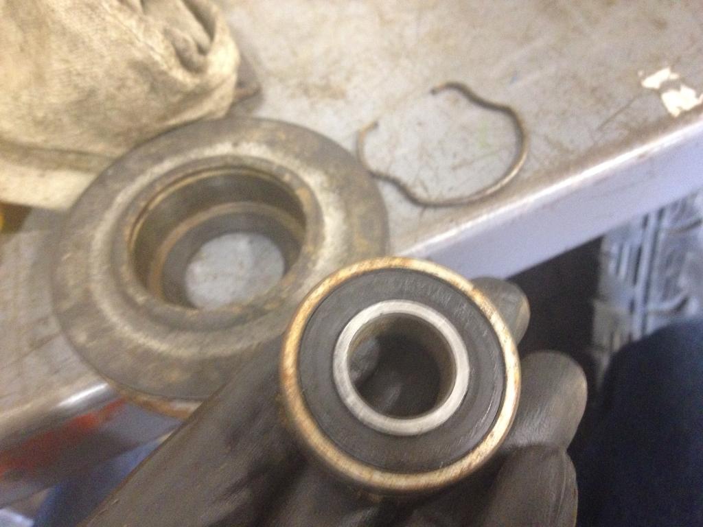

Shhhhh. I used a ford hub socket on the bottom.
Slid out like butter surprisingly

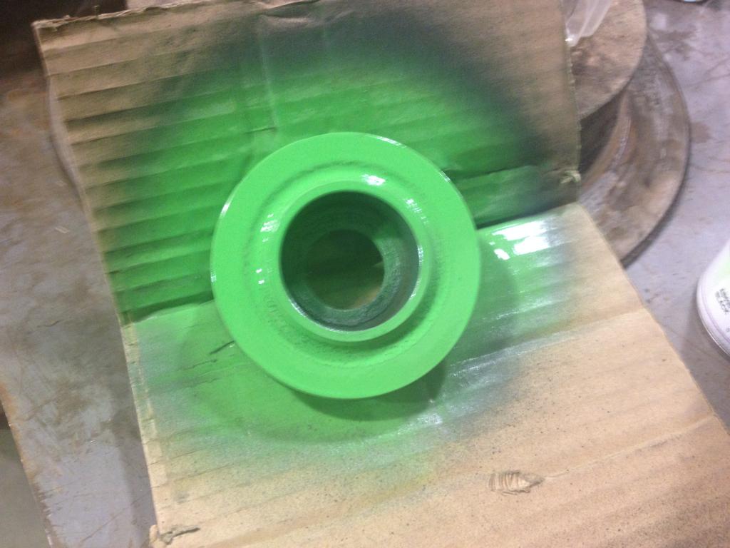

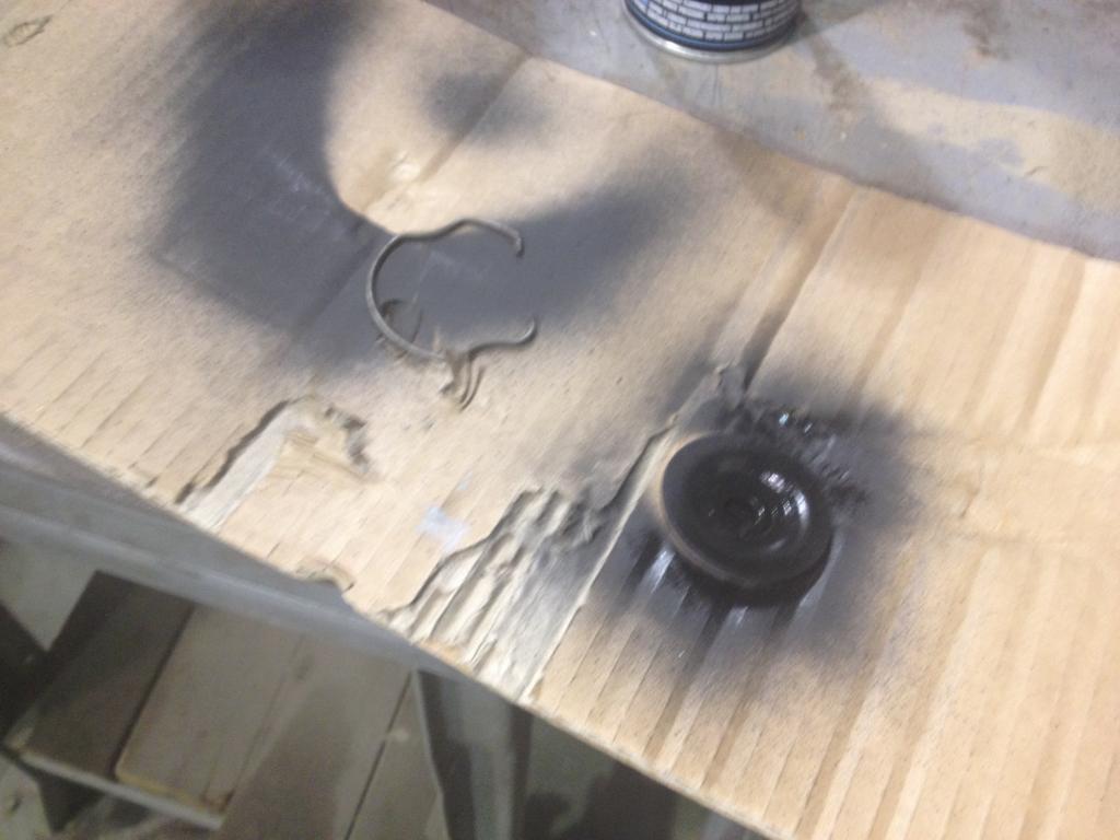

Had some green paint left over. Why not

Nice work, sounds like you caught it just in time! Thanks for posting up the differences between the older style tensioner and the newer style.

I had a bearing to go out and Toyota only sells the complete assembly. It is expensive!!!! Luckily I knew the bearing could be swapped out. Great write up.
