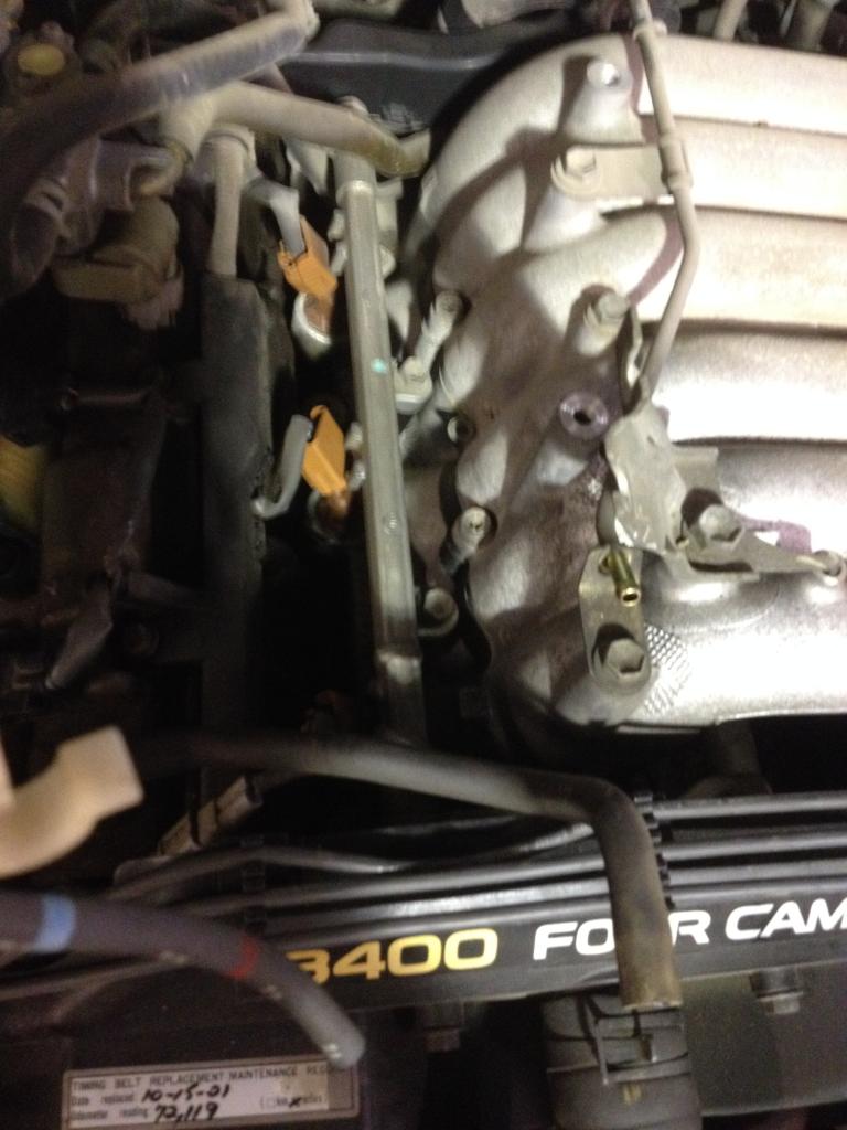

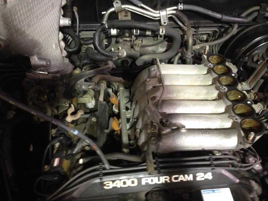

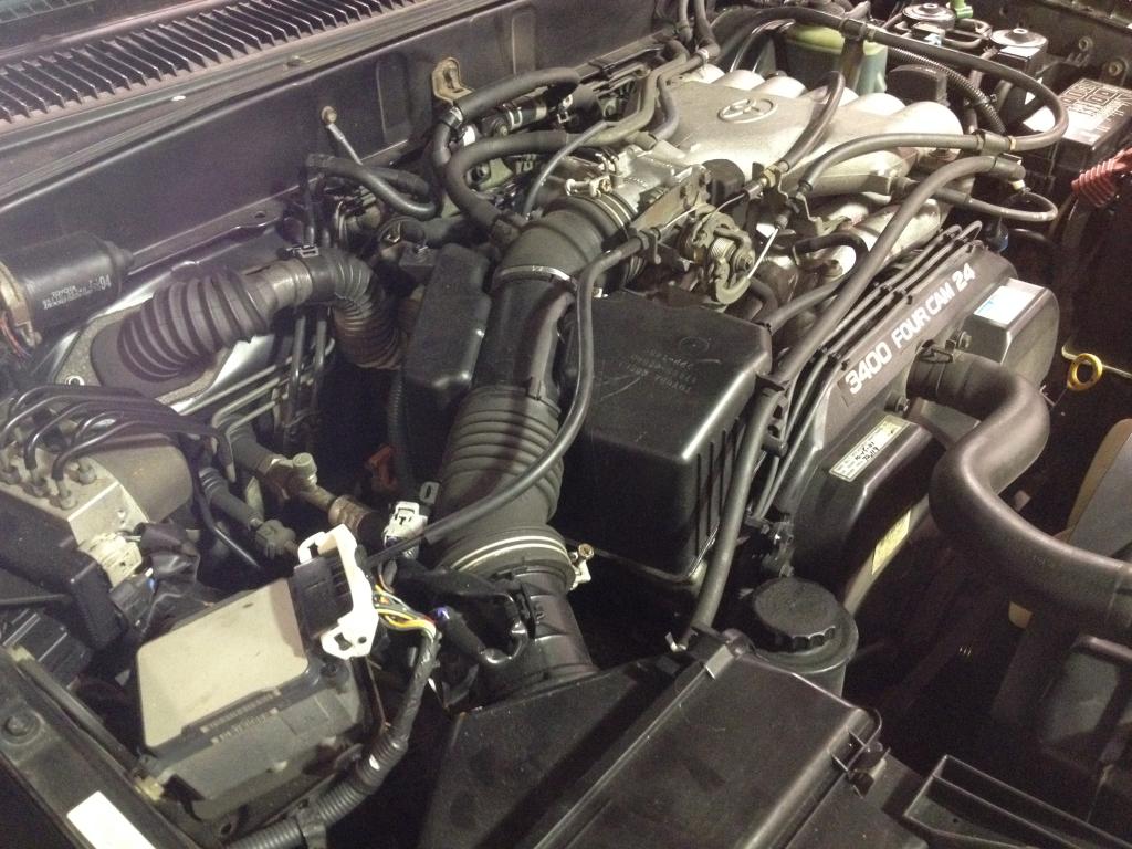

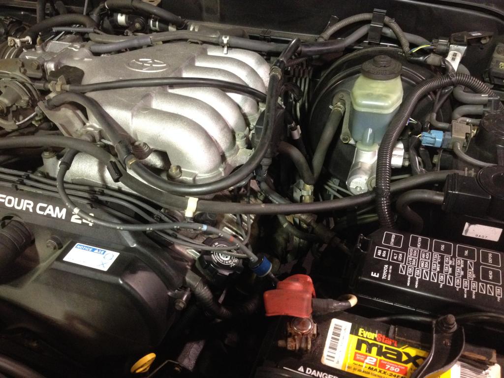

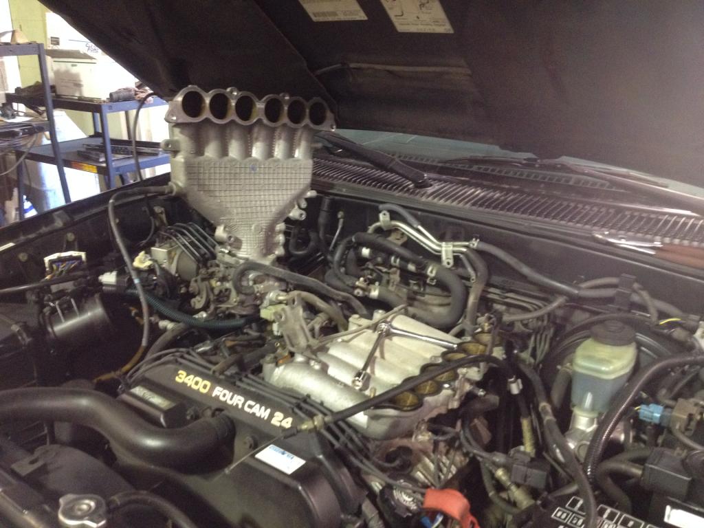

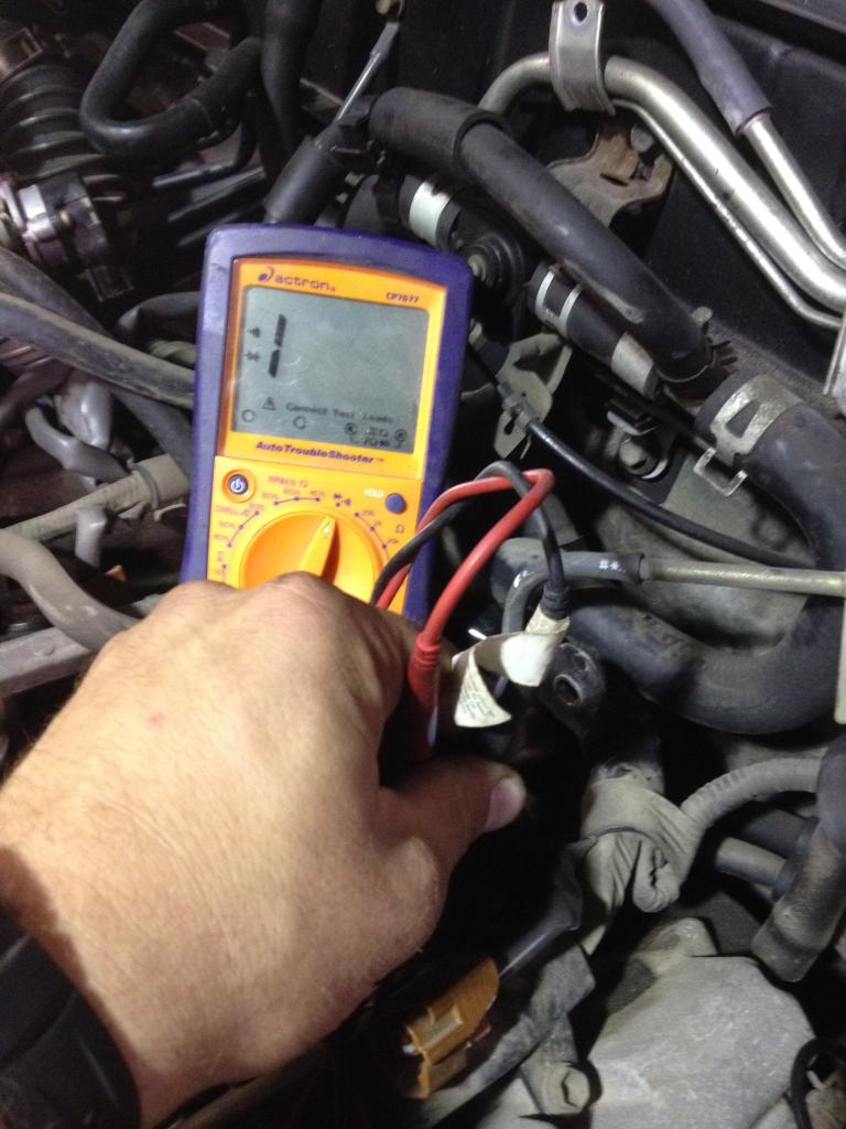

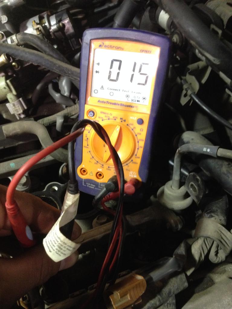

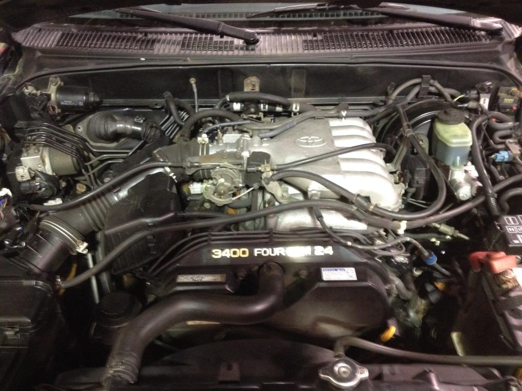

I have not really had the chance to work on it lately. I have been busy with a lot of other vehicles the last few weeks.
Lately I have been working on a 99 4runner that is a neighbor of chris's. It had a miss on cyl #6. He took it to get looked at and they swapped plug wires, coils, and plugs, and still had a miss. I tore it all down and ohmed out the injectors to find the #6 one was dead. and then the #2 injector has a broken nozzle.
Its all back together now and running great!
Here are a few pics.
Before

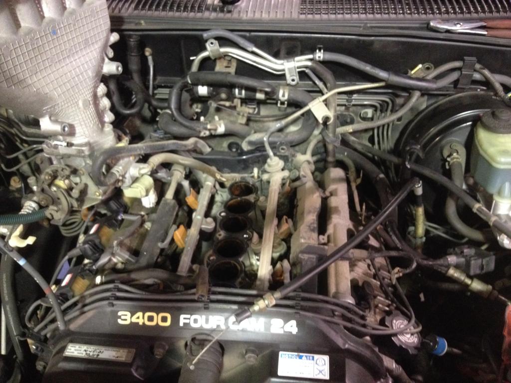

Found a nest under the lower plenum and thought that their might be a chewed wire.
There's the culprit #6 injector
And #2 Cyl for reference
This thing runs great and just purrs with 200,000 miles.
