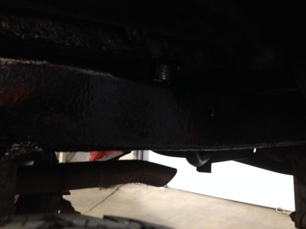

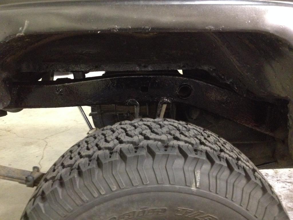

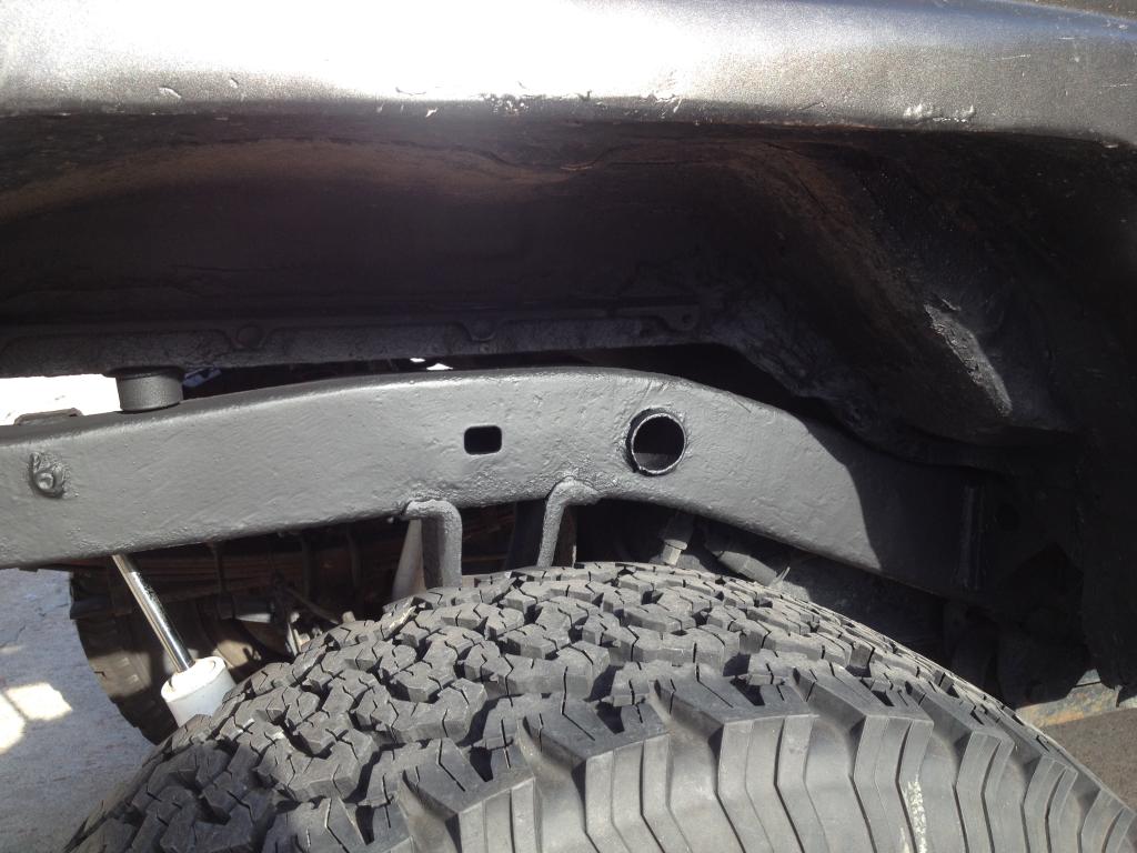

As winter is slowly approaching, I have been thinking of some things to get done in a hurry. One of those was to do a test run on the outside of the frame rails in the rear fender well.
I eventually want to do the entire frame, well everything I can get without taking the body off.
I used a flap wheel disc on the frame I get all the existing undercoating and crap off. Made it nice and smooth. Then I decided to slap on some POR-15.
Sorry for the blurry pics.
Put two coats on. From my own experience, you must put at least 2 coats on or it will still rust.
After that, I decided to put some black primer over and then top coat with flat black paint. I probably should have used gloss so dirt and mud would less likely stick to it. But I'm not a huge gloss black kind of guy.
Final product

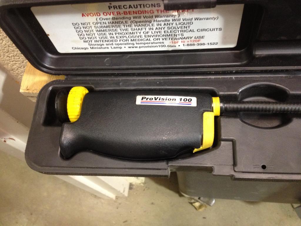

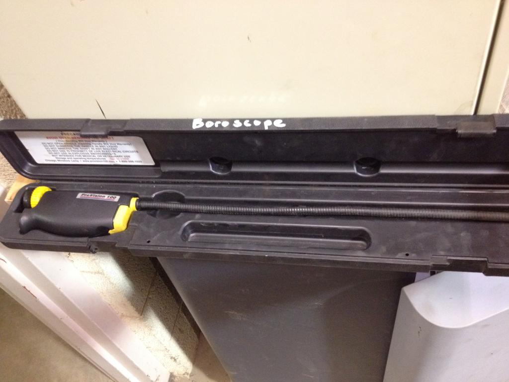

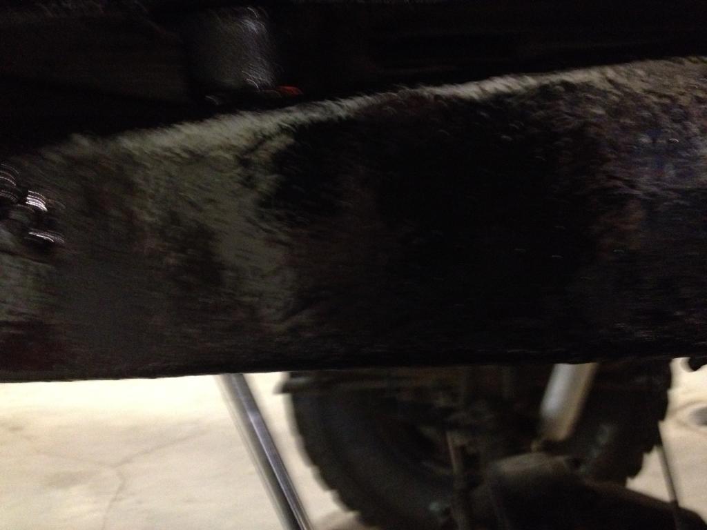

While I was poking around, I decided to stick my bore scope down into the frame to see the condition of it. I was afraid I would find some rot.
Much to my surprise, there was no rot in the typical area near the front of the rear leaf springs. Just typical surface rust.
