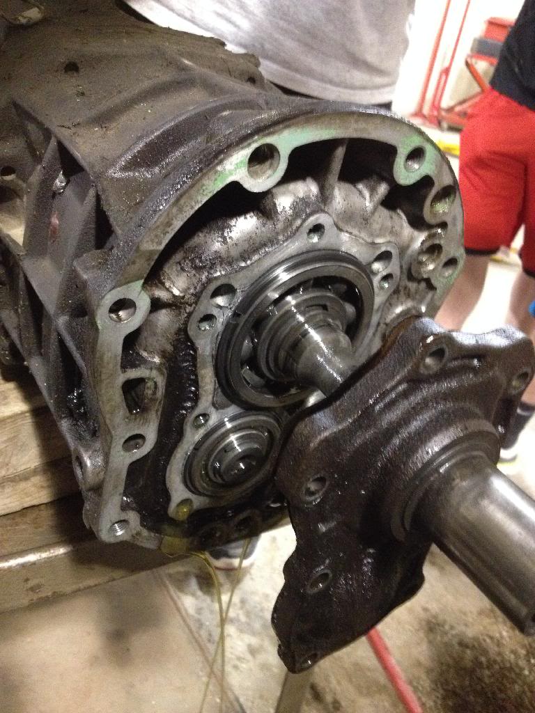

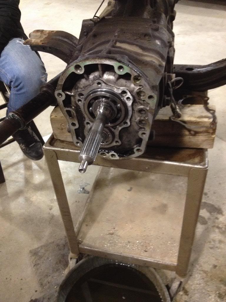

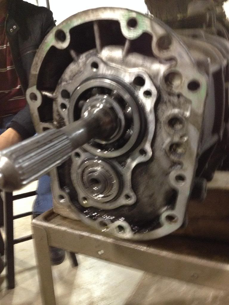

So I started to tear a little further into the Transmission today to tackle the input seal leak.
Removed the retainer plate

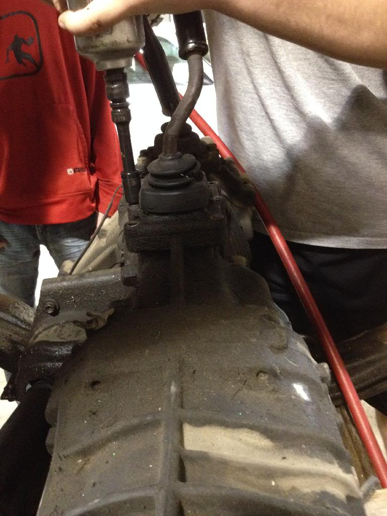

Had a student remove the shifter and he accidentally dropped two washers down into the transmission. Luckily I was able to remove them with a magnet.

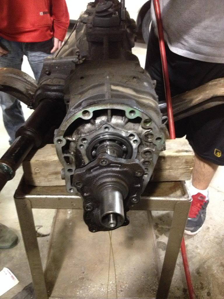

Totally removed and fluid draining.

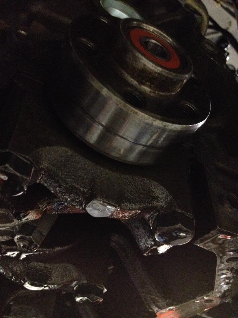

One question I have is to use anaerobic sealant or try to get the gasket that goes in between the plate and trans? I have some of the Permatex stuff

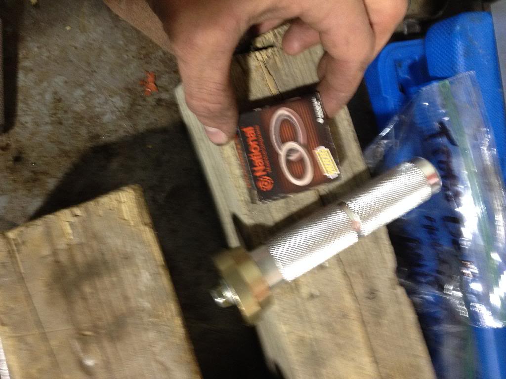

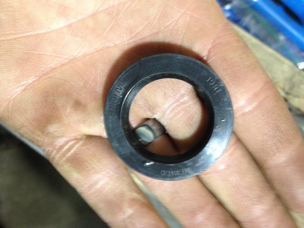

I also removed the old seal and picked up a new National seal from the parts house. Here are some pics for reference and the part number if you guys need is.

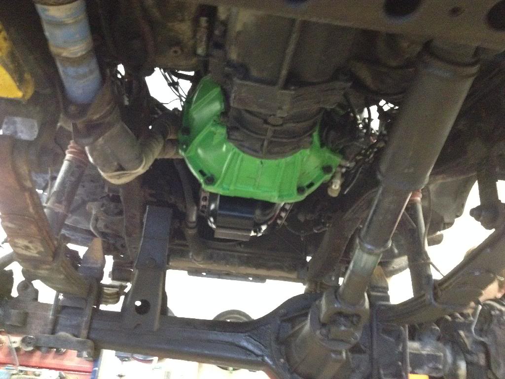

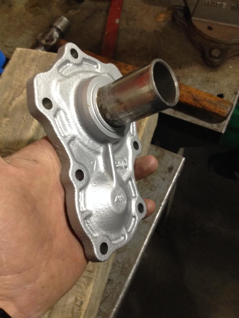

Decided to paint the housing.
Installer and new seal
New seal
National Part Number

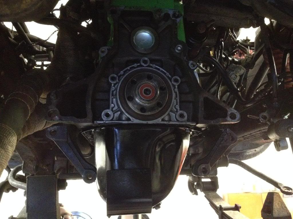

Got it all back together yesterday afternoon.

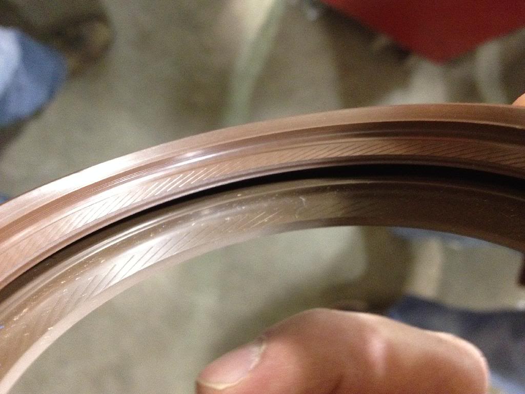

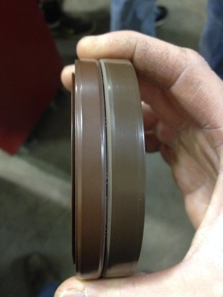

Very strange situation on the rear main seal. I decided to pick up an OEM seal. Big mistake that was. Actually a 35$ mistake. It absolutely did not fit tight over the crank. So much so that I could have fit a thin blade between it and the crank.
It was half the width as the felpro seal I had and fit nowhere near like the felpro did. Unfortunately I did not realize this until after I had already installed it into the housing.
Oem seal on left, felpro on the right (12$)
The inner seal lips wet a lot different also
Oem top and felpro bottom

Was surprised to see the Felpro was actually the better seal.

Really crazy that the 12$ felpro seal was way better than the (35$ at a discount) OEM seal.

Well, here we are a few days after the seal up attempt and it's dropping again from te back of the pan area when turne off. I'm starting to wonder I my oil pan is not messed up somehow.
I will say though, that the leak is nowhere near what it was before. Has a very very small drip.
