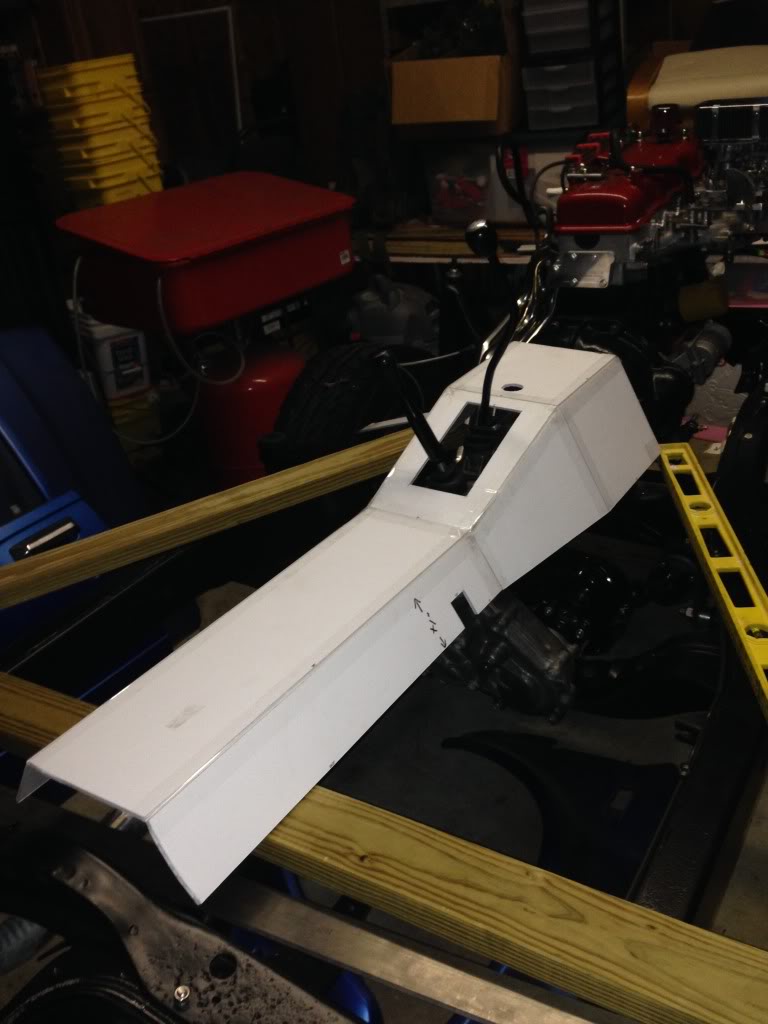

I took my foam core tranny tunnel over to where I'm storing my chassis to check for fitment over and around the transmission and transfer case. The front, wider portion fit fine, but the shorter and more narrow section was riding a little too close to the rear of the transfer case. I modified the design to extend the slope (above the shifters) toward the rear by 1" and made the narrow portion about 3/4" higher. That should do the trick. I'll do a final mock up once I get the floors tacked in.

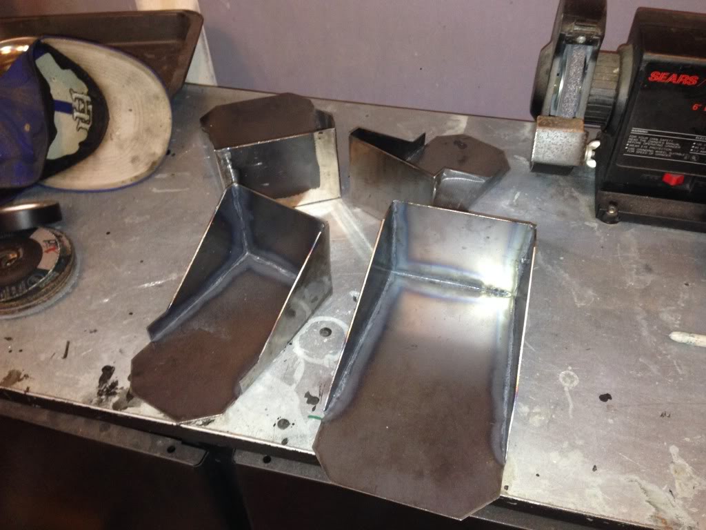

I also finished welding up the body mount brackets tonight. I got about two and a half of them done before I ran out of gas AGAIN! I think I got a light fill on my tank. It's a 80 CF tank which should give me over 6.5 hours of trigger time at 12 CFH. I MIGHT have had about 45 minutes on this tank. I'm certainly going to AirGas tomorrow to speak my peace about this issue. I ended up finishing them up without gas so I have a little more cleaning up and grinding work to do now.

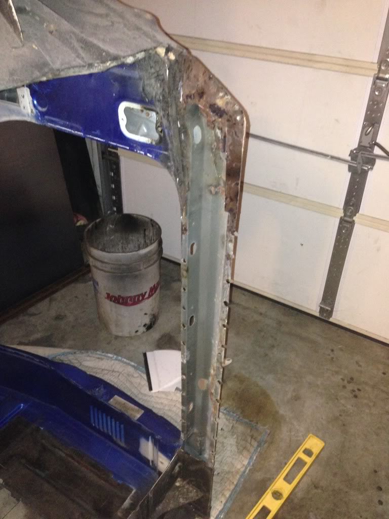

Hey Corey, what did you do or use to make that ledge on the inside of your rockers for the floor pan to sit on and weld to in your picture below?
Looks like the back side of my rockers are the only bad metal left. I started cutting out the back side of the rocker panels tonight so I'm trying to get a game plan together. I was just going to weld some 14ga steel to replace what I removed, but I wanted to make sure that I have something solid for the floor pan to rest on and weld to. I could quite see exactly what you did in your thread.
Looks like the back side of my rockers are the only bad metal left. I started cutting out the back side of the rocker panels tonight so I'm trying to get a game plan. I was just going to weld some 14ga steel to replace what I removed, but I wanted to make sure that I have something solid for the floor pan to rest on and weld to.

I finished cleaning up the welds on the body mount brackets today. They turned out fairly well despite not having gas for half the welds.

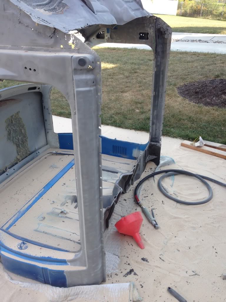

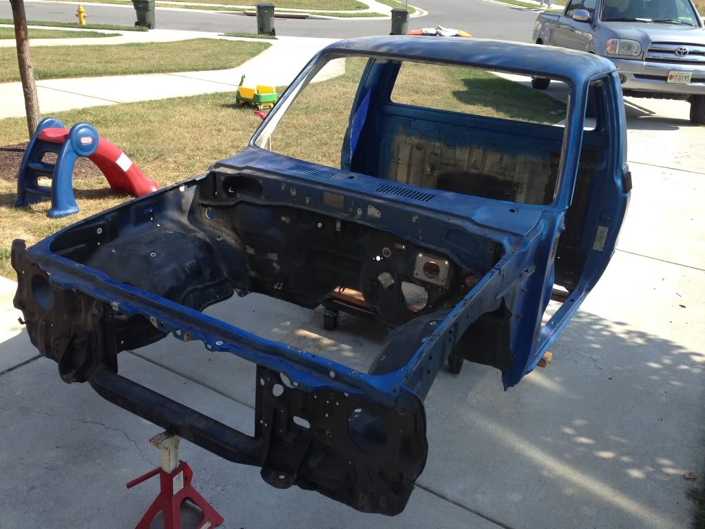

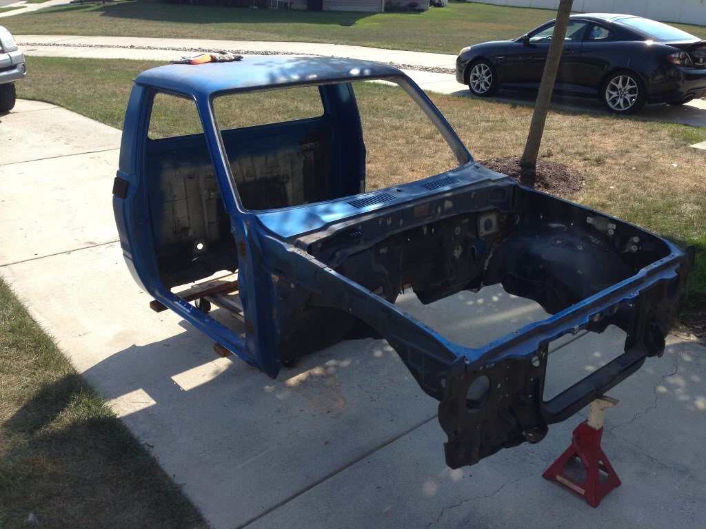

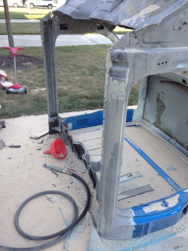

I rolled the cab out of the garage for some sandblasting this weekend. I just sandblasted the inside and outside of the rocker panels and any portion of the cab that I will be welding the floor to soon. I didn't want to sandblast the whole thing until I'm ready to throw on some sealer to protect the metal. Here's what its started like:
And after:
No major surprises other than the driver side rocker panel having a couple of spots rusted through about mid way back on the rocker panel. The PO actually didn't do a bad job on the filler in that area, but I blasted it off anyway to repair again. It's not bad enough to have to replace the actual rocker panel though. My primary areas of concern are the rusted out areas around the front cab corner where it meets up with the kick panel. I'm going to end up cutting that section out and replace it with new sheet metal that runs about 2 inches up the kick panel and down to the bottom of the rocker panel. Shouldn't be too bad (famous last words).
And after:

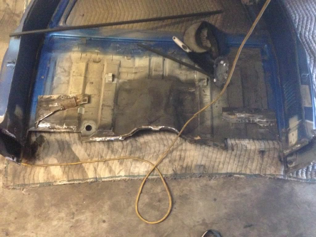

Well as expected, the surprises keep coming. I left the rear of the floorpan attached so that I could keep the rigidity of the cab until I was closer to installing the new floor pan. Today I was looking at it and noticed some bondo on the rear cab wall. Soooo... after cutting out the last section of the floor pan I ended up cutting a small section out of the rear cab wall on both sides.
Here's the before with the floor pan stil intact:
Here it is after cutting it out:
You can kind of see the bondo on the passenger side (left in the photo). The driver side wasn't as bad as the passenger side. The PO sure did like slapping some bondo down. All of his "repairs" consisted of welding in a sheet of 14ga steel with what appears to be stick work and then covering it with a handful of bondo. He didn't even bother cleaning up his patch work. What amazes me is that the sheet of steel that he welded in was somehow inserted between the rear cab wall and the rear passenger side body mount. I have no clue how he did it unless the factory spot welds failed. Nonetheless, I made some templates so that I can cut some patches out of 16ga steel to weld in.
My son went to bed early tonight so I had to do some quiet work. I decided to do some light cosmetic work with the welder. I fixed some small rust holes on the driverside rocker panel. There were 4 of them about 2-4 mm in diameter. The rust was very localized so I was able to build up a weld around the holes from the inside and outside of the rocker panel so I could build my welds inward until the holes were closed without blowing through the metal. I also welded up the seems where the rocker panels meet the rear of the cab near the back of the doors. I'm just going for a nice seemless look where ever possible. I'll get some pictures after I grind the welds down
Next on the list I plan on cutting and welding in the back side of the rocker panels and the ledge that the floor will sit on in order to get the rocker panels more rigid so I can flip the cab down and move it around without worrying about bending up the rocker panels.

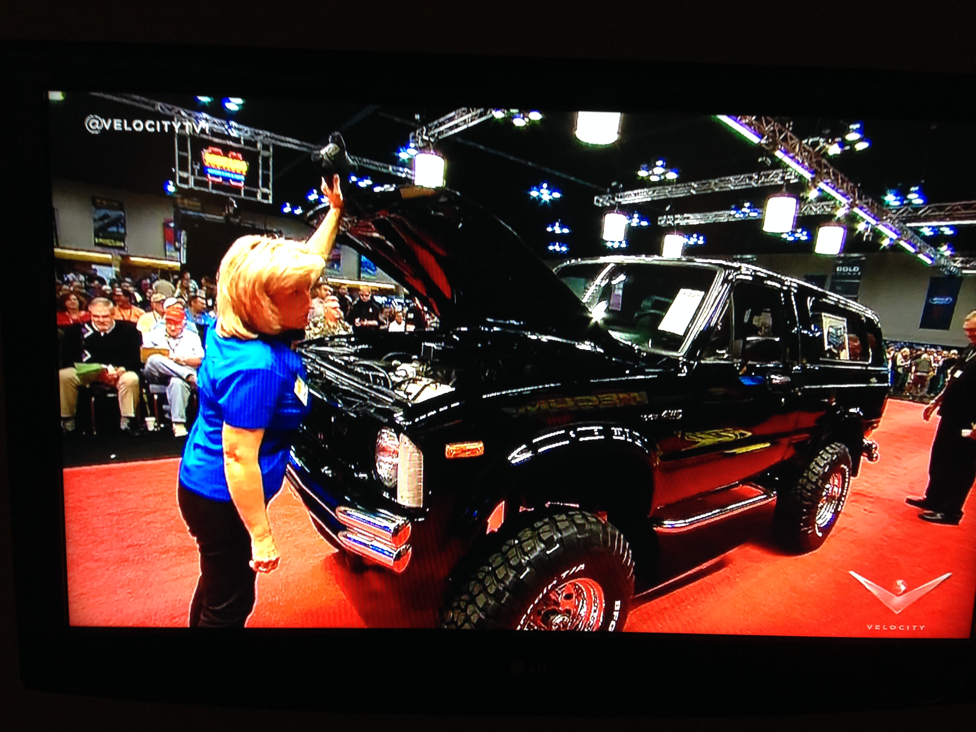

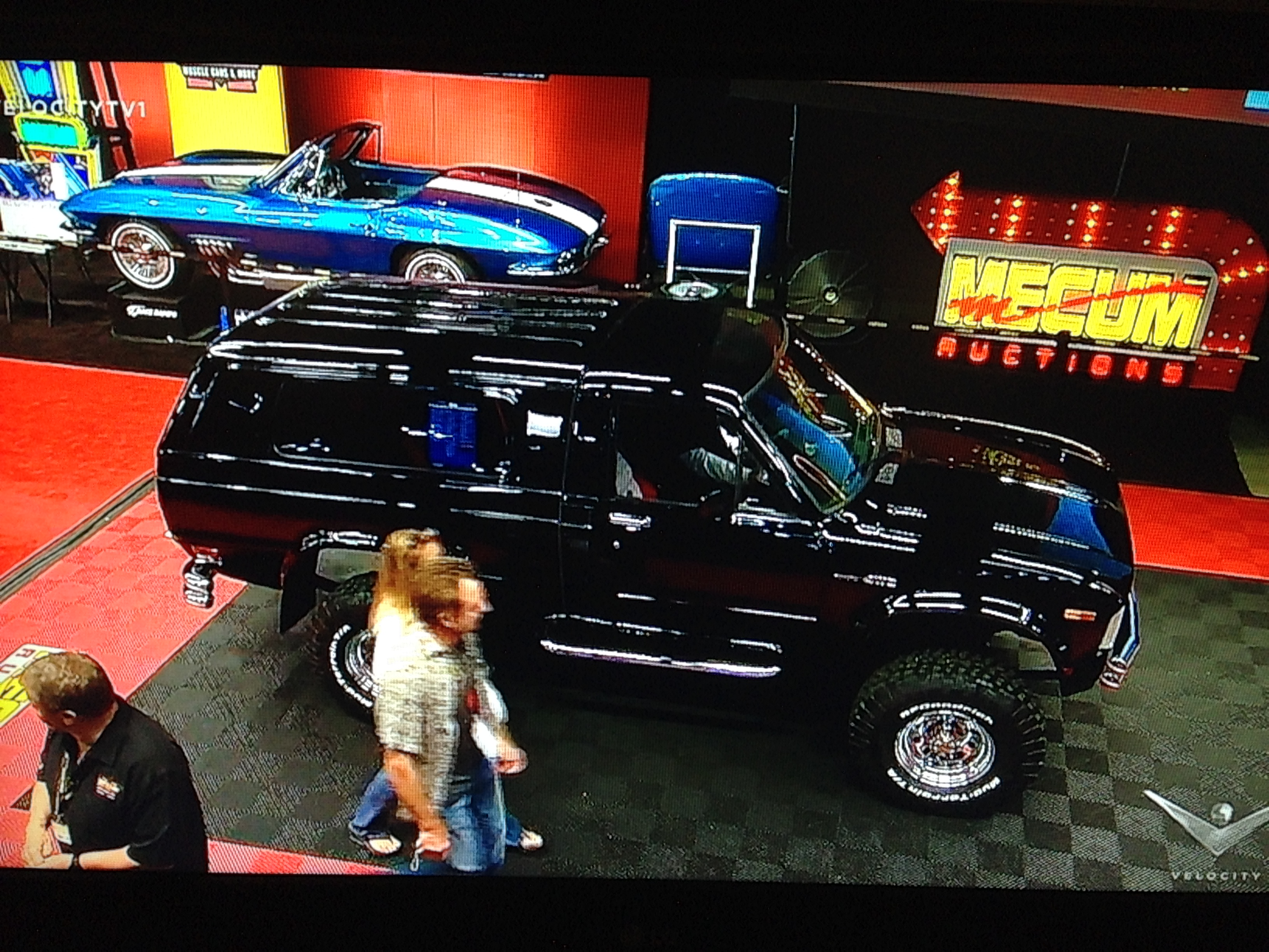

In other news, as I was sitting here typing this post, a 1981Trekker went across the block at the Mecum auction in Chicago! The bid got up to $13,500 but it didn't sell. Check this thing out (of course I took pictures of the TV), it's really well done:
