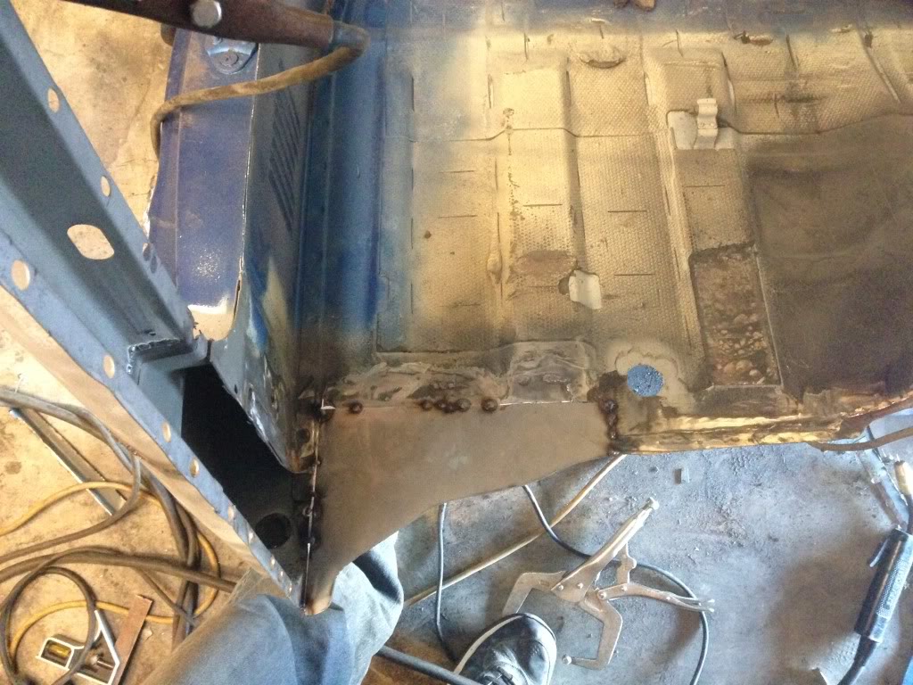

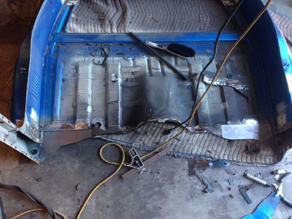

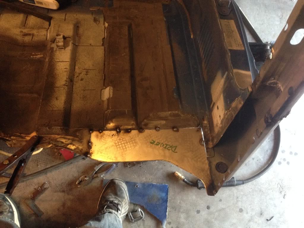

I cut out the patches for the rear of the cab. They were cut out of 16ga steel to match up with the thickness of the factory metal which seems to be a thin 16ga or thick 18ga.
I then tacked them in:
I had to slowly weld the patches in using series of tack welds so I wouldn't burn through the steel. I used .030 wire in my welder, but I should have gone out and got some .024 wire. Just roughly welded in the patches from the inside - I'll do the clean up with the grinder after I touch up the outside.

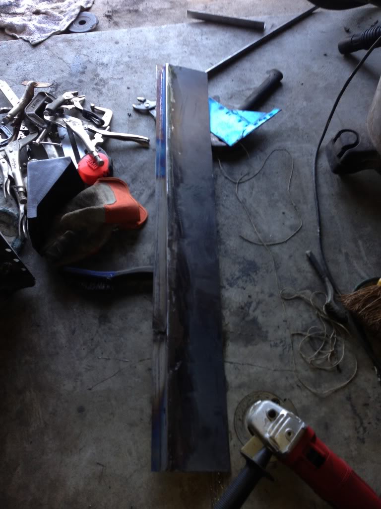

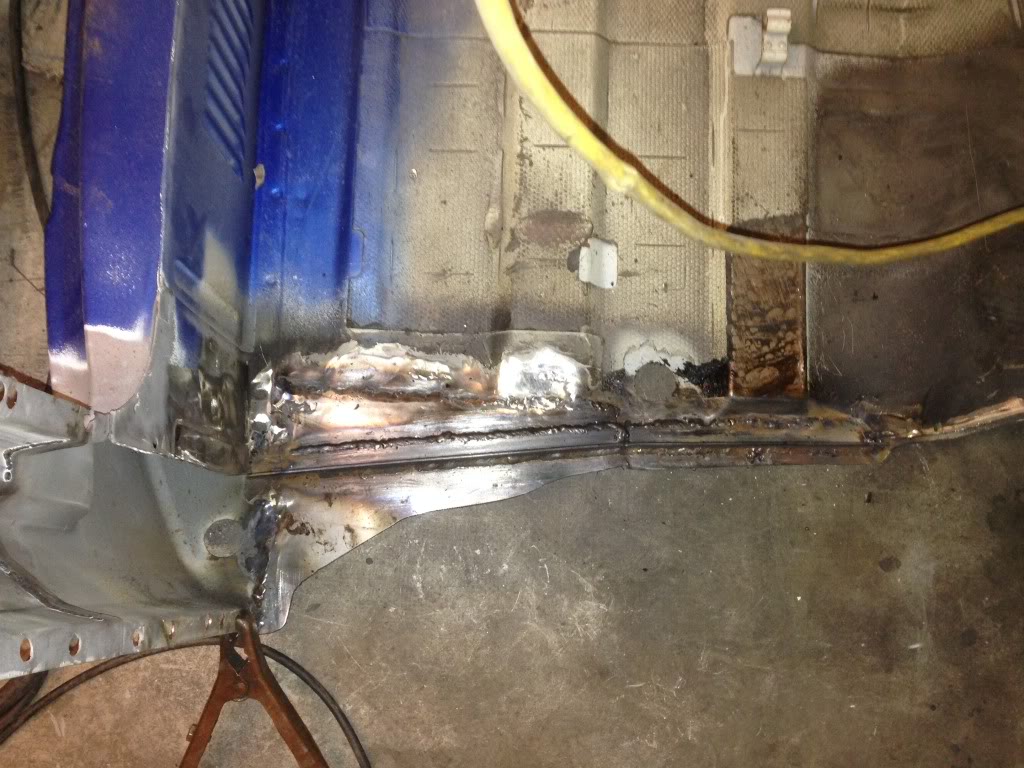

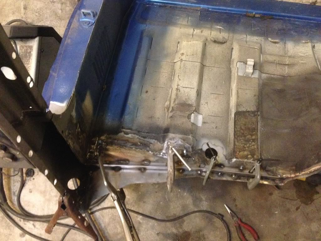

I then used some 3/4" angle stock to create "ledge" for the floor pan to sit on. The last approximately 8 inches of the floor will be angled upward toward the tunnel to allow clearance for the center cross member. The rest of the floor will be flat so the angled section will actually help provide some structural rigidity to the floor.
Here are the ledges tacked in:
And burned in:
My welder has been giving me hell - I think my wire feeder motor may be going up so my welds are all kinds of jackedd up and uneven. They are still good enough, but I'll clean everything up later. My goal is to get everything assembled this weekend, the cosmetics can come later.

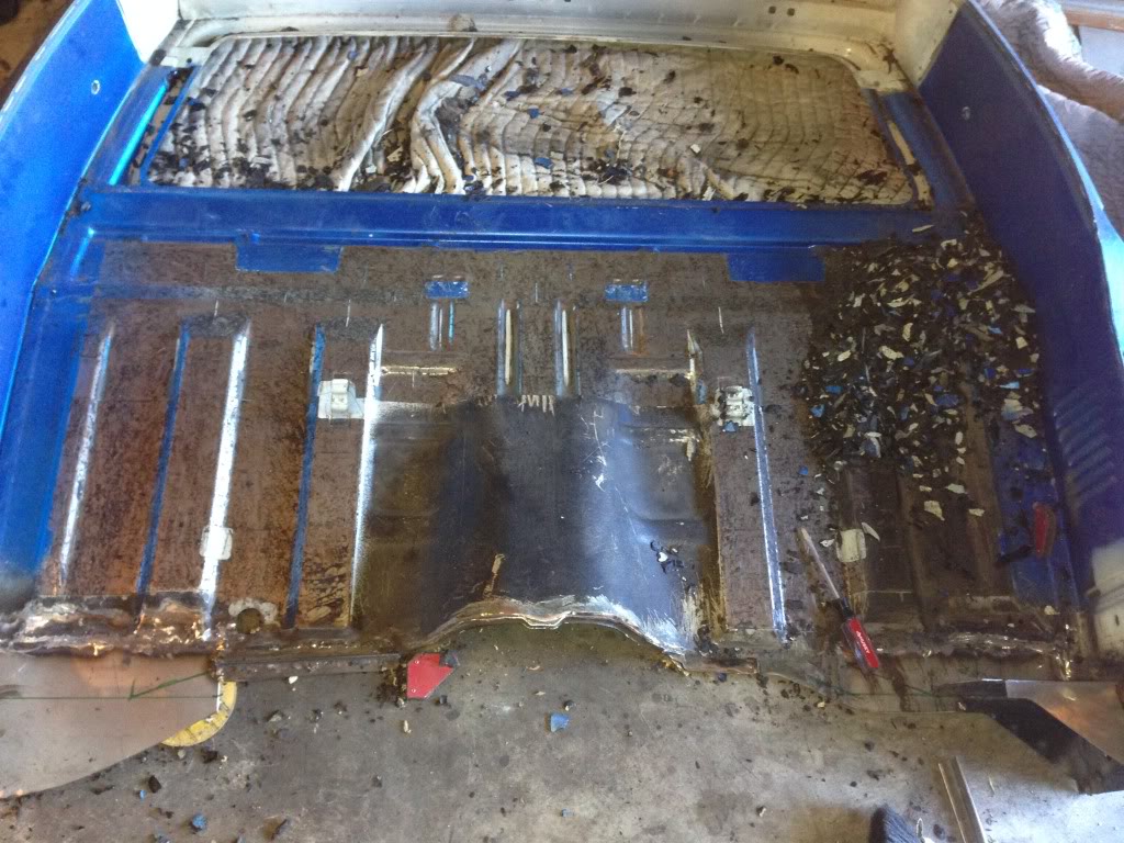

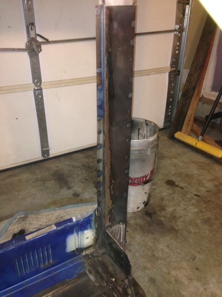

I was getting sick of the burnt sound deadener smell so I scraped all that off:

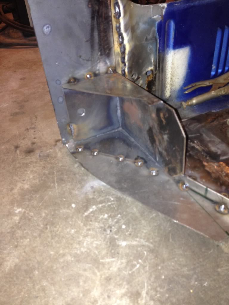

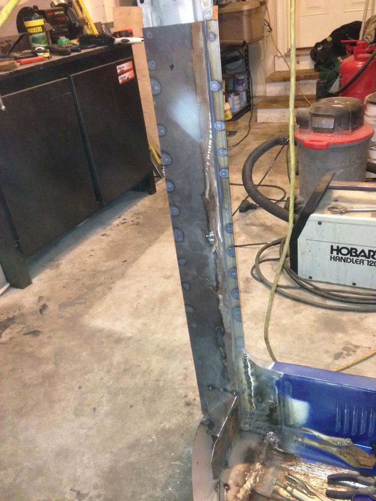

Welded up the panels for the back side of my rockers. Just use some 1" angle stock and 14ga sheet steal. Mock up was pretty crucial to get the panels to sit properly so that my body mounts go on level - took lots of clamps:
Fast forward a little and here are the results, just tacked in where the spot welds were drilled out:

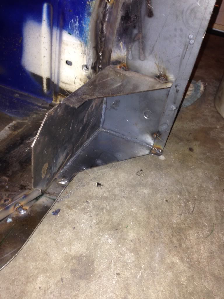

Tacked in the body mounts that I made a few weeks ago:

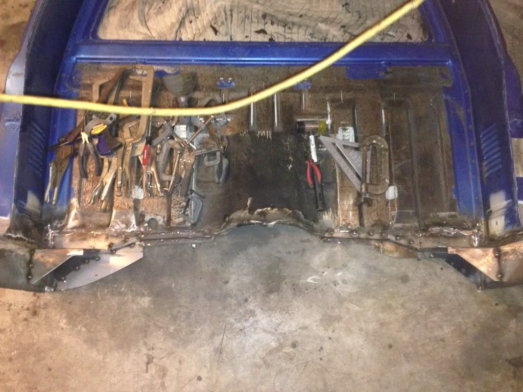

Used some 3/4" angle stock to make a "ledge" for the floor pan to sit on across the rear wall of the cab (notice my plethra of clamps - you can never have enough clamps!):
For right now, everything is just tacked in. I want to shoot it again with the sandblaster before I burn everything because I was getting some contamination in my welds from old seam sealer, paint and sound deadener (you can see my "burnt" weld in the pictures). Not to mention, seam sealer smells awful when it is burnt!
The backs of the rocker panels still need to be trimmed up even with the door sills and the bottom of the rockers, but I'll probably do that after I get the cab set up enough to roll around on wheels so that I don't bang it all up moving it around. I also only ran the rear patch of the rocker panels up to the front of the door opening. I plan on tying in my floorpan "ledge" with the kick panels as I have some bad metal in there to replace as well.
All-in-all, it was a productive weekend - I finish everything that I needed to get done. At least now I can move it around without worrying about bending up the rockers.
