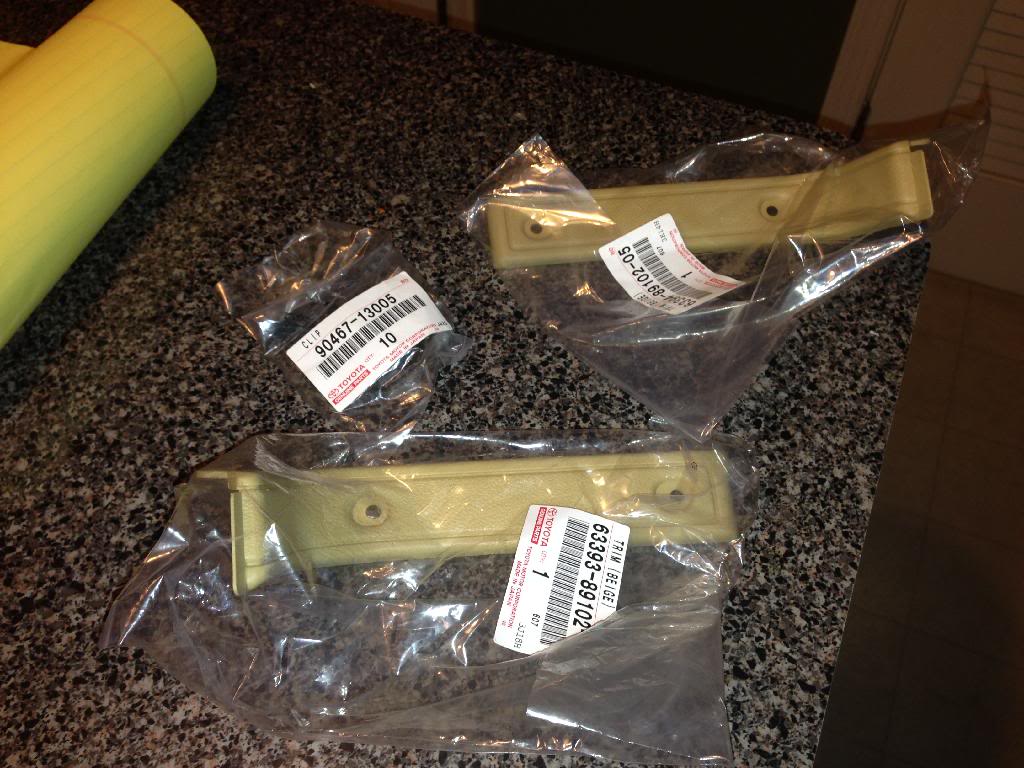

Got a couple parts in today. New old stock headliner trim pieces and a grille clips! The trim pieces will probably be painted but they perfect new quality, gotta love it! I'm still a good bit away from needing these parts, but I've got to buy them when I find them or they'll be gone when I do need them.

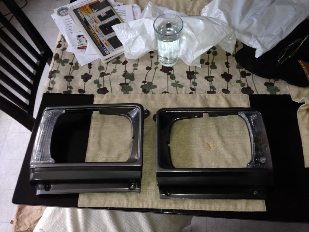

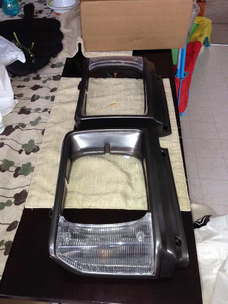

OK, rant over. So I had to head home during lunch to get some information for said application above and I was slightly cheered up by a brown package on my front steps! Earlier this week I rolled the dice on a set of replacement headlight doors (Not factory Toyota) since they were only $70 for the pair. I figured it would be worth the gamble. Opened them up when I got home and they weren't too bad. They are pretty much just like the factory headlight doors, in fact they seem a little more sturdy and less brittle. The only downsides that I saw was that the corner lenses were kind of cheap, but I'll probably just replace those with some new old stock lenses and the corner light wiring plug does not match the factory plug, but I'll be able to splice the factory plug on to it with no problem. For right now, it looks like I will be going with these (probably painted black) unless I can find a set of really nice chrome headlight doors. Here's what they look like:

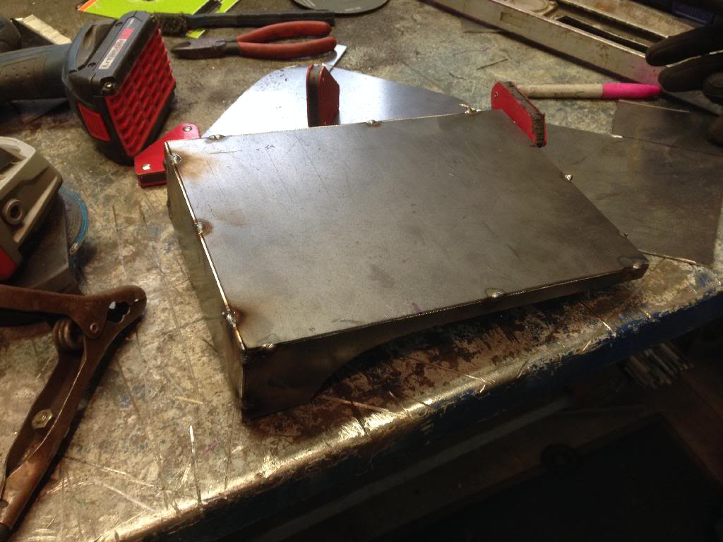

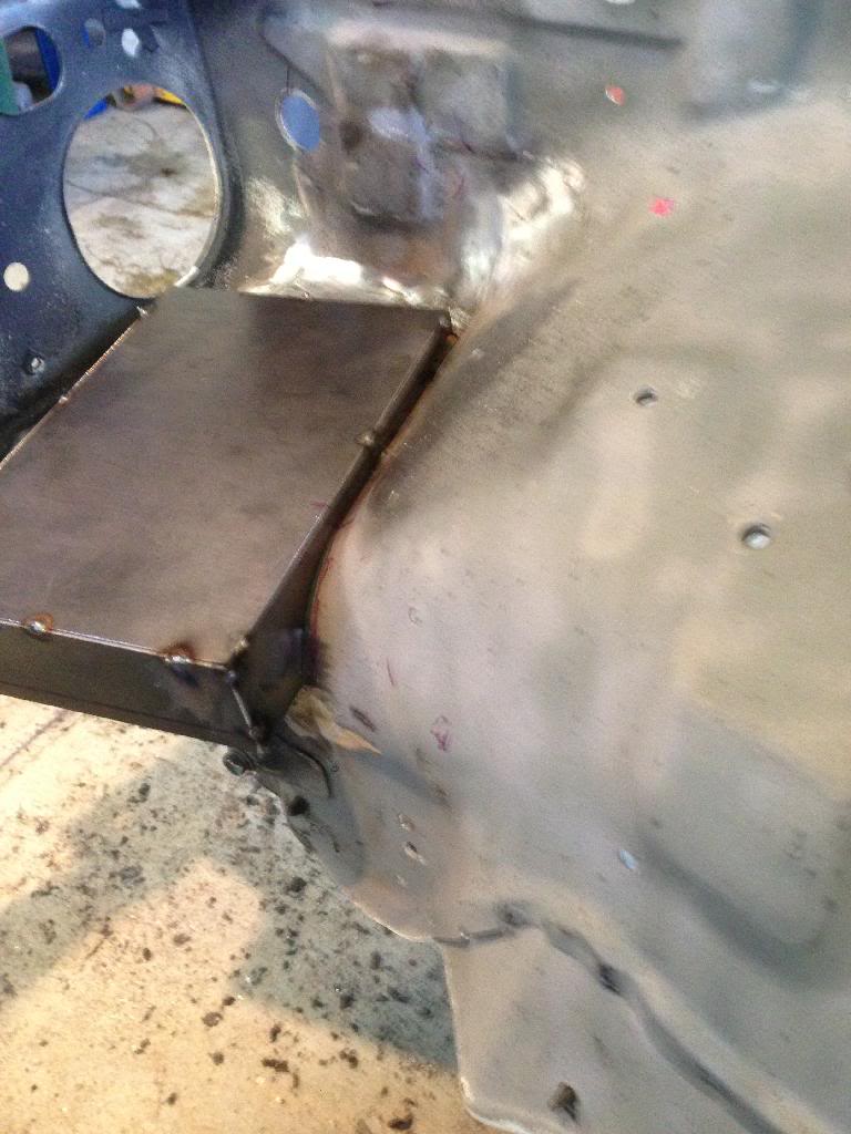

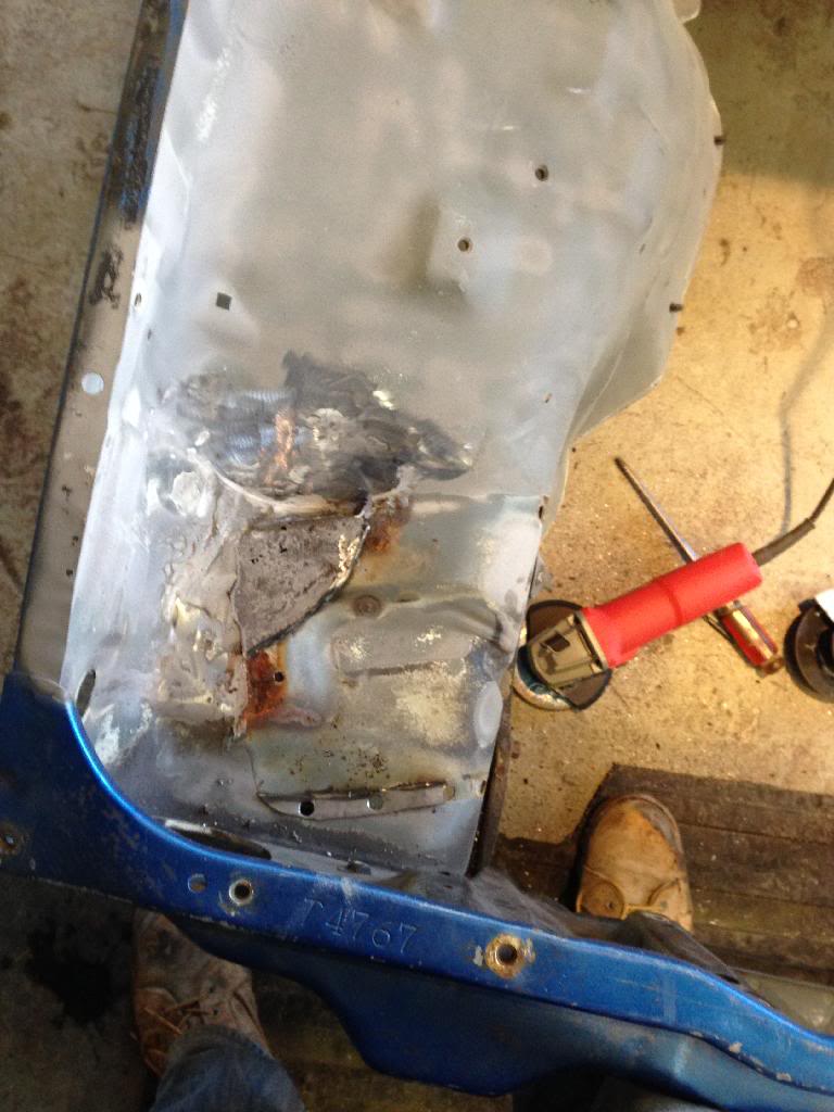

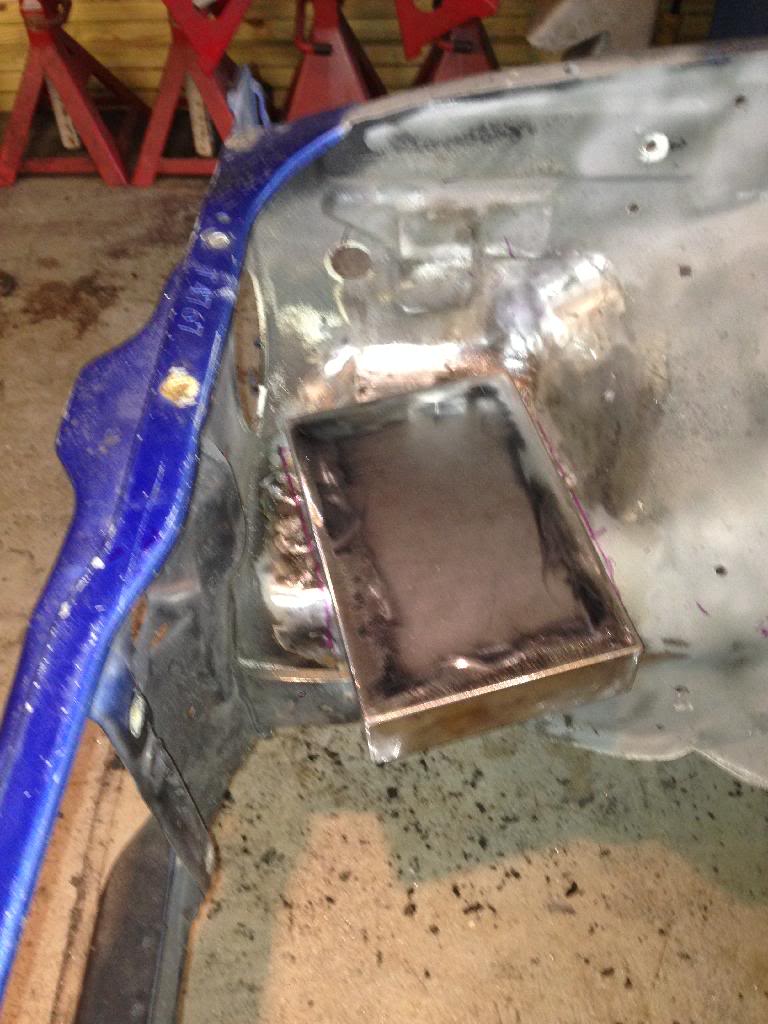

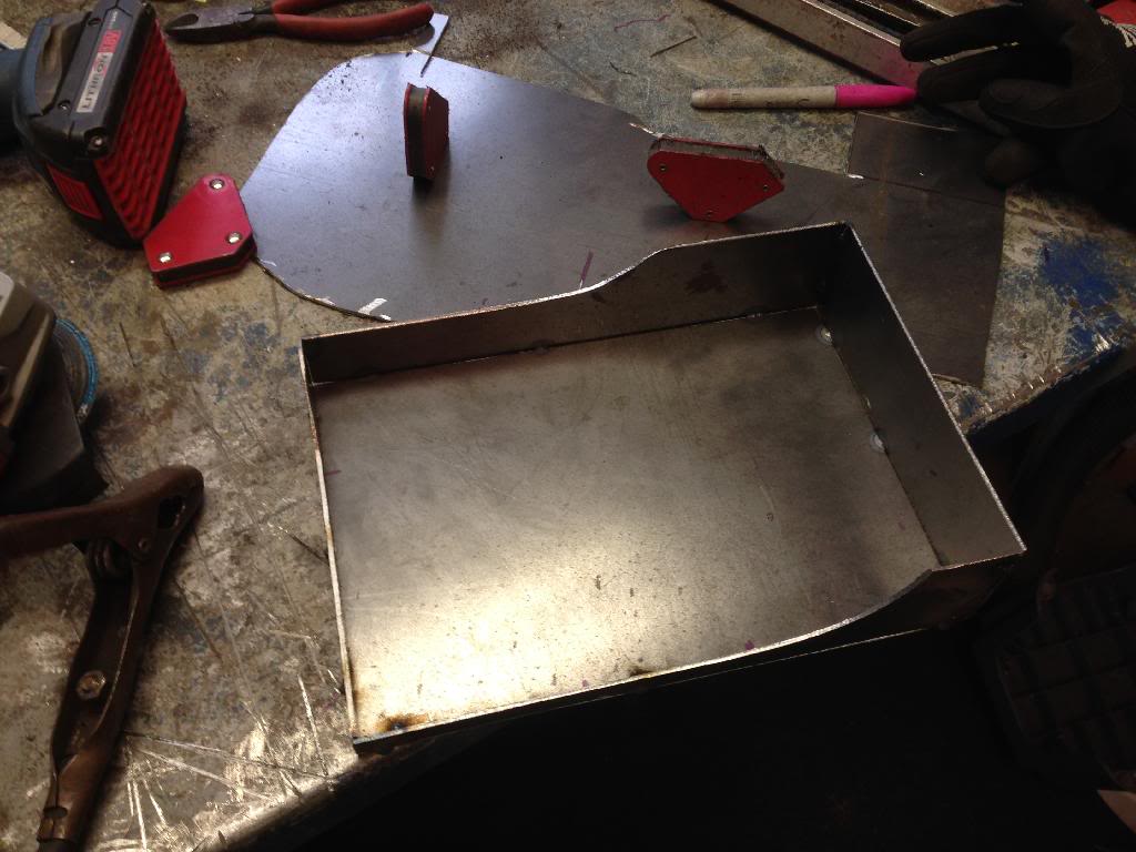

The wife and kid are out of town and the weather was rather mild today so I was able to get some work done. I got a lot of the welds dressed up today but I still have about half left to do - should be able to wrap them up tomorrow. I'll get some pictures up once I have them all done. I also decided to tackle the battery tray "shelf" today. It was rusted out pretty badly and the PO decided that slapping some bondo over it would cure the problem (he was wrong). There was also a peice of steel welded and bondo'd over on the under side of the inner fender below the battery tray. It looks as though there was a donor truck at some point in time that the steel was cut out of to do the repair. I'm going to leave it there, fix the welds around it and smooth it over since it isn't going to be easily seen, but at least it will be addressed.
So here's the battery "shelf" as I was cutting it out:
After I cleaned up the metal and removed the globs of old bondo I began mocking up and fabricating the new battery shelf:

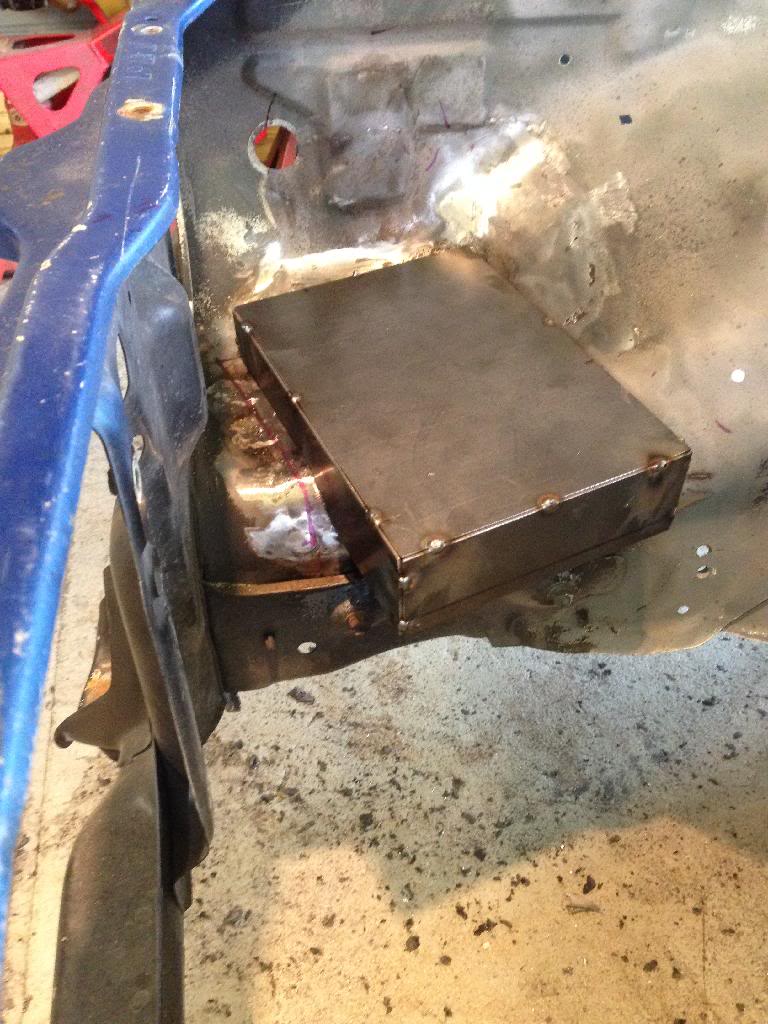

A quick test fit (I was quite impressed with myself in getting the curves right so it contoured the inner fender and sat flat. Three of the four sides had curves incorporated in them in order for it to sit right and I nailed it!):

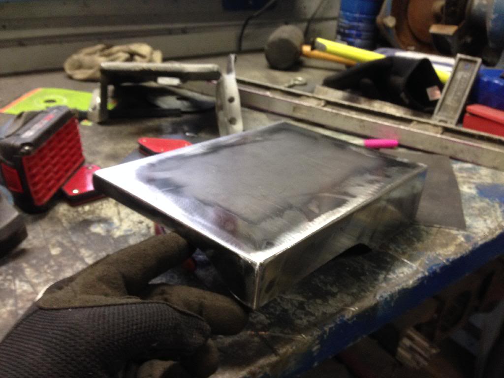

Welded up the seams and ground down the welds:
And finally burned it into place:
I forgot to make a hook or some way to tie down the battery, but I'll figure something out.

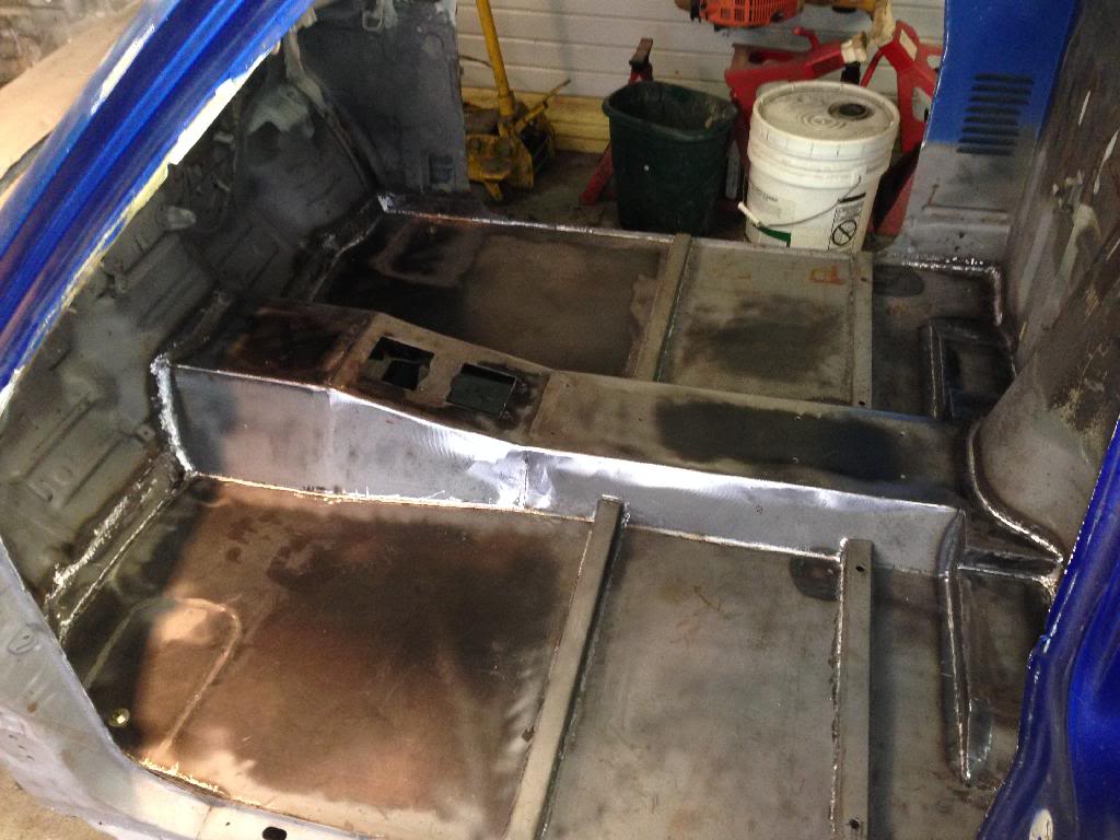

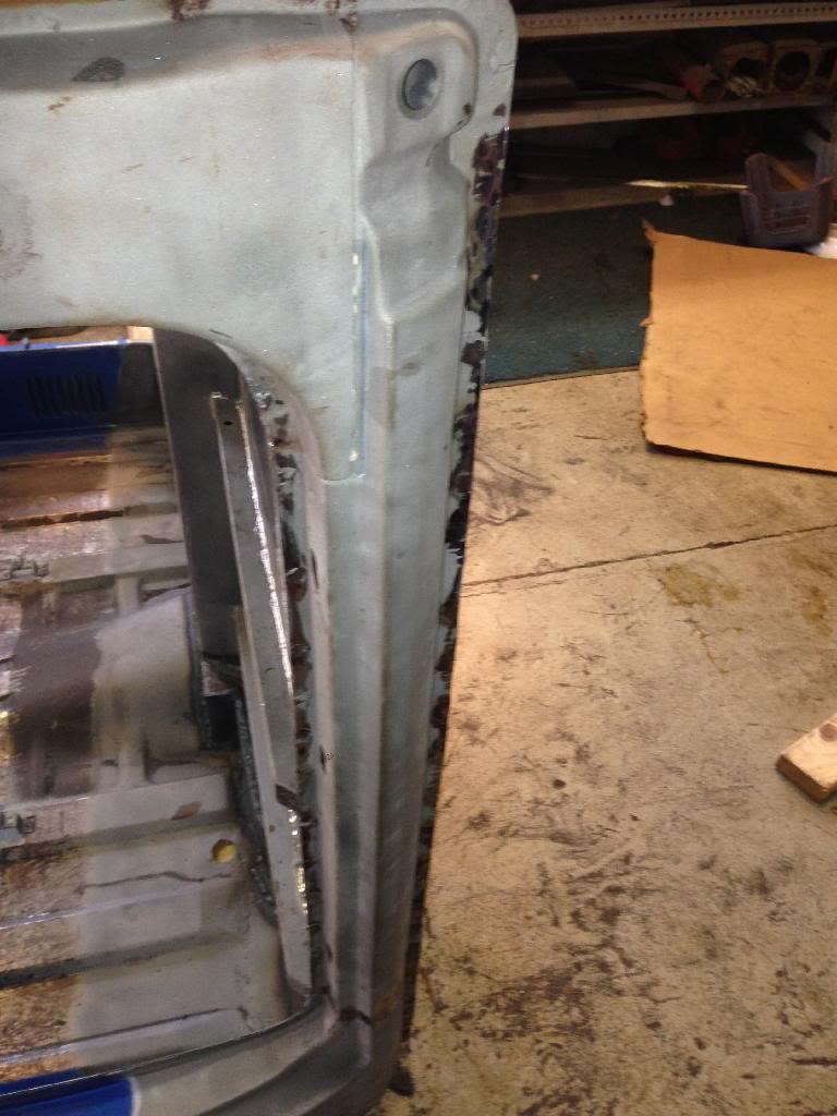

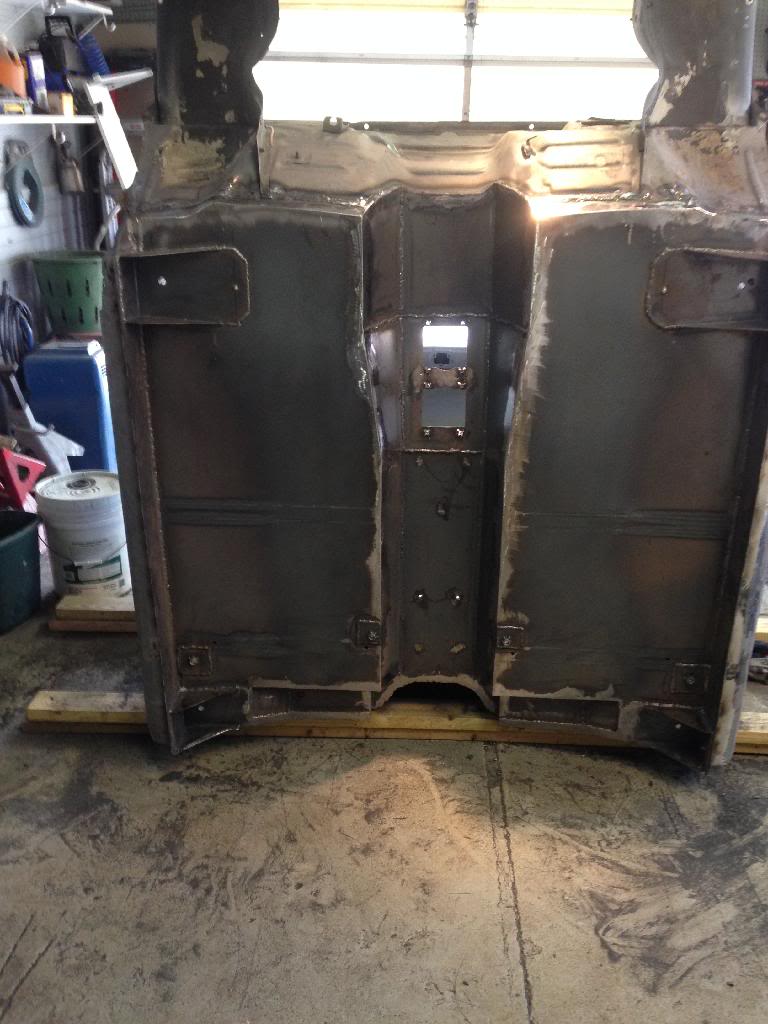

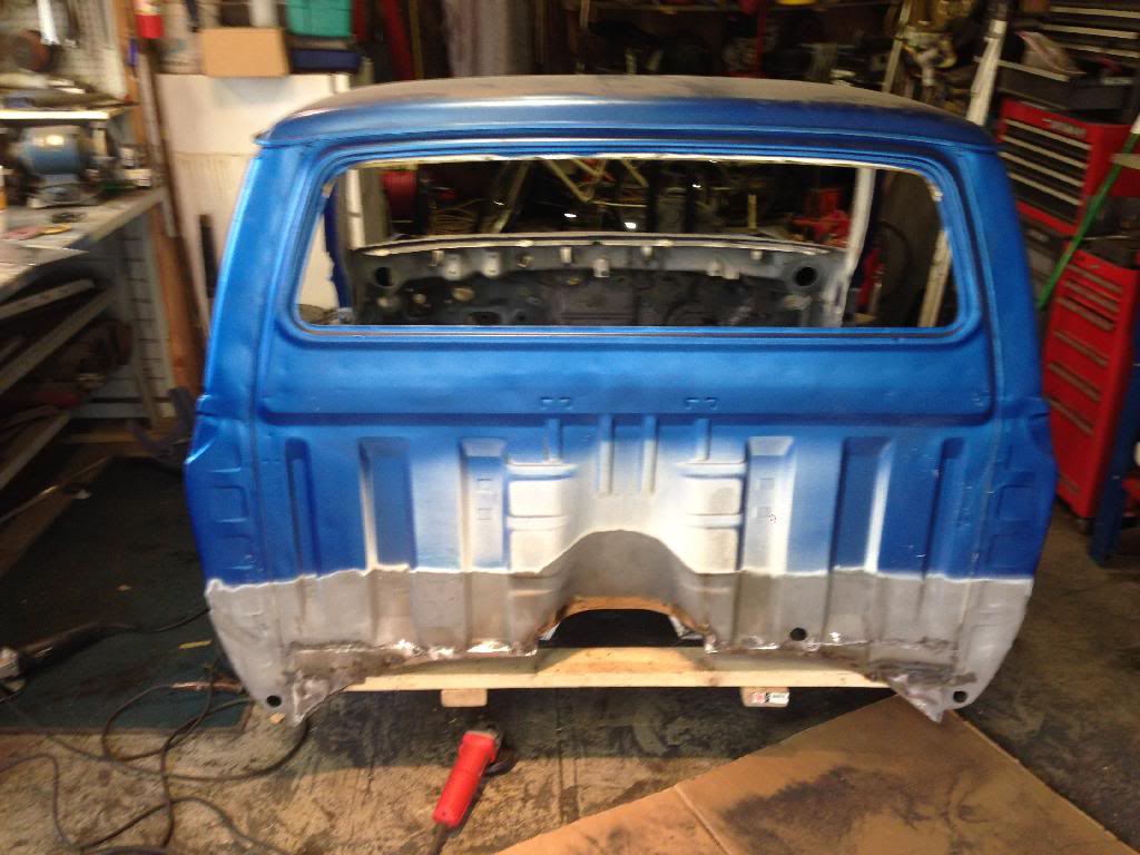

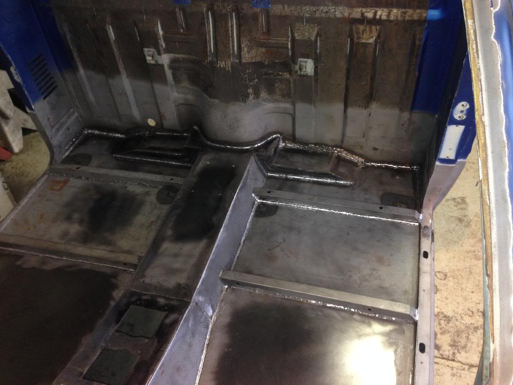

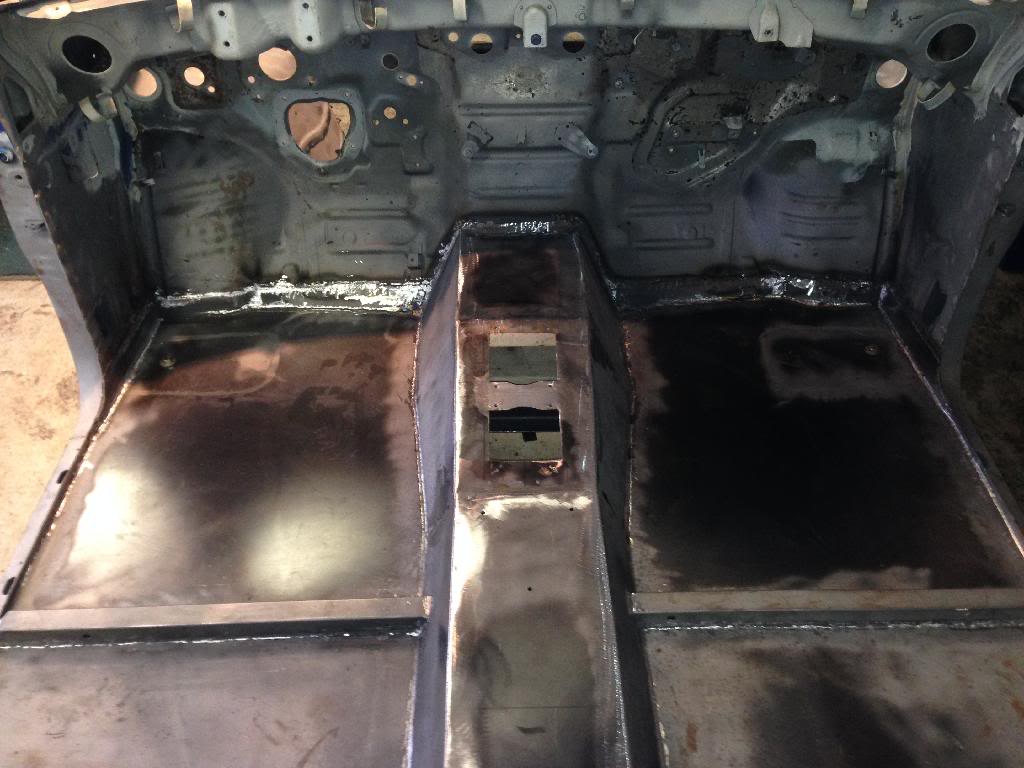

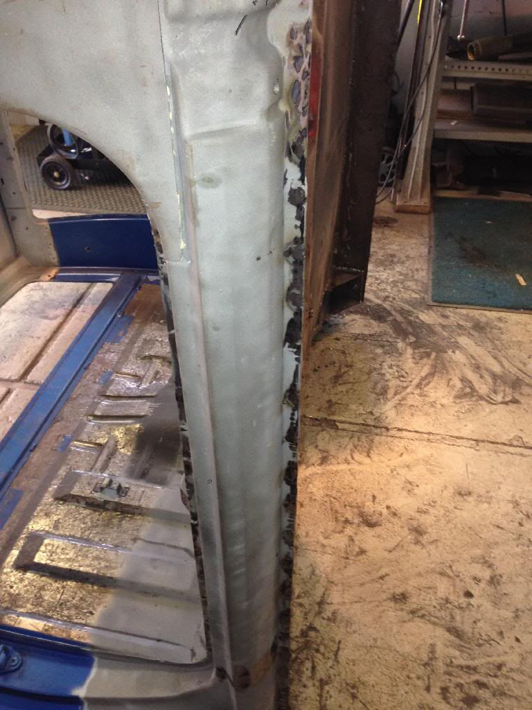

Alas, all the metal work is complete! I never want to see a welder or die grinder again! I went back and finished some welds that I forgot to burn in and finished dressing all the welds today. Woot woot!
Underside of the cab:
Rockers:
Rear of cab:
And interior:
Now a quick sandblasting and it's FINALLy ready for sealer... Which apparently will happen no time soon since we're about to get slammed with another 8-10 inches of snow over night. And then I'm going to have to spend a couple weekends doing the finishing work on my brother's building so we can get a tenant in by the first of April. This truck seems soooo close to being done, yet not close at all
