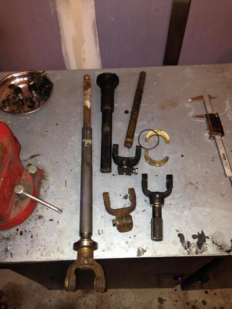

I already have power steering, in fact last night I pulled the steering shaft out of the steering column to press out the u-joints since I finally found some the other day. The new u-joints should be here next week so I decided to take the time to start cleaning everything up for powder coating. It's not something that has to be done right now, but it needs to eventually get done. Surprisingly, I slid out of the steering column with no problem and the u-joints came out relatively easily.

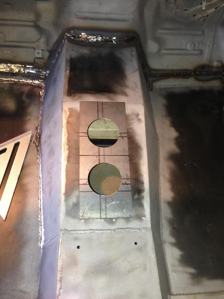

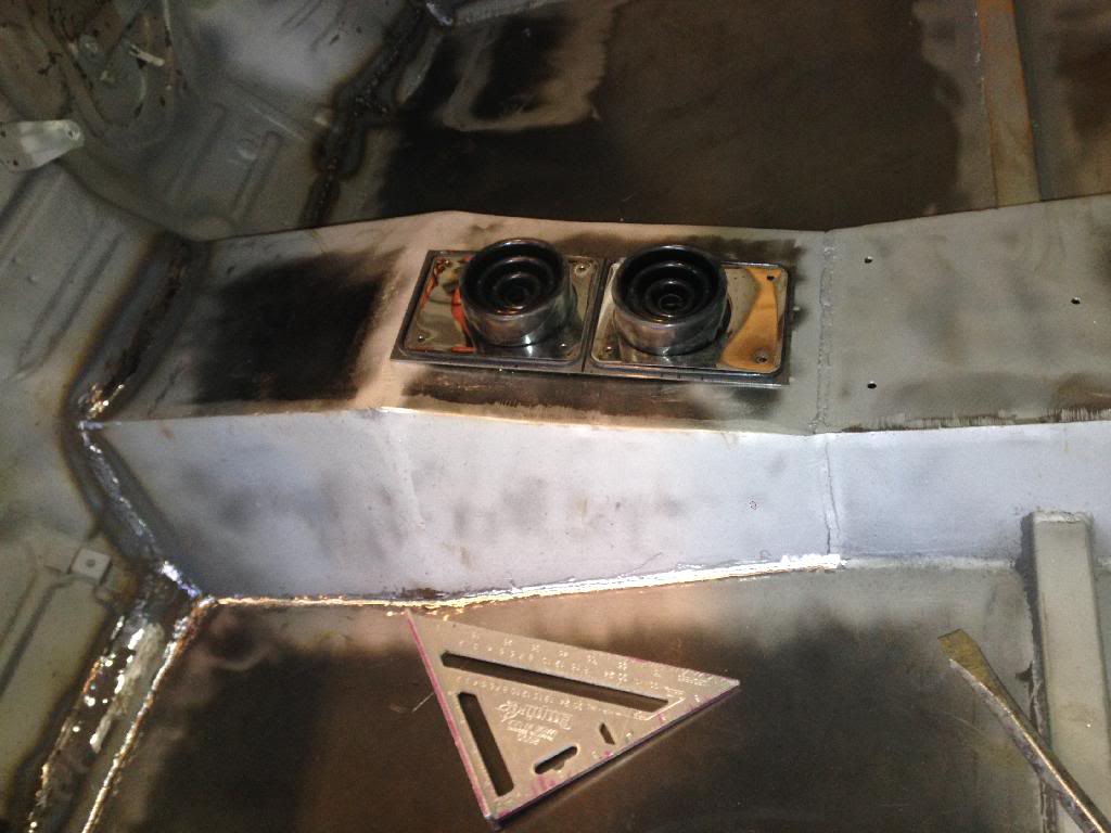

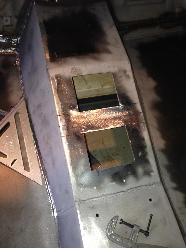

Earlier yesterday I worked on mocking up the shifter boots. I'm just doing simple hurst shifter boots, nothing fancy. I wanted to make a plate to mount the boots to and through to welded nuts on the underside of the cab. That way if I ever want to change it up in the future I will have more options without having to do any welding or too much cutting.
Started by making a "crossmember" in the hole that I originally made for the shifts (I needed something to bolt to in the middle). Welded it in and dressed it like it never happened.
Then made the plate for the shifter boots to mount.

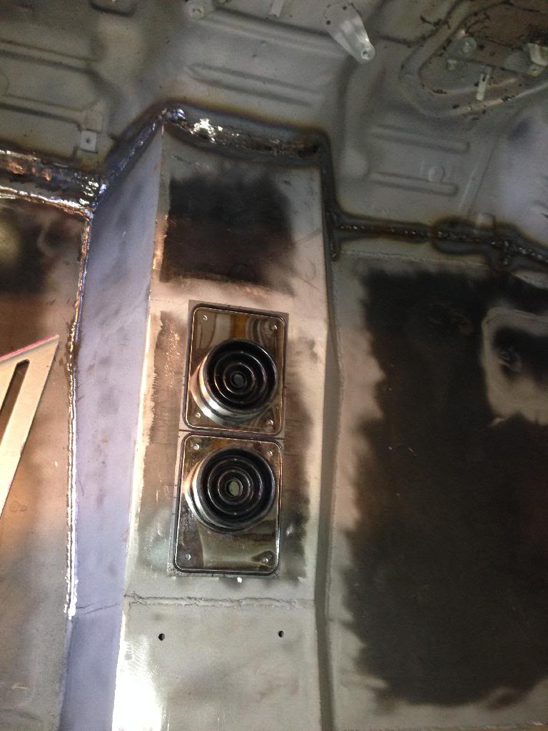

It should look about like this with the mounting plate corners rounded, powdercoated and mounted with Stainless hardware
