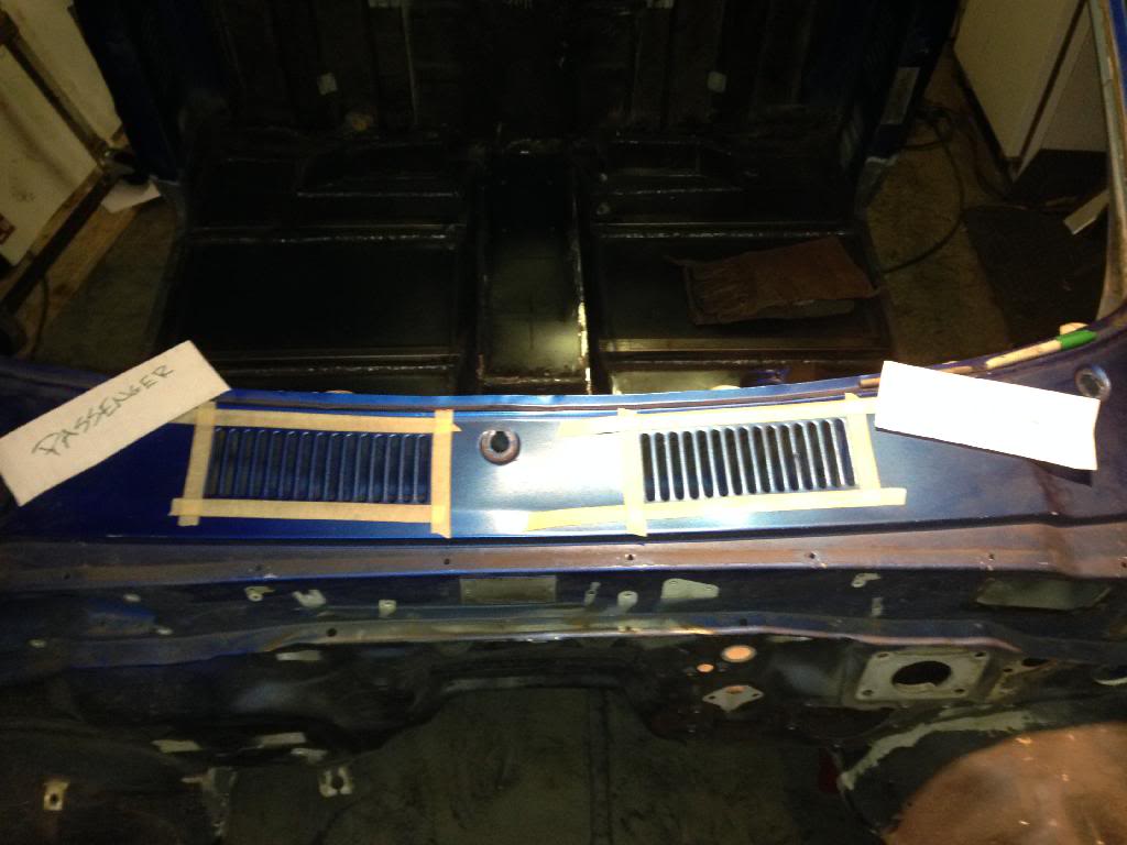

Before I shut it down for the night I mocked up everything for the smoothie cowl. No more draining water into the kick panels and rocker panels for this guy!!! (I still can't believe that it was designed that way) I have to go grab a small sheet of 16ga steel tomorrow and i should be able to get the smoothie cowl all buttoned up tomorrow night. Then all of the fabrication on the cab should be done! Woot woot!

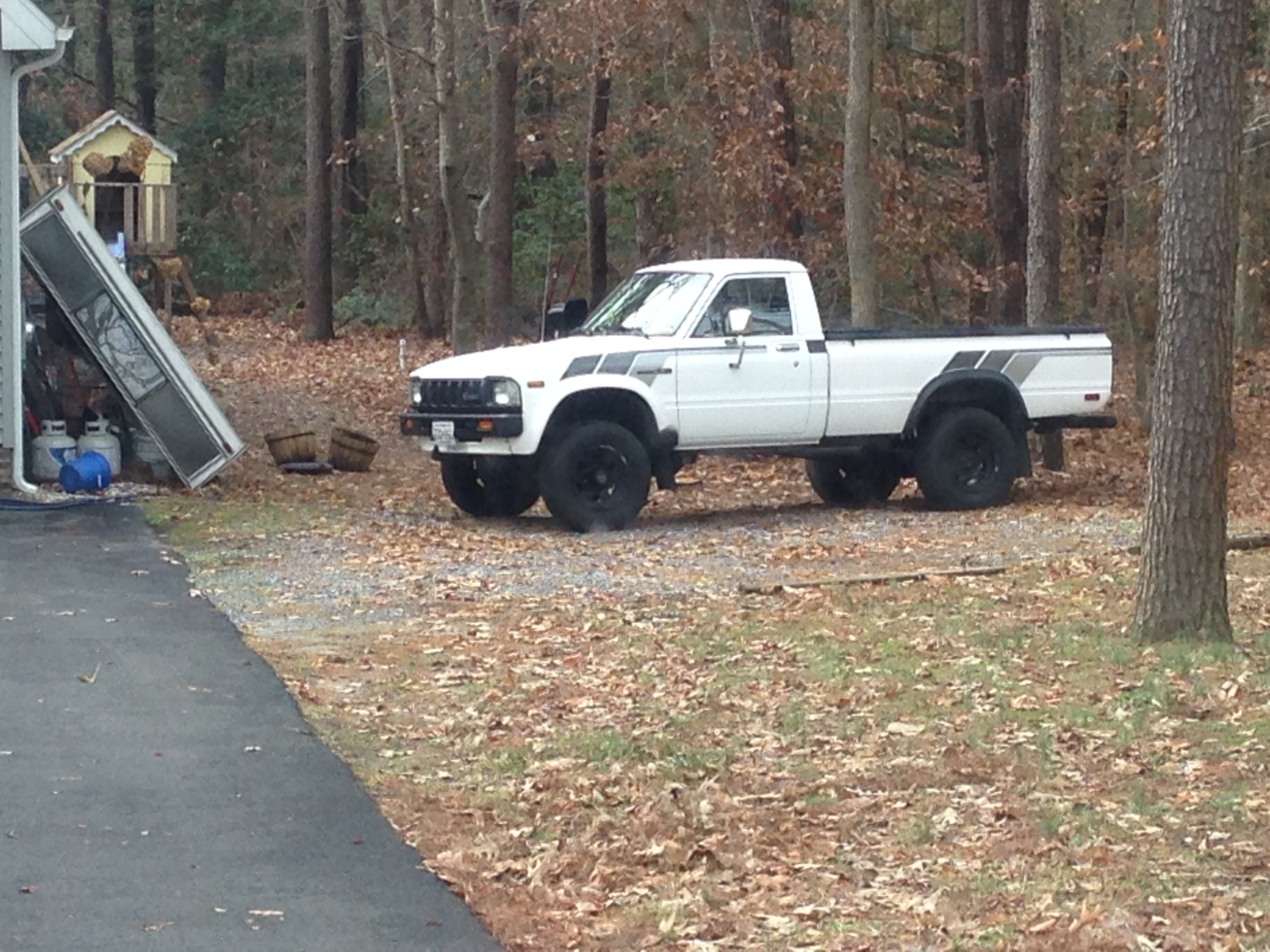

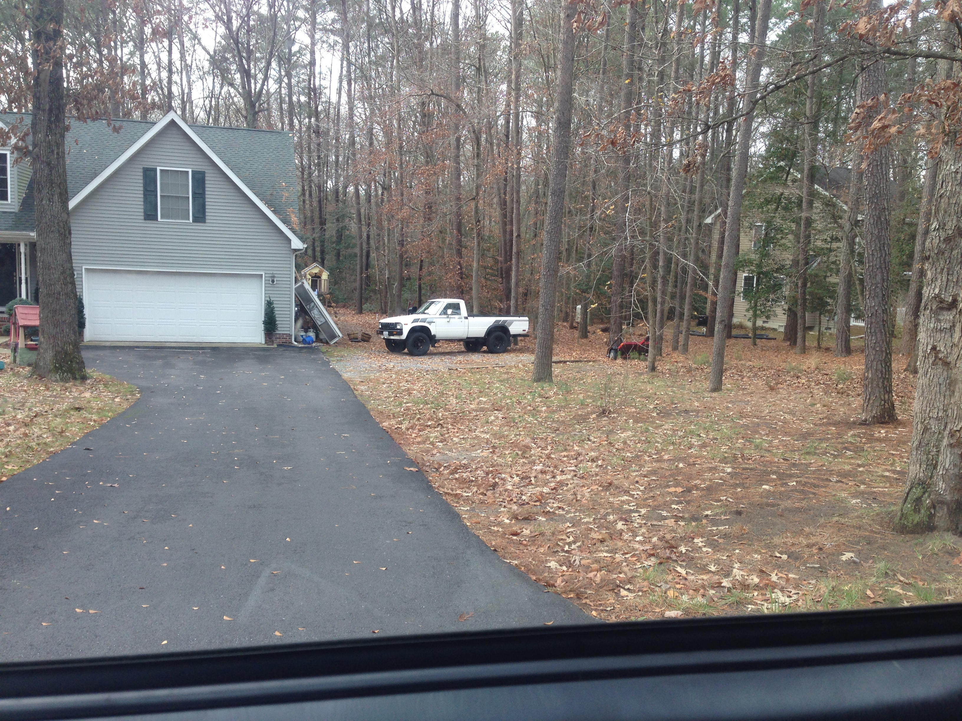

In other news, I was out on a site visit for work today and came across this little gem:
I'm going to stop by there later to take a closer look, but it appears to be in great shape! May make an offer to see if I can snag another project up for later on in life.

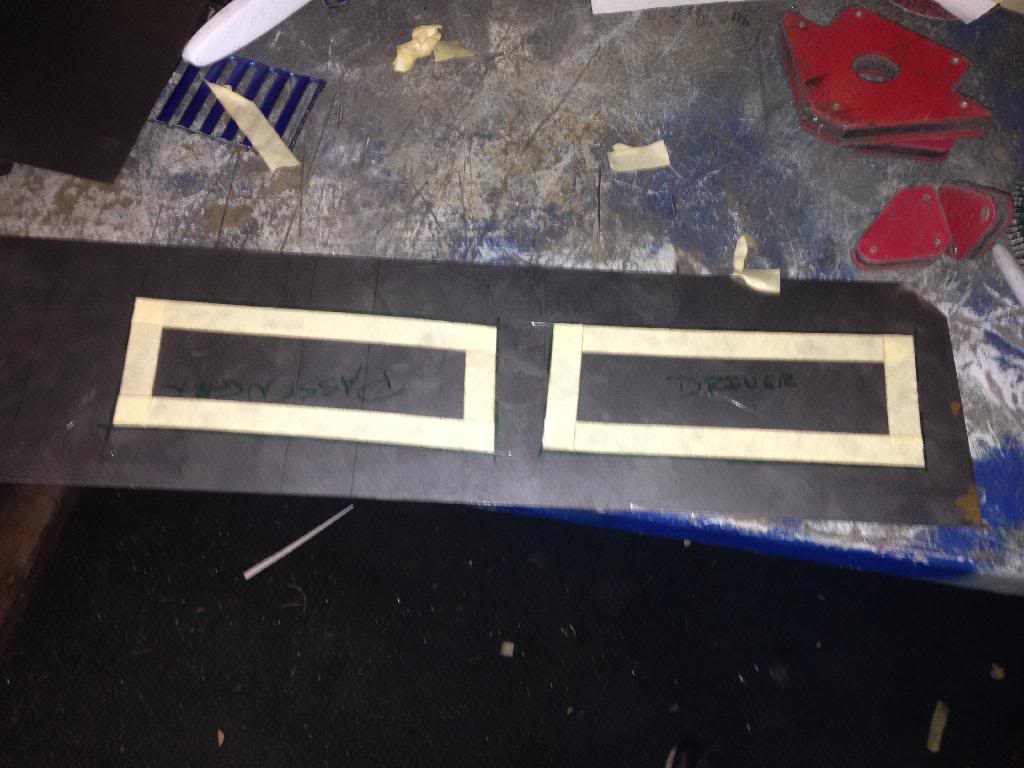

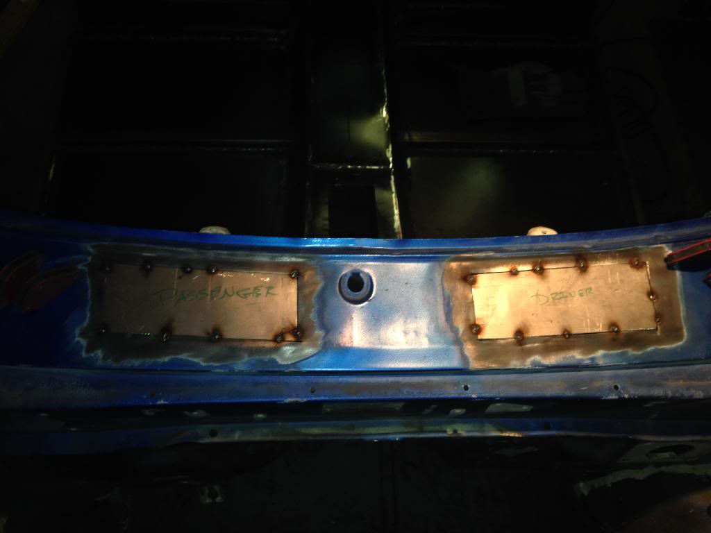

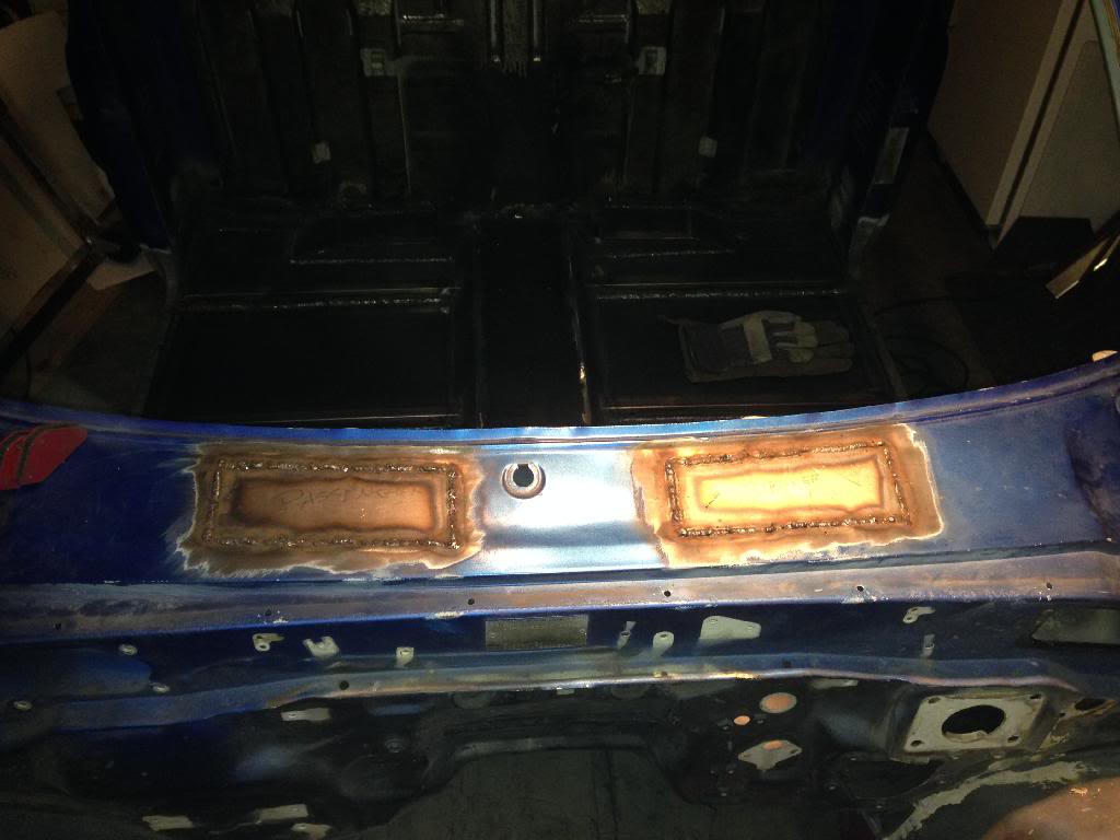

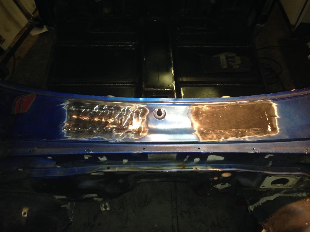

Got the smoothie cowl almost completed tonight.
Cut the patches out of 18ga steel (I like using masking tape as a guide):

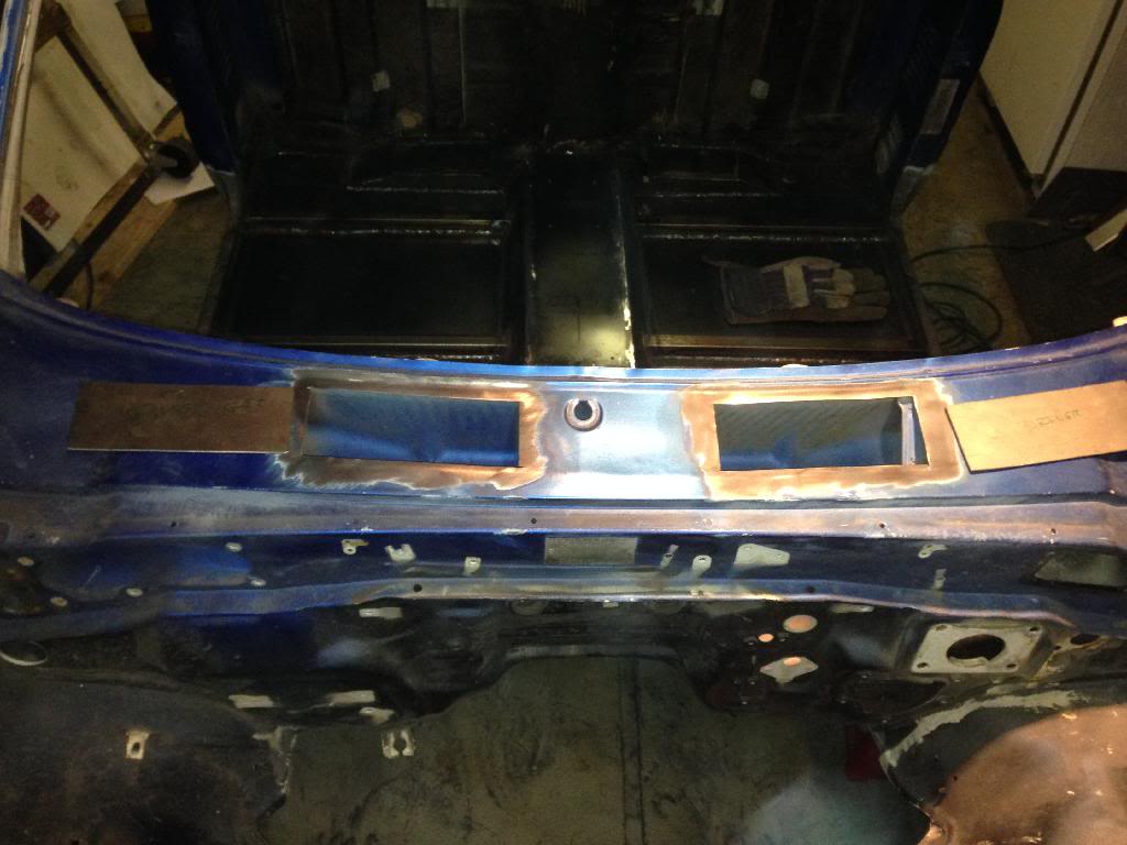

Then the point of no return, I cut out the cowl vents:
Tacked in the patches:

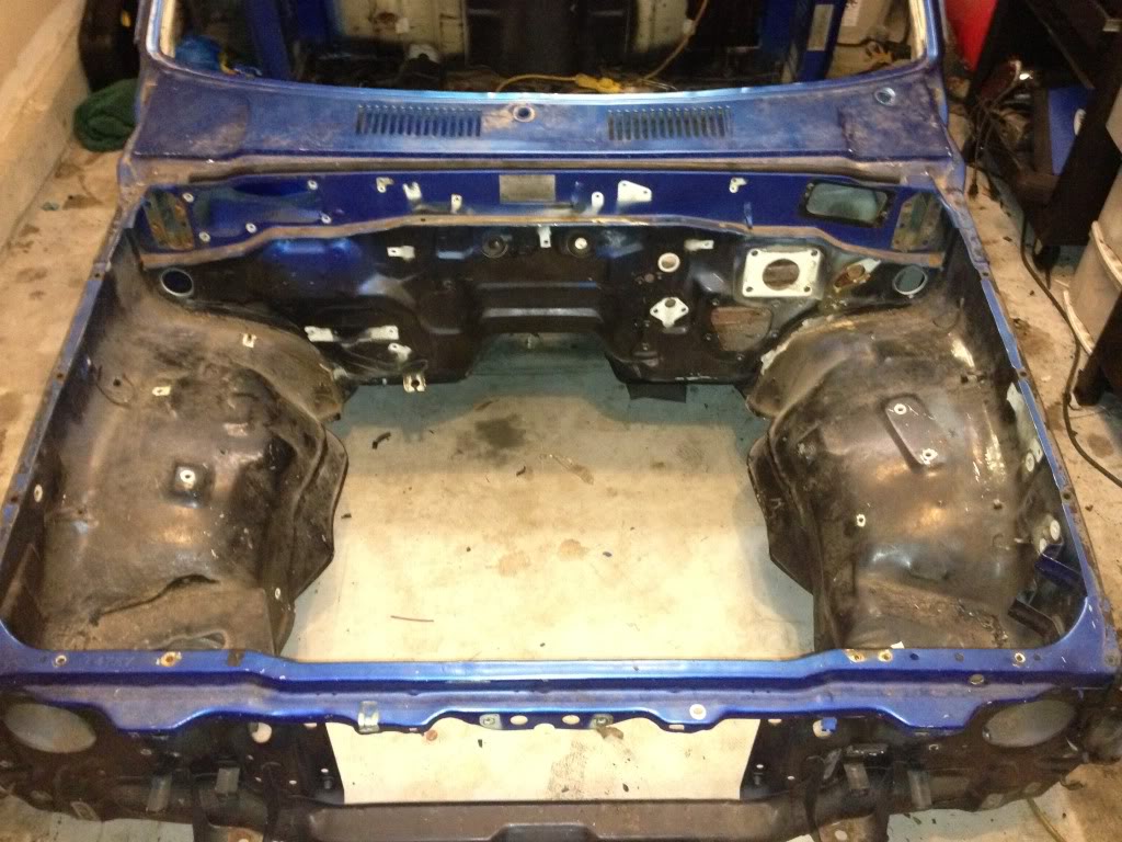

Then welded the perimeter. This was a little bit of a pain... I only had .030 wire so i had to use a series of small spot welds to keep it from burning through - the body steel on these trucks blows through so easily. I still ended up with a decent amount of shrinkage, but nothing that can't be fixed with a little filler.
Then dressed the welds a little bit. The pictures all look a little yellow, but it is cleaned steel. i still have a little bit more to knock down, but this will do for now
Special thanks to Corey for providing me with the idea via his Trekker build. It is an excellent solution to one of the biggest problems with these trucks - the rusted kick panels and rocker panels!
