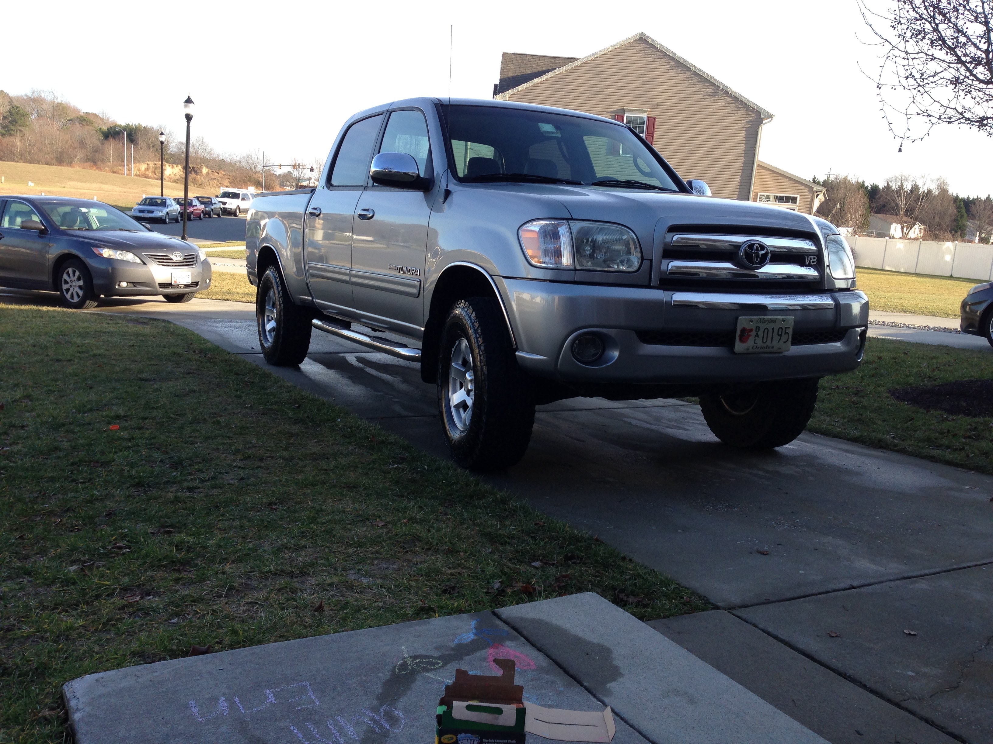

As Joe Nicoles would say, it was sunny and 75 today so I decided that I would quit neglecting my Tundra and give good ole T-Wrex a good washin' and waxin'
It was absolutely filthy from the construction job at my brother's building and simple neglect for the past 6 months because I've been working on my pickup. So here he is in all his sparkling glory:
Gotta keep it looking good since I plan on trading it in soon for a 2015 Tacoma if the new body style looks good and the New V6 isn't garbage.

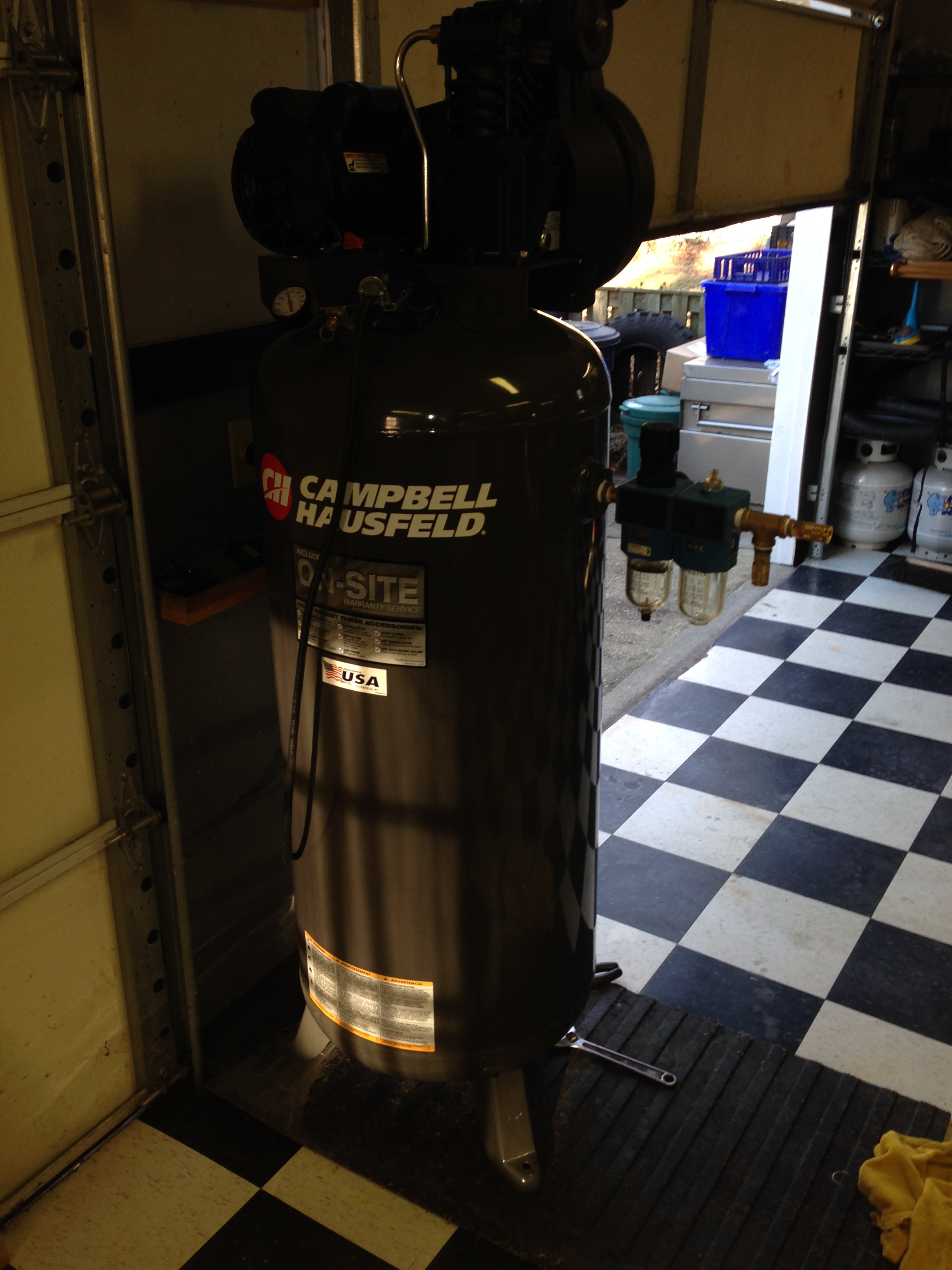

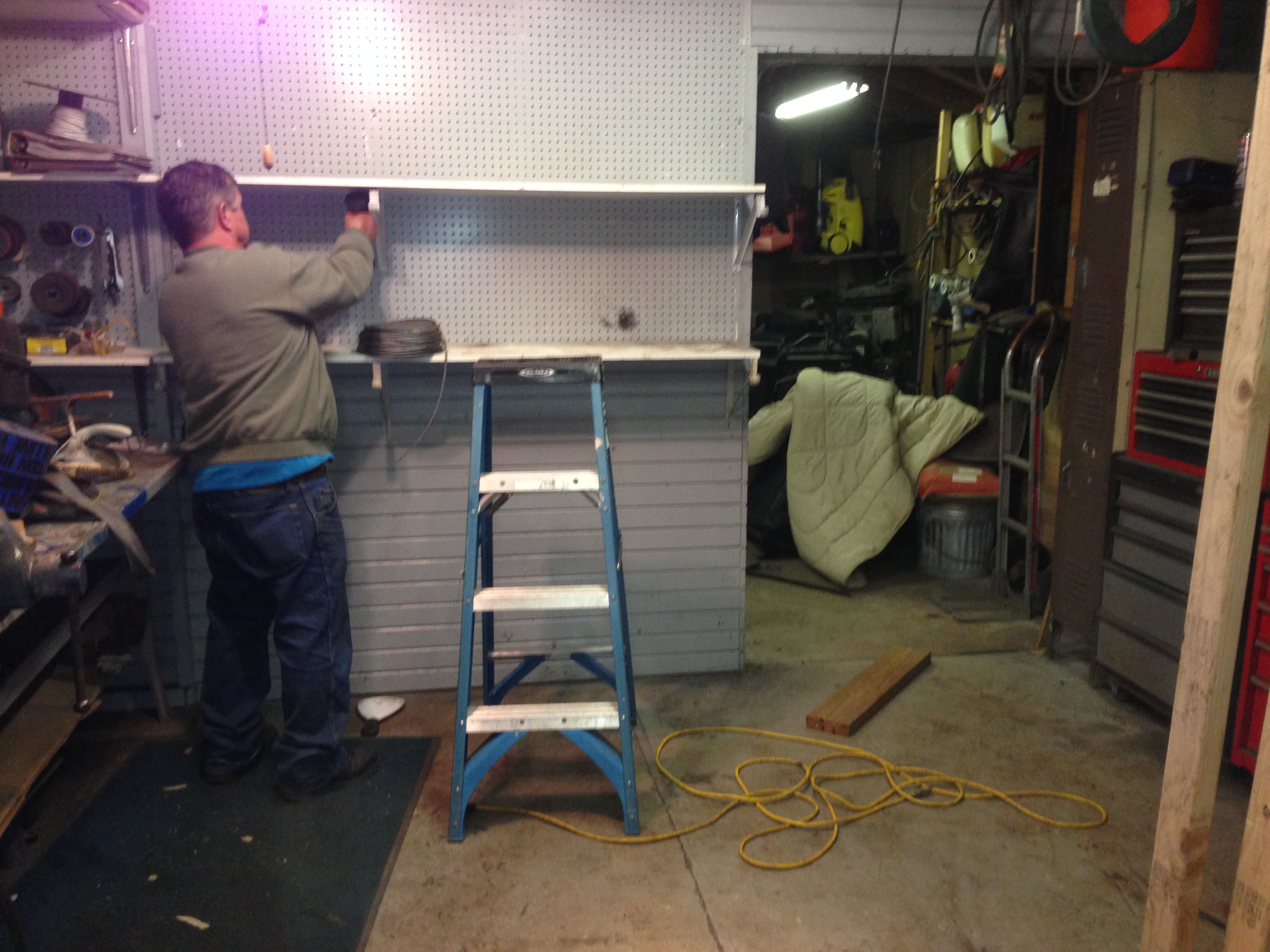

Merry Christmas to meeeee! It was about time to upgrade the air compressor so my Pops and I went in on a new 60 gallon upright compressor with water separator and in line lubricator (I told him that I would kick his ass if he put lube in it before I got my truck painted!). Here it is in all its glory:

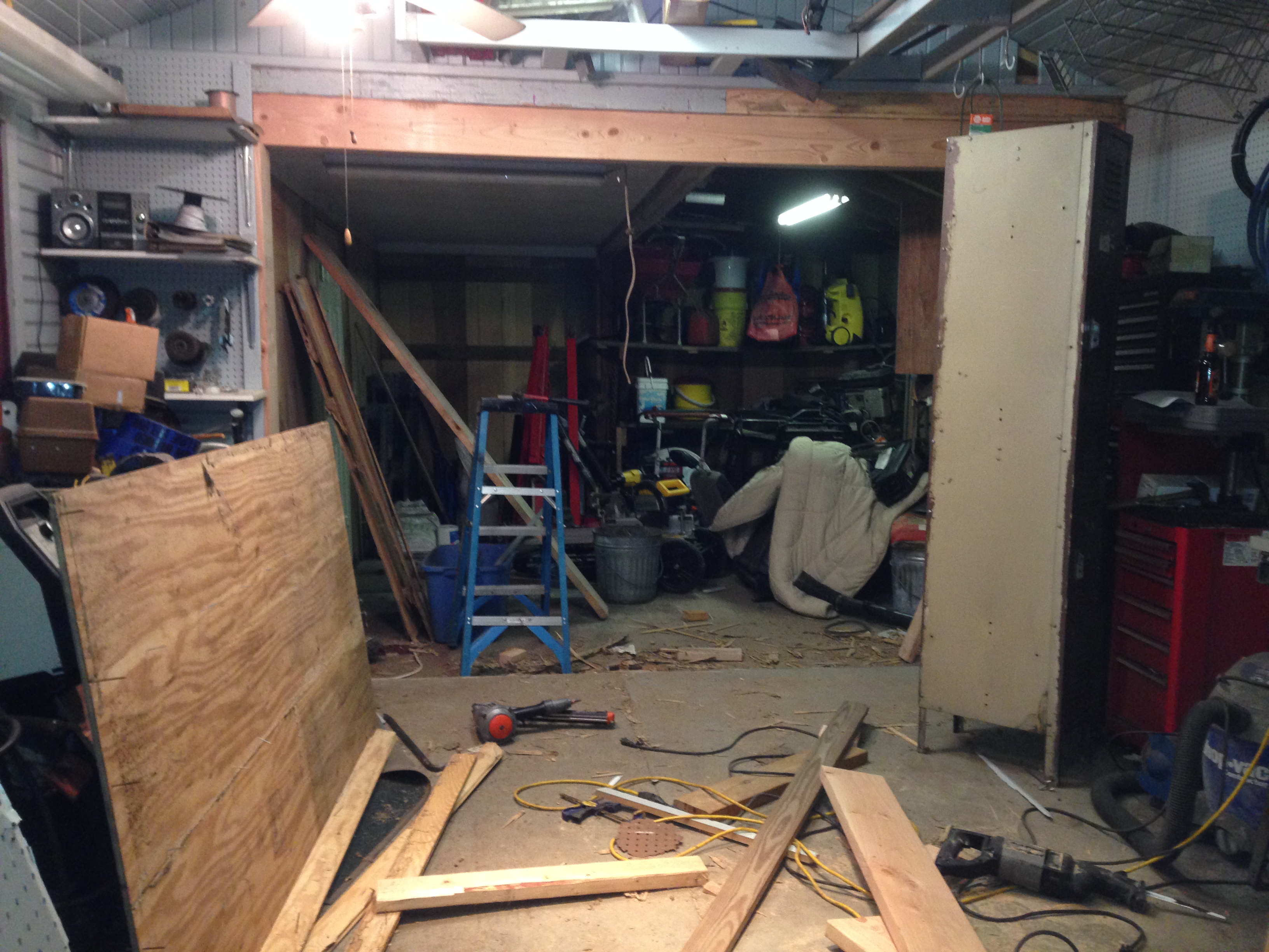

We also decided to make the spare garage a little larger. About 20 years ago he added a single bay garage to the side of his shed. It only had about a 4 foot door going from the garage to the shed so I gave him the idea of knocking out the wall between the two. I more or less proposed the idea since that is "my" space for working on motorcycles and my truck. Here's what it originally looked like:
After removing the pegboard and tongue and grove boards we discovered some termite damage so it was a pretty good idea to do this. We sandwiched three 2x8's for a beam (I'm going to drill a hole through it so I can also use it to hoist engines) and threw up some jack studs to hold it up and voila, instant bigger workspace for me! Only took about three hours to complete. Final product:
Now I just have to get him to organize all his junk in there!

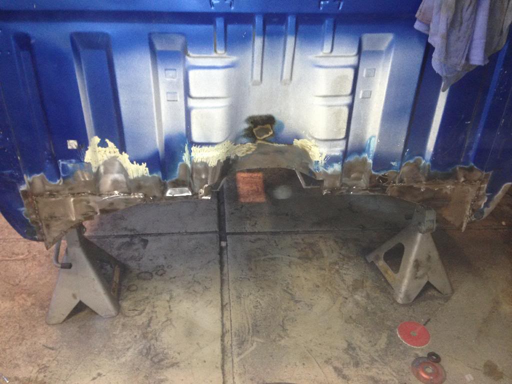

I also got the rear of the cab cleaned up tonight. I just needed to get the floorpan trimmed up even with the rear cab wall so that I can sandblast it before final welding:
I'm going to do some sand blasting tomorrow to clean up all the metal in and around the floorpan so that I have clean metal to finish up the welding. I got sick of getting crappy welds because my metal was so grimy.

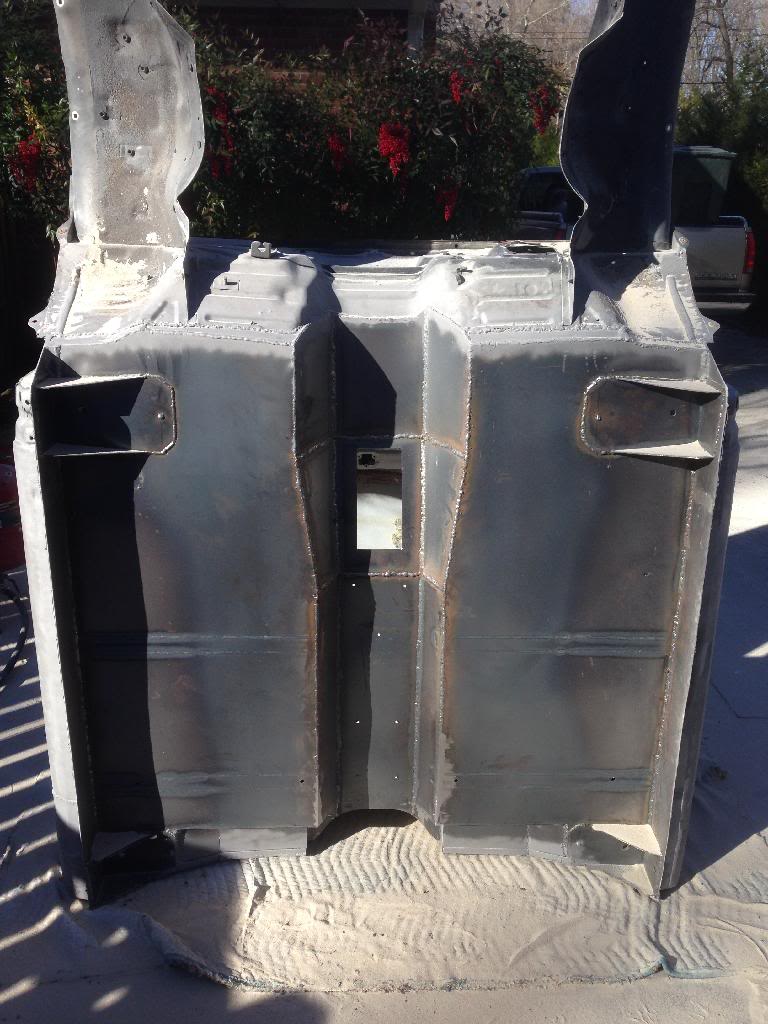

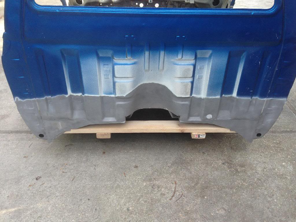

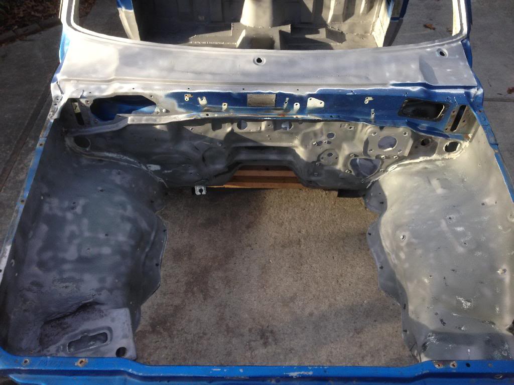

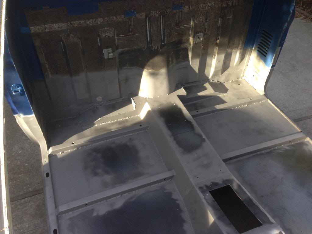

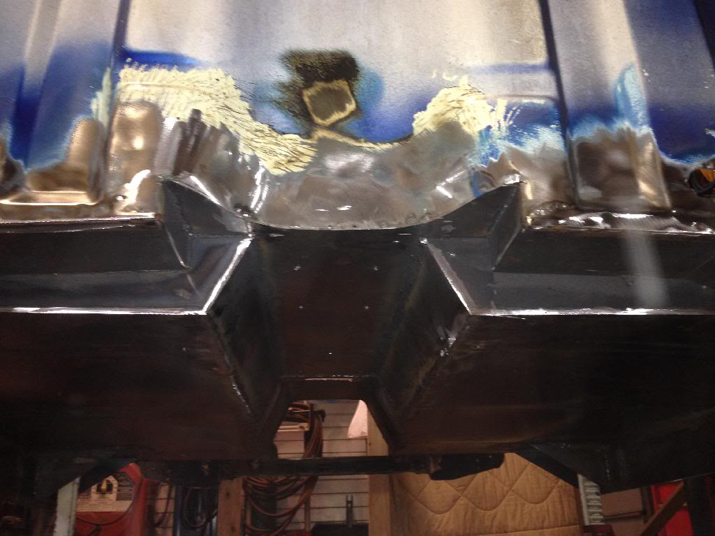

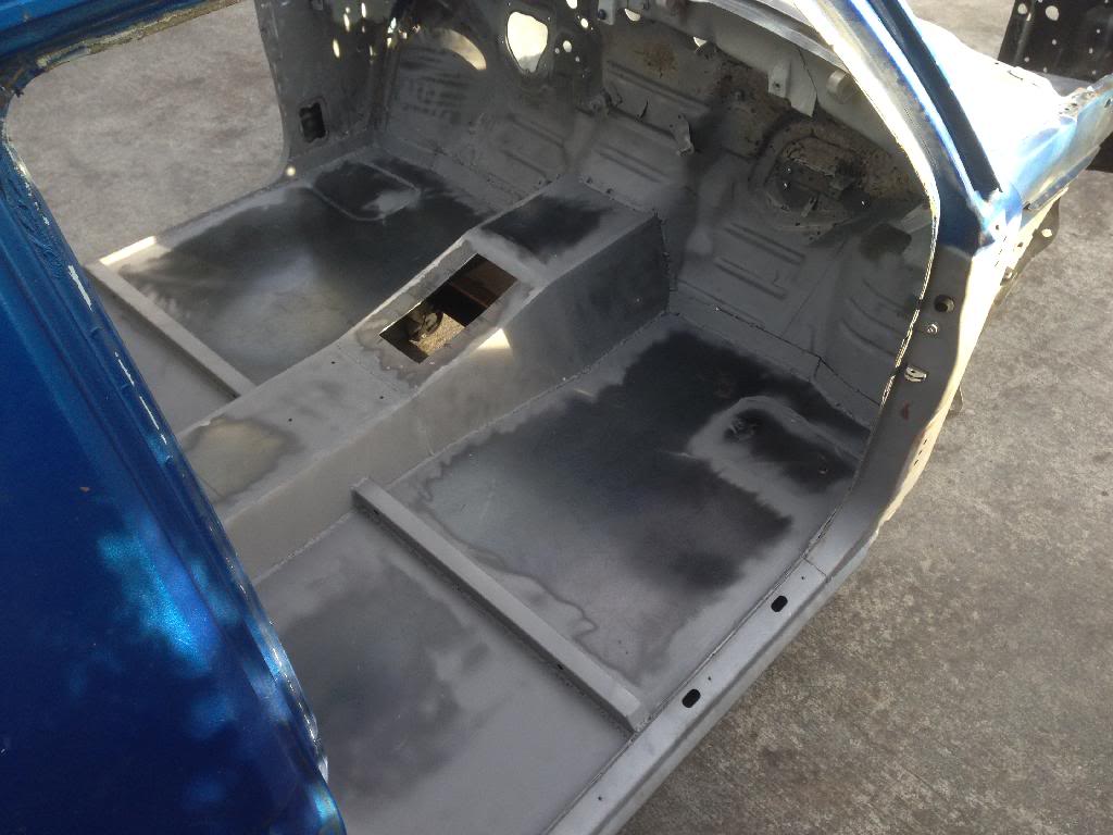

I forgot to post the pictures from Saturday's blaster session. My main goal was to hit all the welds so that I can touch them up, dress them and prep them for sealer primer.
Underside of the cab (mainly needed to hit the area around the firewall):
Interior:
The rear cab wall:
Hit up the smoothie cowl and since I had some sand left in the pot I also hit up the engine compartment really quick:
The new compressor kept up exceptionally well and the air stayed clean and dry the whole time; that's great news when it comes to paint! Little bit of welding and some dressing and she'll be ready for epoxy sealer, but Since Saturday I've been on the shelf with a cold that has been hand delivered straight from hell by Satan himself so I haven't been working on it at all. Buuuuuut I did receive the LCE newsletter today and my truck was the featured reader ride this month! Pretty neat little honor to me. Check it out here:

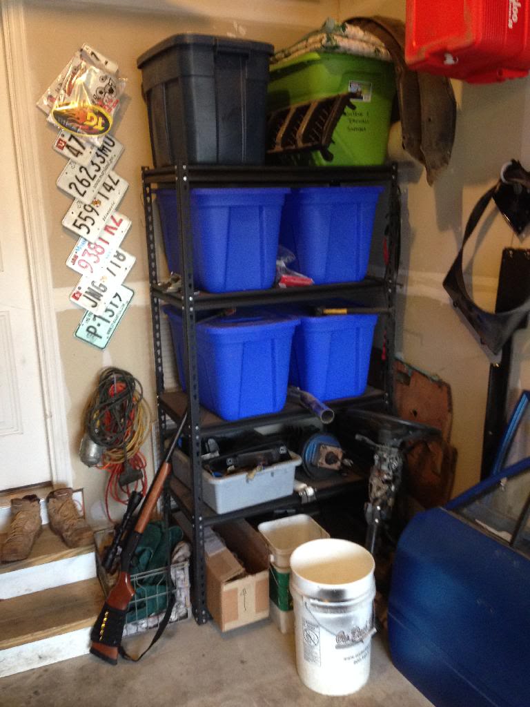

Still battling this obnoxious cold, now mixed with some allergies, but it's starting to clear up. Decided to clean up my garage today because it was getting a little out of control with tools and parts everywhere. Bought some totes to store all my truck parts until I'm ready for them. Each box is labeled with their contents so I shouldn't have problems searching for parts.
My Toyota is officially on the shelf LOL
Should be back in action this week on the cab.
