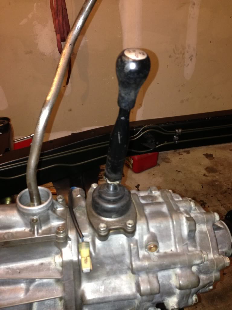

Here's what it looked like originally (you can see the rubber bushing in there):
Attachment 155636

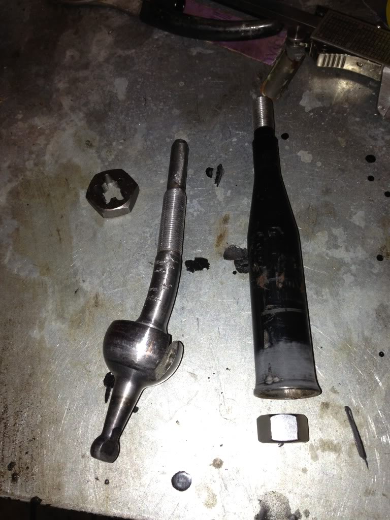

After some cussing, reaming and temper tantrums, I got the two pieces separated. The shaft attached to the ball wasn't originally threaded so I grabbed a 1/2" x 20 die and cut some threads on it (Die fit the shaft diameter perfectly). Also went out and grabbed a 1/2" x 20 nut to weld into the shifter shaft:
Attachment 155637

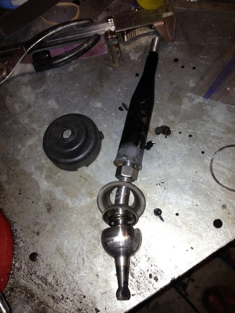

You can see how it's going to go together here with the nut going inside the shifter shaft so the the ball shaft can thread into it:
Attachment 155638

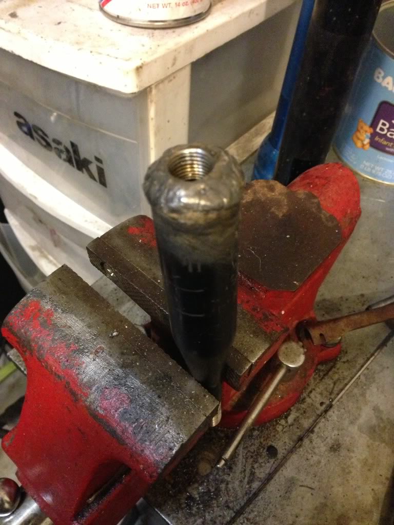

I welded the nut to the inside of the shifter shaft. Don't make fun of my crappy welds; I ran out of gas when I was doing my frame and I probably bought the worst flux core welding wire ever! I'll clean it up with the grinder before I powdercoat it.
Attachment 155639

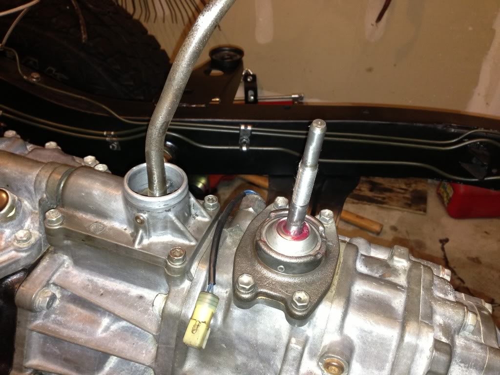

Here's the ball installed in the t-case socket:
Attachment 155640

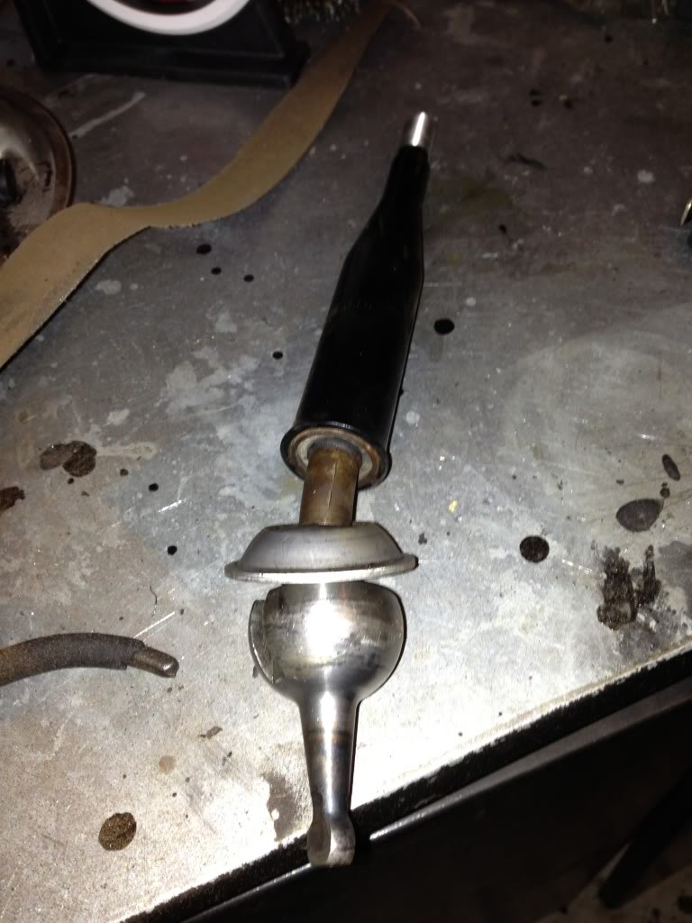

ANNNND the shifter shaft and knob just thread right on:
Attachment 155641
I'm pretty satified with the result, although I'm not quite sure why Toyota designed it the way they did since you can't remove the shaft to replace the spring and retainer caps if you need to. I suppose that's one way the stealership makes money...
