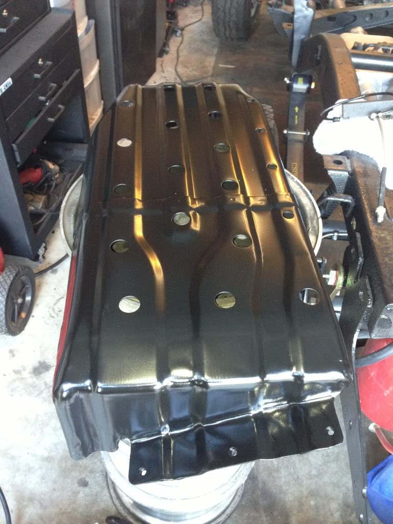

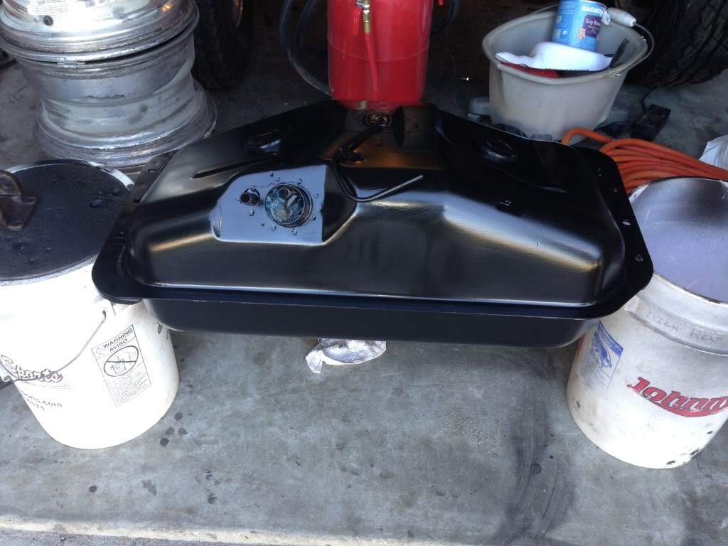

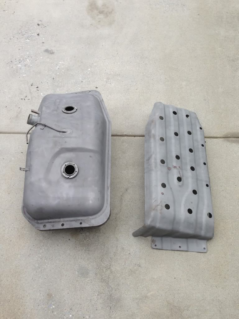

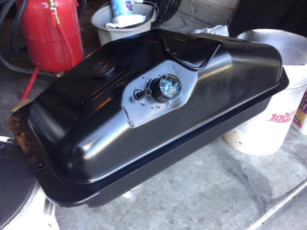

Finished sandblasting my tank and skid plate on Thursday night and managed to get a couple coats of paint on them on Friday before I left for D.C. to visit my in-laws (they drive me nuts!!).
Had my little helper in the garage holding some washers and bolts while I finished buttoning up my brake lines.

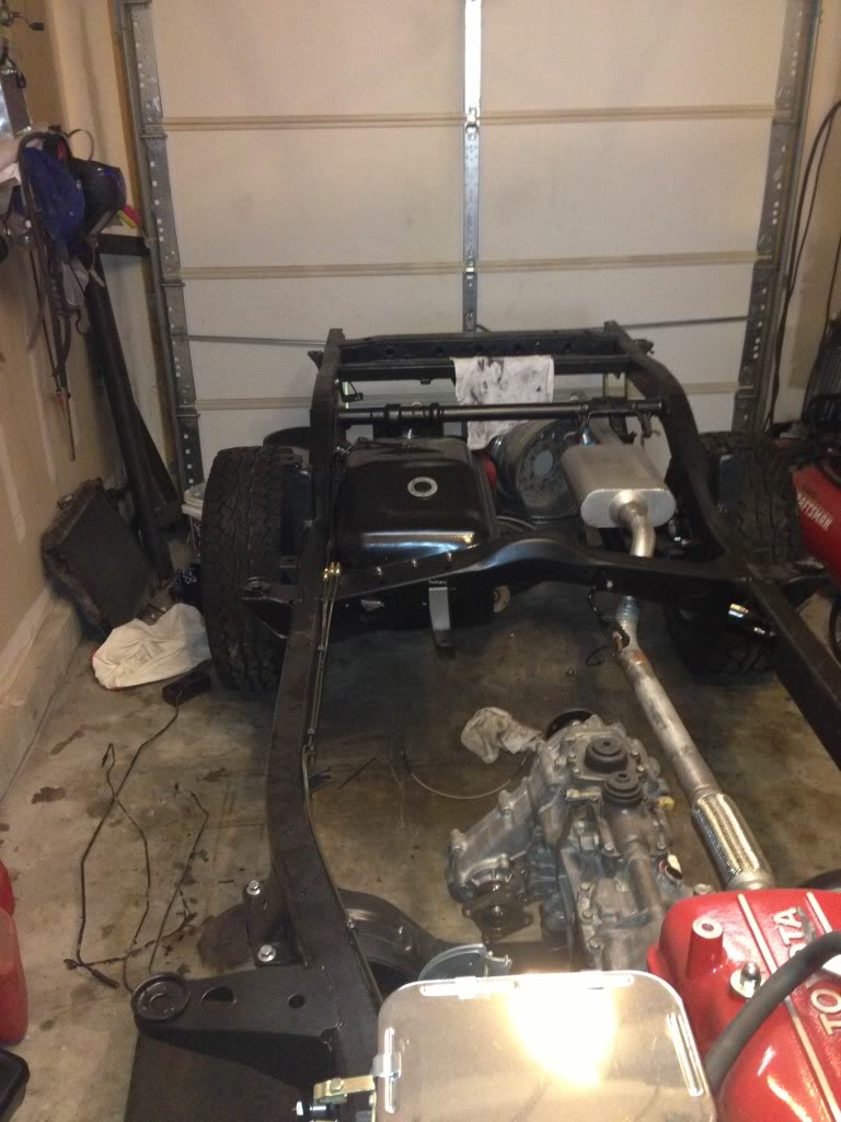

Came home today from D.C. and put the final 2 coats of top coat on the tank, skid plate, steering box and tie rod.

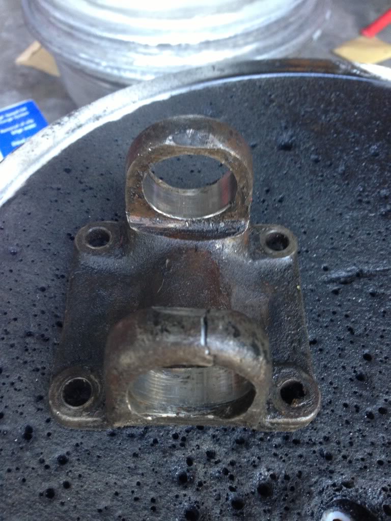

While I was pressing out the old u-joints from my drive shafts, I managed to crack one of the rear driveshaft yokes:
Does anybody happen to have a spare that I could buy off of them? or perhaps know a source for a new one. I haven't checked around much yet, but I imagine that this will be a stealership part if they have it.
By the way, if you are thinking about replacing the u-joints in your front drive shaft just because, I would put it off until they are just about falling apart! LOL That double cardan joint is a pain in the ass!!

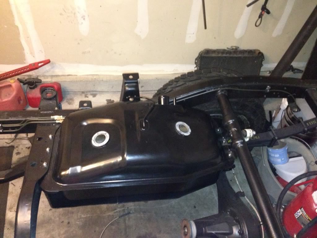

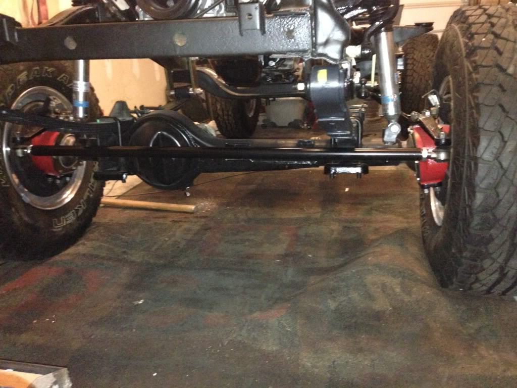

Painted and mounted the Sky Manufacturing HD tie rod. I like how beefy this thing is - would definitely recommend it to anybody who doesn't want to go with crossover steering but wants something stronger than the stock tie rod.
Also got the tank and skid plate mounted today as well.

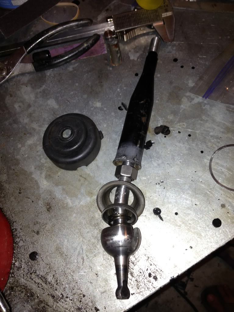

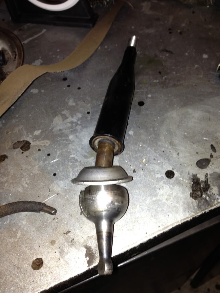

So last night I was sitting in the garage bored and decided to pull out the shifters to install them before the chassis goes to storage. Of course they couldn't go back on without a fresh coat of powdercoating! Sooooo.... I was trying to separate the t-case shaft from the shifter ball when I realized that they were pressed together with some sort of rubber bushing. Well, I boogered that up good so I decided to come up with a fix that I think will make it a little easier to separate in the future.

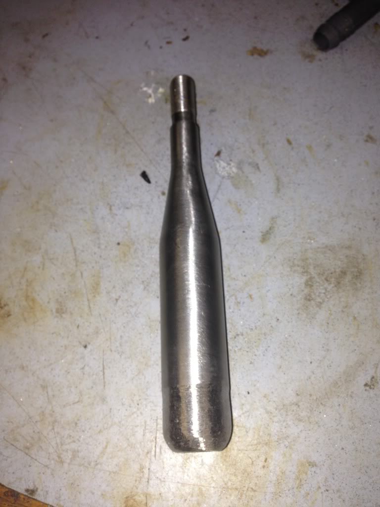

Here's what it looked like originally (you can see the rubber bushing in there):

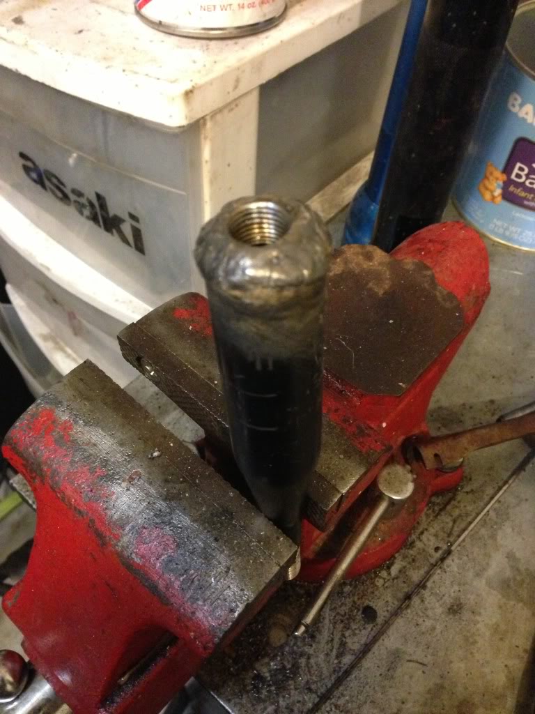

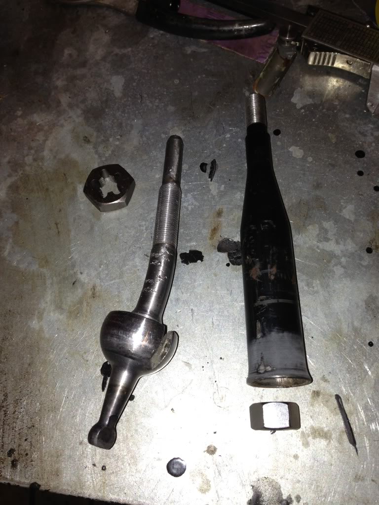

After some cussing, reaming and temper tantrums, I got the two pieces separated. The shaft attached to the ball wasn't originally threaded so I grabbed a 1/2" x 20 die and cut some threads on it (Die fit the shaft diameter perfectly). Also went out and grabbed a 1/2" x 20 nut to weld into the shifter shaft:

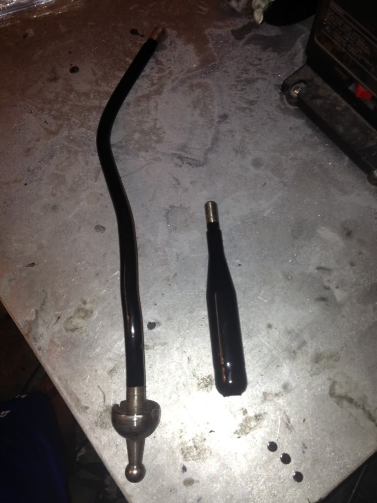

You can see how it's going to go together here with the nut going inside the shifter shaft so the the ball shaft can thread into it:
I welded the nut to the inside of the shifter shaft. Don't make fun of my crappy welds; I ran out of gas when I was doing my frame and I probably bought the worst flux core welding wire ever! I'll clean it up with the grinder before I powdercoat it.

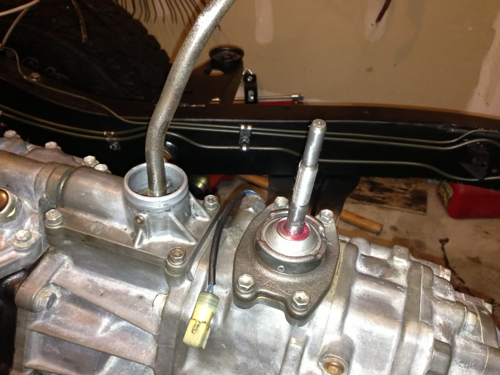

Here's the ball installed in the t-case socket:

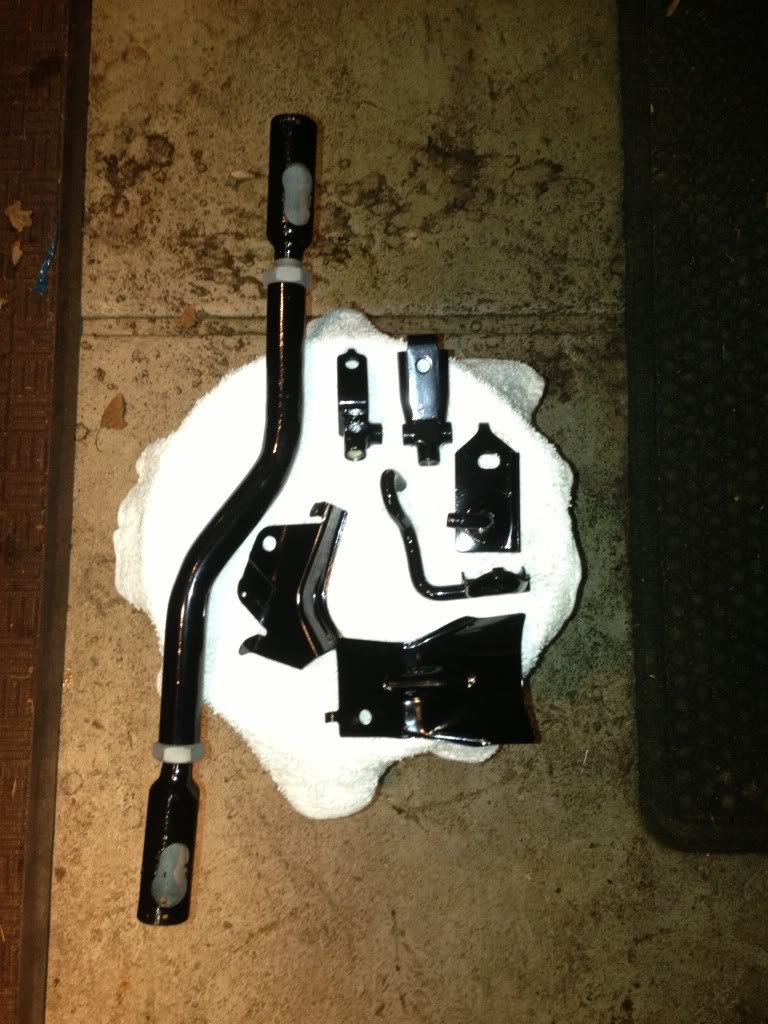

Powdercoated both shifters:

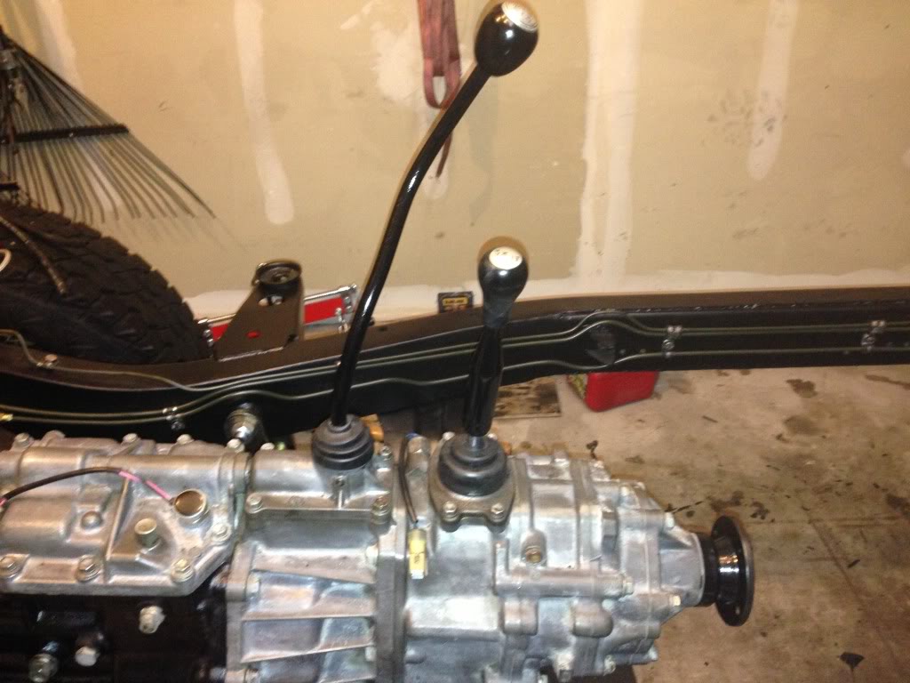

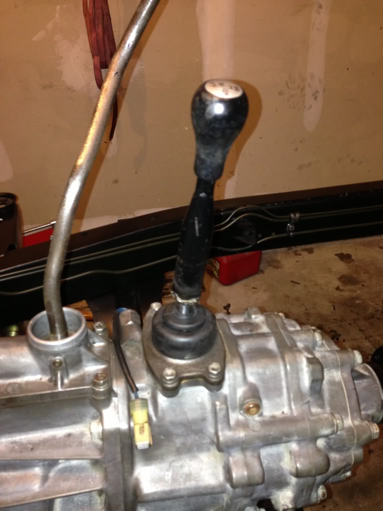

And installed those biznatches:
I know I'll have to remove them to drop the cab on, but I wanted get them installed so that I'm less likely to get moisture and grime in the tranny and t-case.

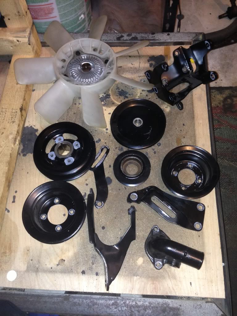

I also decided to remove all the front end pulleys and braclets so that I can strip and powdercoat them. I primed and painted everything with high temperature paint when I rebuilt the motor, but I wanted to go with something more durable so powdercoating it is! I've definitely got my money's worth with that powdercoating kit. The motor hasn't even been started yet and you can see how the high temp paint just wasn't holding up very well in the pictures below.
