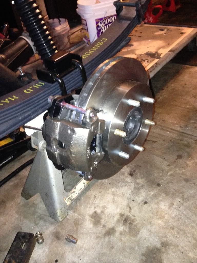

Tonight I was hoping to get my rear disc brake conversion complete, but the brake gods had other plans. I originally had just the calipers mounted up to double check the clearance on the wheels so I had to remove them to install the brake rotors. Then once I had them installed again I realized that I forgot to install the spring clips on the pads. Then once I had them installed AGAIN, I realized that the conversion bracket was in the way of the banjo bolt so I had to take them off to grind down a portion of the calipers near the banjo bolt (also gave me a better route to the center of the axle housing). Then once I had them installed yet AGAIN I realized that my banjo bolts were too short so I have them off AGAIN to take to the parts store to match up the proper banjo bolt length... By now, I'm pretty damn good at installing 1982 Monte Carlo brake calipers!
In other news, I dropped my wheels off to get the tires mounted and balanced during my lunch break today. The shop was jammed up all day so I should be getting them back tomorrow - slightly convenient since I couldn't mount them anyway with the rear brakes acting up.

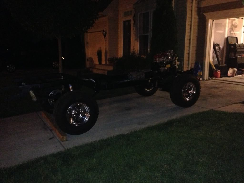

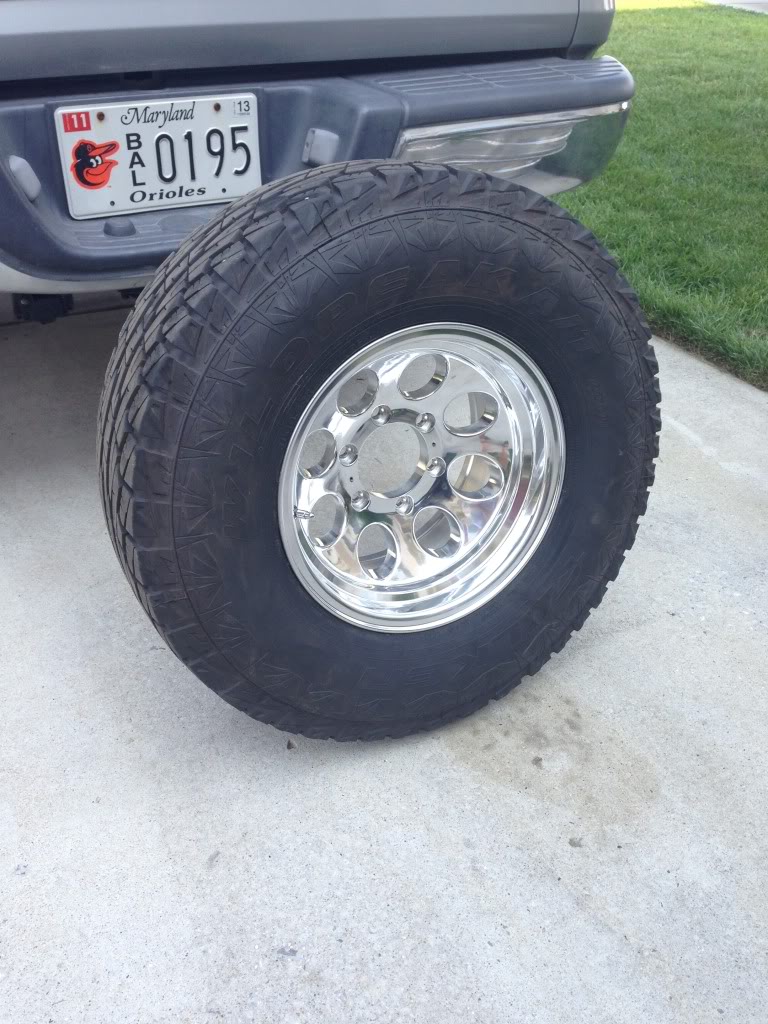

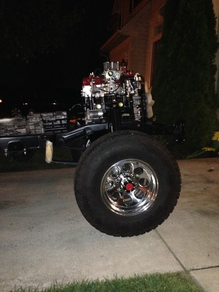

Today was a great day!! Got my tires swapped over to the my new Ion wheels. I'm running Falken Wild Peak 31x10.5 tires. I still maintain that they are the absolute best tires for your buck!! I paid around $600 shipped from Discount Tire direct. I liked them so much that I got a set of 33's for my Tundra. They are quiet on the road, don't cake up in the mud, great in the snow, don't wear too fast and grip the road really well. They have a mildly aggressive look which is what I was going for. I would highly recommend them to anybody who wants an A/T with solid off-road capabilities. Oh... and the wheels look good too! Absolutely perfect clearance around the calipers, tie rod and steering arms.

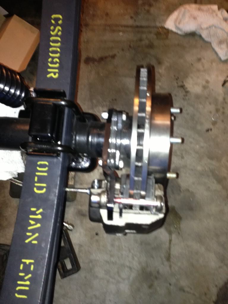

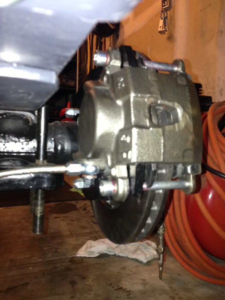

So I spent my entire lunch break (and then some) searching parts stores for the correct banjo bolts for my rear brake calipers. Went to both Auto Zones, PepBoys, Advanced Auto, Napa, a couple brake shops and even my tire shop... nothing!! Obiviously I could have ordered them, but I wanted them TODAY! I went back to work depressed and expressed my sorrows to my co-worker (who's building a International Scout) and he mentioned this little local mom and pop parts store called RC Holloway. They tend to have some random off the wall parts. Voila, they had it!! For those looking for banjo bolts for this conversion, you will need M10 x 1.5 x 27.8 banjo bolts. Here are the results (eventually, I'll break down the calipers and powdercoat them):

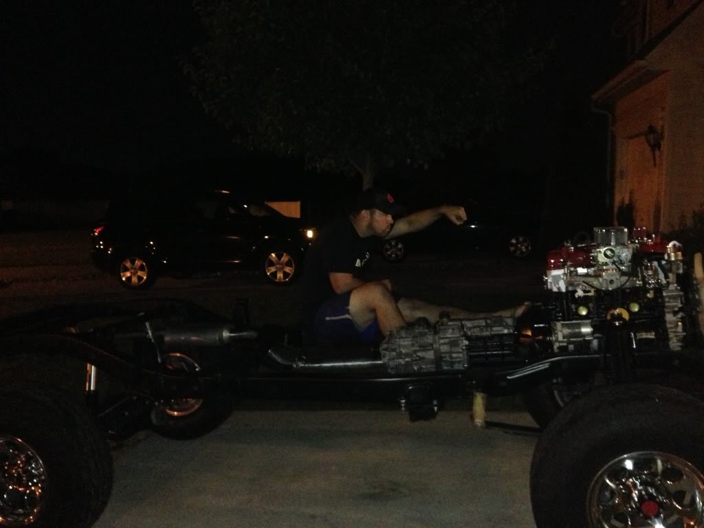

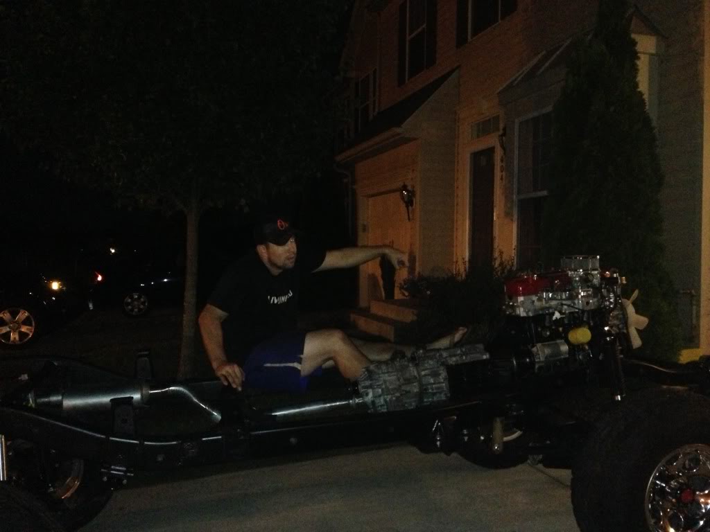

After I got everything buttoned up, I decided to take it for a test spin... My wife caught me driveway pimpin'

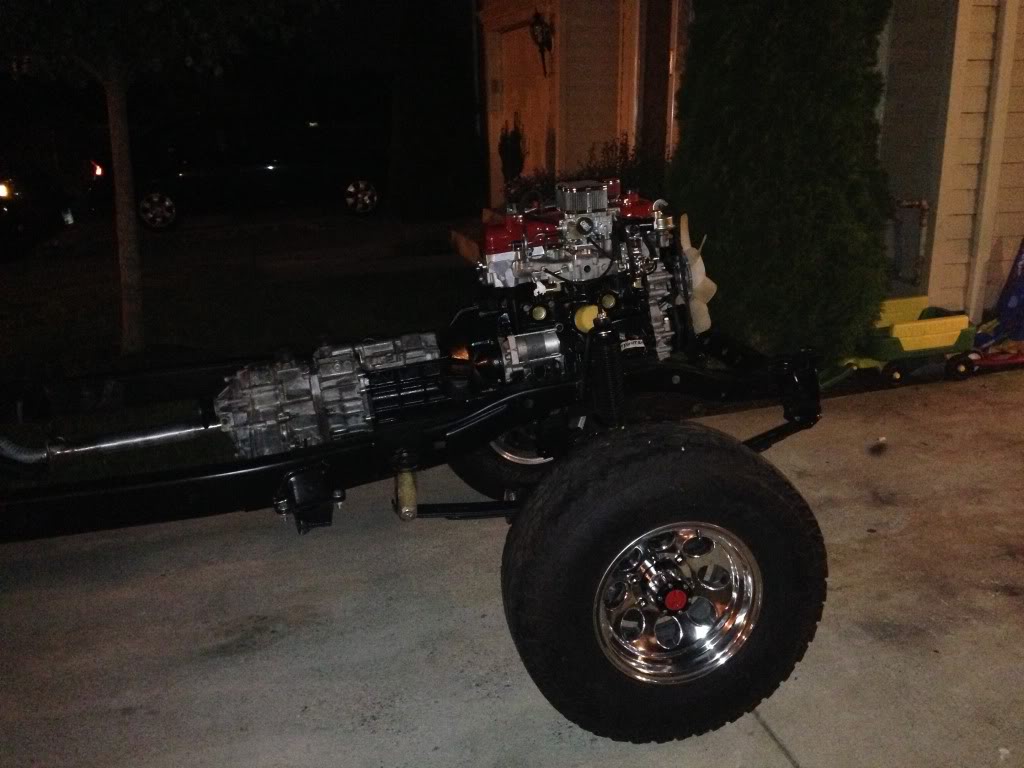

I tried to get some shots while I had it outside, but I ran out of daylight. I'll roll it back out and try to get some shot tomorrow before the sun goes down. It sits a little high so I'm hoping that those springs settle a little bit. My rear shackle angle is a little jacked up, I am praying that the weight of the bed corrects it. If not, I'll address the issue later. The front shackle angle will be perfect once the cab weight is on.
I'm super satisfied with the wheels!

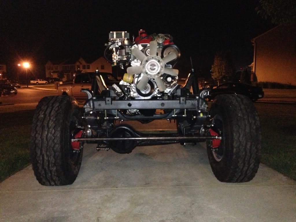

I'm also really glad that I powdercoated the knuckles red. I was a little concerned that they would be a little hidden, but they pop out really nice and provide some good contrast against all the other black chassis components.

I got an overwelming sense of accomplishment today! Even cleaned up the garage tonight while I was getting bombarded by mosquitos!! This weekend I'm going to try to sort through my brake hardware to see what fittings are reuseable and might get to bending some new brake lines.

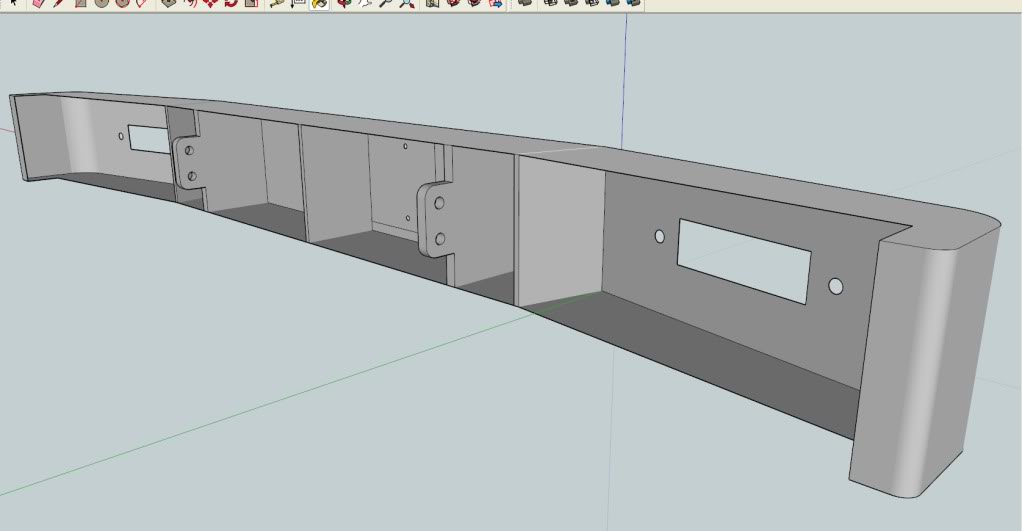

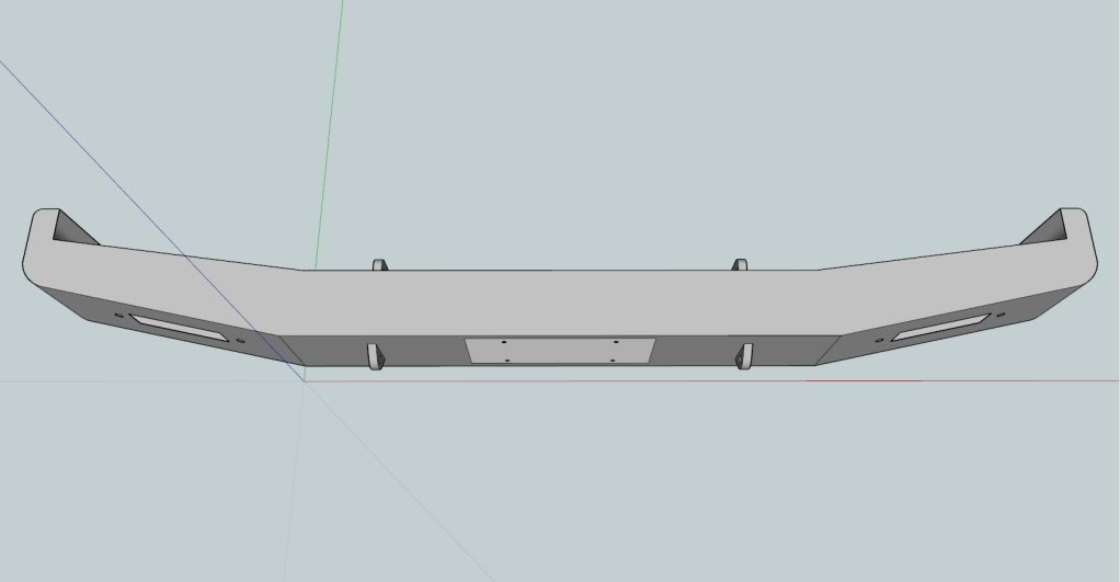

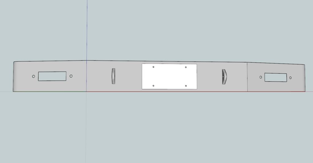

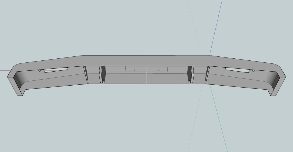

I got this new software at work today called SketchUp - It's a 3D modeling and design software. It's really easy to use and turns out some pretty cool products. So in my need to learn the software for work I decided to design my front bumper. I originally had a different design that had a little more of a off road look, but I'm going to go with something a little more conservative to keep it looking more stock. Obiviously I'm no where near building a bumper in my build, but this is what I'm mostlikely going with.

I like that a lot. Sketchup is a sweet program. I used it a bit in high school to design some robotic arms and stuff, but I'll have to give it another shot.
Where is your winch going to mount?

I doubt that I'll ever mount a winch, but if I do I have allowed my self just enough room behind the bumper to mount a small winch. And I will be using 1/4" plate steel for the front portion (3/32" for the rest) so that my D-rings are properly reinforced and I so that I will have enough strength for a winch but I'll probably never mount one. I don't do a lot of wheeling, just hunting in the woods and some occasional trails and mischief. Besides, chances are that if I ever get stuck I'll more than likely be with my friend who has a H1 Hummer... I'm sure he'll be able to get me out. Here's a pic of us hauling jetskis back to Ocean City with it:

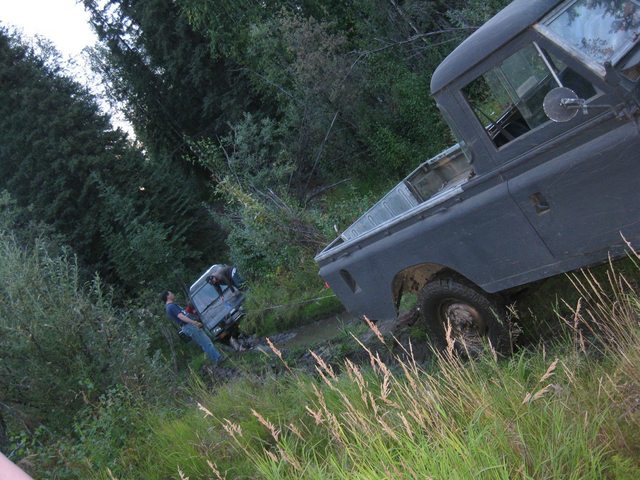

I think winches are great, especially when there isn't much room for another truck to pull you out.
This is my friend yanking his '83 Yota out of the mud using my Rover as a winch point. I was sitting on the only hard patch of ground in the area.

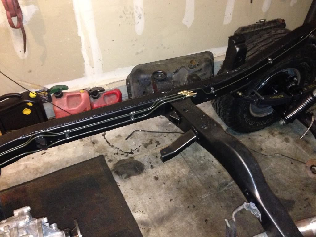

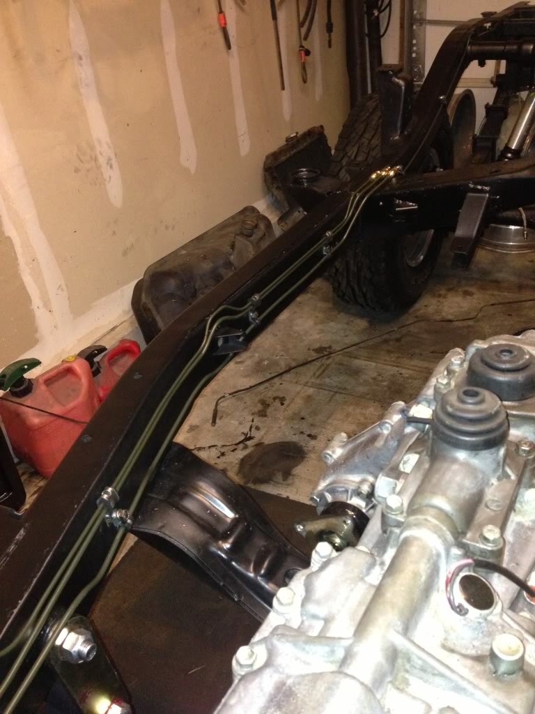

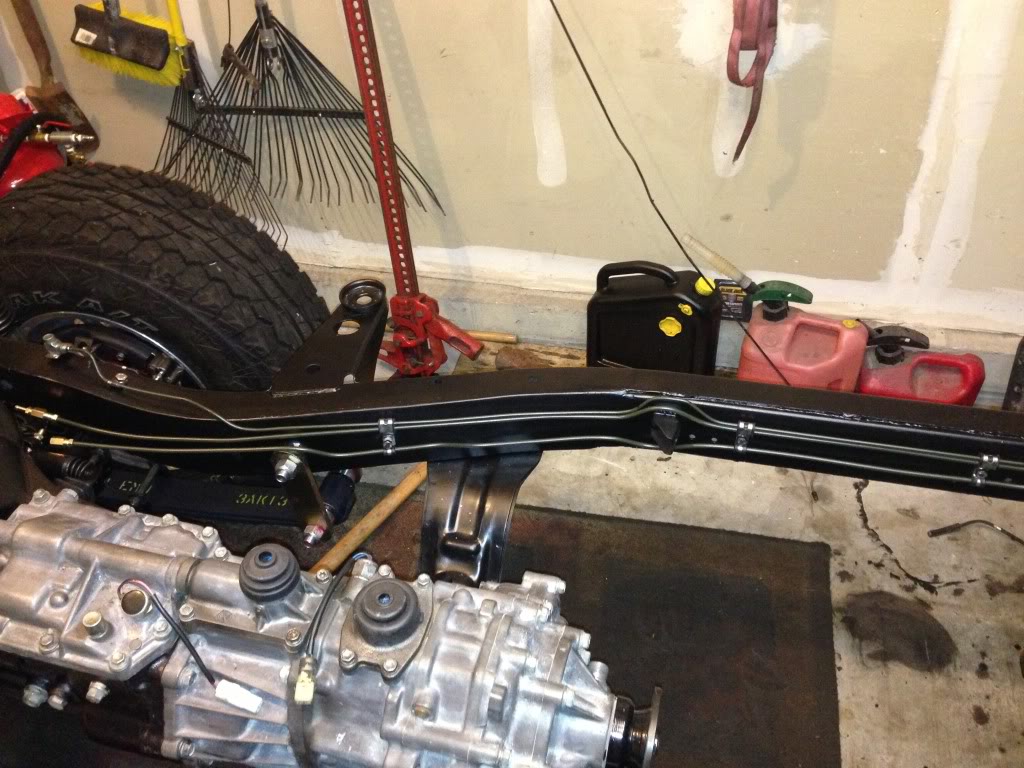

I got my brake and fuel lines bent and mounted tonight. Turned out pretty damn good I must say! I didn't want to mess with the coiled up brake lines so I used a 6 ft and 5 ft pre-flared sections of straight 3/16" brake lines and unioned them in the middle. I only had to cut and make one flare on the rear section where it would fit into the LPV if I had one. Ideally, I could have used two 5 ft sections and not have to cut and flare anything at all (But that would be too easy, right?!). I pretty much routed it the same way that the factory routing went, but still need to drill and tap a new hole for the clip where I patched up the frame - I actually boogered up my first attempt and managed to brake my tap in the frame so I still need to figure out how to get the tap out. I'm also thinking about getting a spark plug retainer or something to secure the three lines on top of the cross member so they don't end up causing rattles. Other than that, it's pretty much done until my extended braided steel line come in from LCE. Now it's a long waiting game and plenty of praying that there are no leaks after all of my brake upgrades!!
Old Jul 20, 2013 | 09:30 PM

Oh, I forgot to mention... I will be mounting the manual load proportioning valve under the hood directly off the 1" Bore master cylinder. If I end up needing a residual valve I'll locate that under the hood as well.
