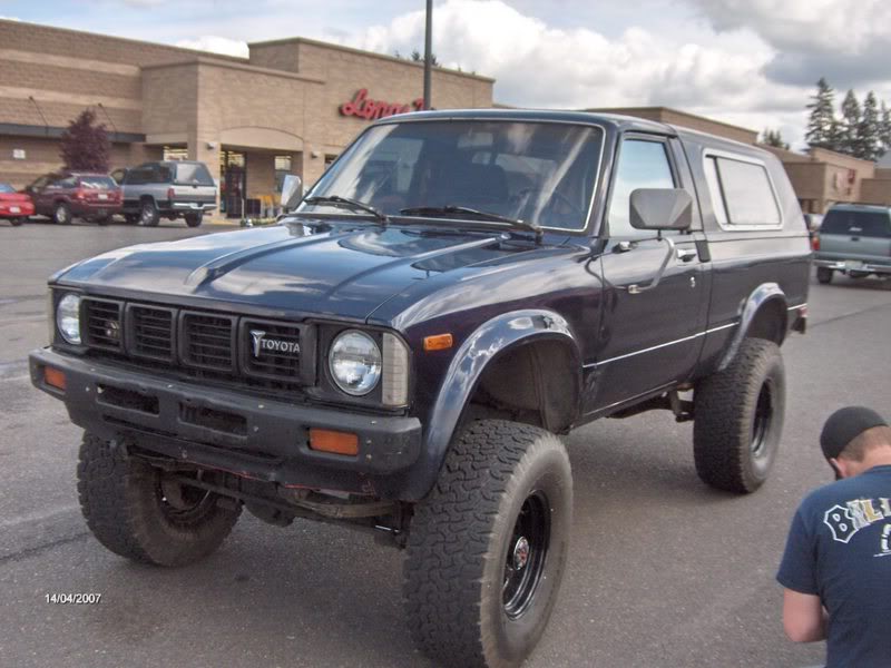

when I picked it up:

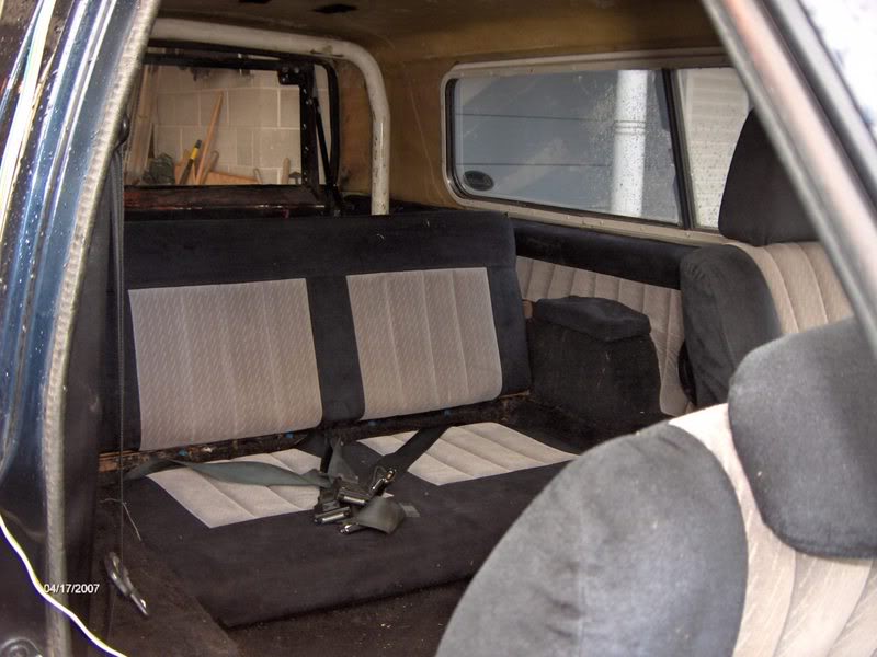

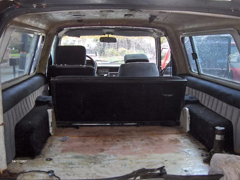

Interior shots:

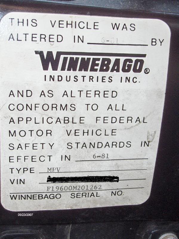

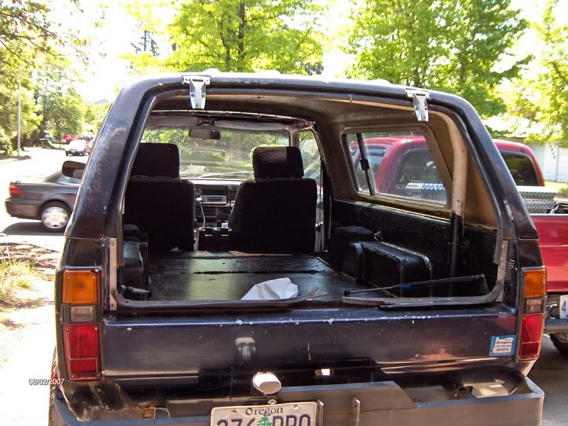

Rear Before:

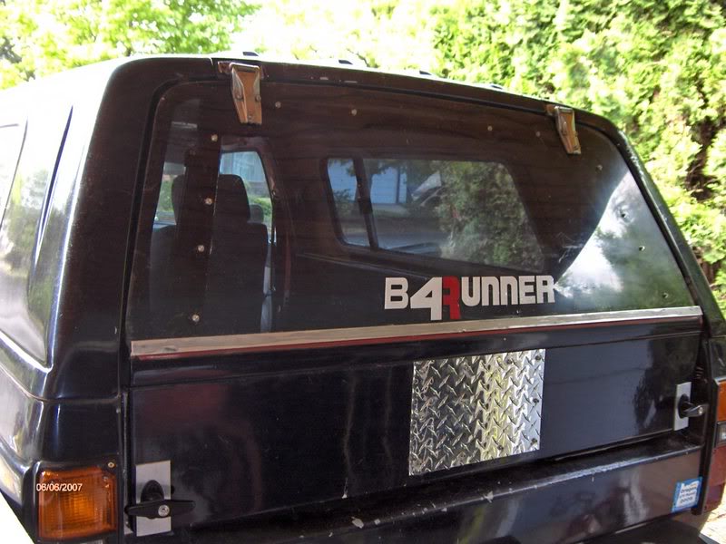

Herculined the back:

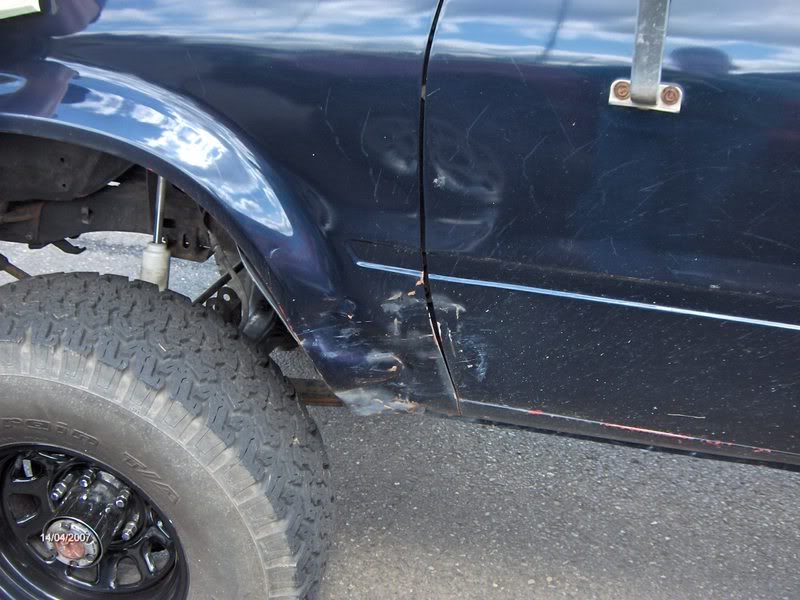

Only real body damage:

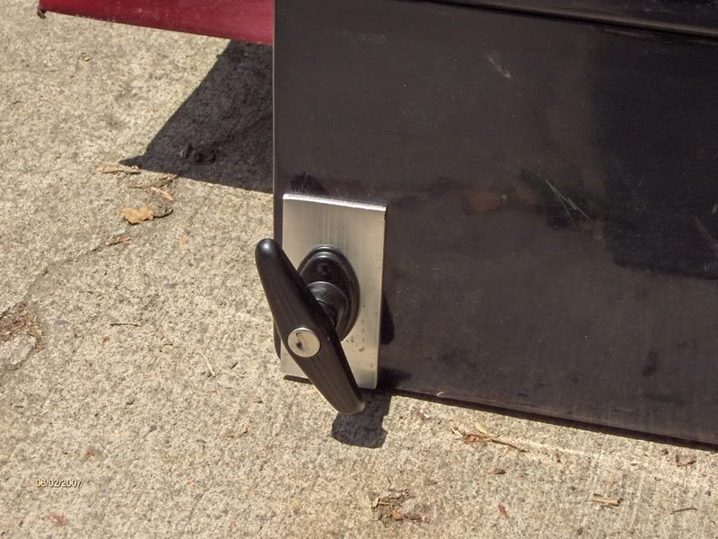

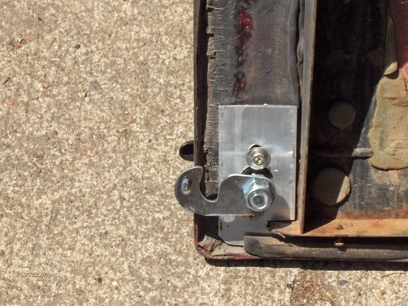

The lock for the rear hatch was fubarred so I picked up a set of match canopy locks off ebay and came up with this--aluminum to help strenthen the fiberglass and an aluminum striker plate on the inside lip. Need to find a new rear seal or something that might work...

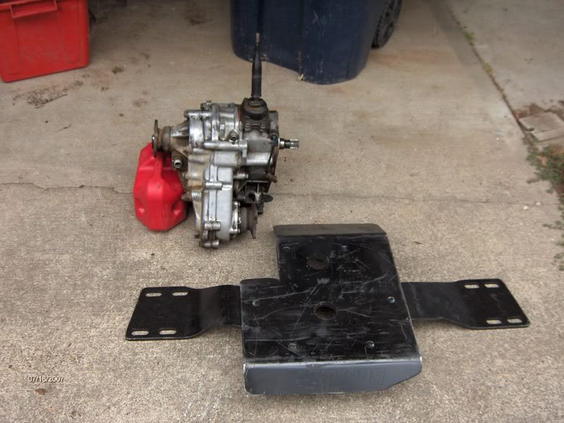

Well a little update. Haven't really been doing to much but driving the '81 a day or two a week and trying to accumulate some parts.
High Steer is on hold for now so did a dropped drag link and put a another steering box on in conjuctions with a steering rod Pokey hooked me up with. Steering issues (for now) are a thing of the past.
John aka Luv24by hooked me up with a seller on ebay, picked up a set of Trail Gear front springs and a used BudBuilt 1stGen Dual Case CrossMember and skids way cheaper than I ever expected. So are course with that I had to find another transfer case. Will be converting it to 23 spline based on the Wisdom of WaskillyWabbit (Brian) who has been a wealth of info
