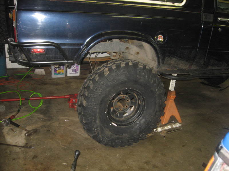

I headed down to Mt. Angel to see how Derek was doing on my truck..its been awhile but the price for what he is doing is worth the wait...He said I should be able to pick it up next week, we'll see but fingers are crossed.
he was just in the process of starting on the rear suspension when I showed up:

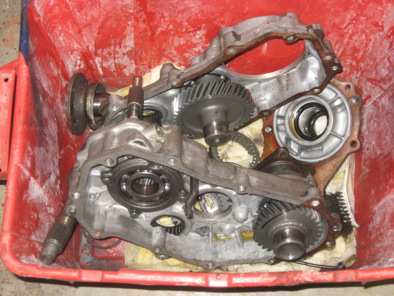

nothing big, but here is what you have left when 2 transfer cases become duals
between the donor case everything was in pretty good shape. i was worried about my $50 donor TC being junk but everything on the inside seemed to be good to go...

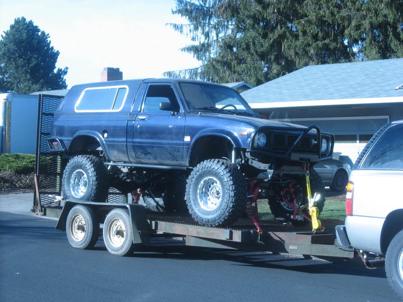

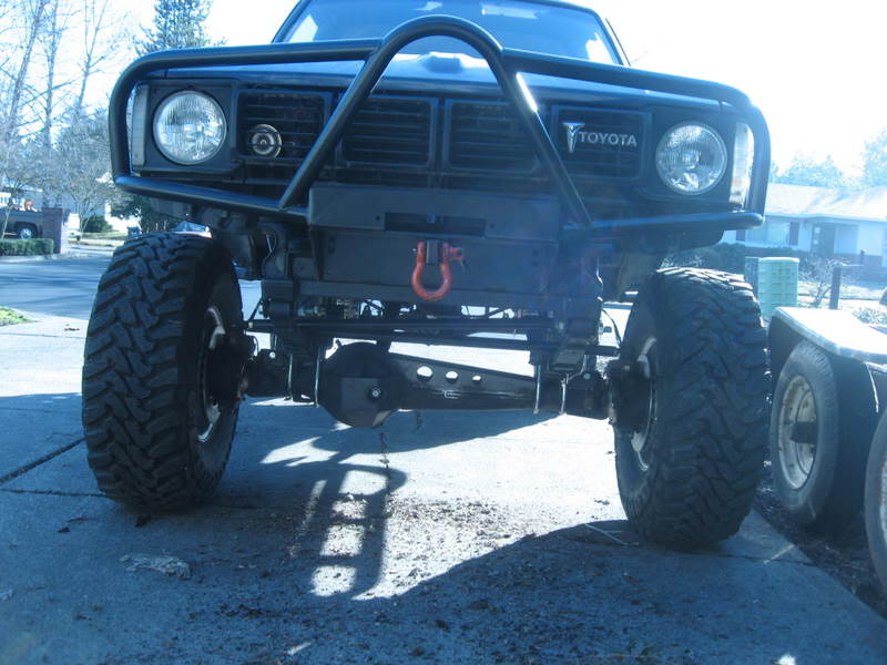

Well I was finally able to head down to pick up the trekker. Took longer than expected but for what I paid for the amount of work I am very happy.
--All the bare metal has been cleaned and painted after the pics were taken..
What was accomplished:
-Rebuild front end, ARP studs, front aussie locker installed, FJ rotors and V-6 Calipers, front diff armor, truss and knuckle gusset kit

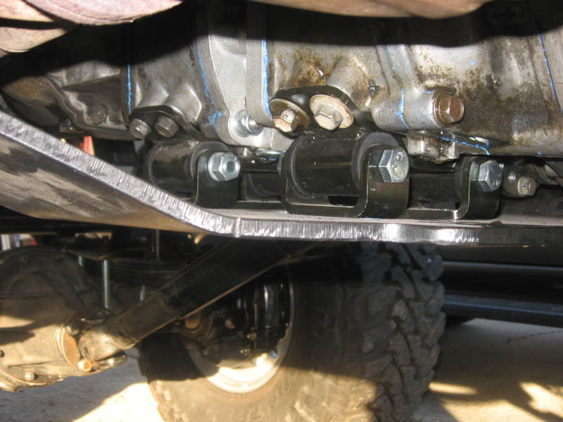

-dual cases 2.28 in front case, 4.7 in rear case and Front Range Off Road Twin stick, Bud Build crossmember..

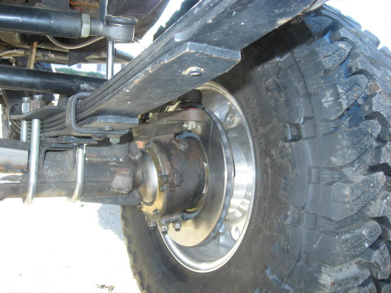

-5" T-G rear springs installed
-Front Shaft lengthened and rear shaft shortened

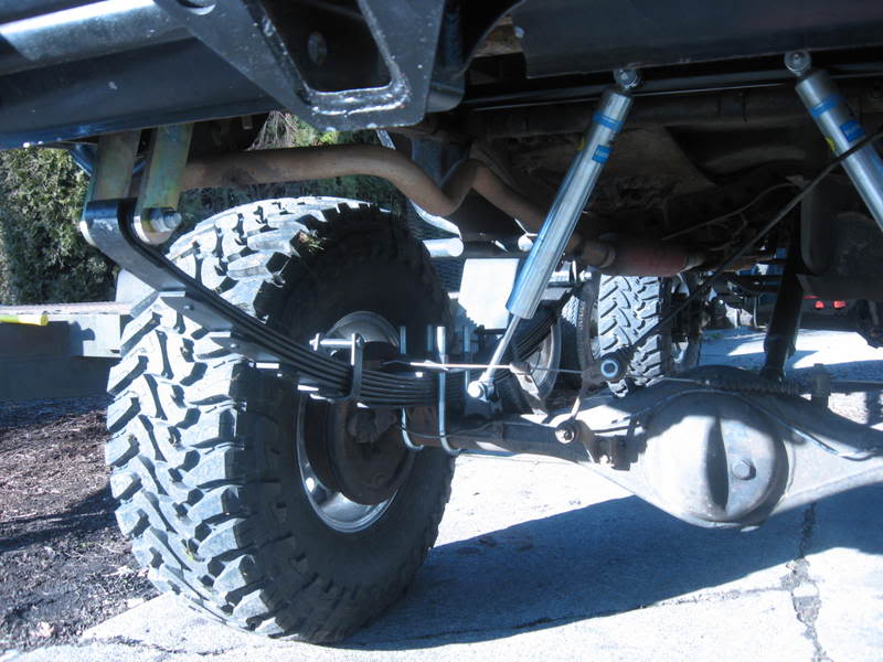

I really like using axle strap tie downs vs. the chain binders I have used in the past hauling.
The truck sit a little high in the back, but T-G springs have a reputation of settling...if not I can pull a leaf:

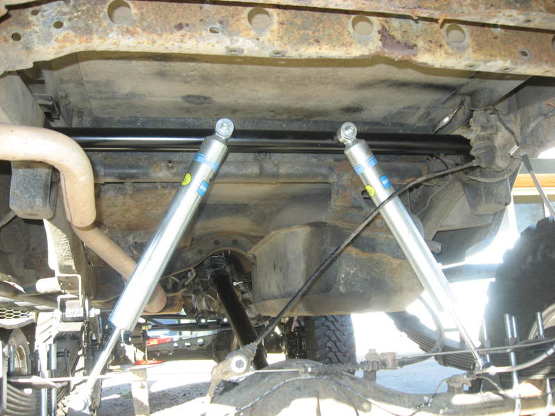

Derek fabbed up a new upper rear shock mount:

no backing plates:

I am very happy with Derek at Revenge Fab's work...need to take it on a shake down run. A little trip around the block everything seems to work.
Thanks for Brian at Wab-Fab for giving me some great deals on parts.

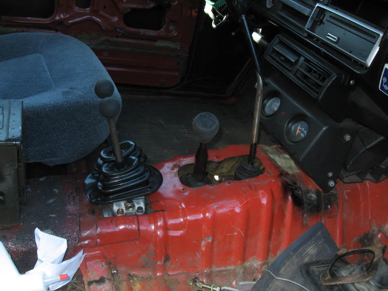

-rubber boots around the shifters...might need to dog leg the front TC selector
