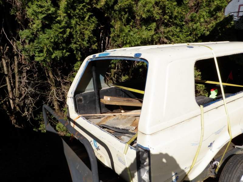

well as most of you know Trekkers are getting harder to find. I still want to wheel mine, going to be more careful but had an opportunity that I could not pass up.
picked up a spare trekker bed and cap...it will go into storage 'just in case'
it is far from being in perfect shape but in repairable condition...way cheaper than regular first gen beds sell for

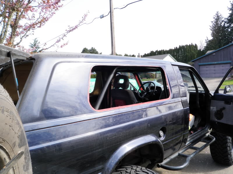

well been driving the Trekker the last couple of days..needed a new battery and a clutch slave cylinder..when converting from a L50 5 speed to a L43 4 speed you need the adjustable slave cylinder rod...having that got the clutch working fine still gonna be a little while getting used to the 4 speed... but for a cheap deal off of craigslist..IT WORKS
one project that has been put off for a while was a fix for the leaky side windows...some Trekker urban legends was that 81's were the only Trekkers out of the 81-83 production that had the sliders...Winnebago and toyota killed them due to leaks...as much as mine leaked I am inclined to believe that little rumor..
Anyway on to the way to solve it. Made a trade for some stuff with my Trekker bud Paul for some solid side windows, today it was nice and our scheduled clicked so we were able to do the swap.
the sliders are nice but 95% of the time no one is in the back:
my sorry butt getting ready to do some work:

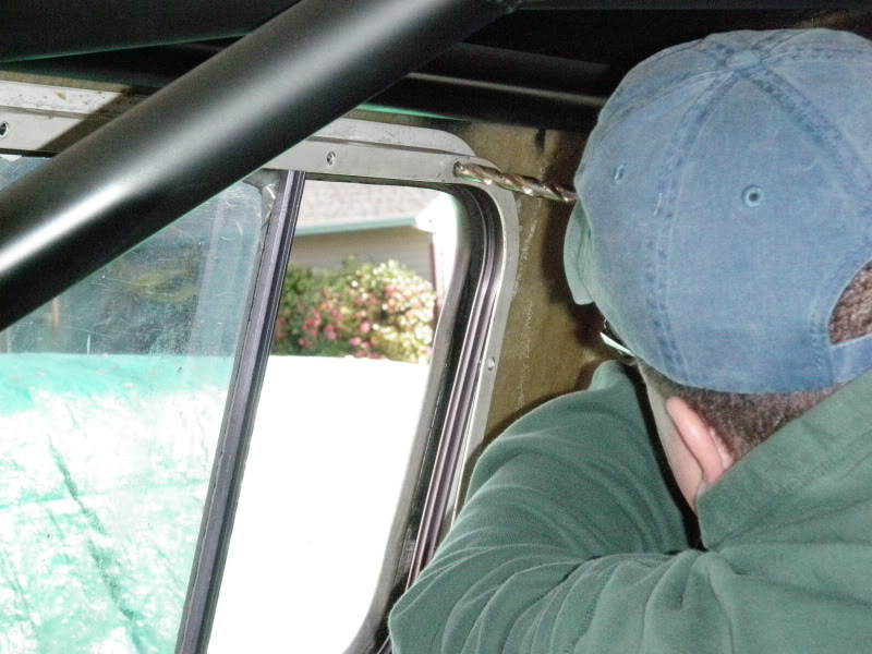

all the screws came out easy but there is always one...drill and grinder took care of this stubborn one:

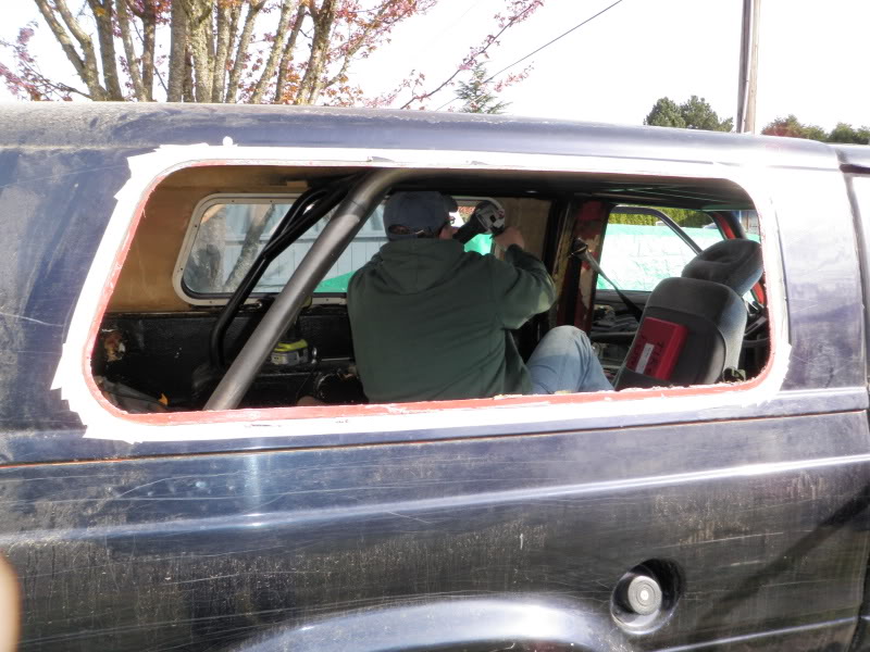

with out the windows in there the breeze was kind of nice:

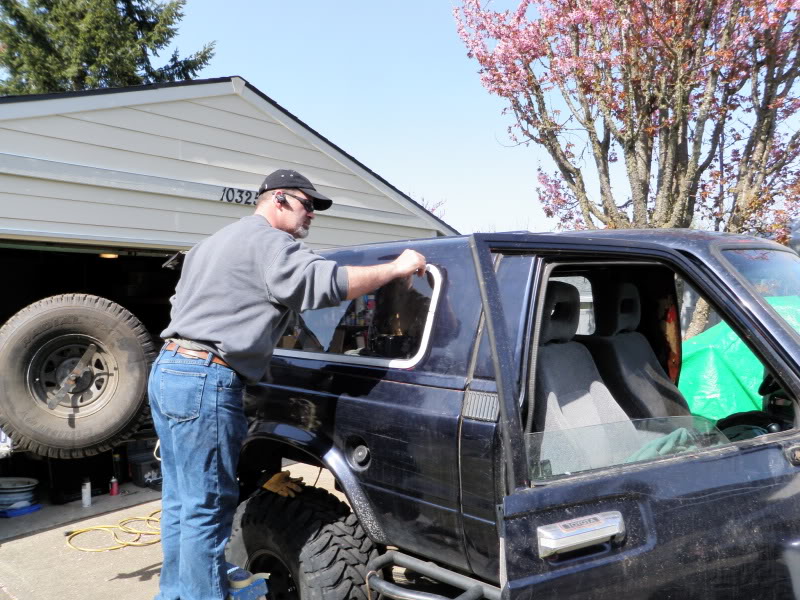

Paul knocking some seal clean up:
learned a little trick mask everything--windshield sealant is sticky:

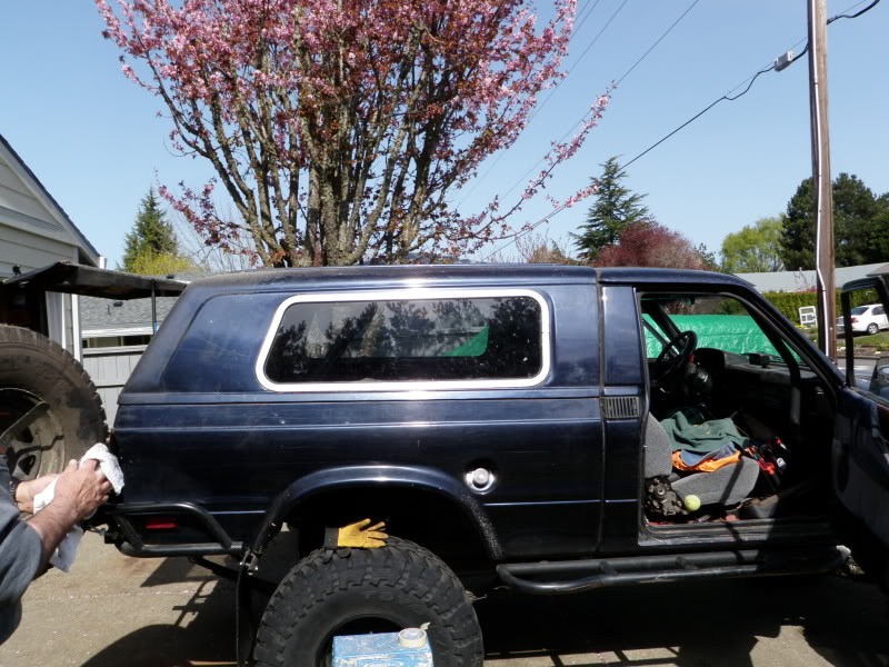

finished product, no leaks, more secure
it was a good morning project getting it done...definitely a 2 person job..thanks for your help Paul

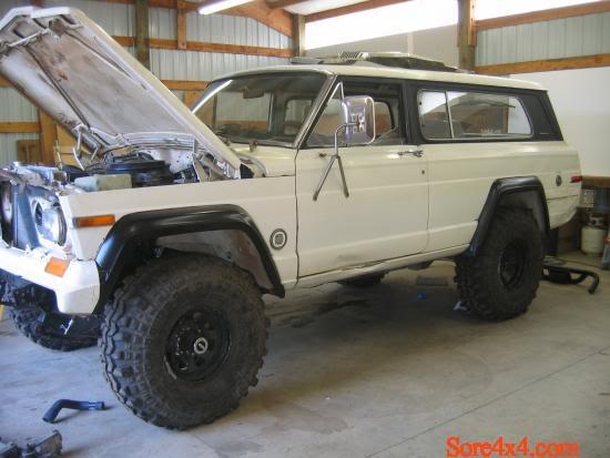

it looks like the size and shape of those windows are pretty close to the same as the windows on my full size jeep cherokee....
they have a wing window (no slider) and never leak....
might be interesting to put a tape to them and see.
