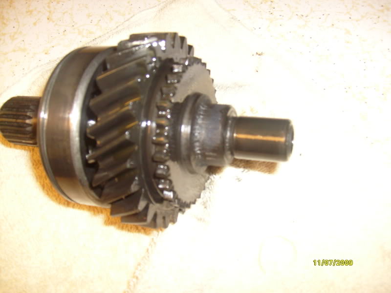

Finally got the transfer case apart. Looks like the thing kicked into low range and fried the bearings on the input shaft, no thrust bearings left
If I have to flat tow again I don't care how crappy the weather is I will crawl under and drop the driveshaft

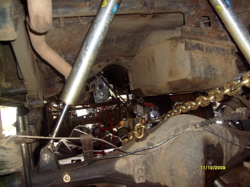

slowest transmission replacement continues

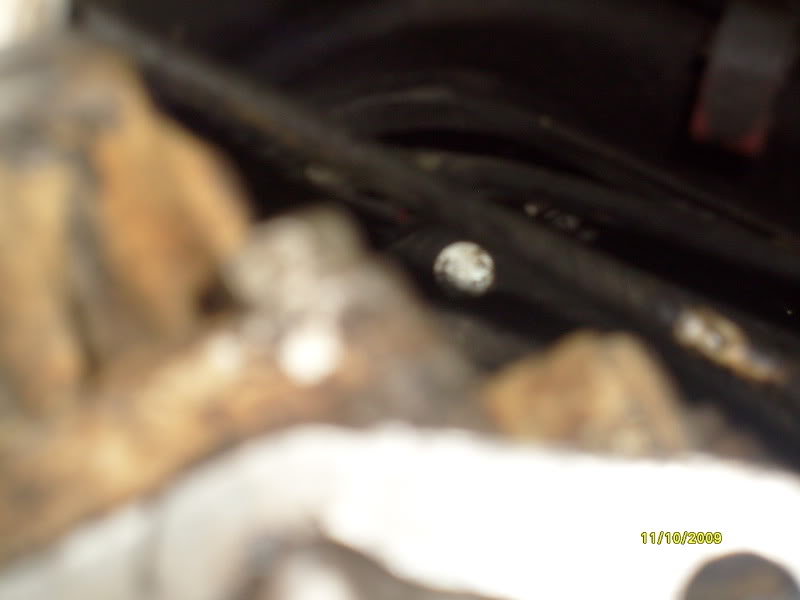

So the slowest transmission replacement in history continues
Finally got the busted one out.

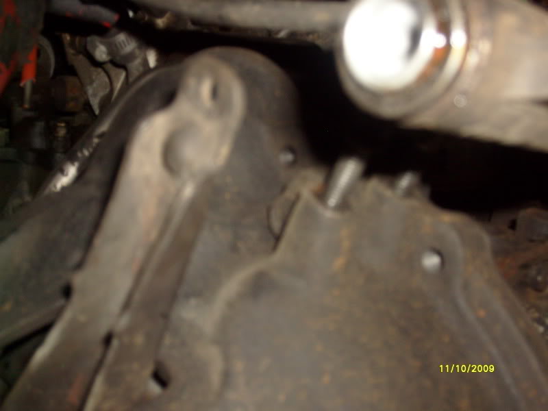

One bolt was kicking my butt, top right bolt, broke 2 sockets and one breaker bar on it...it is metric but I am pretty sure it wasn't stock:
also don't forget the one behind the pivot for the throw out beearing:

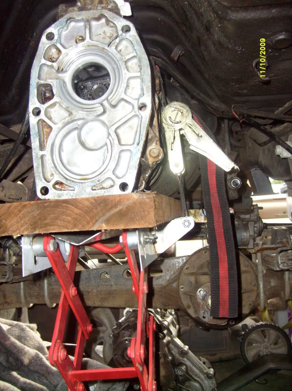

A guy at work loaned me his transmission jack, used a 2x12 to gain a little extra heighth:
frigging thing still did not want to pop off, hooked up a little come along, one click and the transmission popped right off:
can't believe that it was this big of a PITA to get out but finally out...

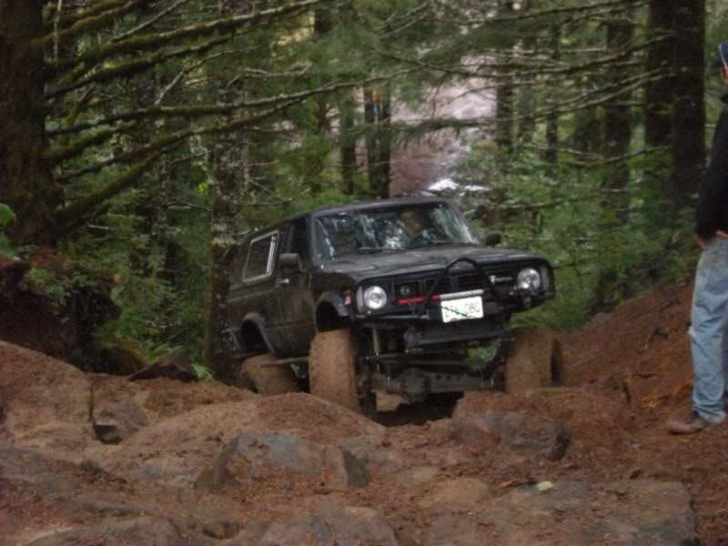

Somebody on Pirate has some pics of my wheeling trip with Al from september:
These are from the top of Canopener at Brown's camp...I really need some tires that don't clog so easy

i'm glad someone got some good shots of you heading up canopener.
i always forget how gooey the clay is up there on that trail. some TSL's would probably have been the ticket that day.

yeah it was pretty gooey, but maybe lower pressure like you said would have helped...I will be using these for awhile unless I find some 37" Iroks really cheap...not holding my breath...I am glad too that someone had some pics. It was the Kid with the '89 X-cab SAS with 38's and beadlocks not sure if you remember him, he was hammering on it pretty good

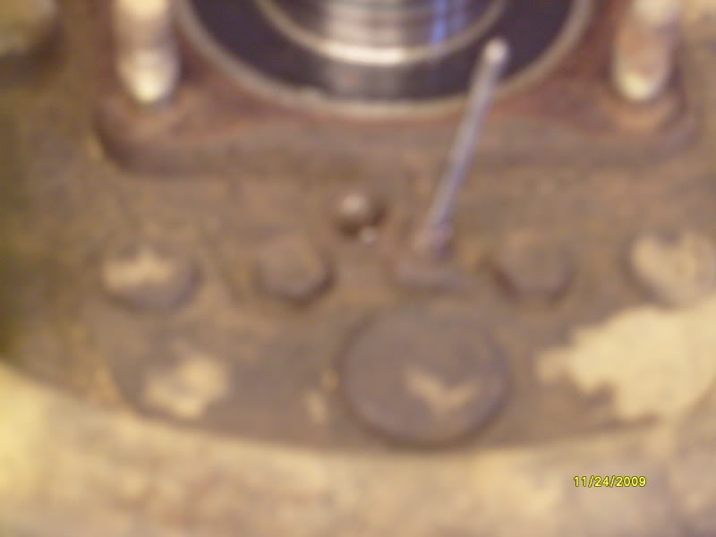

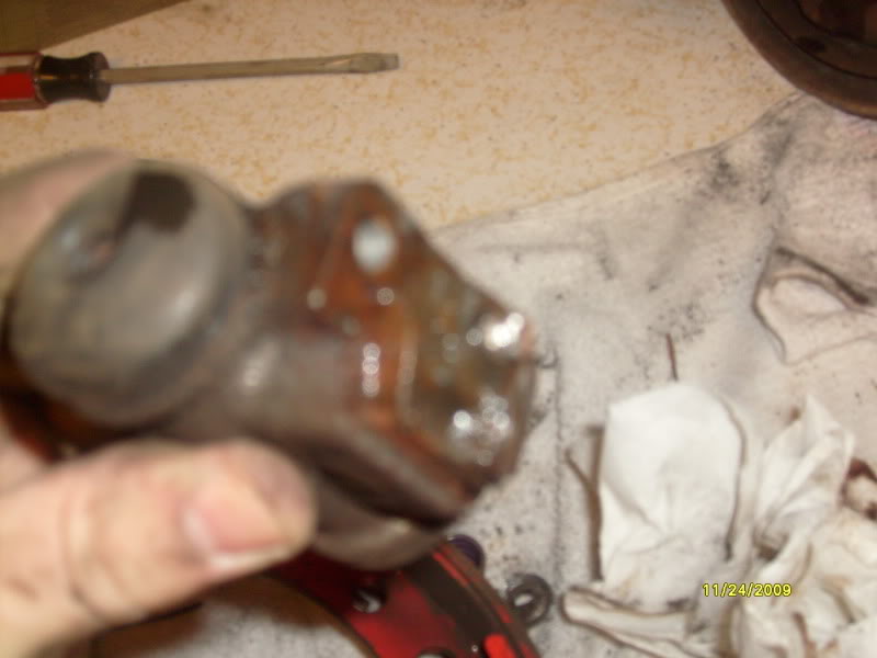

Talking kitchen wheel cylinder replacement
I thought for sure I was busted today when she came home for lunch and found me doing a wheel cylinder replacement in the kitchen
She was totally cool, just said to be sure to clean up my mess
I had broke off the bleeder screw, couldn't it out with an ease out so thought what the heck bring it where is was warm
so much quicker to work on when the axle is off the truck
edit: yes I went back and put the shoe guide thing back on under the springs--
hoping for a new camera for x-mas...these pics kind of suck...the POS I have been using has been dropped a lot
