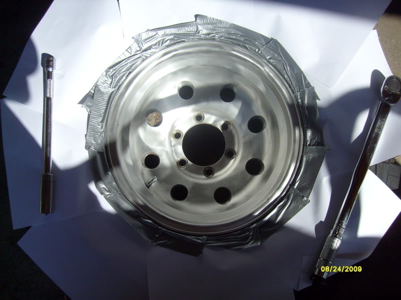

painted wheels
not much tech here and I know a ton of people have done this but been wanting to do it for awhile so here ya'go:
before anywork:

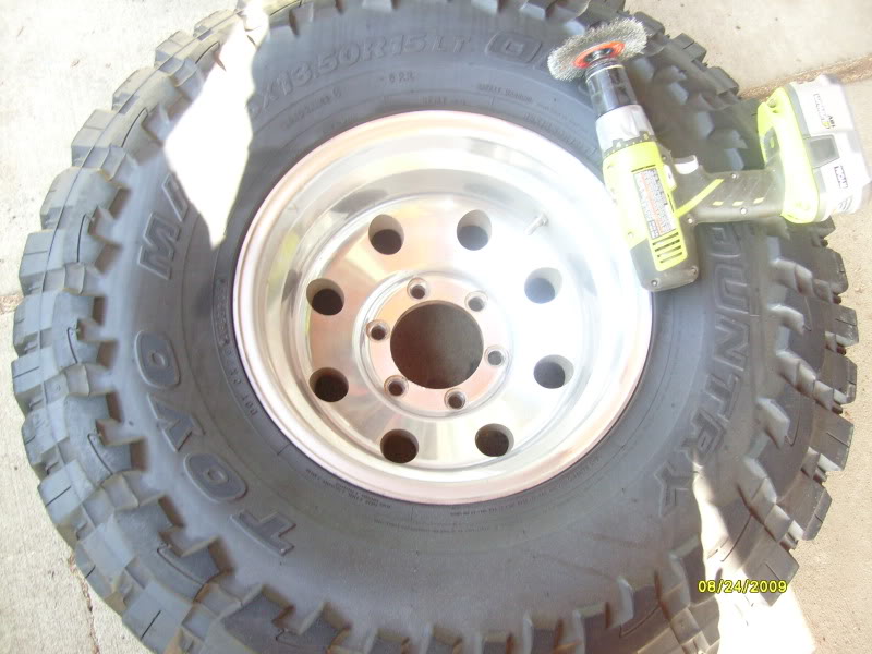

about 30-45 minutes with the assorted wirewheels got all the clear coat and road grime off:
cleaned it off with some IPA (isopropal alchohol) works great for cleaning stuff in the cleanroom I work in. picks everything up and dries fast:
yeah duct tape sucks, the next two rims I did I used masking tape...
used crapoleum wheel paint, got a couple of rims out of a can, so used 2 cans.
instructions say to do one light/dry coat than wait a little while and do a wet coat.
I did 4-5 light coats. feel the finish came out better than it did following the instructions on a previous truck.
still have one more rim to do...for a low budget but kind of time consumer project I am happy with the looks...especially since the finish on these craiglist rims was kind of crappy to begin with

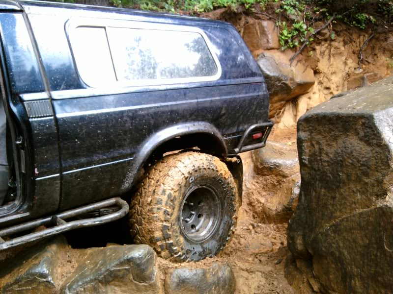

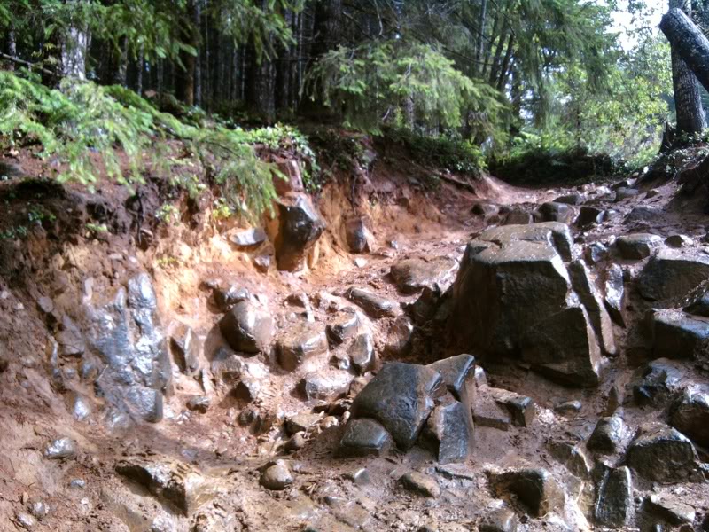

Went Wheeling today
After of trying for about a year, finally got to meet up with Al (al's chop shop) and do a little wheeling. AL is a great guy, very helpful for spotting and knowing the local trails..Even helping me from flopping today
camera died early in the trip, had to resort to the cell phone

I made it up to the top of can opener but couldn't get over the top...very wet.
38's might have helped like they did for this guy:

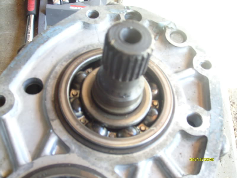

busted some stuff

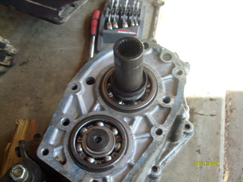

Guess the lack of strength of my L50 transmission showed up and popped something while wheeling last weekend...it has always kind of made a noise since I bought it 2.5 years ago...but finally let loose saturday morning with a couple loud tunks..
just in case I pulled the 3rd and checked it...looked fine, a 30 minute process of elimination.
pulled the dual cases...not good when part of the transmission comes out with the transfer cases:
clip is from the crawl box...
fried the input shaft (21 spline) and bearings,if you look close you can see the heat marks:
4.7 box seems to be ok:
need to pull the cases further apart to check for more damage...but it all seems to be ok...and yes I checked the oil passages between the cases, no blockage...
truck is gonna sit for a while till I can get a new transmission and another case hopefully find a W56 or something cheap

i can't see how heat could have built up to do that kind of damage when wheeling, at least in the transmission side of things. you had her revved up pretty good on canopener but i can't see that as to generating much heat. all i can think is that if you left the t-cases engaged in gear (especially in low) when you towed it home, that would spin the trans gears extremely fast and could cook the bearings.
when i get back from the honeymoon i am dedicated to working on her toyota. i'm thinking a wrench-o-thon is in order. bring the trekker over, i'll fire up the BBQ.

yeah that is pretty much the same conclusion I came to ...bonehead mistake... one trip i don't take out the driveshaft it bites me in the butt...haven't even touched the thing.
Kind of want to see what the trans looks like though since the oil in it was scorched but the tranfer case oil was clean...
either way truck is laid up for awhile till I figure out if I want to sell a couple of boomsticks or what...

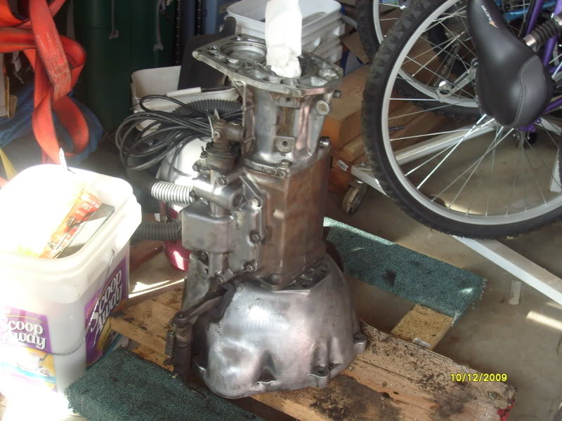

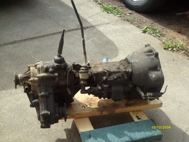

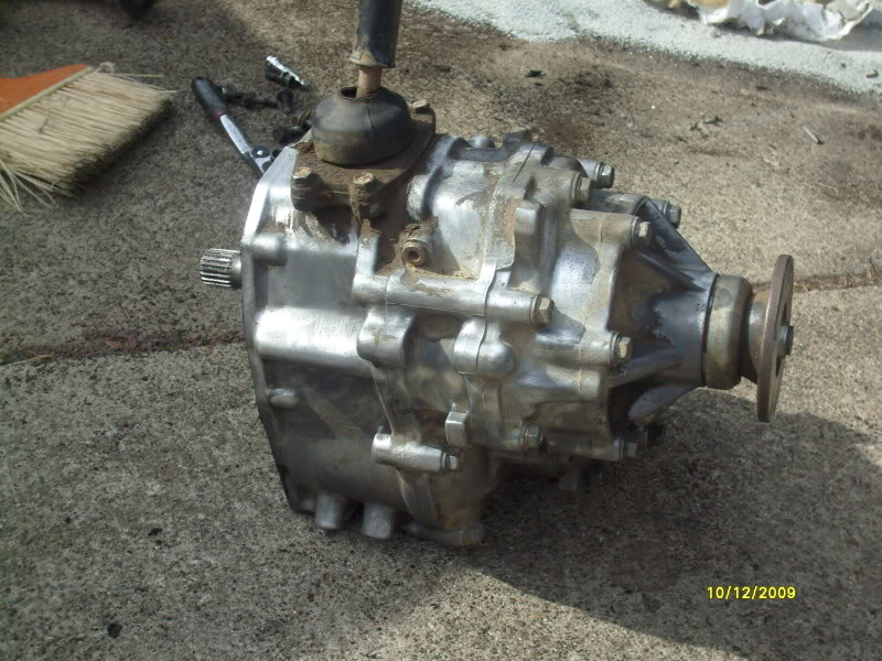

I picked up a used transmission and transfer case recently to replace the one that took a dump on me...cleaning it up I needed a place to put the bolts and washers, remember that I had bought a magnet parts bowl at harbor freight awhile ago for like a buck or two:
thought it was kind of cool till I realized how small it was as I was grabbing a pop out of the garage fridge and saw all these magnets on the door...hmmmm
looked at all the x-mas cookie tins on the shelf, glanced at the drill.
had this a few minutes laterL
20 times the capacity with a lid...
...bad part is that is it a 4 speed but it was dirt cheap, seems (fingers crossed) to be in functioning condition and other than being dirty:

spent some time with a wire wheel and wire brush it cleaned up pretty good:
did not find any cracks or anything. I just need to get a reverse light switch (might be able to use my 5 speed one) and some rubber seals for the shift mechanism, i think I might actually have some...
now just need to get the time to pull out the 5 speed and swap the dual case adapter over...
need to get this thing back on the road and get wheeling
