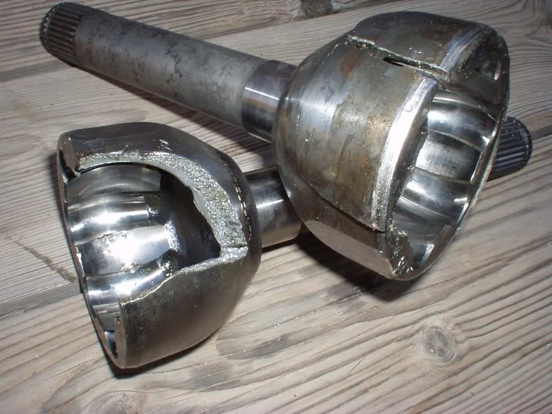

in an effort to avoid breaking something like this and to lighten my spare parts load by 50 lbs:
(broken birf pic borrowed from google)

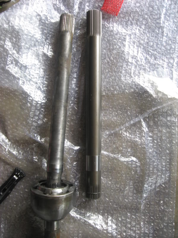

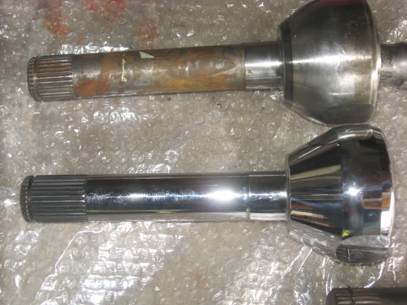

ordered a set of chromoly dirty 30's from trail-gear...i know the whole longfield debate...these were in the budget and allowed me to do some other stuff..
dirty 30 compared to my spares:
quite a bit beefier and a lifetime/no ?'s guarantee

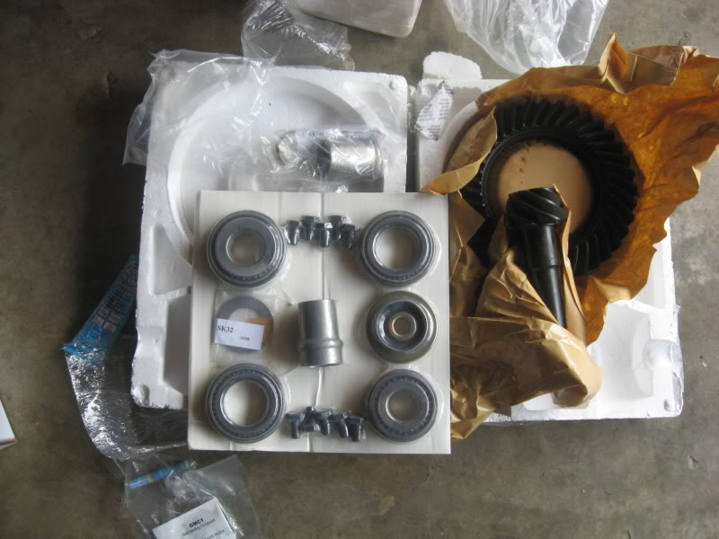

5.29's , master install kit's and solid pinion sleeve should put the RPM's back into a more friendly range...and my double low first gear crawl ratio goes from 163:1 to 220:1

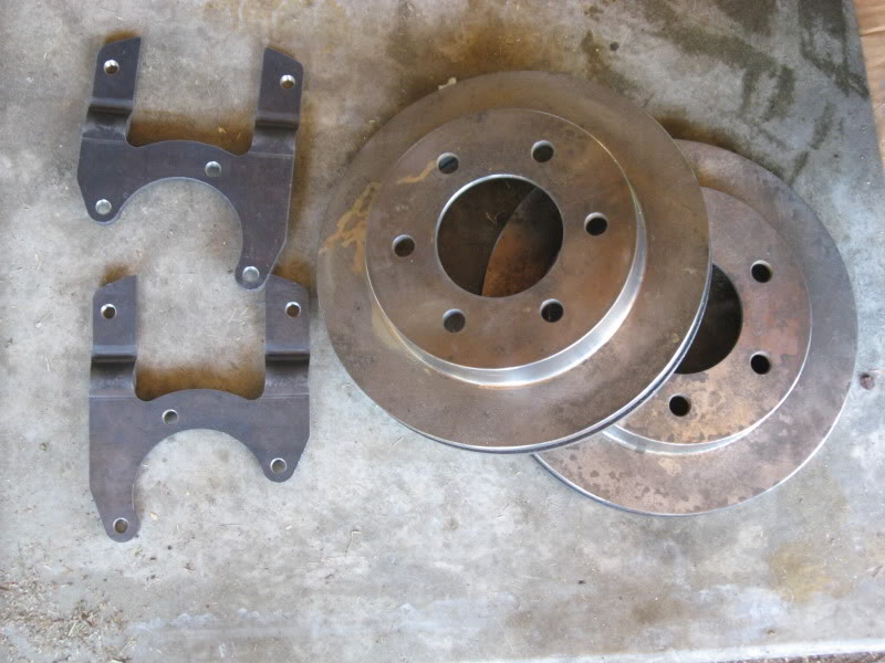

rear disc brake kit
forgot about this smoking deal that I picked up from a local trekker bud, Paul.
a sky's rear disc kit. I have got one core caliper and have a lead on another one...hopefully have it mounted sometime before the end of the summer (2010 maybe)
