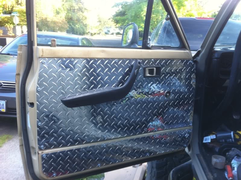

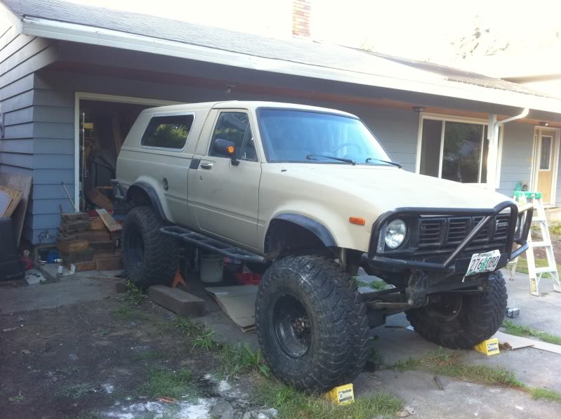

So got a free day finally
Did the typical diamond plate door panels, PITA cutting with a sawzall, no jigza bladds
Sanded the rest of the truck down...didn't get pics of the top of the fiberglass canopy but it is certainly rough...a nice afternoon, a few hours and a few cans of rattle can camo tan the truck is finally one color
An Oregon Yotatech'er (sorry don't remember who) brought up fender flares a few weeks ago...sure enough saw another local wheeler pulled over, no flares, or mudflaps on 38's or some big hunk of rubber so took advantage of JC WHitney's labor sale sale and orders a roll of flexible rubber fender flares...not the greatest stuff certainly not Bushwacker quality but it was cheap and should serve the purpose:
yes it is ugly but it works

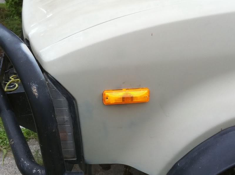

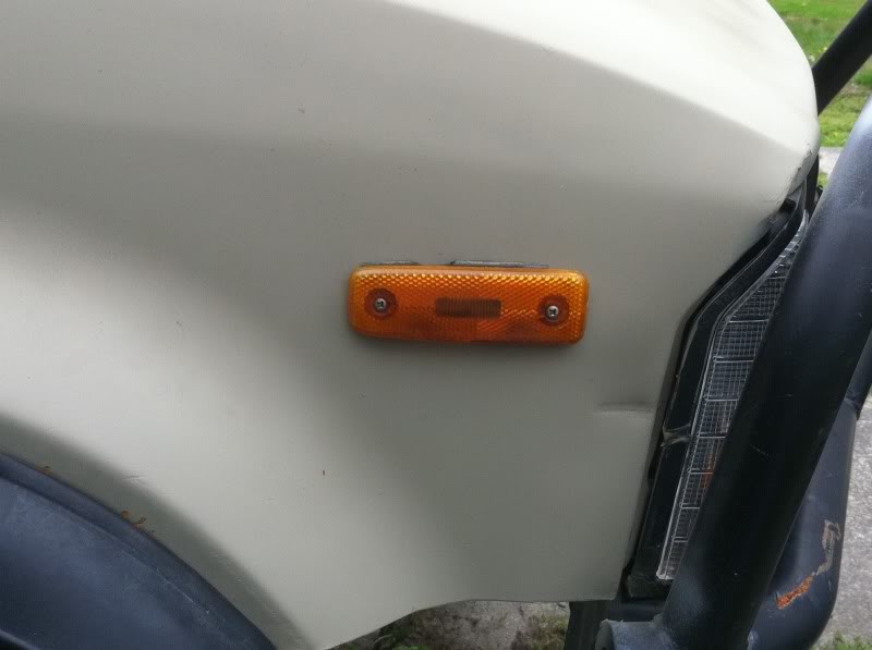

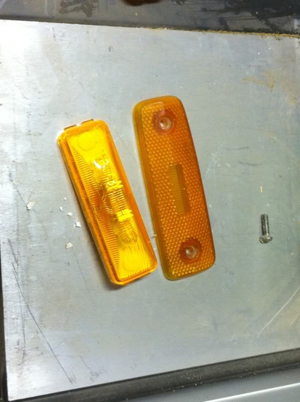

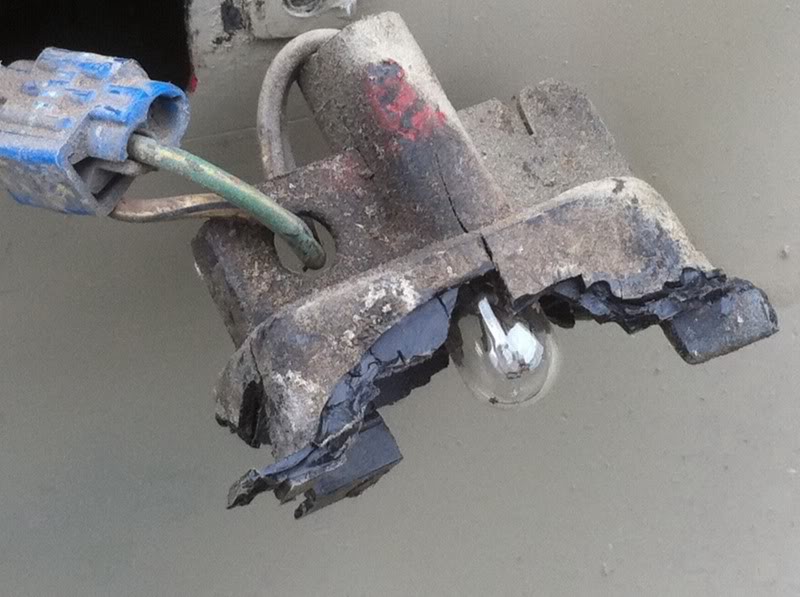

side marker light
So I gave TrekkerPaul a call today to see if he had some spare side marker lights...he is looking for them too. I looked around for a similar set of lights to what Rowdy235 had found a couple of years ago.
Most 1st Gen owners know what I am talking about...you touch a 30 year old light and melt in your hand, my lenses are in awesome shape though:
didn't see one like Rowdy had found so I settled on this...:, they are a hair shorter than the stock lenses:
Matched up the sides, used the lense as a template on the drill press, allows me to use the stock mounting holes:
since the new light is open on the inside, filled the drilled hole with some silicon, than counter sunk the outside hole to allow for the screw head:
It is not quite the same, but is works...had to solder the leads on the back, too cheap to buy the pigtails

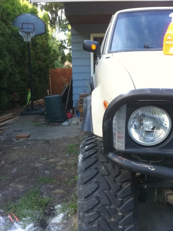

Al: I picked up the Red LED marker lights for the rear...found out something nice too--bullet connectors slip right on to them...not sure why I didn't try that on the front markers instead of soldering them...much easier connection

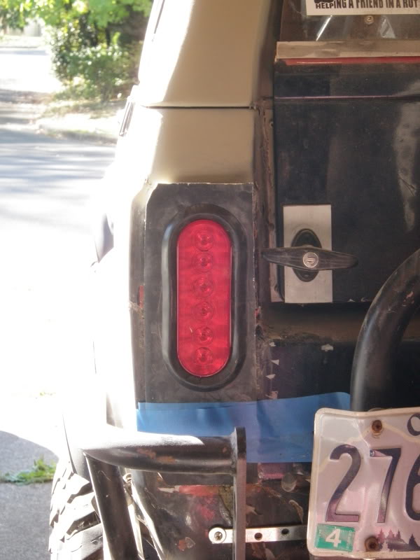

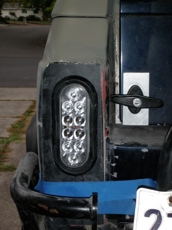

decided to make myself useful and see about a possible conversion for my rear tail lights.
I know some of you would not get away from the traditional 1st gen tail lights, but I seem to either break them or they have been stolen (Lense 2x's in 3 years)
anyway cut out a section of a rolled 1st Gen 4Runner roof my wife has been wondering about for a year or so:
it kind of has a nice curve that might come in handy
the roof is from a rolled 4Runner...not sure if this is from the accident or some form of adhesive used for the head liner
took a little time to trim it to fit (rough) and put an LED light in there:
like said before, not a done deal but am kind of leaning towards this...lower amp draw, easier to fix, just would need a trailer light adapter to allow for the turn signal..

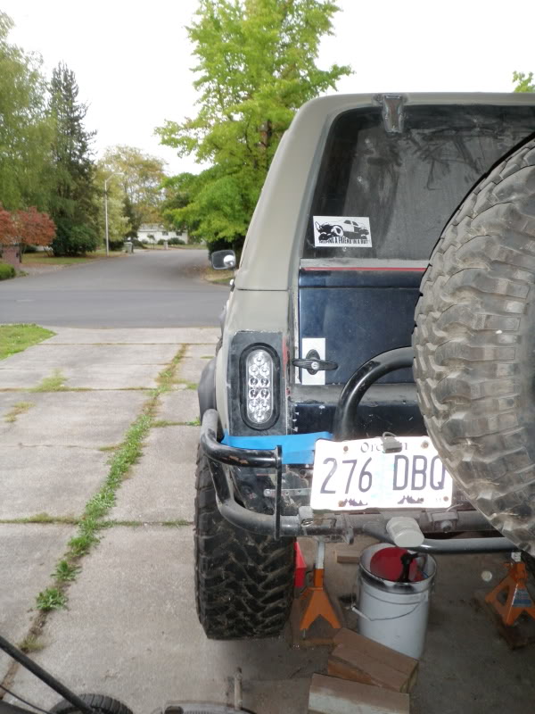

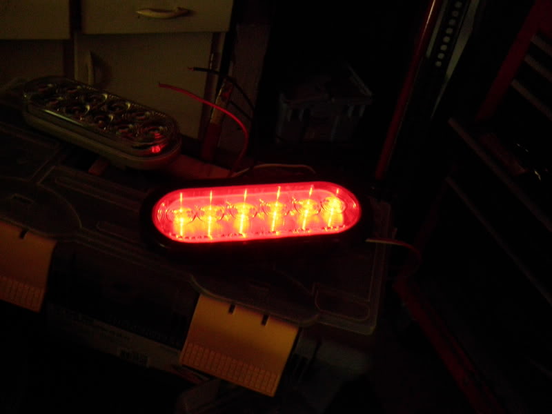

OK more on my lighting dilemma...go with the red lenses or the clear lenses...my wife doesn't like the clear (whoopy doo right)
I thought with more LED's they would put out more light:
tail light, 4 come one:
brake light:
brake light output:
red lense w/ 6 LED:
taillight:
brake light:
6 LED brakelight output:
so I am gonna do this LED conversion...which one do you guys think?
Red or Clear?
seems like from an output standpoint the 6 LED has more...
