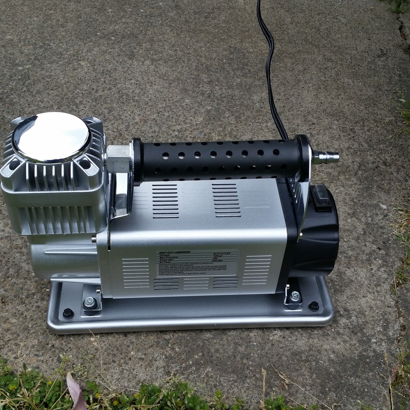

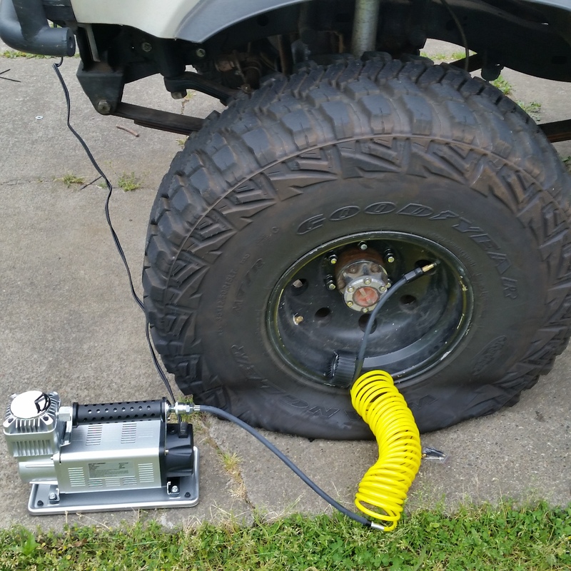

After paying $42 to refill my CO2 tank I started looking for alternative fast air sources.I thought about a Viair system but didn't think $400 was worth it.
Decided to give ebay a shot with a seller I have had good luck with in the past, picked up one of these, only bidder at $99
http://www.ebay.com/itm/HEAVY-DUTY-150psi-PORTABLE-AIR-COMPRESSOR-12V-HIGH-VOLUME-EXTREME-35-TIRES-/141672458890?hash=item20fc562a8a&item=141672458890&vxp=mtr
It basically looks like a generic Super Flow MV-90
it sucks a done of juice but is fast
Filled the empty 35x12.50 from 0 to 30 psi in a little over 2 minutes

Nice, you going to mount it to the rig?
The CO2 thing is cool, but I use my compressor for all my cars since they can be reached easily from my rig.
I think i'll leave it portable. I have a camp trailer and some other vehicles that it is nice having air. For.

Mine not being portable is one less thing I have to strap down or remember to pack. I've plumbed the rig to have air connectors at front and rear. Downside, as you pointed out, is the rig goes where air is needed. Even though it's slower then CO2, I'd rather have unlimited air filling then pay to fill a tank.

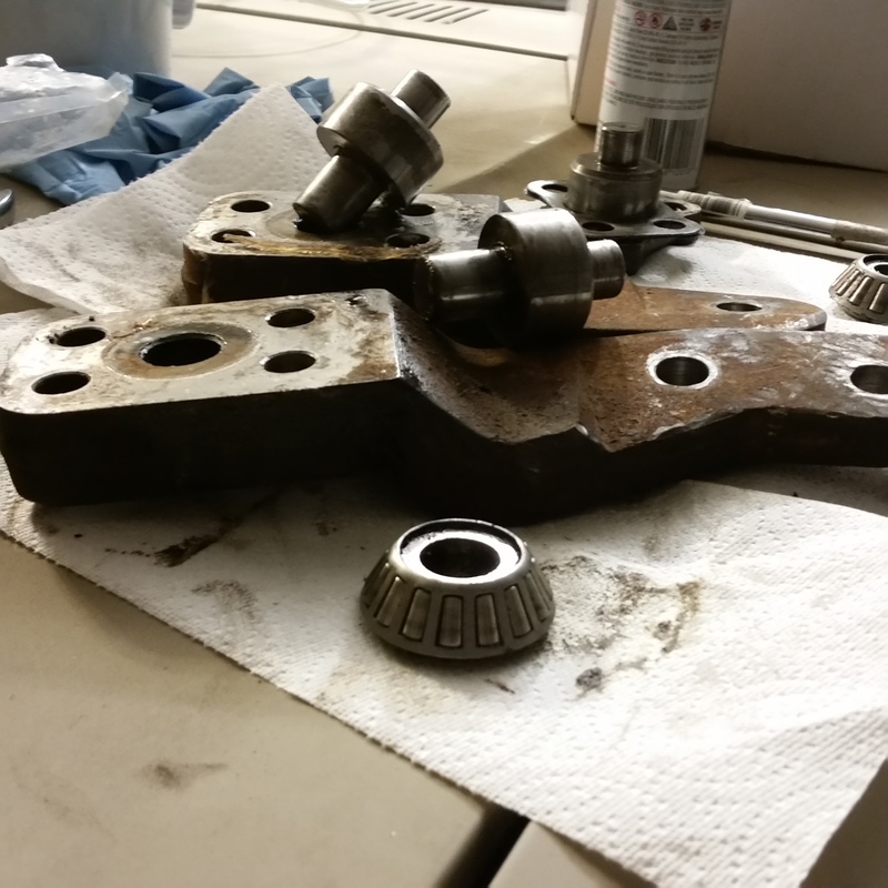

Sunday night replaced my tie rod ends, took it for a test drive..life was good.
Headed out monday for a Run out at Tillamook State Forest and all was fine until about 2 miles from the meet up spot and had death wobble from hell..checked lugs and they were fine.
turns around and drove the 20 miles or so home not being able to get above 30..it sucked.

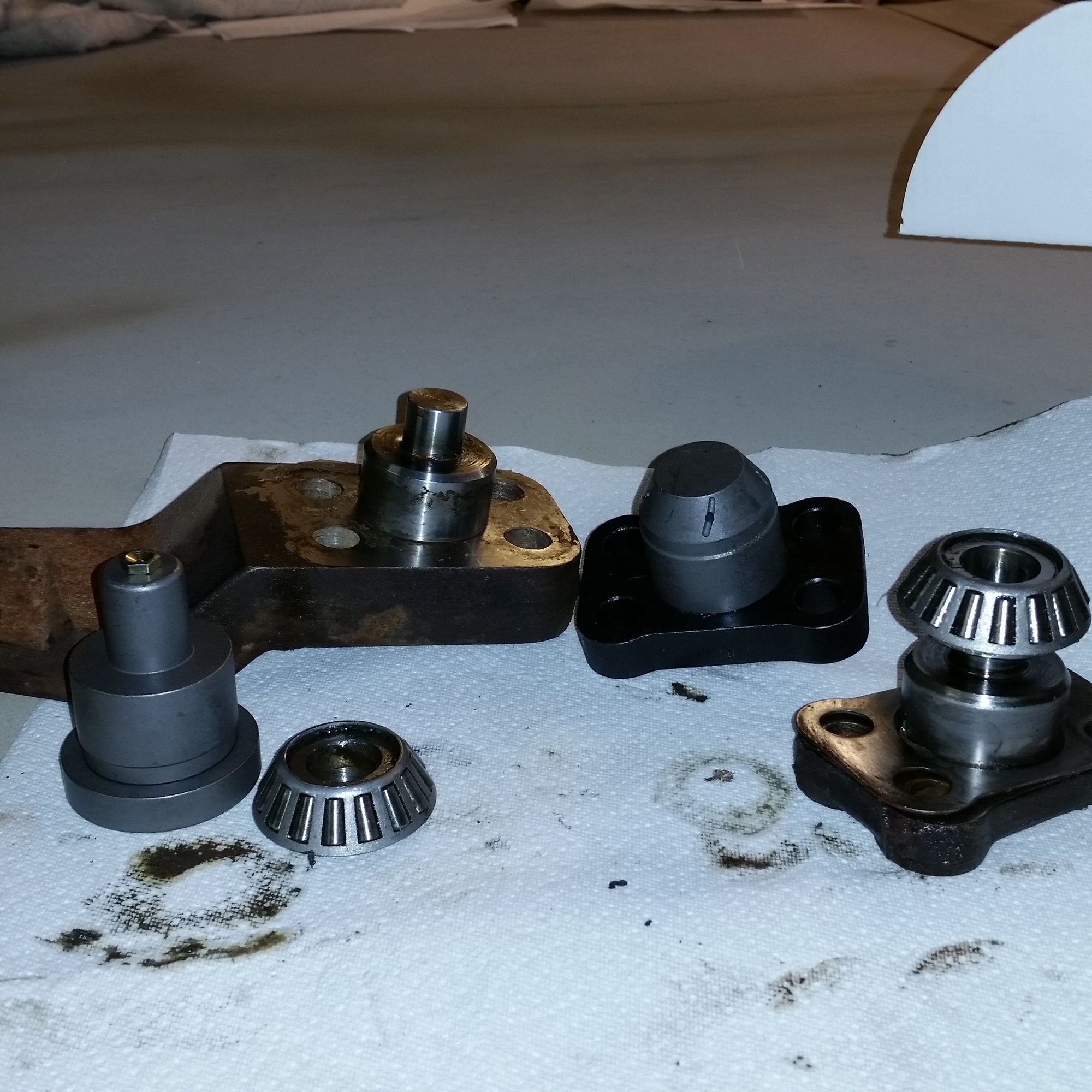

Scored a set of trunnion bearing eliminators cheap so started the tear down today.
They look pretty good compared to the stock bearing, finding someone local with a press may be a challenge though
Dirty 30's were installed about 6 years ago by a local guy who needed some $ and I didn't have time.

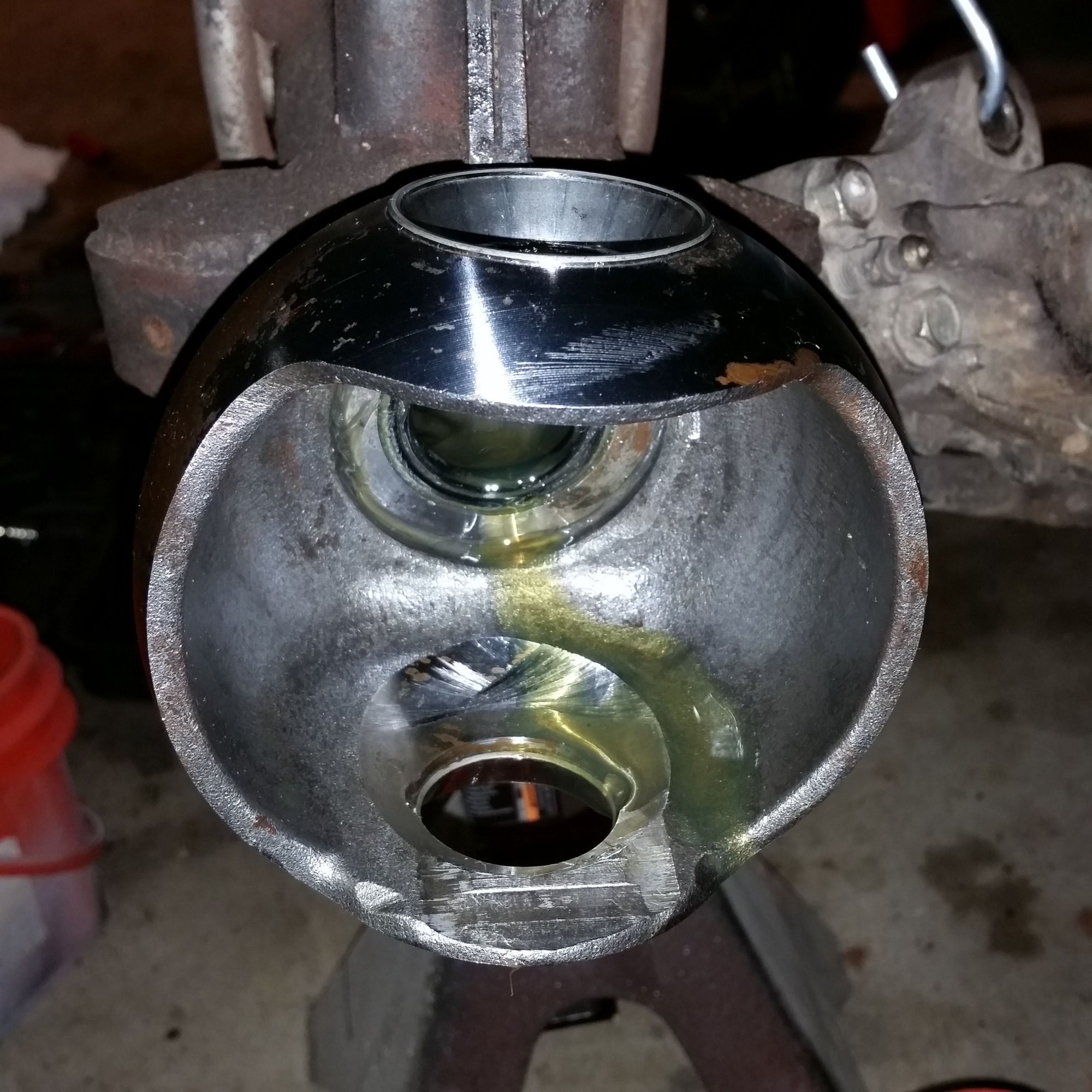

He didn't mention that the driver side must have had a blown birf at some point, not chunked up too bad bUT not as clean as the p/s
drivers side
Passenger side

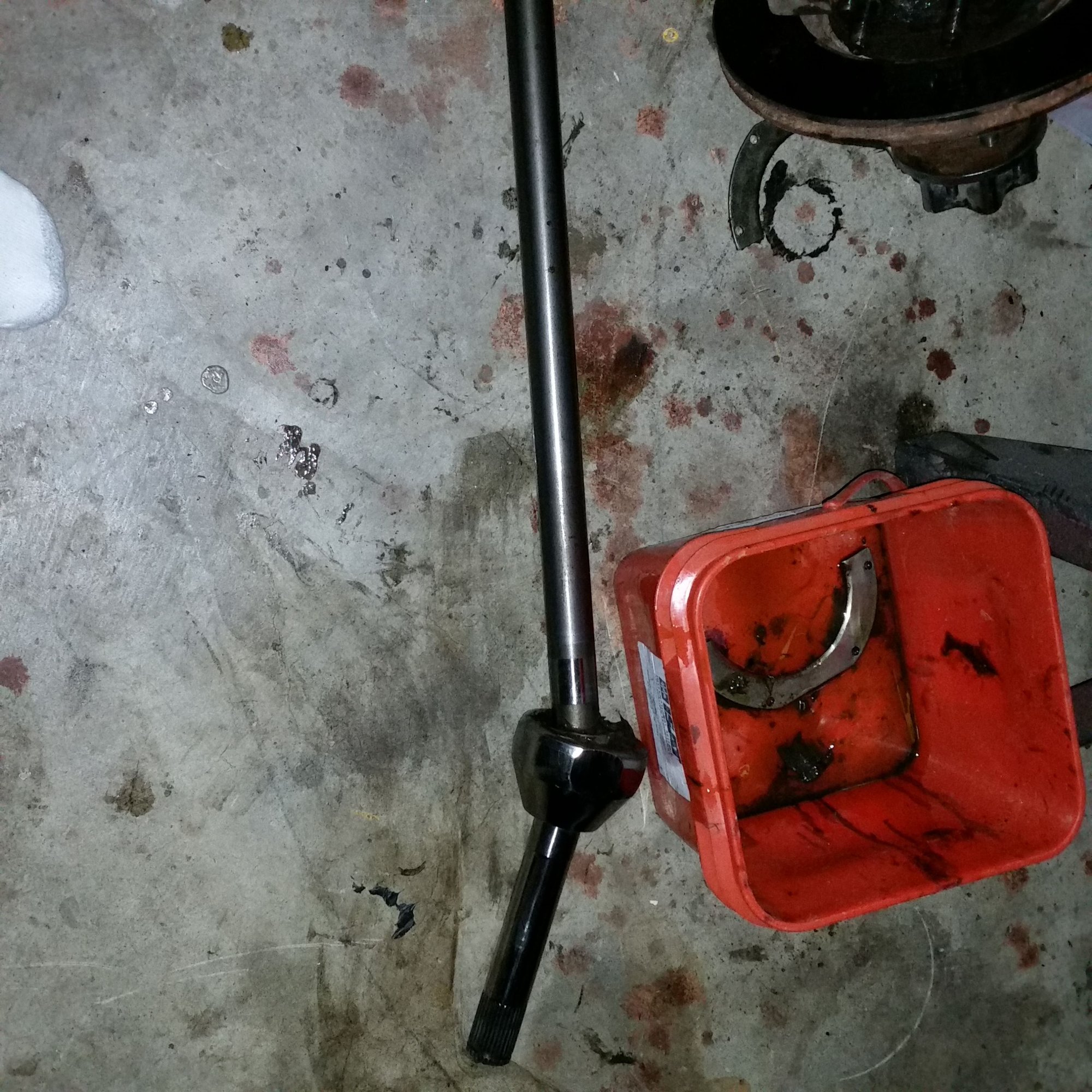

Axles came out now And easy and looked awesome
It was nice to see the inner axles seals still in good shape

picked up a HF 12 ton press that made short work of the pivot pins

Are the trunion eliminators all part of the pin? How often are you suppose to grease them?
When I did my SAS I ordered the MC oversized bearings and pins, they are always back ordered along with the hi-steer arms. That really slowed my SAS progress. I need a press also.

There is a provision for a zirk fitting. I wanted the MV kit but picked this up locally for about 1/2 price from a guy that needed some $$

Not totally necessary Terry.
I needed to push out the trunion pins to replace them for the eliminator pins.
I probably could have done this with a vise but seemed like a good excuse to get one. I should be able to do rear axle bearings too..

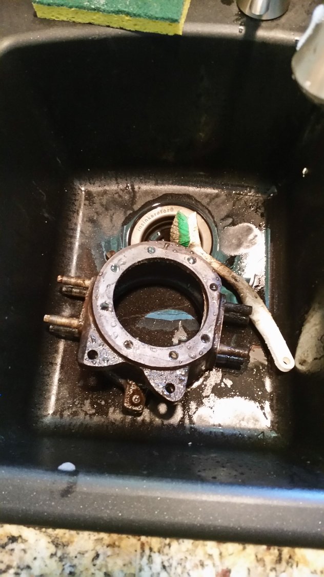

Thrilled my wife with this in the sink
My new favorite cheap tool

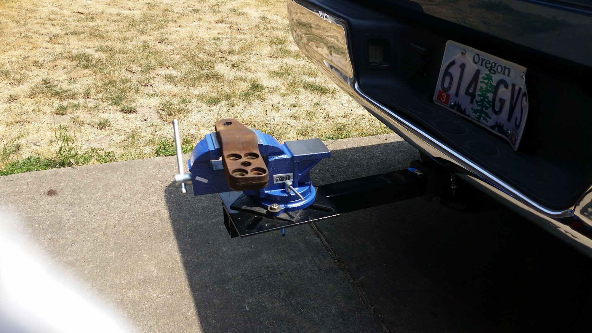

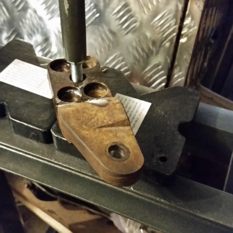

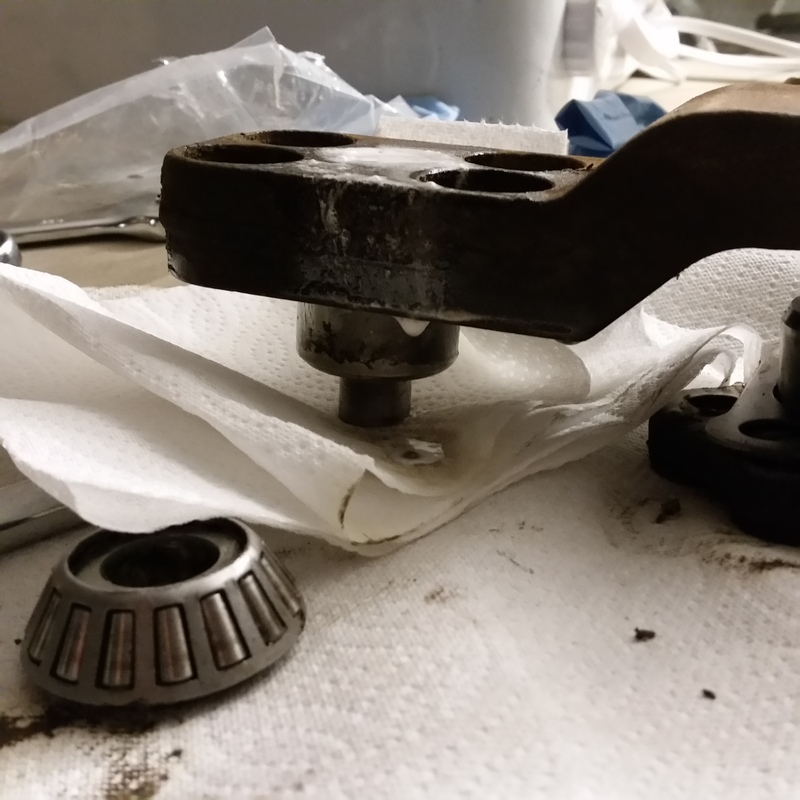

got a little bit done, pressed the trunnion bearing Elinator studs in the steering arms
Hitch mounted vice

Congratulations on the grandson. Great looking kid. He will be ready for wheeling before you know it, they grow quickkk. The front axle rebuild is not bad at all but it is the cleaning that is the time killer. Cool idea for the outside vise. That would be handy to have at times.

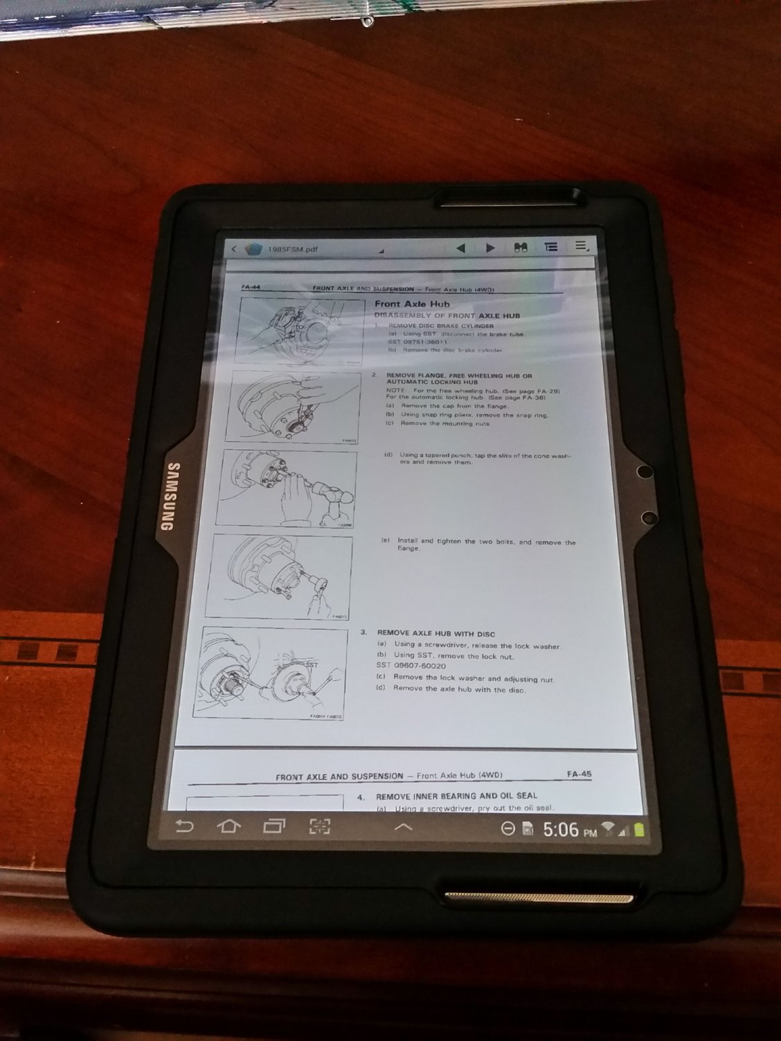

Scored a used Galaxy Tab 2 10.1 in awesome shape dirt cheap that should come in handy
download the FSM and will make some procedures easier
Download some trail maps and it can also double as a big GPS
