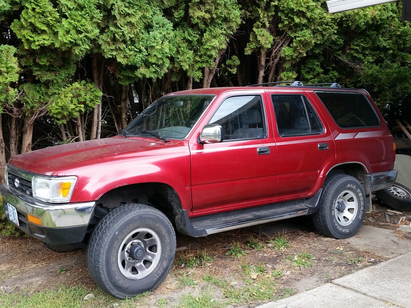

OK- I am at kind a a dilemma with regards to the Trekker
it has been a fun project but the truck overall is just very tired.
Frame is tweeked, it isn't square, multiple cracks in the front towards the spring hanger.
The top leaks at the rear hatch.
So- do I sell it as a running truck - complete
or Pull the suspension, tires, axles, dual cases, seats and other misc stuff and sell it as basically a shell(body & cage with an engine and transmisison)
and switch most of the stuff to the 4Runner

I understand the dilemma. Well, as a working truck it will bring maybe a few thousand. As a parts truck no one is likely to buy what you don't use (body), and you'll probably have to haul it to the dump. If you want the axles and drive train, go for it.
Another way to look at this is that there really are folks that would likt to pick up where you left off. It's a cool truck as is, and there are people out there that may have more energy to put into it. There are not too many of them in restorable condition out there.
Uh... one more thing to consider is that as a parts truck it represents more work! I only say this as a person that has way too many projects open. I am struggling to regain control and wondering if trips to the dump may be the only way out of some of them!

I know solid axles are all the rage, but IFS does well. They will take alot more abuse then most think. Solid axles are eaiser to lift and is about the only advantage I see over IFS. With this one going to be hauling the grand kids, I think that is going to keep the wheeling a little milder then what you have done in the past.
If you are wanting to get into extreme wheeling where you really need a solid axle, I would keep the parts for another first gen truck or sell them seperately. I would consider the time and cost to get the 2nd gen runner built back up. Cost wont be much since you have the parts but you are still going to have time into it which in realistic terms is probably a year or two.
Old Sep 10, 2015 | 05:48 AM
  #1529
irab88's Avatar
iTrader: (4)
Joined: Jul 2010
Posts: 6,499
Likes: 37
Originally Posted by Terrys87
...Solid axles are eaiser to lift and is about the only advantage I see over IFS...
solid axles have a lot more travel, ride smoother on the trail, have fewer points of failure, and easier to upgrade (gears, knuckles, lockers, etc).
however: as this is being a family-hauler, ifs is a great choice. smooth around-town performance, good handling, a tad safer, and higher static ground clearance

Have you considered doing the SAS, but making it spring under axle to keep it low?
Realistically I know I probably wouldn't get more that $4-5K for the truck if it was complete.
I am pretty confident the shell would go fairly quickly, I i got $500 for the body I would be happy. I have two transmissions, the current engine still runs but is tired, i have another engine sitting on an engine stand supposedly with less than 70K on it.
Nice thing is the sliders are only a couple of inches short for the 4Runner so they will definitely be transferred to the 4Runner
Not looking to do any extreme wheeling. More of a capable weekend warrior. Crawling through rocks has been fun but it would be nice to have something that I can drive to and from a weekend trail run.
I priced getting the new spring mounts I would need and it came to about $300. Considerably cheaper than going IFS long travel and having to get an IFS third set up with gears.
I see what 85Toyman would charge to do the SAS for me, he has a nice shop and could get the work done fairly quickly.
actually I am really looking into that. I would push the axle forward slightly
Low would definitely be nice. Need to look into oil pan and axle clearance
I don't want it to come out like the typical 2nd Gen Skyscraper
