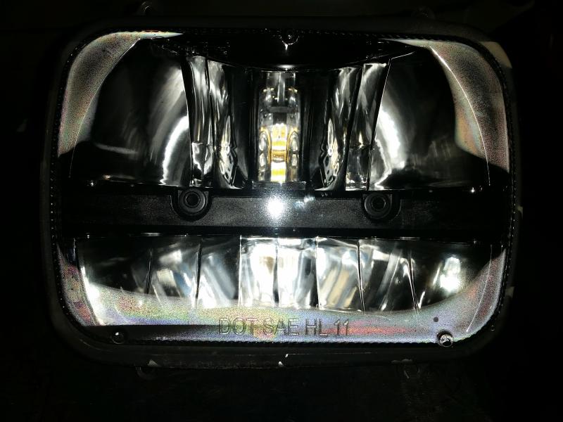

So have a not so good update 2 years later.
On the way home tonight my passenger side headlight high beam was flickering quite a bit even though I was using low beams. Fortunately it was dusk so I was able to get away with out my headlights for the last couple of miles.
Got home thinking I had a bad relay, short or headlight switch.
Decide to take a look at the lights...kind of ticked, found moisture in the passenger side housing.
the light has not been subjected to a crash or anything.
I swapped out an old H4, not one flicker with the truck idling for 30 minutes. Plug the trucklite headlight back in, high beam starts to flicker again.
Glad I didn't start a lot of chasing ghosts with a DVM..the swapped light leads me to believe the moisture is the culprit. No moisture or any issues with the d/s light.
time to see how Truck Lite's customer service is with their 3 year warranty.
I really like the out put on these things and glad the warranty might come through for me but I really don't want to have to pay $180 for a replacement. That will probably not happen for a month or more..

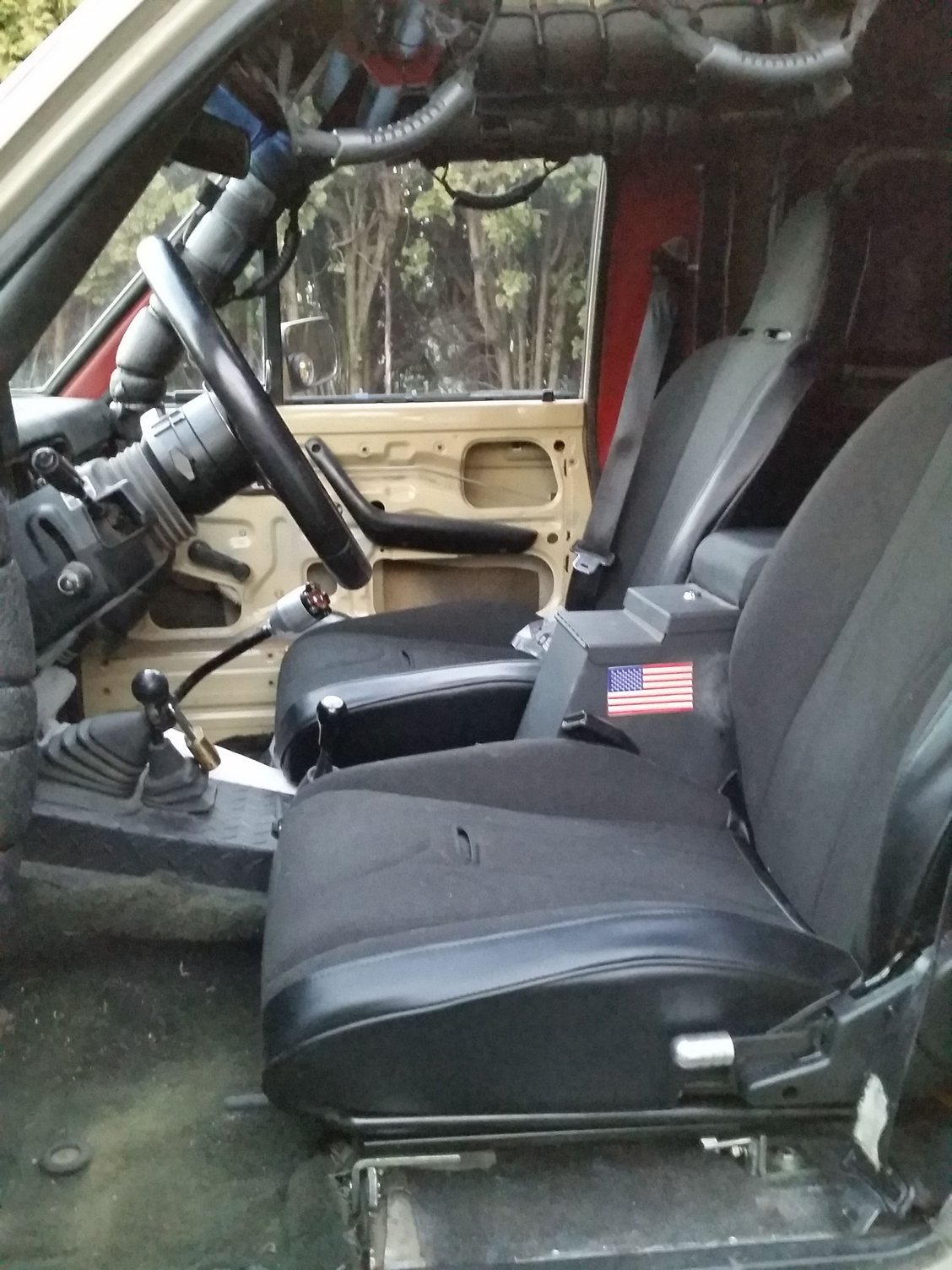

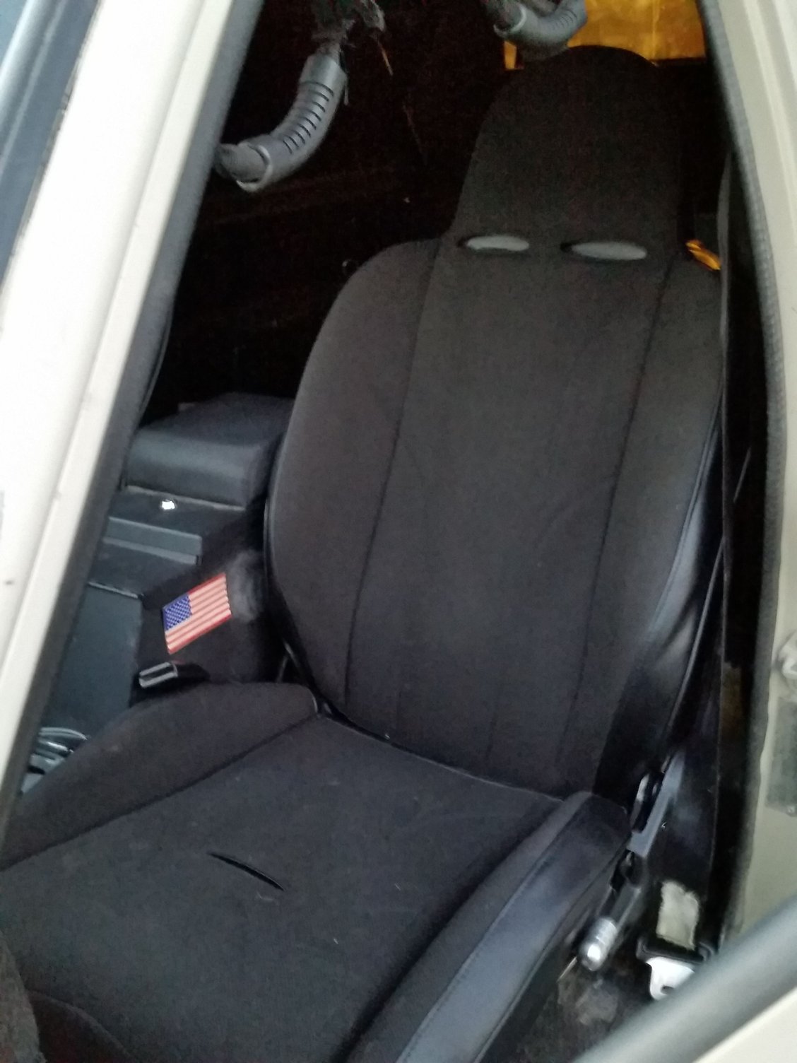

Got a killer deal on a set of Suspension seats and the missus said go for it

Update on my Truck Lite LED headlight issue:
I wasn't getting any email response from Truck Lite so I posted on their Facebook page.
Very quick response and they had me email another department and I got a great response.
They are sending another set of lights and they will cover shipping for me to return the my existing lights with an RMA. It took some time but kind of cool getting two replacements instead of just one.

Truck Lite's Warranty came through finally
20 minutes later two new headlights installed

those suspension seats look comfy!

Hurray for the warranty! haha.
Yeo, am happy it came through.
seats are great, i want to lower them in the back though, angle just isn't quite right
Those seats DO indeed look great. You can tell by the passenger door position that they are much farther back than possible in the single cabs. My Honda seats have a rather thick backrest, which exacerbate the problem! The extracab models were a great invention, but I see there's no issue at all in the Trekker!
The dashboard looks like new... because it is!
the extra room is one thing i really like about the trekker..thanks!
