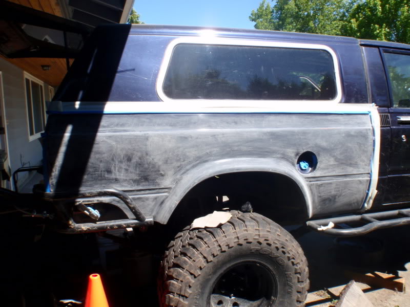

had some time to kill so decided to take the plunge and start rattling some cans...no turning back now..
started off sanding it a bit...Found some bondo in the fiberglass...

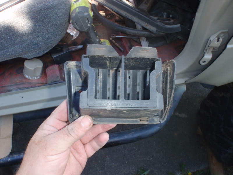

took out the cab vent, sure enough the little rubber flap was MIA, Paul I will be using your replacement idea in the near future:

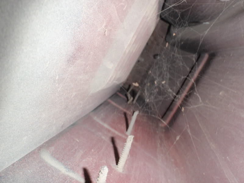

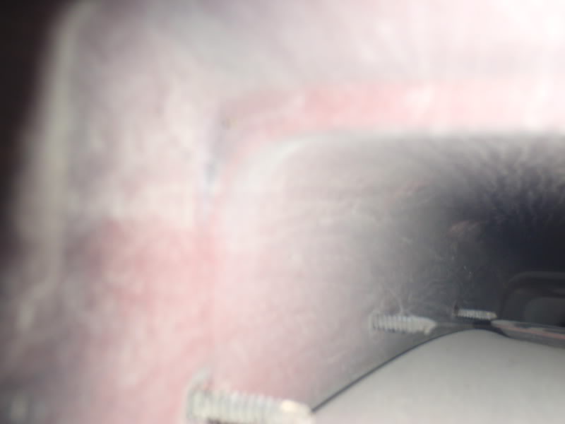

so trekkers have a bad habit of rusting out in between the cab and the fiberglass bed & cap. My eventual goal is to make the top removeable, but was dreading what I would find...thought with the vent out, perfect opportunity to see what I might run into:
towards the floor:
view up:'
very happy to find no rust, as least through all the way...some trekker owners have ended up doing a cab swap because of what they find. Winnebago used about a gazillion screws to attach the fiberglass to the back of the cab...

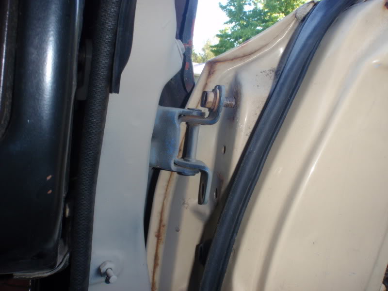

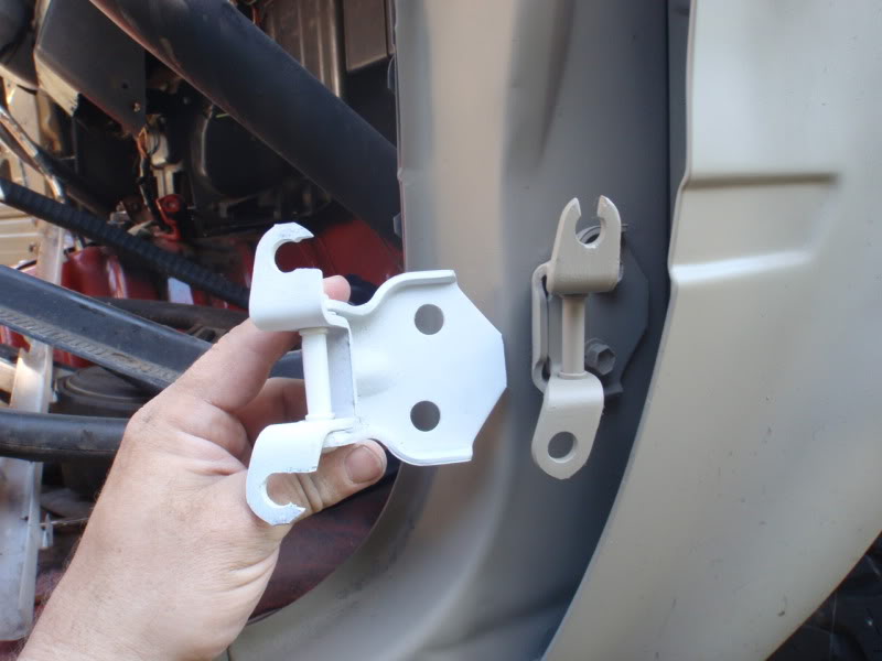

swapped out the passenger door, my version of a quick release hinge was not a great success, so I decided to go with Stub's gravity version...much easier:
