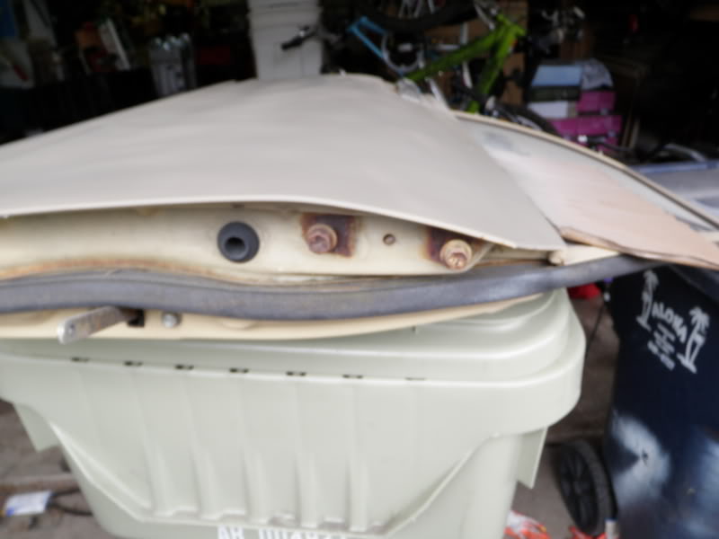

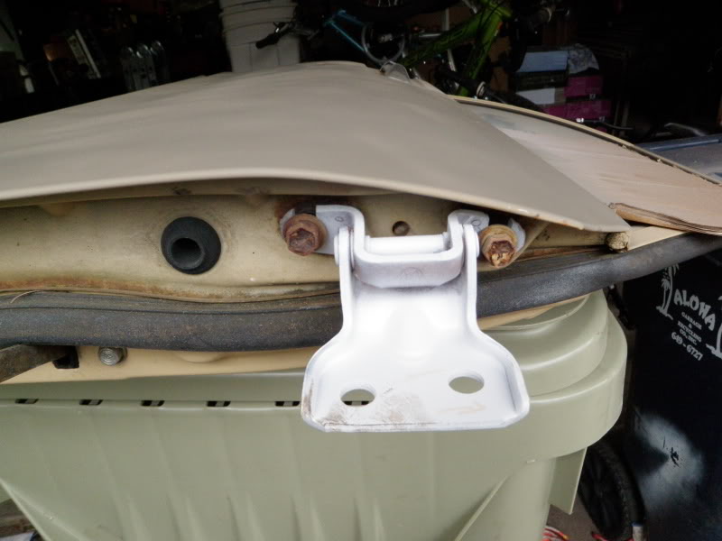

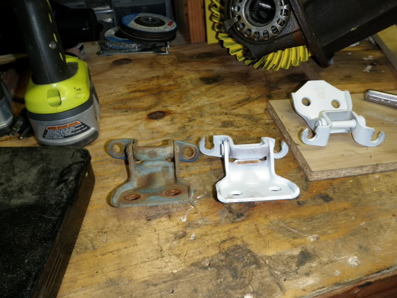

cut out a strip on the hinge that would allow a poor man's quick change hinge:
stock upper P/S hinge on left, modified upper p/s hinge in the middle, bottom p/s hinge on right:

Door is off the truck but you get the idea:

tighten with your 12mm wrench on off you go
I had tried drilling out the brass bushings on one set of hinges on my tube doors for pins, that worked fine for the tube doors but with out the brass bushing in there with the weight of a full door it would kind of droop a little bit.

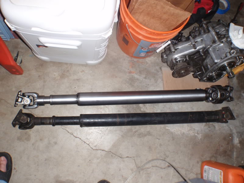

rear driveshaft
well nothing major but got a step closer getting bqck on the trail.
Picked up the new rear driveshaft this morning:
new one is got a CV joint out of an 90'ish 4runner. fully retubed, clearanced CV, balanced and new joints etc...should help some of the vibration issues
spare driveshaft on the bottom.

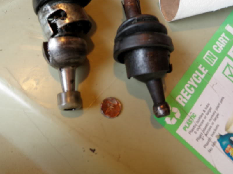

picked up an L-52 that is in surprisingly good shape, has some nice paper gaskets on it that makes me think it might have been rebuilt at some point>
new one(out of an '83) on the bottom, old one on top (L-50 stock '81)
the shifter is nice and tight..it even has a shifter seat bushing...my original shifter retainer was so rusted in there I never got it out until the transmission went out
I wonder if the Penny helped the new one seem to be tight
new on left, old on right

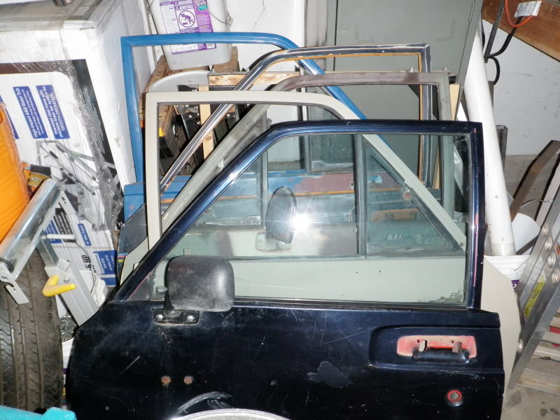

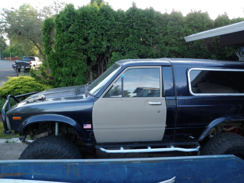

Hey Al: figured I owed you a pic of some of the doors:

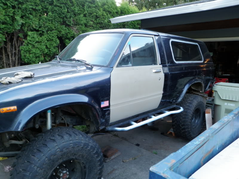

Figured it was time to swap out the munched door. Took one ttahat I got from TrekkerPaul. It had some surface rust so I cleaned that up and used some self etching primer on it. It started out tan, thought what the heck. I always kind of liked the Desert Tan, Camo brown color. Gave it a couple of coats to see what it might look like...I kind of like it...
the clear coat on the Trekker is pealing like crazy...dunno
oh yeah...it's back on all fours at least..
