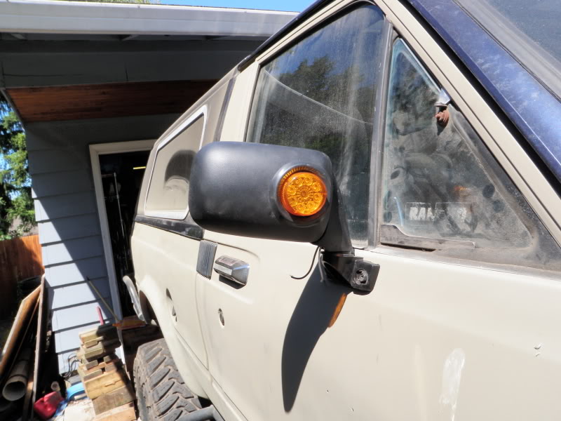

Turn Signal In Mirror mod
Been working on my kitchen remodel for a while now, went out to the garage to look for something and got sidetracked
decided to take about 10 minutes and do a signal in the mirror.
took a spare generic mirror (i usually have a couple of spares I tend to break them)
took the mirror and a 2" LED marker light:
drilled a 2.25" hole, in the mirror housing, fed the wire through a couple of more holes in the mount and ended up with this:
still needs to be wired up, but i like it for 10-15 minutes and a $3-4 LED marker
When the 1st Gen truck first came out they were billed as the "Son of a Land Cruiser" so kind of like a new FJ Mirror light (though missing the heated mirror etc etc)
..they add some safety...let's face it, 30 year old first gen signals are kind of anemic...

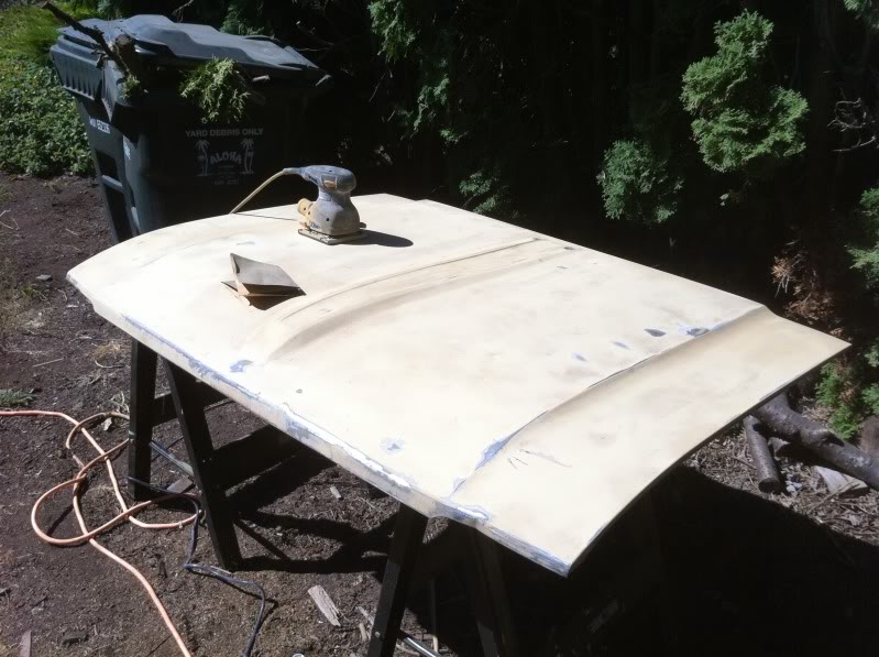

No real update , took a little time to sand and spray a hood that I got from TrekkerPaul and to give photobucket mobile a try, allows to you to upload from your phone:
Seems to work
