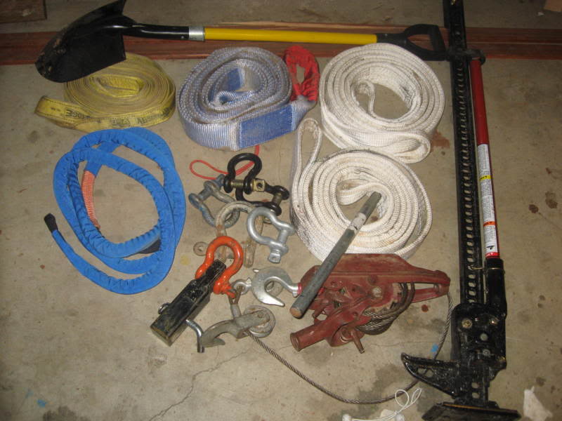

Got a call from my dad that he had buried both his tractors down by his stream. He desribed it as the place i had gotten buried a few times before so I thought great.
Loaded up my recovery gear 5-6 shackles, 4 straps, tree saver, shovel, high lift, and my old 'more' power puller:
loaded the trekker up, towed it just in case it broke or got stuck too:

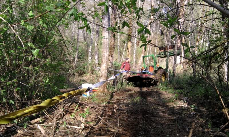

Found the John Deere Buried

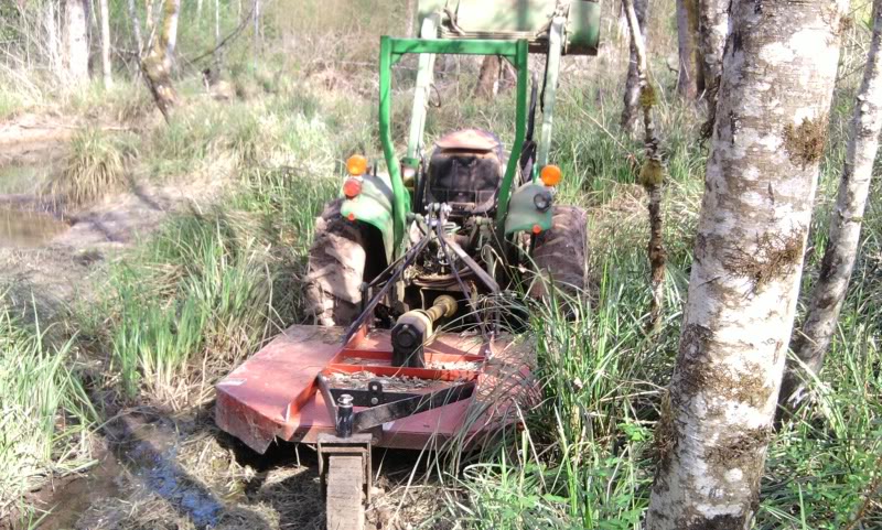

yanked the little mitsubishi tractor out first, it was easy.
The John Deere took a little geometry to due since i couldn't get a straight pull:
ended up with a ton of straps hooked up to get the Trekker to firm enough ground, first pull in 2.28 low didn't go, tried 4.7, no go. put it in double low and it came out with ease:

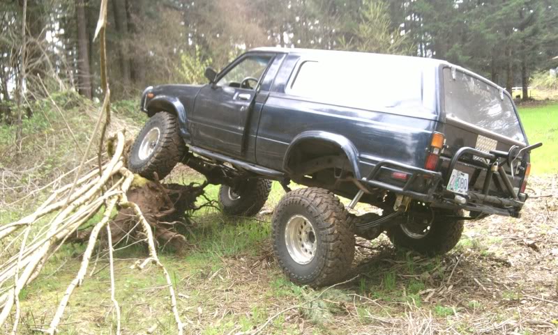

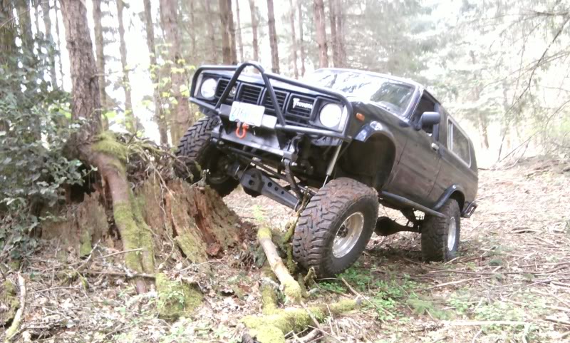

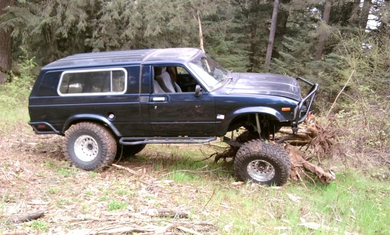

since i was down in the woods did a little stump wheeling:
Didn't have much time for more, the steaks were almost done on the barbeque..

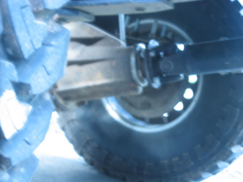

not much of an update,
my rear pinion angle kind of sucked after the rear springs were installed, got that fixed (new spring perches), funny how a couple of noises went away

are you running a double cardan joint in the rear?
i've always thought you needed the pinion parallel (or close) to the t-case output when you don't have a double cardan?
Al
Al
hmmm, Al, I was always under the impression you wanted the pinion to point towards the transfer case. In the 1000 miles or so since I did the rear springs I went through 2 u-joints. Since the correction I had some vibrations go away. I pm'ed some folks with a lot more knowledge than I have so hopefully I will find something out. You got me thinking.
You are off on Sundays and Mondays? I don't have any plans on monday, maybe I can swing by and check your trucks...
Waggy springs would be cool...
Al
Hi...I'm John...if you don't mind me throwin' in my 2¢ worth:...
Wikipedia discusses the math models of UJs - from what they say, it would seem that the issue of having the differential & Tcase shafts parallel applies when your drive shaft itself is a Double Cardan Shaft. Keeping the driving & driven shafts in parallel would keep a constant velocity and reduce certain vibrations....
If you have a Double Cardan Joint (it doesn't look like it by the picture), this would provide constant velocity transmission, compensating if the driving/driven shafts are out of parallel.
But there are limits to this: each UJ, depending on its size & component clearance, will bind above a certain angle. In that case, a little velocity variation is OK as long as the joint runs more smoothly. For instance, maybe the front joint is OK running with 7° angle between t-case shaft & drive shaft, no binding. But the back joint could be binding above 5°, so you'd need to bring the diff shaft in line with the drive shaft a little. Now your t-case and diff are out of parallel and you get a little variance in the velocity, a little vibrations, but you just made the rear UJ very happy where it was throwing bearings every 500 miles before.
by the way...Sweet Trekker!
that was exactly my thought. while parallel is not possible with lots of lift due to working angles, its still better to be closer to parallel then pointing at the t-case.
John--spreading some knowledge is always welcome. You are right, I am not running a double cardon joint. I have an extra front DS that may be come a donor to add to the rear..just need a little $$ so I can get the work done.
Thanks
follow-up thoughts on this - What's wrong with the cyclic velocity produced by the nonparallel shafts? Answer - we're talking 2 higher velocity quarters and 2 lower velocity quarters in a full revolution of the drive shaft - at high RPM this would have a similar effect to driving your axle with an impact wrench.
So at low, crawler speeds it's probably not an issue as much as the Ujoint binding under high torque. At highway speeds, well, depends how fast the shaft is rotating...the effects would be more serious.

I am gonna have to do some more research on the theory of u-joints etc.
seems to me the u-joints (entire shaft for that matter) are gonna be traveling at the same RPM's as the output shaft.
hopefully at the first of the month I can get the double cardon joint installed. just know that with the pinion angle I have now, it seems to be a happy medium

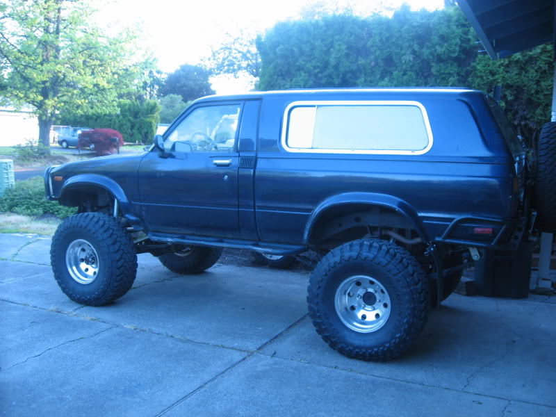

Talking filled out the wheel wells
I was cruising craigslist friday night during my lunch and found an add that read: want to trade 35's for 33's. Looked at it and said that fits me. the guy wanted to swap his 35x13.50x15 Toyo MT's for a set of 33x12.50x15's Toyo's--hmmmm, I thought, exactly my tires
I emailed him, got a response right away that said come on up to Hood River.
Met him sunday afternoon, we agreed to a straight across trade, he pulled this wheels and tires off his very sweet '72 FJ-40 with a 2005 Ford Explorer V-8..I would love to have his FJ, very nicely done.
1.5 hour drive home and I had the tires mounted on the trekker. I think they fill the wheel well nicely. No need for wheel spacers now, the tires came mounted on some 15x10's
driving them around I found that I will need to have the tires balanced. I did not notice any appreciable loss of power by my butt dyno but a hill test I am sure will say other wise. I am happy the trade worked out, $25 in gas is all it cost me
