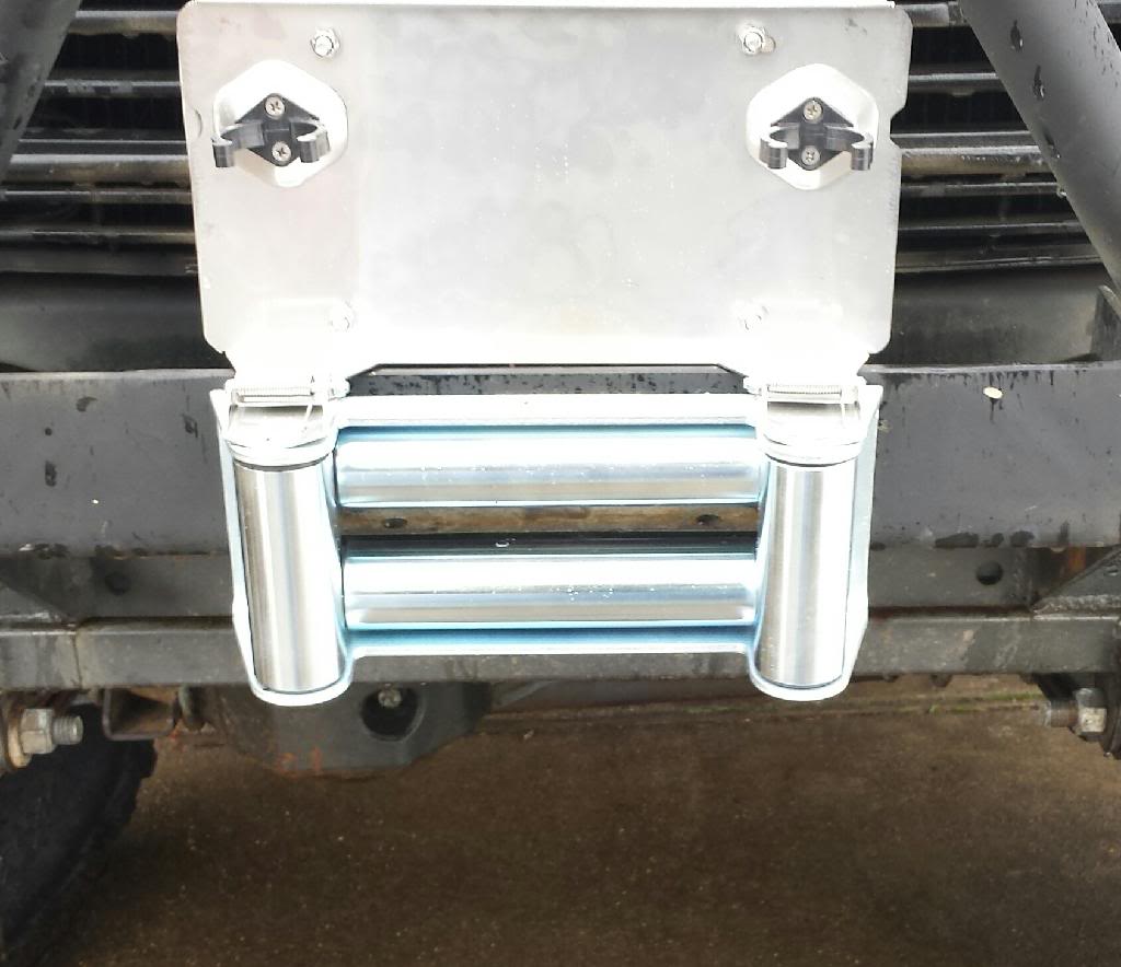

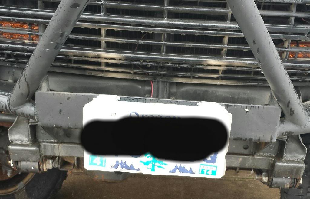

Did a little prep work this afternoon:
No more zip tied license mounts--

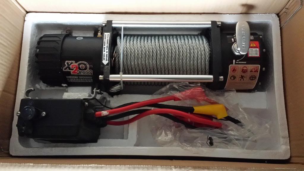

My back ordered Christmas present the missus got for me finally came in after about 7 weeks:
I will need to do a rework of the core support to get enough room, when I mounted the Trail Gear winch tray about 6 years ago I didn't know that they needed to be spaced out about 1/2" when mounting them on 79-83 Toyota trucks. It will also give me the opportunity to beef up the cross member to give it a little more strength when winching.

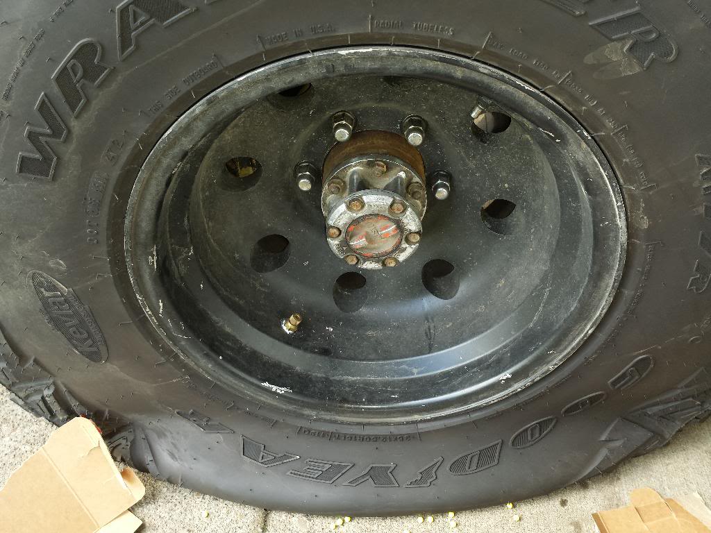

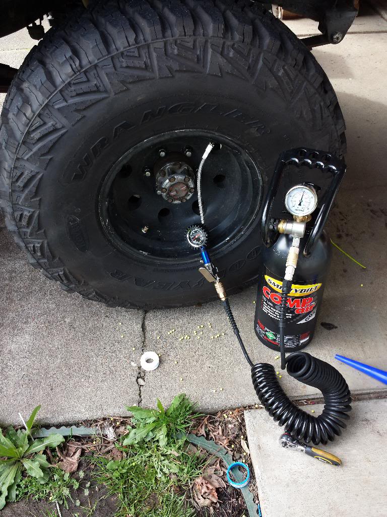

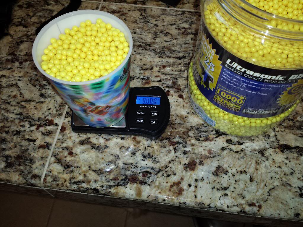

Like most of my projects...This stuff has been on the shelf for over a year...decided it was time
Hoping 8 ounces per tire will help even things out
Dumped them in through the hole for the mini monster deflators
Refilled in 30 seconds

Are those just plastic BBs?

Yep..6 mm air soft.

I started with 7oz. but I think I'm going to add another ounce to them. Dynabead called for 6-8oz, so I figuAt 75mph i'm getting a bit more vibes like a tire is slightly red I'd start in the middle out. I'm actually amazed at how well this method works. In hindsight I should have gone for the max ounces since the MTR has some good size solid lugs.
let us know about the road test. So far with the MTRs my only complaint has been the flat spots from sitting a few days. Feels like a wheel is loose when I pull out of the driveway, but the feeling goes away in about a block.
