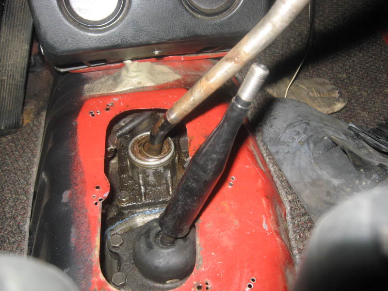

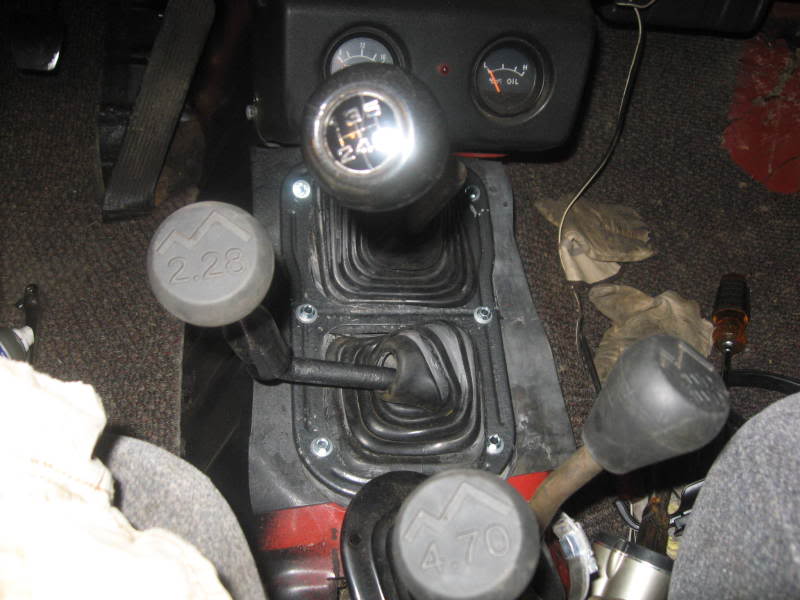

I finally found my replacement shifter bushing kit, it has fallen down behind my roll around tool box along with some other miscellaneous goodies..stuff had only been misplaced for a year and a half...
Tried for 2 days off and on to get the stupid shifter collar out...used a ton of penetrating oil and about beat the thing...it one. just plain old rusted in there.
the problem with having a sloppy shifter other than being a PITA is that when I have the front transfer case in low range and put the transmission in reverse-the transmission lever kicks the TC out of low range and into neutral..another pain:
so as an interim fix until I have some more time to remove the shift lever thingy from underneath I used the extra TC lever I had and a $1 unknown shifter from the U-Pull it and dog legged the front TC lever...no more getting knocked out of low range:
might need to shorten the dog leg a little bit, but this will work for now...thought it might hit my leg while driving but a trip around down it seems fine.

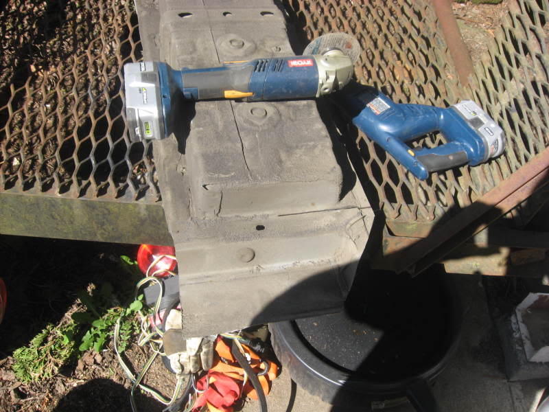

I had recently cut out a small floor storage unit out of a 1995 Kia SPortage.
cut off some excess metal:

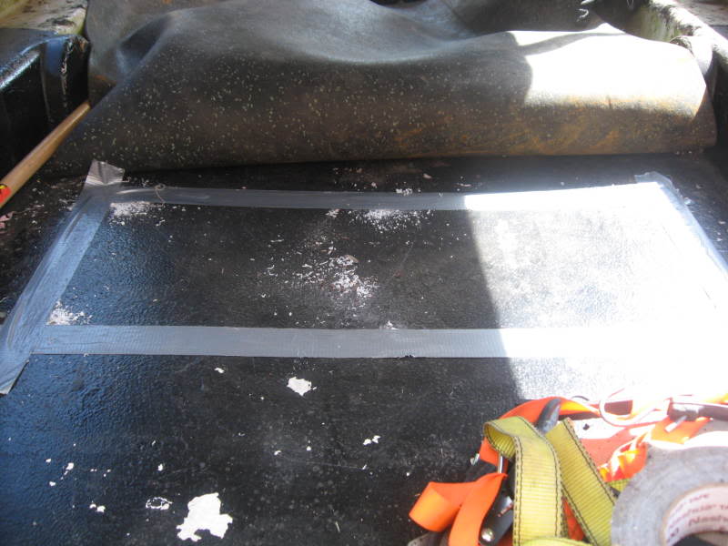

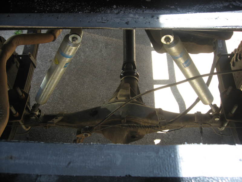

checked under the bed of the Trekker to see what I might run into. I wanted to mount this thing a little closer to the back but was limited by a crossmember>

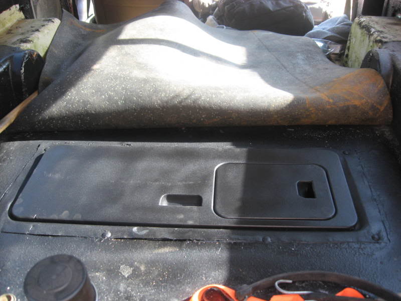

than out came the jig saw, no turning back now:
sealed the storage compartment in with some windshield sealant and bolted it down:
it has enough room for the jack, jumper cables, lug wrench, duct tape, oil and other misc junk.

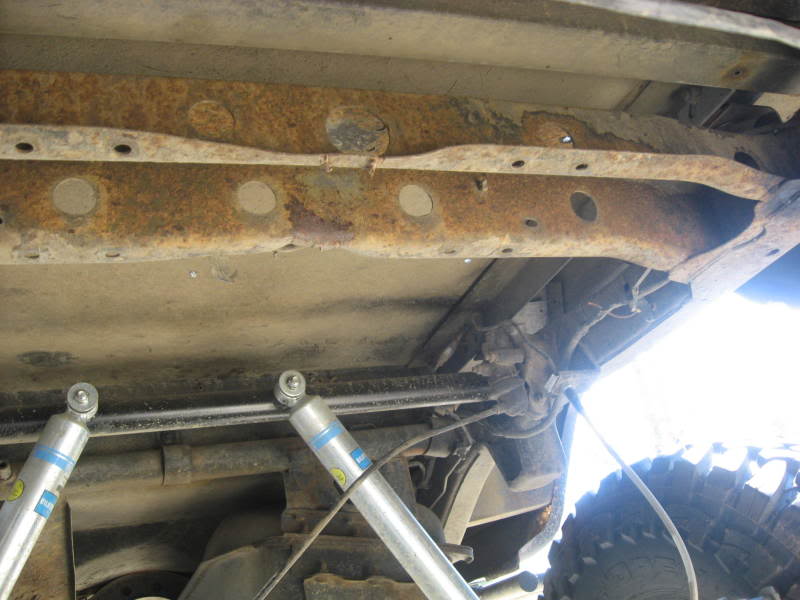

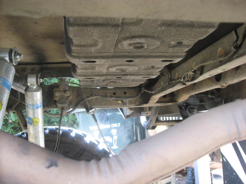

Here are some other shots, hope these work for you:
Inside (yeah truck is a mess)--I think that if I had some more metal/fiberglass skills I could have worked it out so that the lid would have sit flush with the bed, I think I will go ahead and cut some aluminum Diamond plate to use as a lid, that should drop it down a little more flush, probably reverse hinges too.
It doesn't go below the crossmember, only 5" deep. It could get whacked on an obstacle but will probably catch the crossmember or bumper first
frame needs some time with the flapper disc and some POR-15--it's on the list
--other I never realized until I took this picture is that my LSPV has been bypassed (it wasn't me ) so I am gonna need to order a proportioning valve ASAP. The truck seems to brake fine though..of course the v-6 calipers etc help but the rears will lock up in a panic stop
