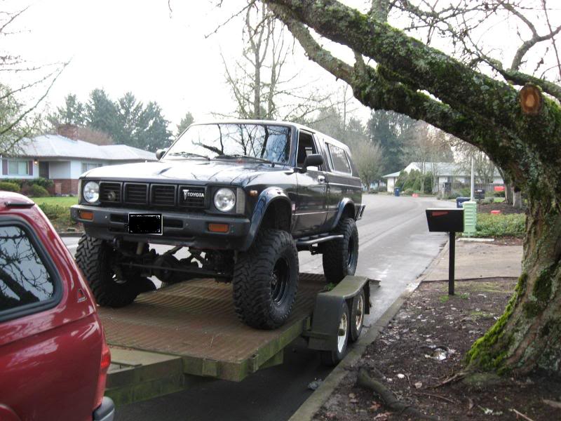

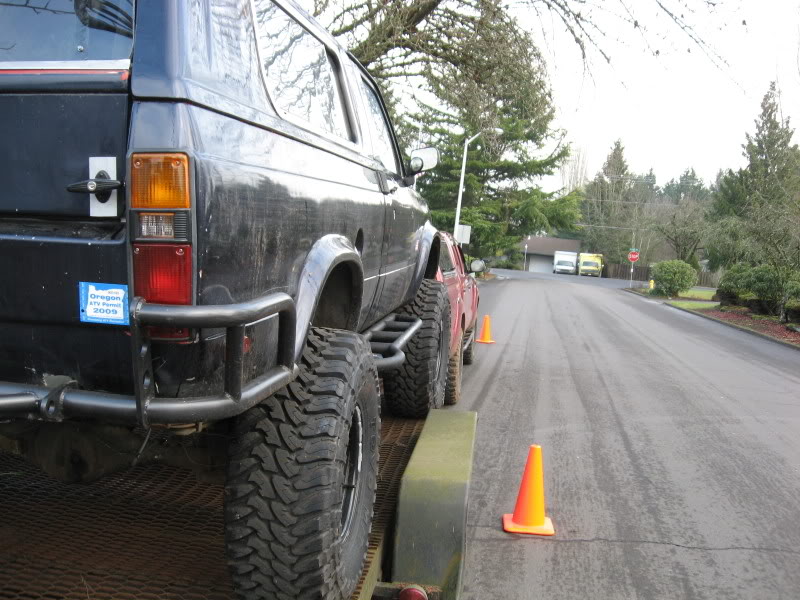

So had to do some moving big stuff around and ended up with my dad's flatbed trailer. I had towed my trekker using a tow dolly and taking out the rear D-shaft but that is kind of a pain, plus the front tie down straps don't fit real well. Thought that since I had the trailer at the house I would try out the trekker on it. Towed it around, went through a weigh station, weighs 4750 (truck and trailer) so I am well within the 6500 towing rating on my Tacoma. The electric brakes make a big difference. It sits up a lot higher than I would prefer so if I ever get a flat bed, it will be a regular car hauler that sits a lot lower. Overall the Taco did fine.
Still wish I had a full size truck and towing the '81 on the Flatbed will be few and far between. If towing needs to be done, I still have a tow bar that I will be integrating the mounts in the planned front bumper, eliminating 800 pounds of trailer weight but loosing the electric brakes kind of sucks....
The trekker should be realiable enough (eventually) to drive to most trail runs...

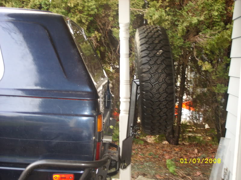

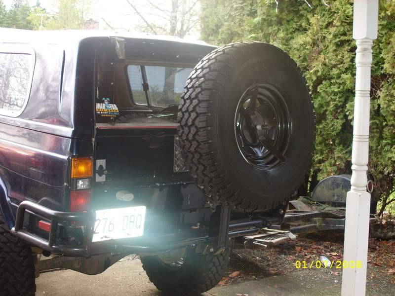

I recently picked up a used CBI tire carrier from MillerPKA, a fellow yotatech member and a great guy to work with. He had it mounted on his 4Runner.
Cleaned it up and gave it a fresh coat of paint:
It is nice to have the rear cargo area back...
It flips up and down very easily and with the intergrated high lift jack mount it will make access very easy.
It does stick out a little more than I thought that it might:
But does leave enough room that I could get a Nato style gas can between the carrier and the back of the truck. Maybe down the road I will have a friend modify the carrier to get it closer to the back of the truck, but it will serve it's intended purpose well in the current form.
Visibility obviously is now limited but hope to have the fixed soon, my wife gave me a back up camera system from Costco for X-mas.
After mounting the tire carrier I was going drive the truck around the block to see how it rattled but couldn't get either door open. Tried 3 different keys and no luck. I was getting a little ticked off, crawled though the back hatch...a big advantage to a Trekker . I wasn't able to even get the doors open when pulling the door release and up on the lock at the same time. Bit the bullet and pulled the door panel the best I could. With pliers I was able to get the latch to release finally.
Found one of these on each side:
at somepoint someone had remote electric door locks on the truck. Would have been nice to have a remote and known about them . Only thing I can figure is that with all the rain and cold we had it fried them, just wierd how they both went out at the same time....
Anyway but the extra rod connected to them, and doors function like they should...

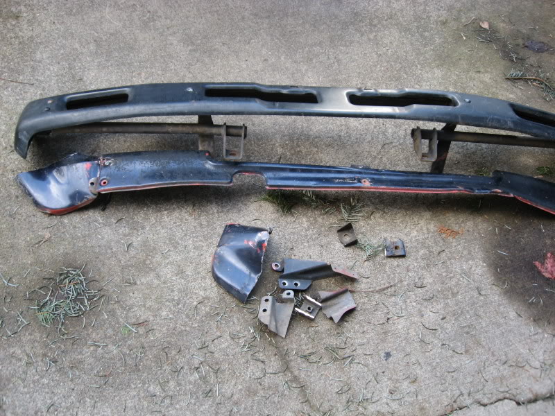

played with the sawzall today..
Found a couple of sawzall blades that still were good so decides to trim a little bit off the trekker...too bad anyweight savings is temporary . I was going to cut off the trackbar mount so I could get the gusset fitted but now I know why everyone takes off the axle and does it when they rebuild the axle...not much room to work under there.
Finally getting the Trekker over to my welding buddy's house to redo the front springs/mounts/high steer/u-bolt flip..
Started with this:
Chopped for a little while and had this pile left over:
The bumper is crap but if someone needs the stock mounts,they appear to be amazingly straight--free to a good home, just pay shipping.

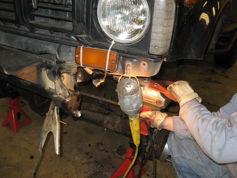

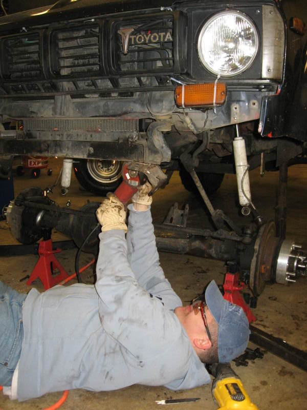

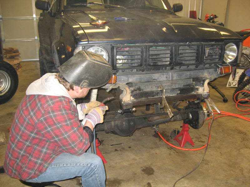

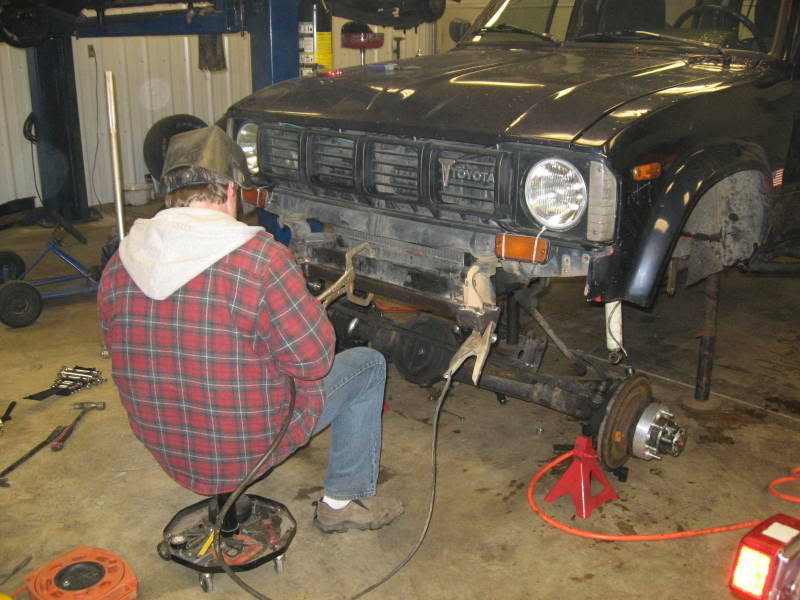

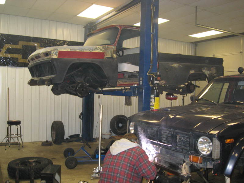

Quick update, finally got over to my friend's shop. All the welding it done but got a late start so I should have it put back together monday.
Todd had his 65 Chevy on the lift..would have made the job a little easy. We ended up finishing his brakes:

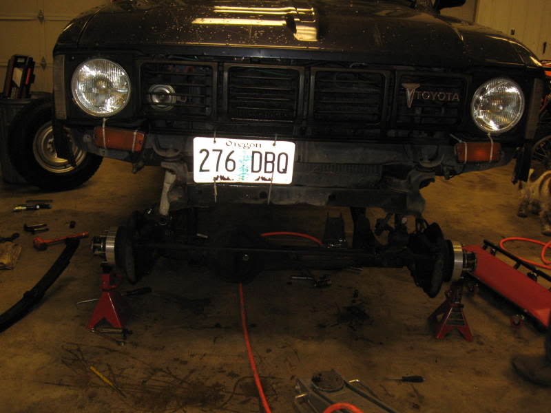

everything removed:
the spring mounts were persistant:

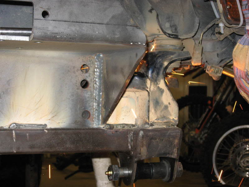

SPring mount and winch bracket on (need to remove the radiator though to be some beads on the back of the bracket/crossmember) on:

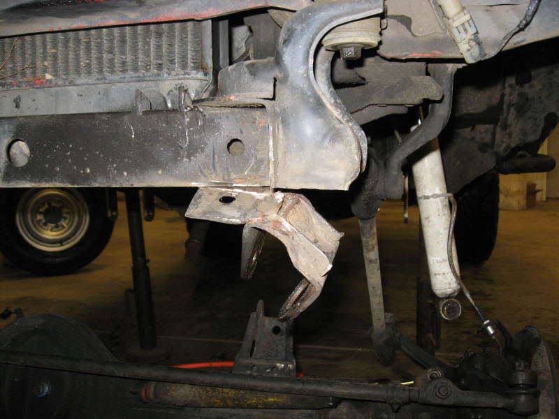

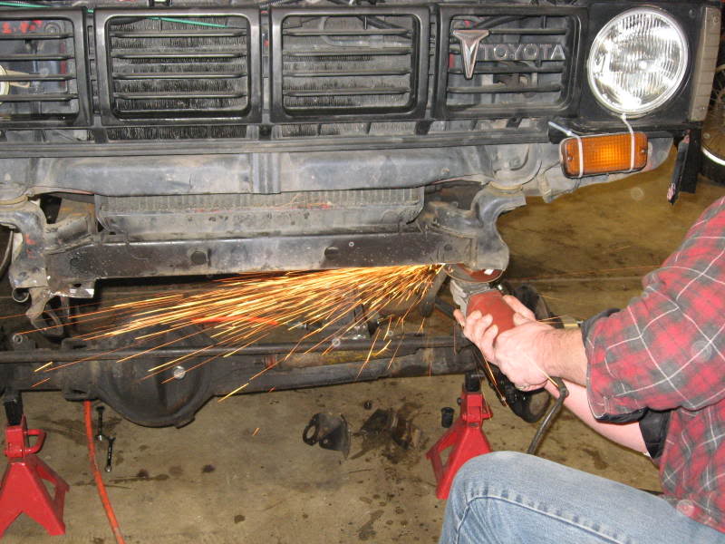

Cutting off the panhard bracket to make way for high steer bracket--Trail Gear could come up with some better install instructions for that
3/4" holes are a pain:
Will head out monday morning to bolt it back together...
Old Jan 27, 2008 | 01:50 PM

Cutting off brackets...torch or plasma.
Drilling 3/4" holes in frame - hole saw.
