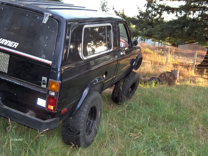

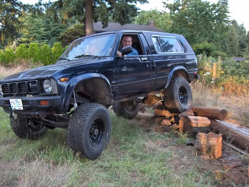

Took the truck out to the folks farm and did some firewood wheeling...need to take the tractor out and clear out the blackberries--lots of good trails down there overgrown...
Flex wasn't too bad, but hope to have the new springs on sometime soon. my brother in law is setting me up with new 4" rear springs he had bought for a project that he sold.
Ordered a Marlin rear bumper last week on monday and had it by wednesday afternoon... awesome quality..hope to have it and the sliders mounted in a couple of weeks. Just need to coordinate schedules with my welder buddy.. I will be ordering a Marlin front bumper in a couple of months..
though may add a little cross bracing so I can use one of CBI off roads spare tire/high lift mount..Thinking about going that route because it is something that I can use on both the trekker and my Tacoma..

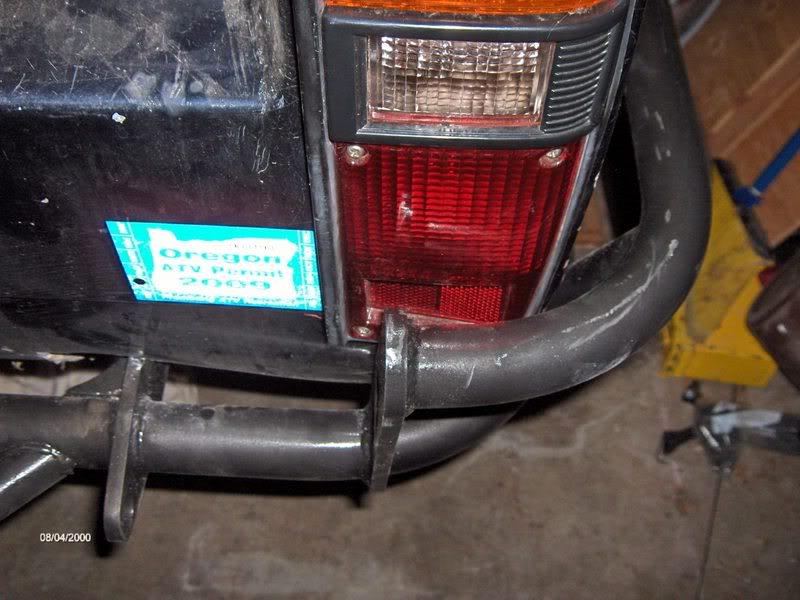

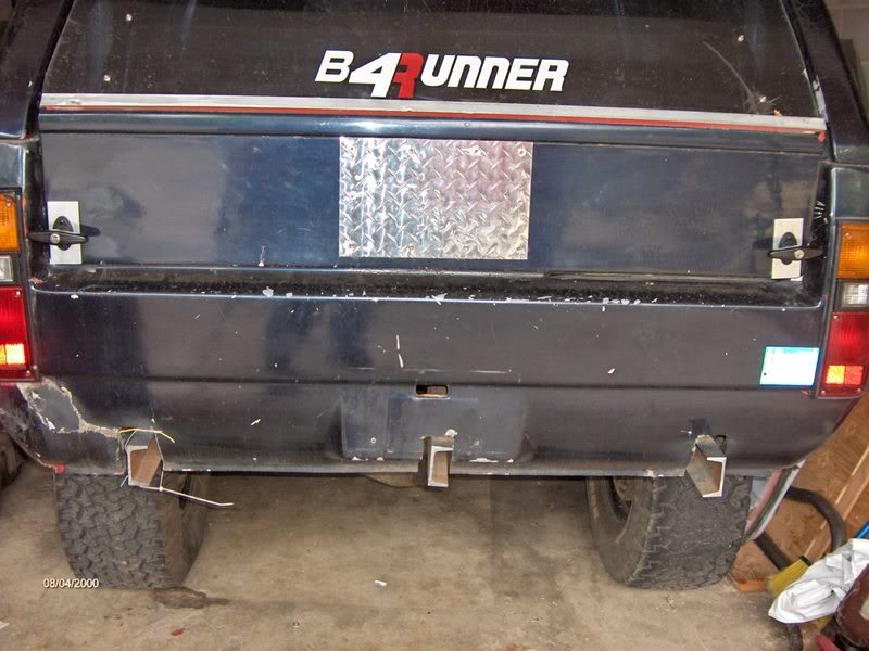

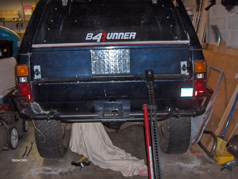

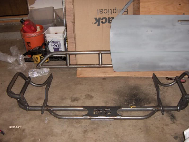

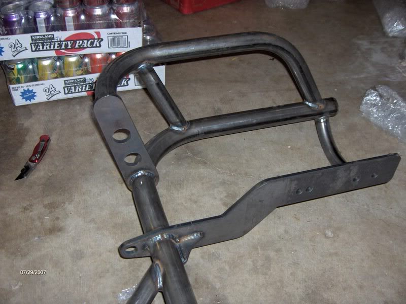

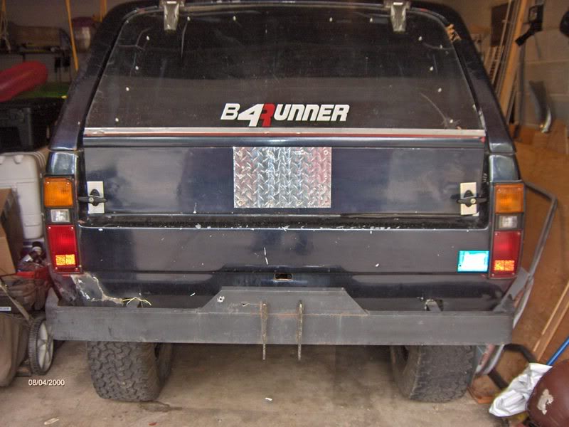

So finally getting a little time to put on the Marlin rear bumper.
Had to cut off the one that a PO had welded on.
It wasn't build too bad, but need something that is more functional/practical
Found that Winnebago welded a body mount over one of three holes in the frame that is used for Marlins mounting holes.
First one was no problem. The one on the driver's side though made me happy I wore safety glasses...Costco's drill bit package are not that great...Need to invest in better bits...only broke 4.
..Might have gotten crooked a little bit, but was drilling pilot holes as I went..
Camera battery died so will post up finished pics after dinnner...
Winnebago put a body mount about 3 inches behind the stock mount so that extra 3/16" on each side took a little finangling to get the bumper on.
Turned out I had to trim about 5" off the lower quarter panel to clear the bumper...Ryobi's 18V cordless saws/drills that all use the same batteries come in handy
The clearance on the Trekker is much tighter than I expected, I would like to see one on a regular 1st gen since they are steel vs. Trekker Fiberglass
Overall I think that the Marlin Bumper is one of the best piece of Armor that you can buy for a 1st Gen. I did not get a picture of it, but I was able to lift the entire back of the truck with the High lift, one of its intended purposes.. .

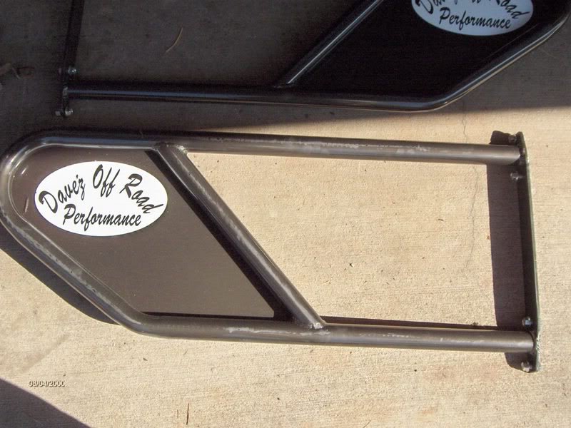

Just got home from taking my daughter to Band Camp and the UPS truck was just pulling away...
dropped off a set of these:
they look great for the money. Need a little touch up paint. Sorry Dave, but the stickers are gonna go, but I will mention to people where I got them:
http://www.davezoffroadperformance.c...opic.php?t=444 From time of order to delivery it was about 2.5 weeks, not too bad...
I was going to make a set of half doors but my donor doors turned out to be in much worse shape than I thought, but I did get the hinges off them, so not a total bust--trip to the local farm store yielded 4 quick release pins for the price of 1 at lowes..go figure
Will get them on over the weekend....

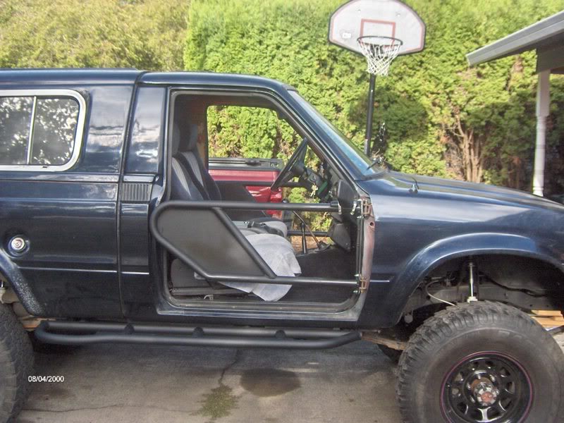

Sliders and half doors are on....went on a quick trip up to the logging roads but of course for got the camera so here are the driveway pics
Put on the tube doors over the weekend. Hardest part was getting the stock hinge pins out, have to hand it to Toyota, those things are well built..
hose clamp holding mirrors are temporary--couldn't find my small drill bits
Found out my brother in law had a nice wire feed welder...gave him a case of beer to help install the 4xInnovations sliders ..I think they will do the job..
(if you are wondering--YES both driver's sides wheels are chocked)
Last edited by dropzone; 08-13-2014 at 10:45 PM. Reason: removed a bad vendor link

Here you go, finally got a cheapo camera that works as long as I don't drop it
Basically Dave's Off Road performance used a fence latch. I was kind of sKeptical of it at first, but they have been very secure. Though I did save the latch mechanisms off the doors I was going to use for half doors as an option down the road.

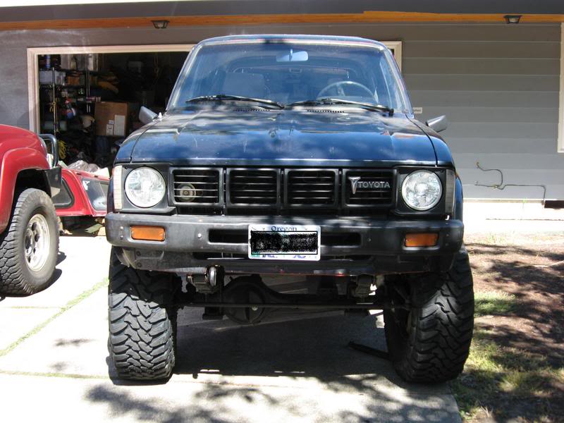

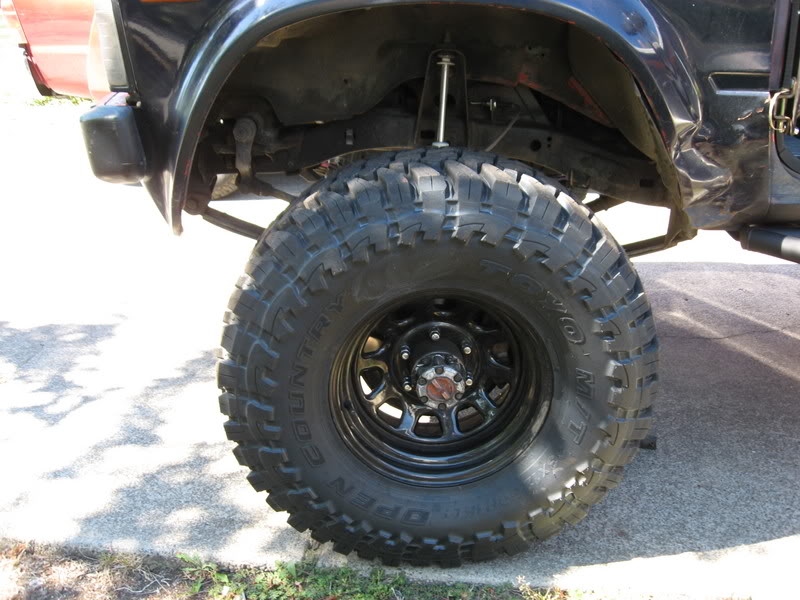

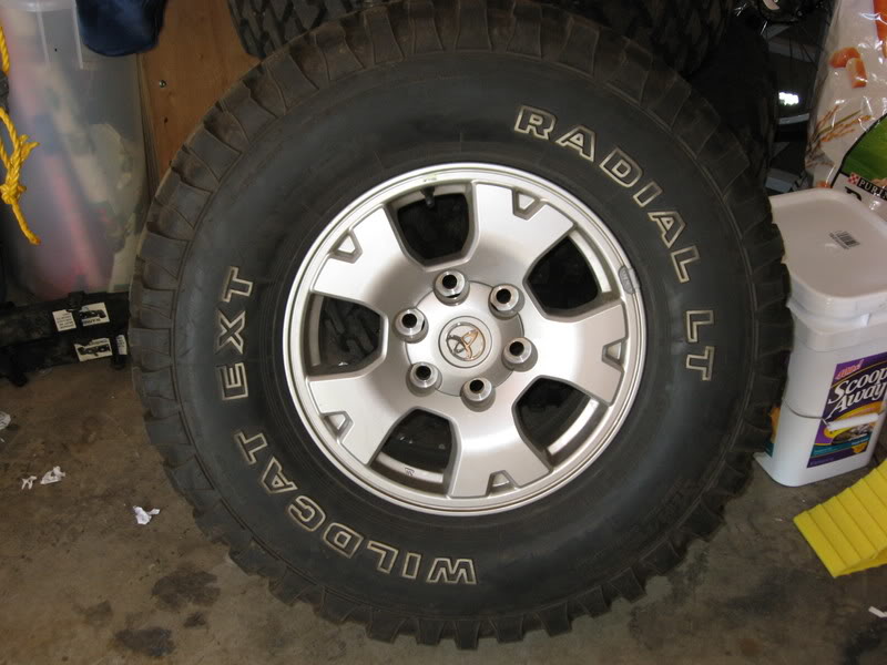

new shoes mounted...
So I have been looking for a used set of tires since I first bought the truck. I have looked at several sets that did not turn out to be in the kind of shape that the seller said they were, numerous different reason for not buying them..
I tried out a buddy's set of 35's over the weekend since that is what I really wanted and just ran them on the rear...I expected some difference because of gearing etc but it seemed like I was going to lose 5th gear and did not really want to re-gear for awhile, though I will be pulling the rear third member at some point to install a locker...
With the current 33" BFG AT's (2 of which were getting cracked with age) the truck had no problems using 5th at highway speeds (65MPH) and is able to pull hill really well IMO.
I wanted to get a set of the Wildcat's from Les Schwab but they have since been discontinued. I have run a couple of sets on other trucks and I have a set of 285's that were studded that I run on my '05. I even contemplated pulling the stud's and getting a set of 16" rims for the 81 but thought against it.
A 45 minute wait at the local Les Schwab resulted in a set of 33" Toyo Open Country MT's, they were a little bit more that I wanted to spend but have a great reputation. If you live in the PNW you know Schwab's has got great service and stand behind what they sell....
Even with the tube doors on I can hear myself think, they don't hum much at all...
