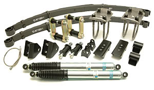

with that I was able to place an order with Brian (waskillywabbit) at WabFab for a 5" rear lift kit:
and a flat pitman arm to help correct a snafu with the angle of my IFS steering box
first time doing most of this so bound to make a few mistakes:
With the rear suspension kit going on it looks like a good time to throw the dual cases in and make a trip to the driveshaft shop for some lengthening up front and shortening the rear
Slowly this thing is coming together but I doubt it will ever be done...

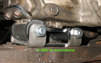

I was digging around in my crap I need to get on the truck and found that the extra transfer case mount I had is shot, the one on my truck is kind of had it two so I went ahead and placed on order for 2 of these from 4xinnovations:
significantly cheaper than what I could find elsewhere and they seem to be made very well. The design allows for easy installation etc.
Hope to get this over to my friend's shop and get the suspension finished soon

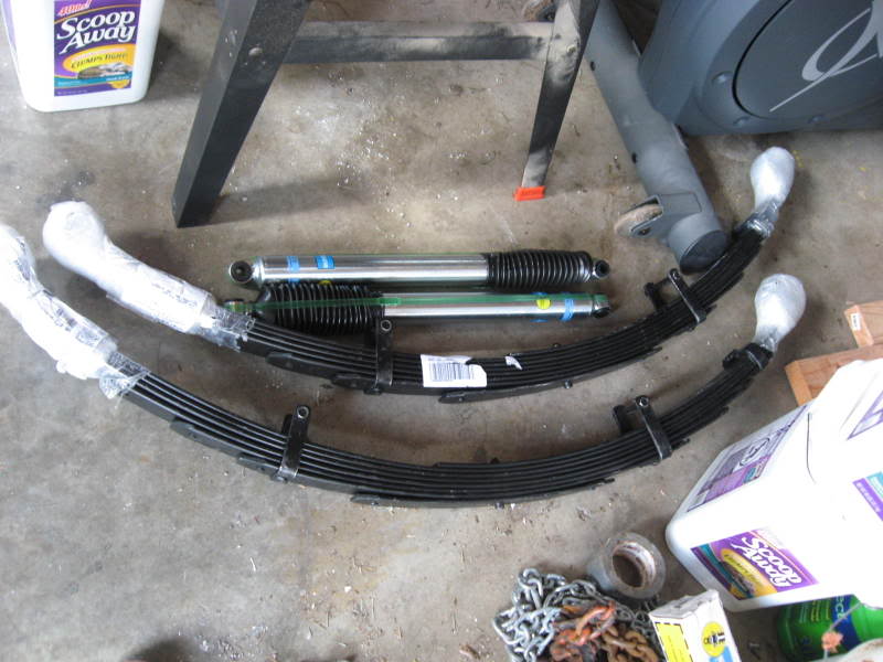

Rear Springs
8 leafs instead of 4, I think that they will flex a bit better than the blocks in there right now

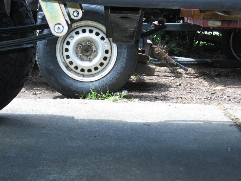

So looking under the truck to see if I might run into any other surpises when I go to do the rear end kit, I remembered the old bumper mounts that will need to be cut off.
The Trail Gear kit requires that the rear shackle mount needs to be moved back 3" so the stock bracket is a goner. With that the frame back there is just 'C' channel, not boxed so I am thinking that a 0.25"x3"x3" crossmember back there is necessary to strengthen the frame...
any thoughts or recommendations?
The stock front spring perch is also going to be a victim soon. a new mount will go 6" C to C of the front mount..crappy picture but you can kind of tell that my slider mount is just about dead center of where I need to mount the front spring perch.
The kit came with these mounts which I like (already have them) plus with their desigh it is easy to get the mount on straight:
An Option to keep from having to redo the slider mounting bracket would be to find a set of brackets like this:
they would just mount to the bottom of the frame.....

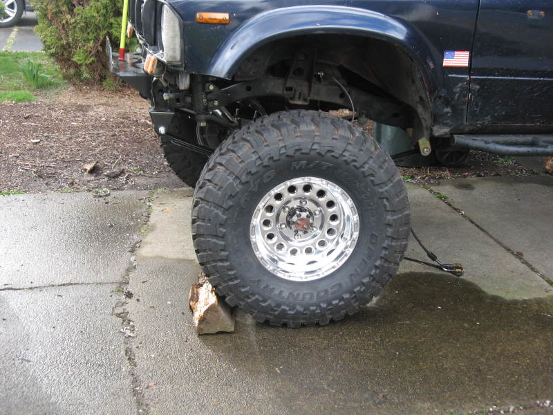

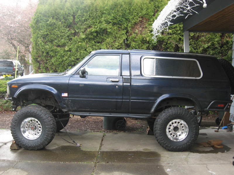

Also something happened to my wheels and tires?!?!
ok, got an ok deal on some unnecessary bling for the trekker

got that unnecessary bling mounted on the truck...

Originally Posted by waskillywabbit
My eyes!
Kind of thought that I might catch a little for the new wheels
Originally Posted by 4banginRunner
no! lol where'd the black wheels go?
They are sitting in the garage. Thought I would keep them around for maybe some RockStomper DIY beadlocks and 36's or 37's down the road

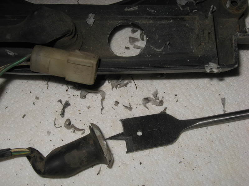

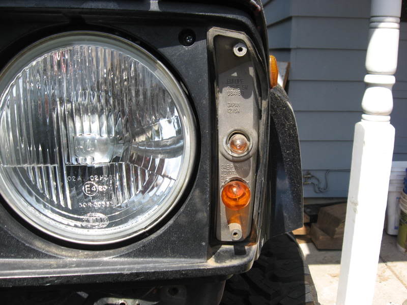

Got the idea for this one from another forum:
Put the turn signal in with the parking light.
1) Remove the turnsignal and Headlight Bezel
2) cut out the turnsignal bulb socket, I used a 1" butterfly bit to drill just under the parking light (drill slowly-this plastic is old and brittle)
3) I ground down the sides to allow to fit in the edges of the bezel and left a lip to allow the plasti weld to bond to (clean all the old dirt and junk out) my lenses were due for a cleaning anyway
4) apply liberal amounts of plasti weld or epoxy:
5) installed just replace the parking light lense:
cheap easy and it actually allows the signal to be seen from the side...

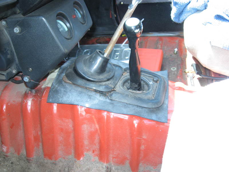

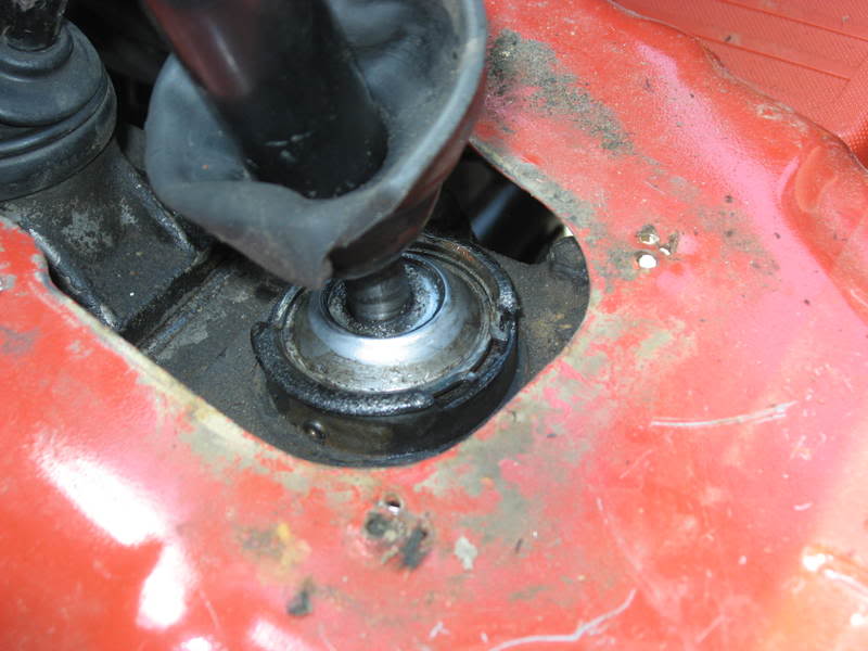

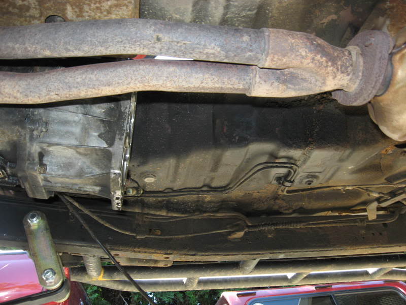

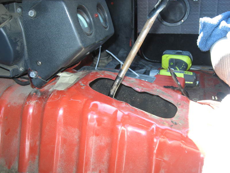

Finally got to spend some time doing something worthwhile on the truck. Father's Day working on the truck and having my teenage daughter help me wrench on it, doesn't get better than that.
Goal was to prep the truck for getting the dual cases in:
first step was to go from this:
to this:
Make sure you use good pliers, that snap ring can fly
With my kid getting wrenches for me only took a half an hour or so to have this pile:
Now it is No wheel drive:

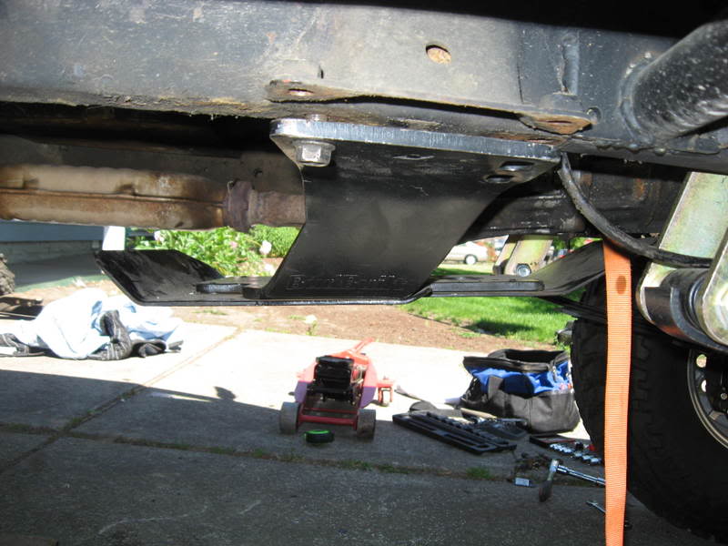

The transmission is held up with a couple of ratchet straps...just have to push the junk around for now.

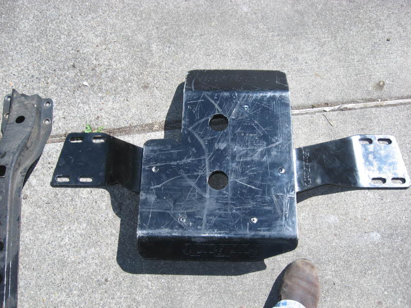

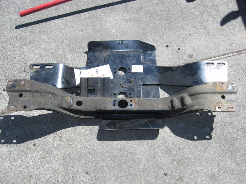

I had bought this Budbuilt skid plate off ebay last year dirt cheap ($31 plus shipping and the only bidder) and thought I got the killer deal, it was listed as "BudBuilt Dual Transfercase mount/crossmember 79-83 Toyota Truck:
With stock transfercase mount I had about 19.5" of clearance:
19.5 inches to the ground with stock skidplate
Thought I would do a test fit to see how much ground clearance I was going to gain:
I would have gained 2" of clearance if the FRigging thing would have been wide enough
budbuilt skidplate: the stock crossmember:
Front inside holes: 31" Ctr to ctr 34.5" Ctr to ctr
Front outside holes: 36" Ctr to ctr 39" Ctr to ctr
Rear inside holes: 33" ctr to ctr 37" ctr to ctr
rear outside holes 38" ctr to ctr 42" ctr to ctr
Anybody got a clue as to what this thing is suppsed to fit? Maybe a samurai
Not out a ton of money obviously was hoping to save a few bucks on this part of the build. Now out a delay of getting the cases put in and having to talk my wife into some cash to order a crossmember from someone....
hopefully tomorrow I can at least get this pile of parts:
To look something like this:
Might even be able to go wheeling sometime this summer...

So I just got an email reply from Bud at Budbuilt:
The skidplate I got is for an 84-94, the passenger side mount is inside the frame Thanks to the ebay seller for listing it wrong...oh well. He said he would give a good deal on just the crossmember. I can use the skidplate...
Hat's off to Bud for the quick reply....
