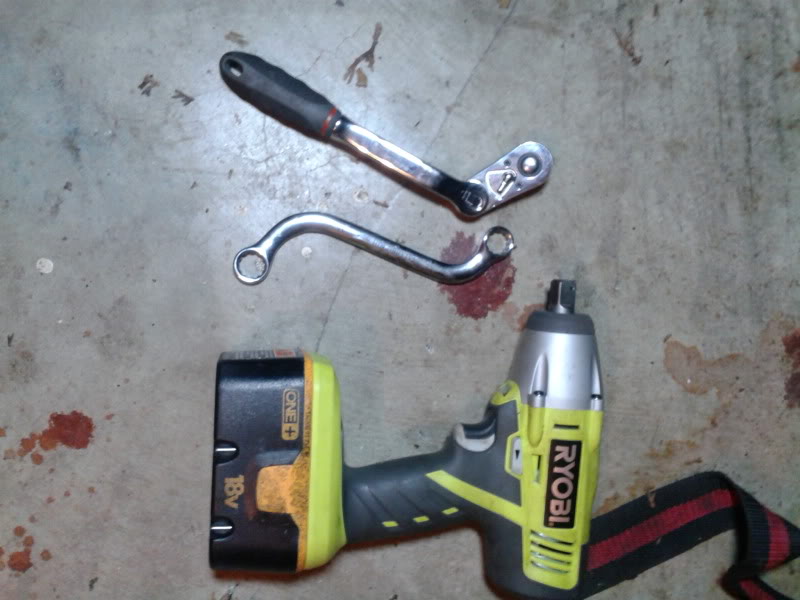

My new favorite tools for getting into tight spaces..the offset wrenches kick butt

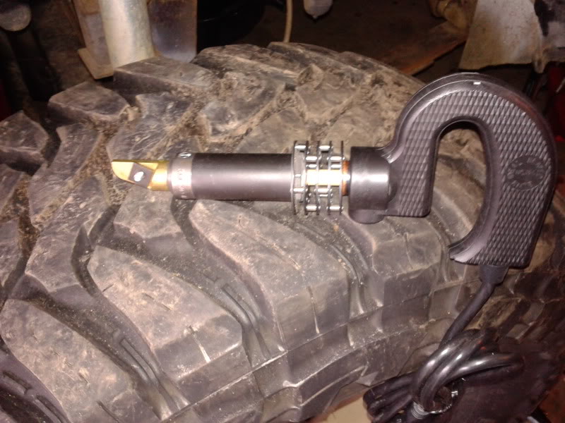

Hopefully this thingy will help my POS tires be more efficient in the snow

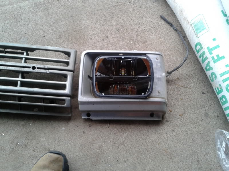

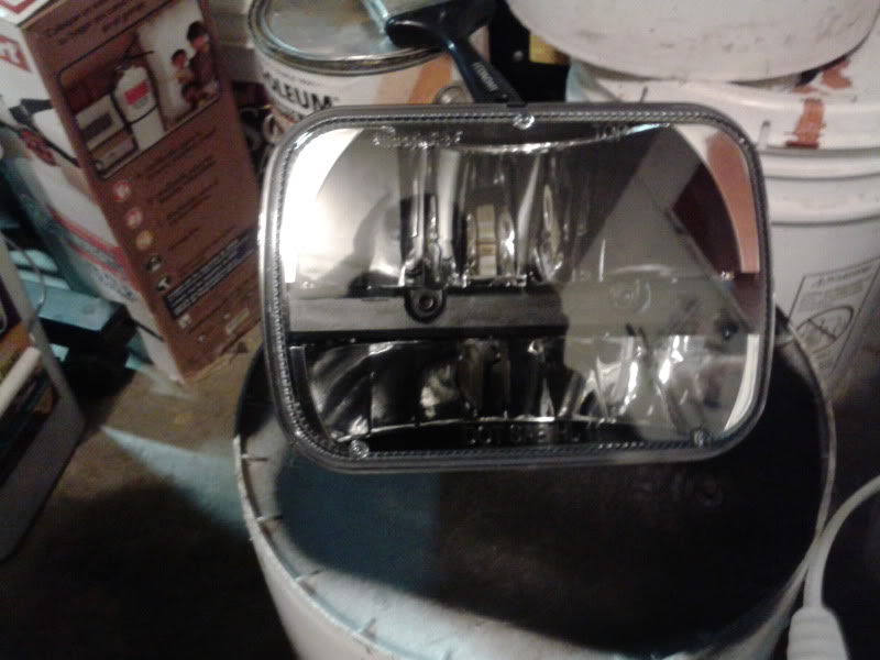

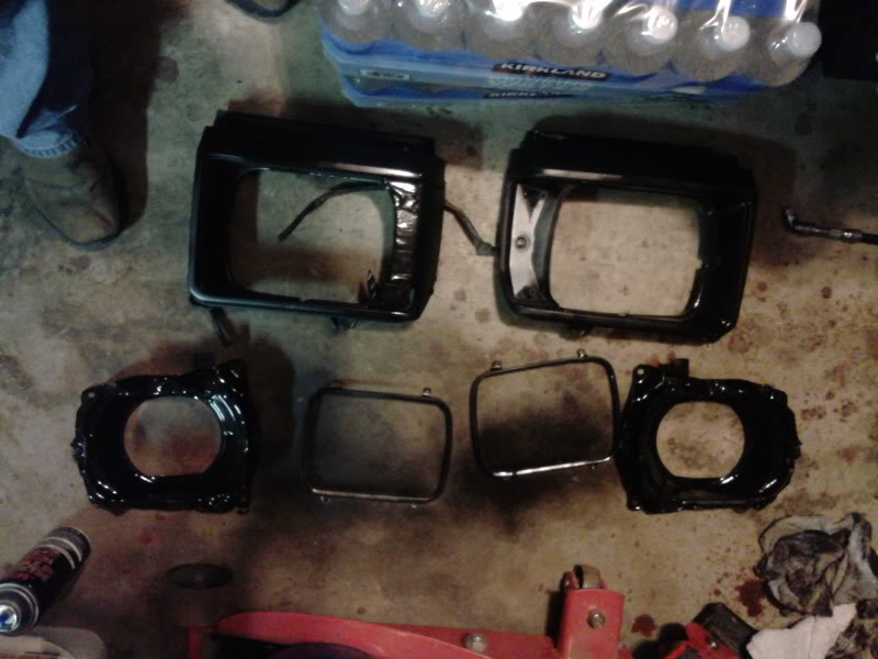

Ran into a snag I should have known about, 82-83 head light buckets don't line up on 79-81 so had to head to hardware store for nuts and bolts..
Took the time to clean and paint the buckets
Close up of the light
Lights aren't mounted but want to see what it might look like,
Low beam

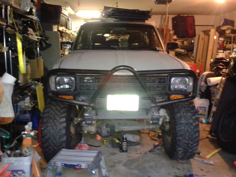

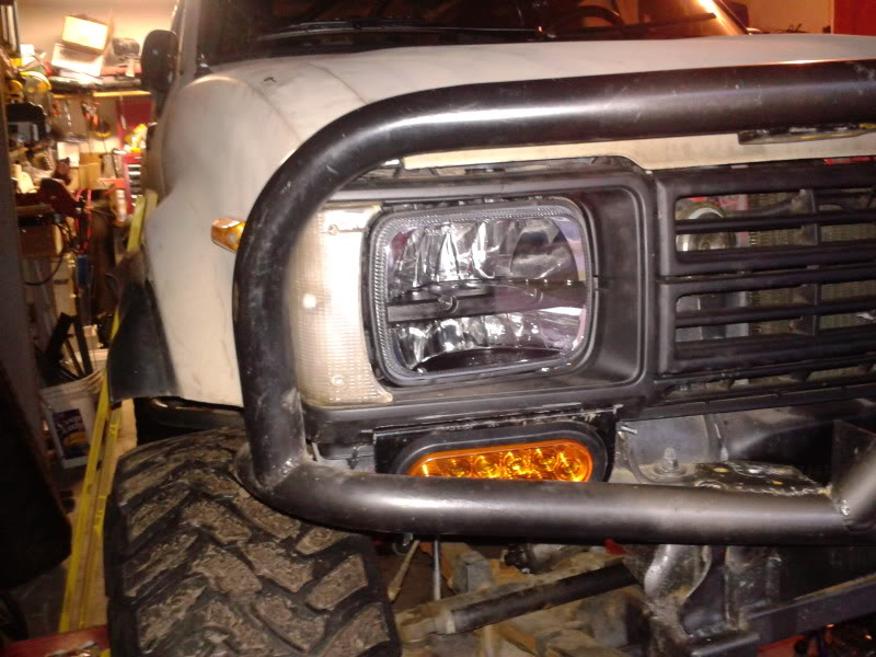

Haven't had a lot of time to do much but had a couple of hours today to finish converting my headlights to LED`s. It would have been a 30 minute job if I had stuck with round headlights but oh well.
I went ahead and moved my turn signals down below the head lights, a little obscured but they are plenty bright.
I will try to get some night shots later on.
Should have time tomorrow before I have to head to the fire station for an afternoon class to finish the clutch.
Life just hasn't been cooperating lately..

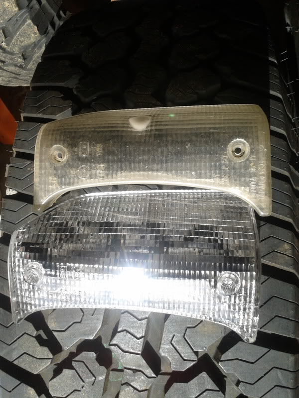

Gotta love a local dealer that can get some parts for old trucks..new lens are great

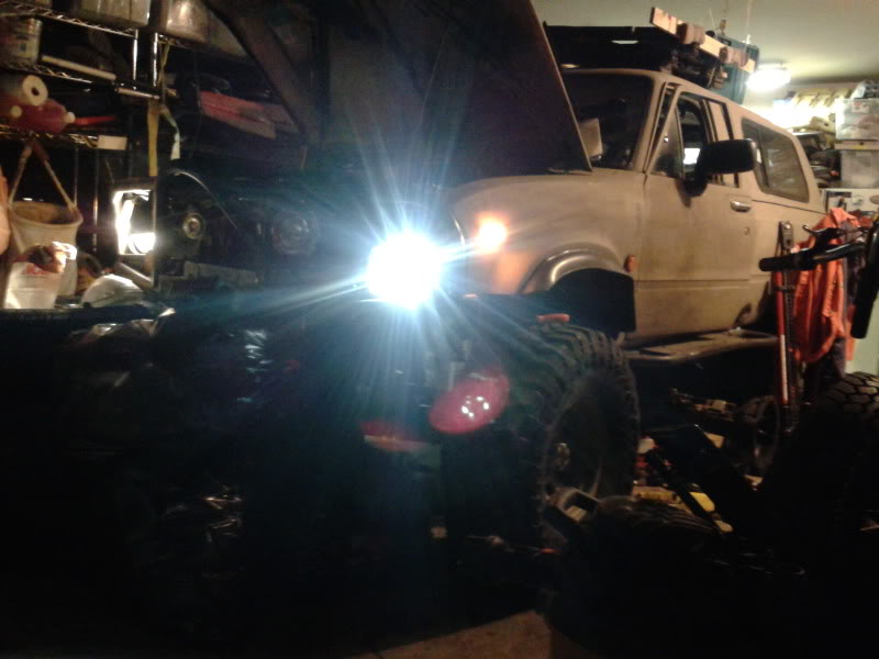

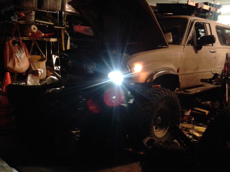

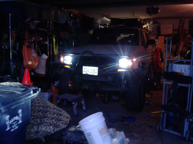

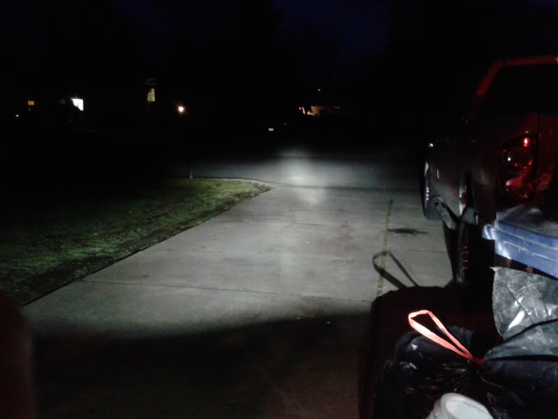

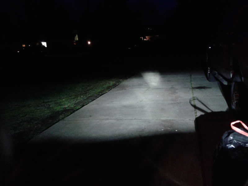

Lame cell phone night shots..the pics don't do the output justice.
Low beams
High beams
Old Feb 12, 2013 | 06:01 PM

Got a part number for those new side lens covers?
Old Feb 20, 2013 | 05:17 PM
  #1116
dropzone's Avatar
Fossilized
iTrader: (6)
Joined: Oct 2005
Posts: 19,771
Likes: 456
From: PNW
from my misc bs FAQ thread:
Originally Posted by ocdropzone
there was some discussion awhile ago in a restoration thread about 1st Gen truck parking light lenses.
Last time I called the dealer I struck out but earlier this week I got lucky and got a guy willing to dig into the computer a little ways and ended up with l/r 79-81 and l/r 82-83.
79-81 passenger side 81611-89101 $9.28
79-81 driver side 81621-89101 $9.28
82-83 passenger side 81611-89121 $8.22
82-83 driver side 81621-89121 $8.22
they also still had the lense gaskets in stock, but not the headlight bezels.
I think the price was good, did not expect to find these things new. if you find them in the boneyard they are usually extremely white and cracked like hell.
Im sorry, what is this?
Old Feb 27, 2013 | 10:08 PM
  #1119
dropzone's Avatar
Fossilized
iTrader: (6)
Joined: Oct 2005
Posts: 19,771
Likes: 456
From: PNW
Originally Posted by toyota4x4907
I love this truck!
thanks, it is a tire groover
Old Feb 27, 2013 | 10:16 PM
  #1120
toyota4x4907's Avatar
Joined: Sep 2008
Posts: 4,355
For like sipes?
All times are GMT -8. The time now is 09:52 PM.
