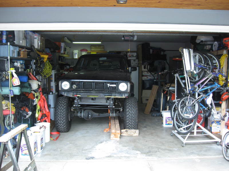

I had an hour to kill today before heading out to the Church's fireworks stand for my evening shift so I thought that I would bust out the 10mm,12mm, 14mm wrenches, the 24MM socket and a screwdriver.
Pushed the '81 back in the garage:

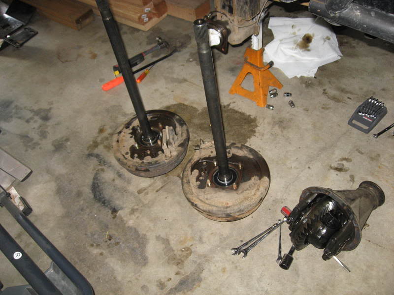

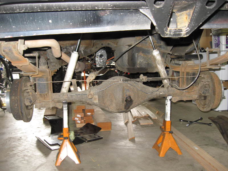

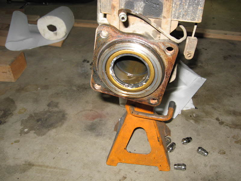

pulled these things out:

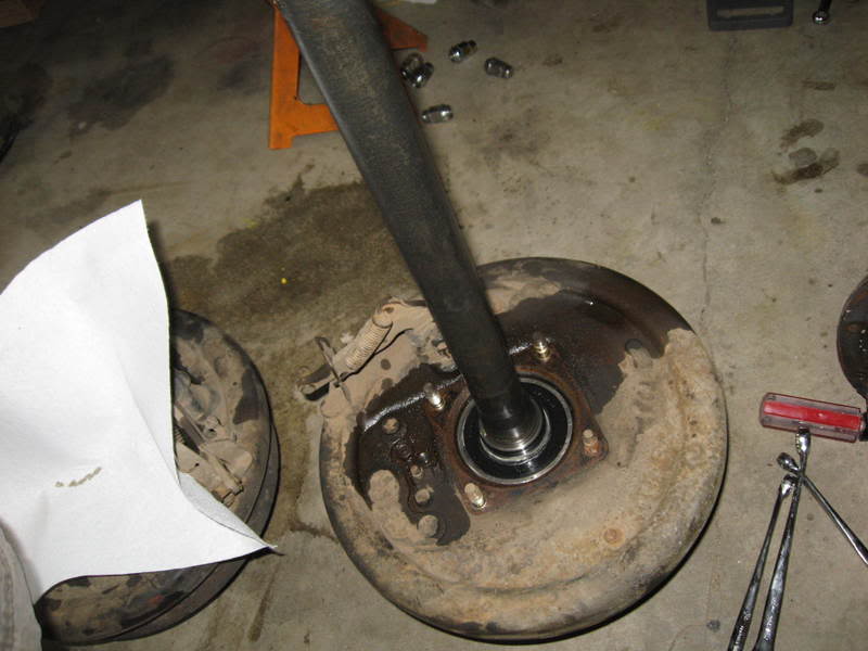

Some people thing they save sometime by letting the axles rest on these but from past experience I know that I end up doing a seal a few months later so so forget that. I will deal with having to bleed the brakes :
axles shafts and differential all seem to be in great shape:

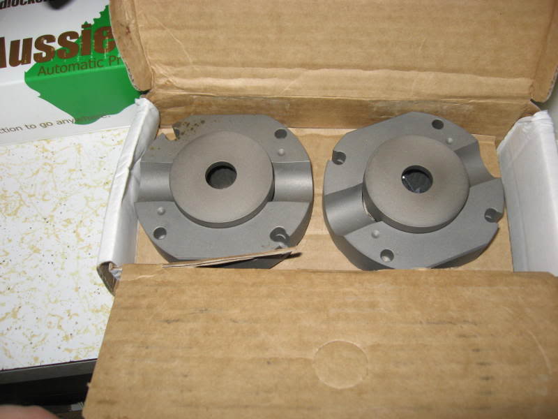

It sucks, I counted the teeth on the ring gear. My thirds are the stock 3.90's that came with the '81. No money for 5.29's at this time, hopefully next spring...
but this should be in tomorrow:

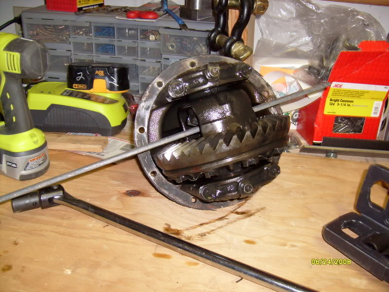

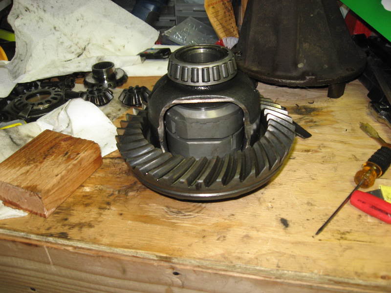

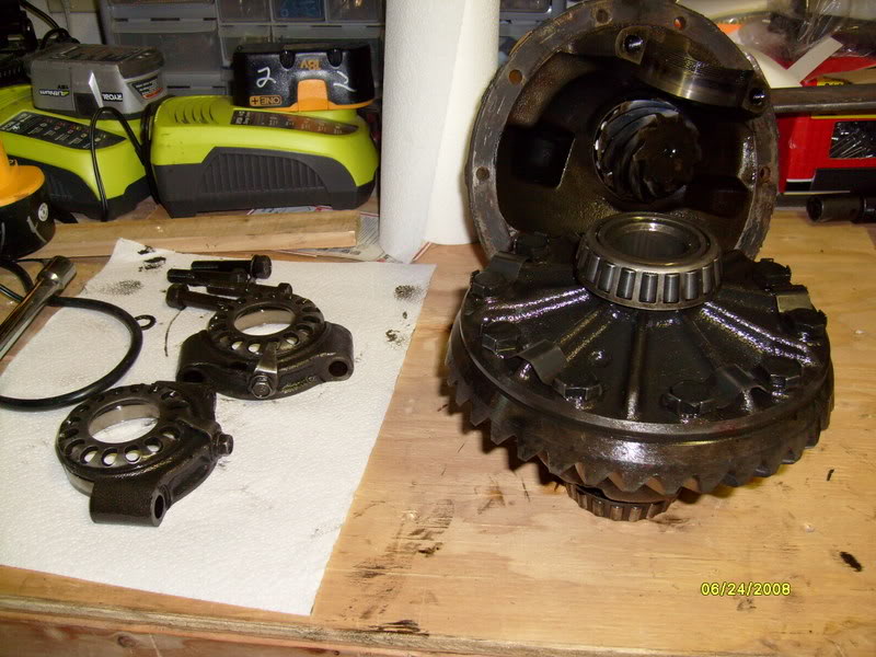

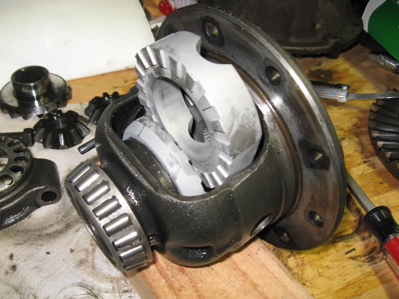

This is as far as I got on the differential:
Used a piece of 1/4" strap as a cheater bar.
For an almost 28 year old third it all appears to be in good shape:

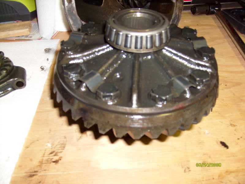

Even has what I believe to be the stock toyota Ring gear retaining clips still install, they appear not to be been touched:

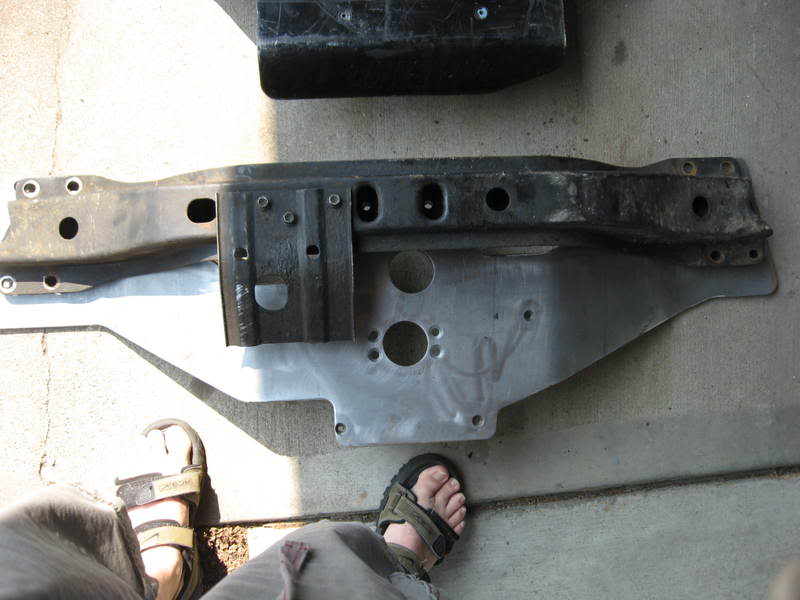

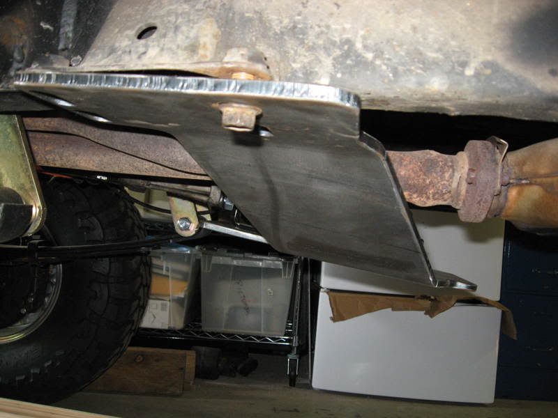

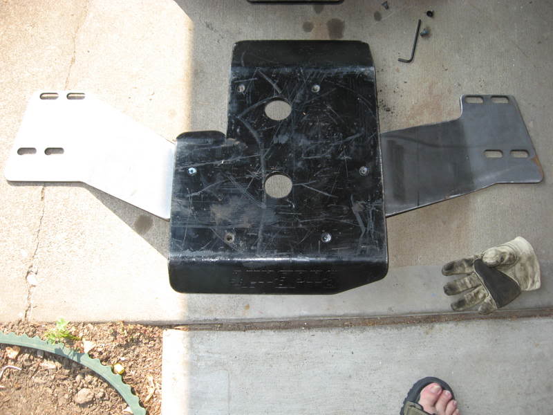

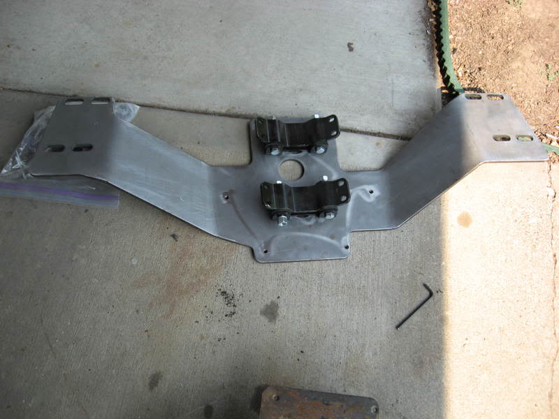

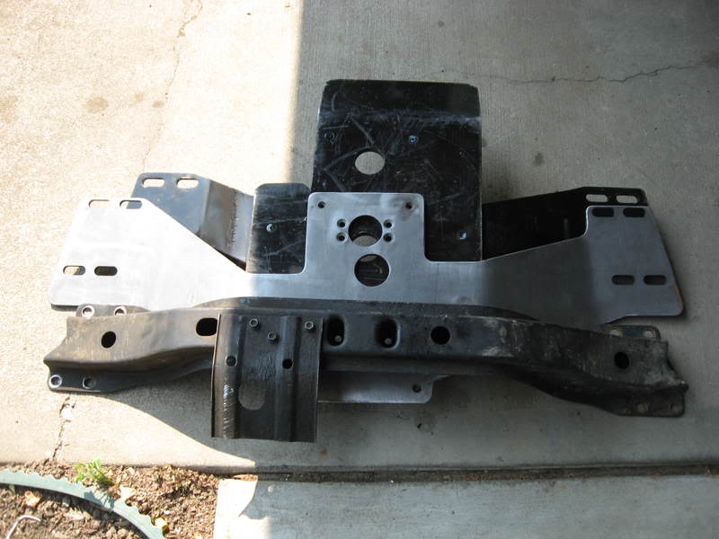

sucked it up and ordered the correct crossmember from BudBuilt.com. Got to hand it to Bud and his Crew. Had the thing with in 5 days. I think that is great service on something that weighs over 40 lbs. I have a guy that will buy the other crossmember so that will help me recoup quite a bit of my cost.
Comparison of my original/first incorrect budbuilt/ new one:
Stock Crossmember VS. BudBuilt...nice when all the holes match up..imagine that:
i was able to save a bit of money by using the existing skid plate with the new crossmember:

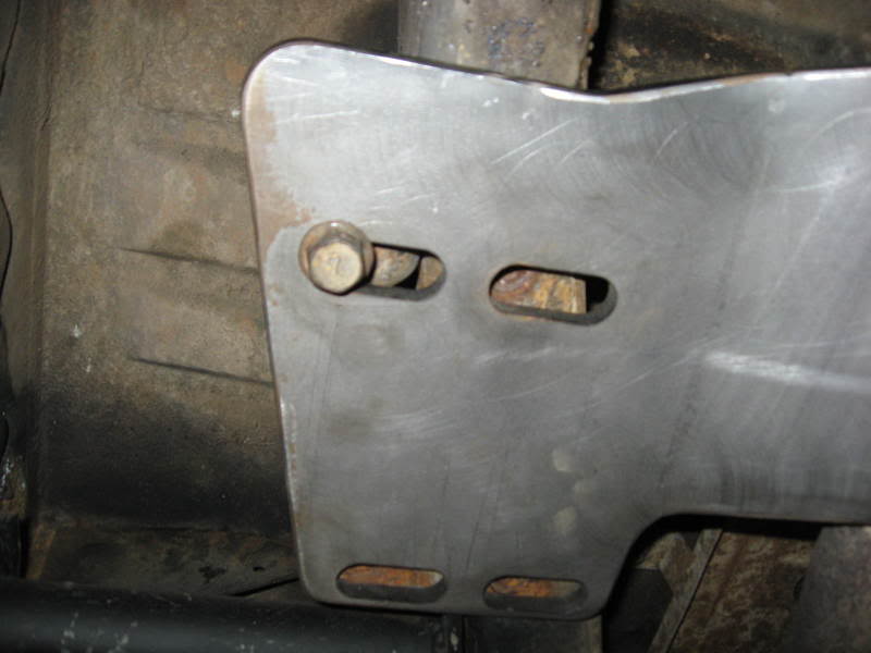

Test Fit of the 4Xinnovations transfercase mounts...everything lines up great. I like it when that happens:
And the fit test. both sides line up with the factory crossmember bolt holes...

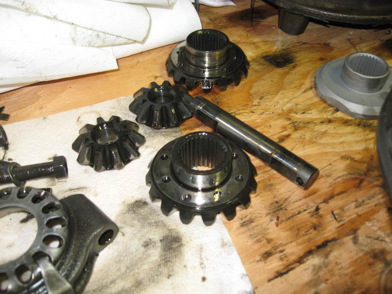

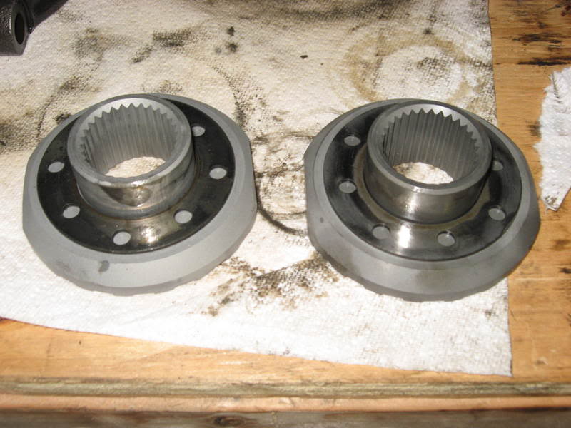

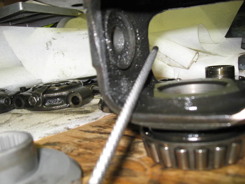

Talking Aussie locker install:
My locker install has not exactly been going as fast as I was hoping. Something about finishing other projects first
Anyway had some time today so got back to work on it, I was following Zuk's write up at gearinstalls.com it is so much better than the install instructions from aussie locker.

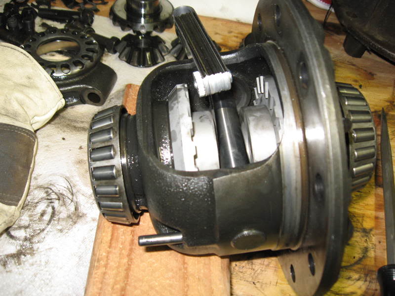

Finally got a 3/16" punch so I could drop the diff shaft and get out the spider gears:

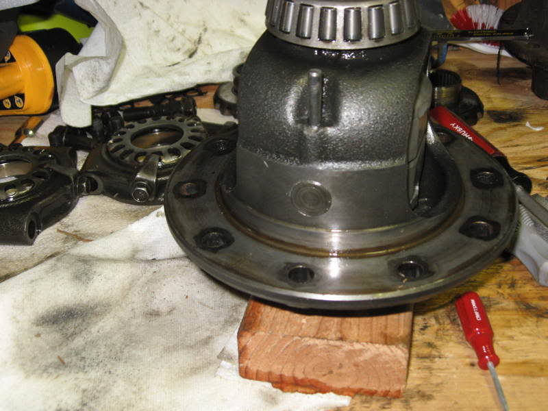

Rear install the thrust washers, evidently some people forget them and the locker won't work right:

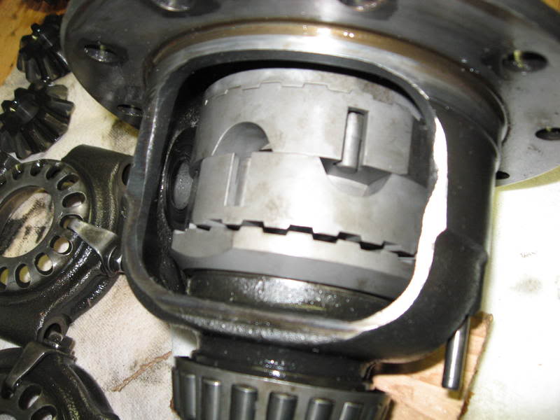

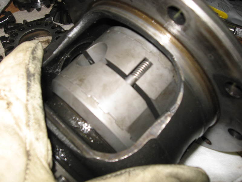

Just like Zuk has found on his aussie installs I had to take some material off the housing to get the parts to drop in:
Checked the clearance between the shaft, I got 0.007", spec says 0.006-.016:
Got all the couplers in after doing the little clearance job mentioned about, a few minutes with a file was all it took:
Next step was to line up the couplers and insert the 4 pins, make sure to install the spring nipple up, it helps to retain the spring:

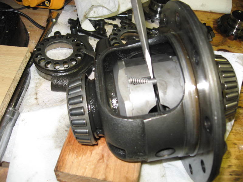

Springs installed, take your time with this, those little buggers can fly, using a couple of small screwdrivers did the trick:
all 4 springs installed:

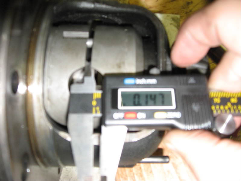

Need to check the gap between the couplers after it is all together, I had 0.147", for the aussie warranty you need 0.145"-0.178" on the center gap:
Main shaft and retaining pin back in:
aussie locker in the carrier:

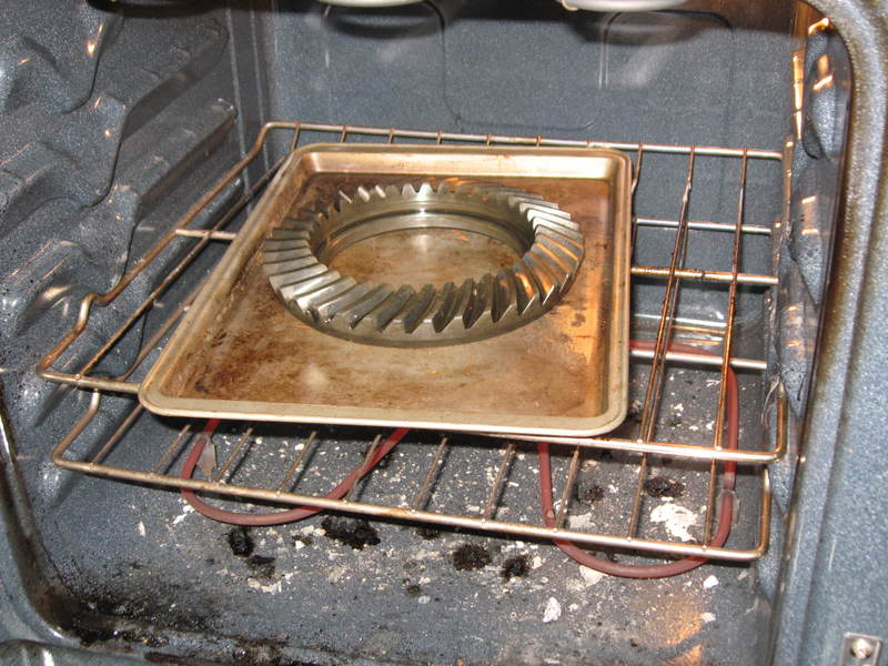

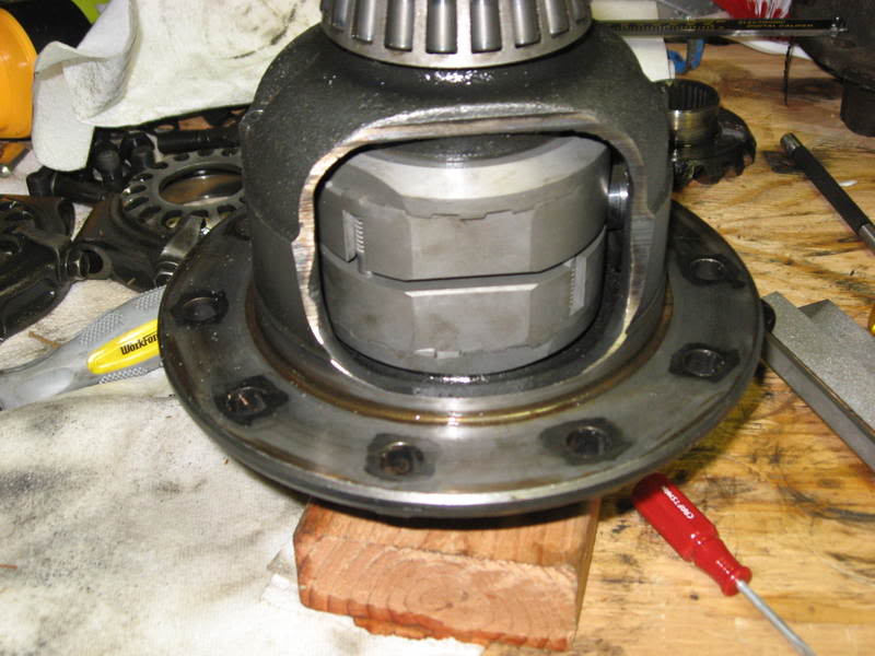

I went to put the ring gear back on and it did not want to drop down all the way so I did something my wife will hate me for:
After 15-20 minutes at 225* the ring gear dropped right down

Originally Posted by fillsrunner4
Looks delicious
Lookin good
thanks! Ring gear pie...hmmmm goood.

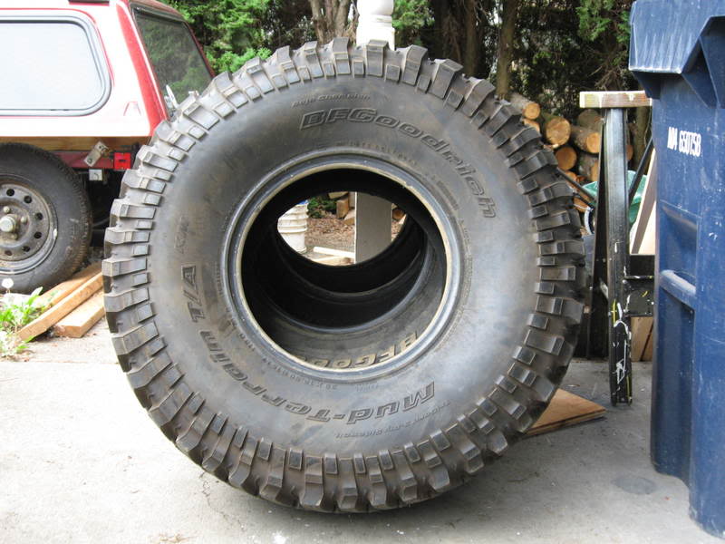

Picked up a set of 35's, the size I should have bought the first time around...now need to sell the 33's...

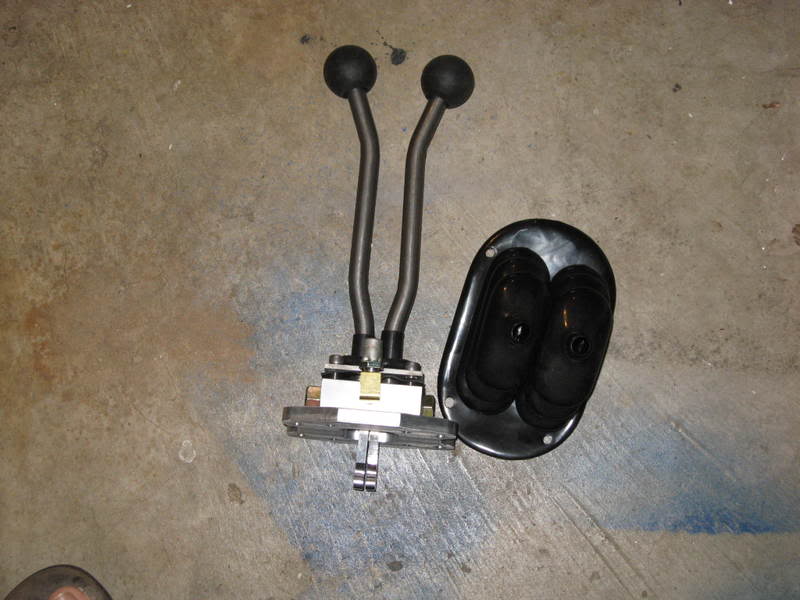

Talking Now I will be up to 4 sticks soon
UPS just dropped this off, Front Range Off Road Twin stick, should make turning a little easier with the front locker. I like their design and workmanship better than some of the others on the market, plus the shift boot comes with the kit, not an add on like some on the market...
Now I just need time to get all the pieces that have been collecting dust for months back together..
