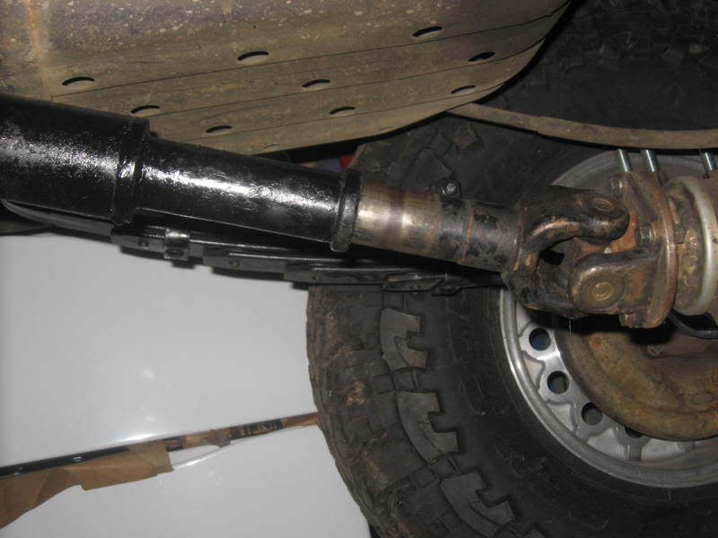

but there might be a few issues keeping my going, big one is I am not sure if my rear driveshaft is too short, take a look at the pic and let me know what you think (it is a stock rear shaft shortened) I am thinking it might be a couple of inches too short and not have enough spline contact...
the guy that did it said he could shorten another shaft for me but not sure if I could get down there in time to have it done..

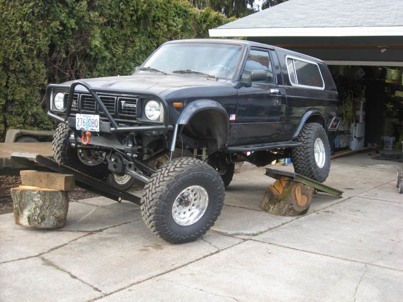

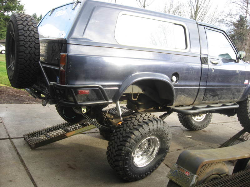

Finally had some time and got the front seats installed in the truck. Got a set of matching F/R Mitsubishi Montero seats at a 50% off sale at the U Pull It ...
I am getting old and for some stupid reason thought having an arm rest instead of hitting my ammo can center console would be a good idea.
What a PITA to install (universal seat sliders, 1.5" sq tubing and 1" sq tube) -would i do it again...no way, should have stuck with my Integra seats..Oh well, they are in and are pretty dang comfortable.
I was gonna get some firewood so I had taken the ramps off the trailer, saw them sitting there so thought what the heck, will try some driveway ramp shots:

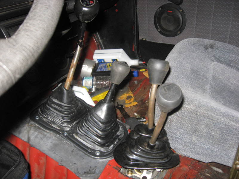

actually there are 4 shift levers: 1 for the 5 speed, 1 for the front 2.28 transfer case, 1 for the 4.7 low range TC and one to select 2WD/4WD. I went with twin sticks in the rear case incase I bind up the front axle (locker)
