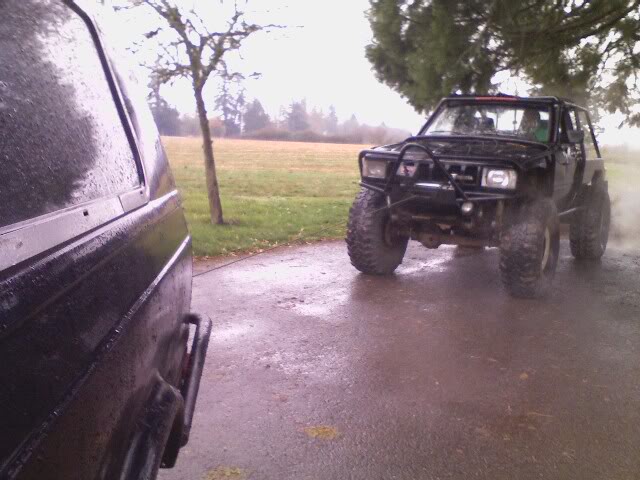

Trekker Needed a little help
Trekker got dropped off, but I was pretty dead from pushing the thing around so another trail rig helped getting the Trekker around:
This simple move makes me want a winch even more

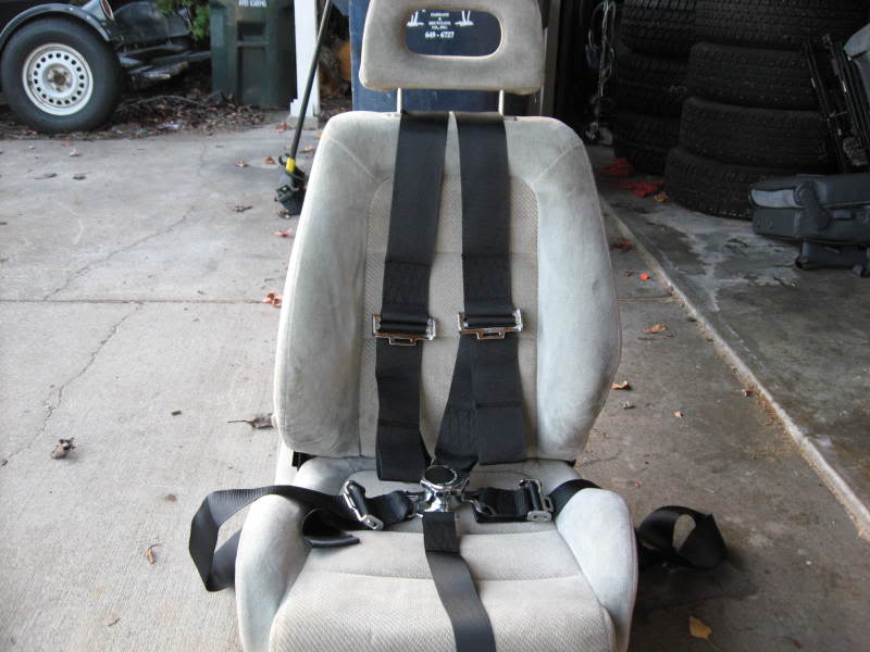

Some Safety stuff arrived....
Since it looks like this thing will actually be getting wheeled soon (that is if I set up my rear diff correct when I did the Aussie install )
Figured that I was gonna need some safety items.
I rolled a bug 3 times and ended once, Flopped my old '84 and both times found that 2" belts just don't cut it.
Decided to go with these with 3" belts with an anti submarine belt (be in a car/truck upside down sometime and you will know why you want one )
For now the shoulder harnesses will be mounted to the floor after going over the head rest. My planned full cage will have a lower bar to mount them to.
These are not SCORE/NASCAR approved or anything like that...I would love to have that kind of rating but these were a decent price (not the 2 for $25 ones off ebay, these were midrange ones off ebay) I used to jump out of planes were a living and inspected the crap out of these things just like I would a jump harness, the stitching etc is very good one them...
A friend of mine is said he could make up a set of mounts (need 10) to the ones in the diagram below:
from what I have read it the proper way to mount them...keeps them out of the crap.and does not add a second wear point on the belt material like a surface mount would.. Will see how these work and than maybe find a set for the kids to use in the back seat...

i've used a 4-point in racing and in wheeling. loved it racing, but hated it when wheeling. i found myself dumping the shoulder belts just so i could navigate the cab well. but safety first if you're going to be running the tough stuff. though i've heard that if you ever need the 5th point, you'll wish it (or your nuts) wasn't there.
for your shoulder belts, i've heard lots of discussion on mounting points. you will want to mount them to a cross bar at shoulder hight, not on the floor. mounting them to the floor can cause spinal compression on impact, and that will screw you up bad!

yeah there are pro's and con's to them. nice thing is that I can detach the antisub belt and shoulder harnesses easy and am maintaining the stock belts too. Plans are for a bar to be attached to the cage for belt mounting.
will see how they go...

Don't Mount the shoulder belts to the floor. Your better off just using the stock belt. But once you get the mid level bar installed, that'll make those belts worth it!
But won't a mid-level, belt bar make it difficult for the kids to get in the back? Being as it is only a 2 door.
Keep up the Great Posts and work! I look forward to seeing your completed build! : ) It looks GREAT So far!!

thanks for the feedback...as far as the mid level bar impeding rear access, looking at making it so it can be mounted in a pocket type fitting and removeable by pulling pins. it is something I had done on one of my old baja bugs, seemed to do the trick and stayed in place when I rolled that thing...gonna be a few months for the cage so I am sure a few ideas will come and a go
