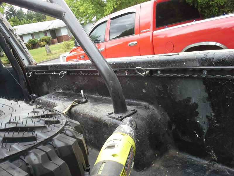

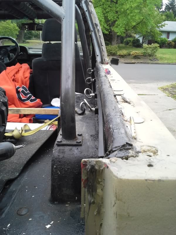

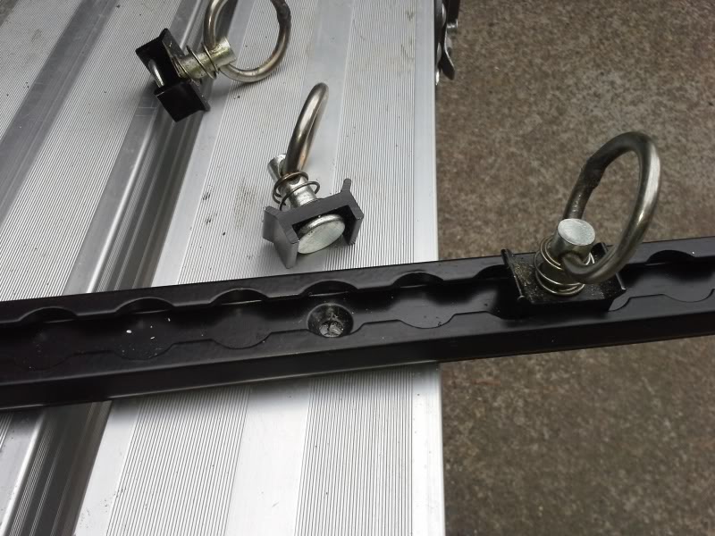

Finally finished putting in my cargo tie down rails. I think I did the first section 2 years ago
I used 1.25" flat stock on the inside of the bed to add some strength. Can't crank too hard on it but it will keep a cargo net and camping gear in place

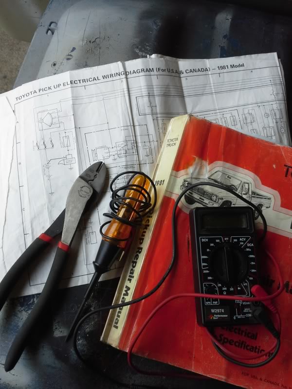

Hopped in the truck sunday night and turned on my headlights. Thought WTH..everything works but the headlights. Fuses good, fusible link good etc. I wish I had taken a pick of the crappy soldering job I found hacked into the headlight circuit but I have headlights thanks to

Old Jul 2, 2013 | 04:41 AM
  #1185
Lons81's Avatar
Joined: Jan 2012
Posts: 711
Likes: 70
From: Stepheville, TX
Having the right tools for the job, sure makes it easier.

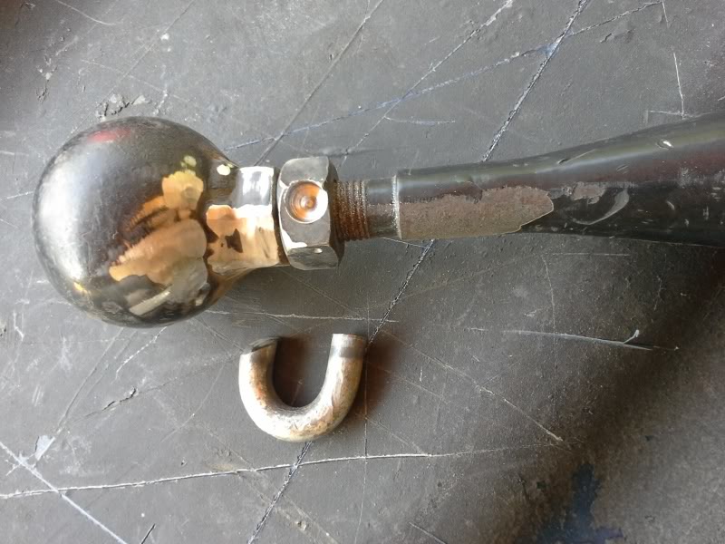

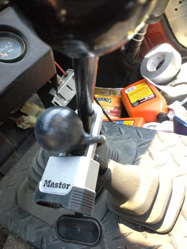

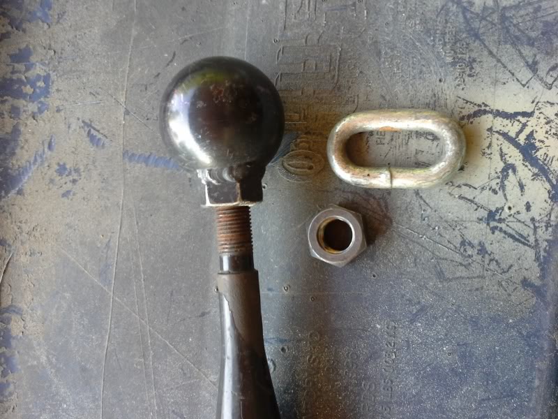

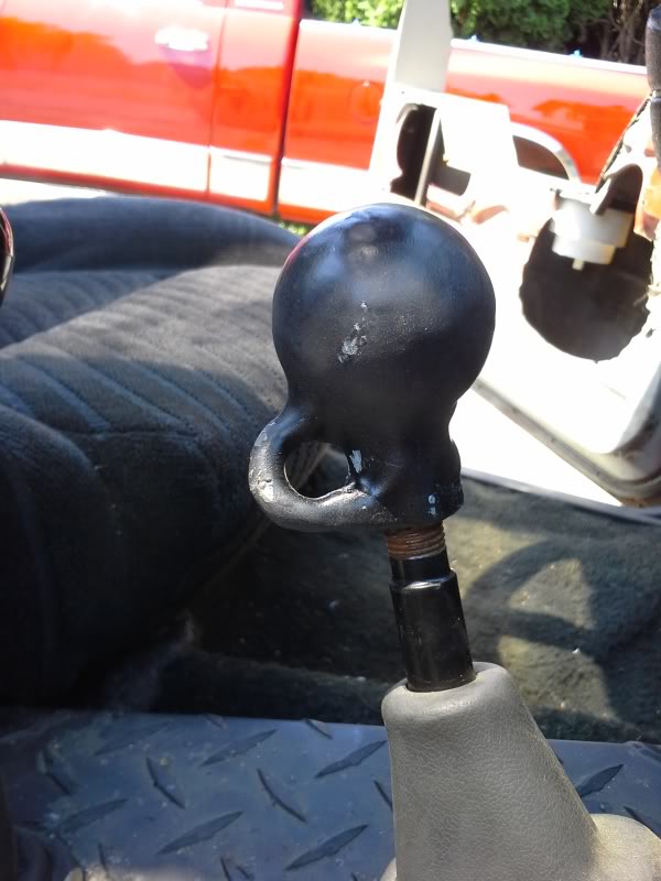

So this is an idea I have had to slow down oxygen thieves for awhile.
Won't stop a determined individual but with a couple of my other anti theft deals it will slow them down..
Hard to drive in 2nd gear low range

that is a sweet anti theft set up. thanks for sharing and alone with other mods, it should keep wondering eyes from trying. should look into a detachable steering wheel too
Old Jul 2, 2013 | 07:12 PM
  #1189
dropzone's Avatar
Fossilized
iTrader: (6)
Joined: Oct 2005
Posts: 19,771
Likes: 456
From: PNW

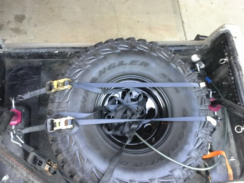

Thanks, appreciate it. I actually have had the Grant removeable steering wheel for a couple of years.
So having a bobbed bed and a 35" spare isn't exactly a winning combination.

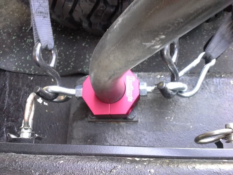

Needed a way to keep the tire more secure so the clamps I found on ebay and used for other mounting projects came tbrough again.

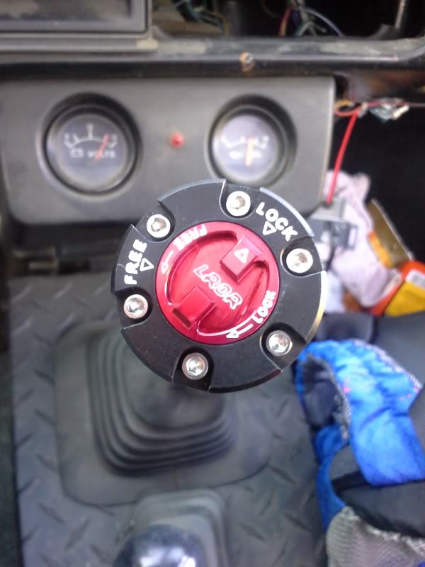

Saw one of these shift knobs that had been donated by Low Range Off Road to raise money for the Rubicon Trail Foundation and thought that is pretty dang cool

Old Jul 5, 2013 | 05:17 PM
  #1191
SCToy's Avatar
Joined: Oct 2009
Posts: 1,560
From: Santa Cruz, CA
Bunch of cool updates. Nice.
Old Jul 5, 2013 | 05:32 PM
  #1192
Ocell's Avatar
Joined: Jul 2012
Posts: 752
From: Austin, TX
Those rollbar clamps look great! I did a search and found your original post with the link.
That's a fun shift knob.

I love LROR! I have ordered a lot of parts from them so far. Their hub lock shifter knob is pretty neat - the dial even turns as it should! Now, I have an idea for you... It would be cool if you could wire the dial in the hub so that when you turned the dial to the "unlocked" position it would disable the ignition. There's your next project!
that would be a good idea, guess I could take the thing apart and see if contacts could be put in there...
