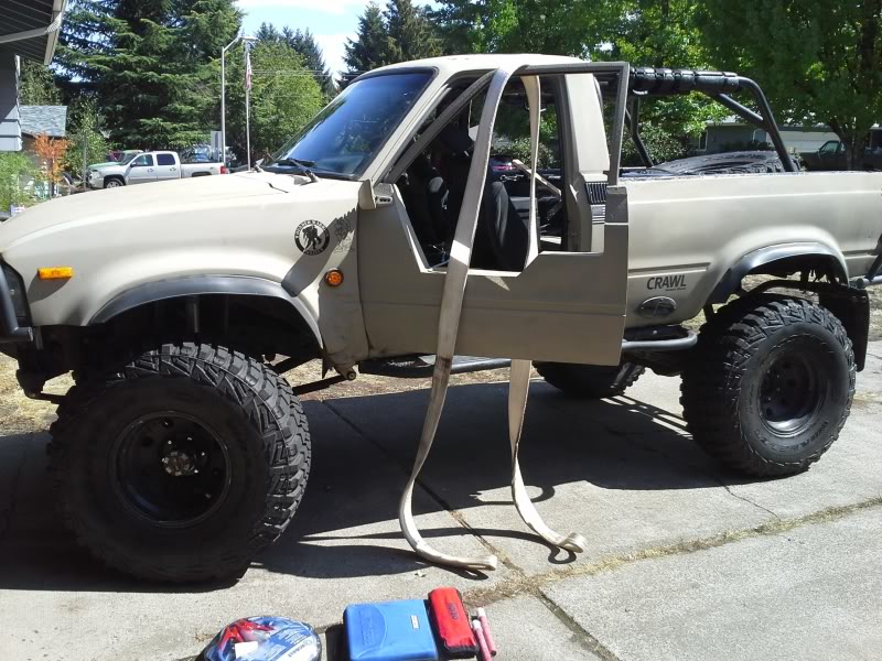

I was out drying the truck this afternoon and a guy stopped by and asked if I would consider selling. I said sure, $5500 and the truck was his. He would only go as high as $4k. So it is still sitting in the driveway. At least it was a cash offer and not some ragged out Cherokee that won't pass emissions.
Need to pay better attention to the forcast, first time this summer i didn't get the tarp on. It dumped last night, looks like more intermittent crap the next few days.
Drying the interior out sucks..
Looks the top goes back on soon.
Not bad though having it off for over 3 months

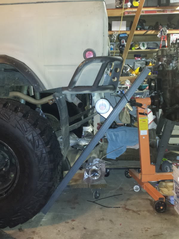

pulled the truck into the garage for some front end work.
Went to go pick up a 30mm socket and saw Magnum drive by
Something about a 308 that I really like
Any way it was time to swap out steering boxes, my old one had a little play and a buddy of mine gave me a box off a 2nd Gen 4Runner he picked up to swap bodies on. Turned out having a section of frame made it easier to pull the steering arm off
Swapped the box and noticed a bleeder screw on it and had an aw ha moment
way easier to bleed air out of the system
I had ordered replacement front spring bushings, UPS said they were out on the truck for delivery so I thought might as well take the old ones out in prep..7:30 pm and it still shows out on the truck. .gee thanks..
After 6 years on the truck the old ones were pretty far gone. I wish Dave's Off Road had their Delrin Frame bushings in stock. $11 each but supposedly they help handling big time.

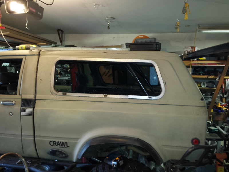

Got side tracked on my frontend work..though LROR finally sent the rest of my order..
my cut down windows have always had a slight leak that I couldn't track down even after attempting to reseal so going back to stock size trekker windows..I should have just reused my original windows. ..would've been the smart move $$wise.
Anyway.
Going from this-

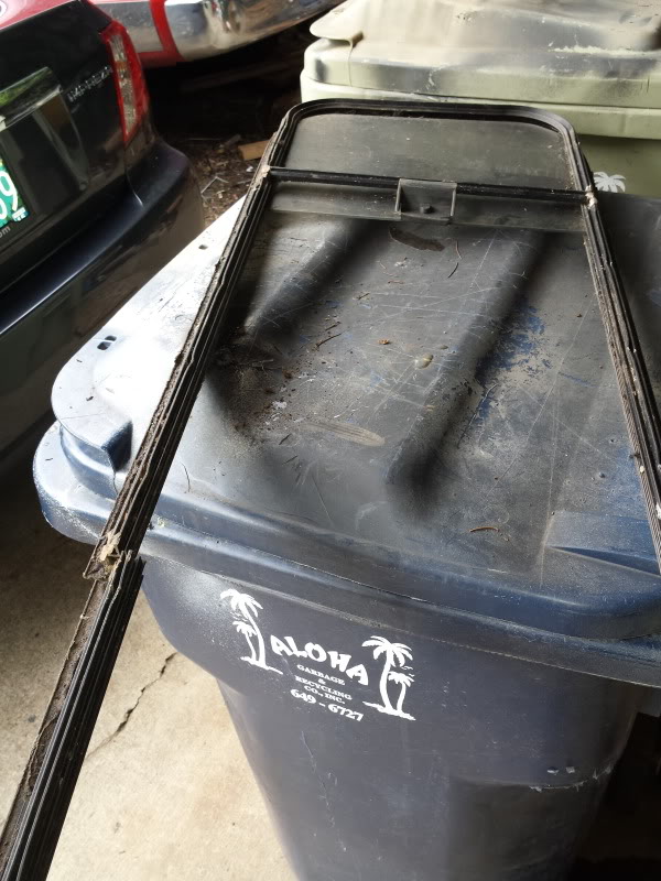

cleaned up the new donor frames out of a rolled trekker
a lot of old sealant and crap came out
enlarged the window opening and test fit the frames
hopefully tomorrow I will have time to make a template and cut the lexan

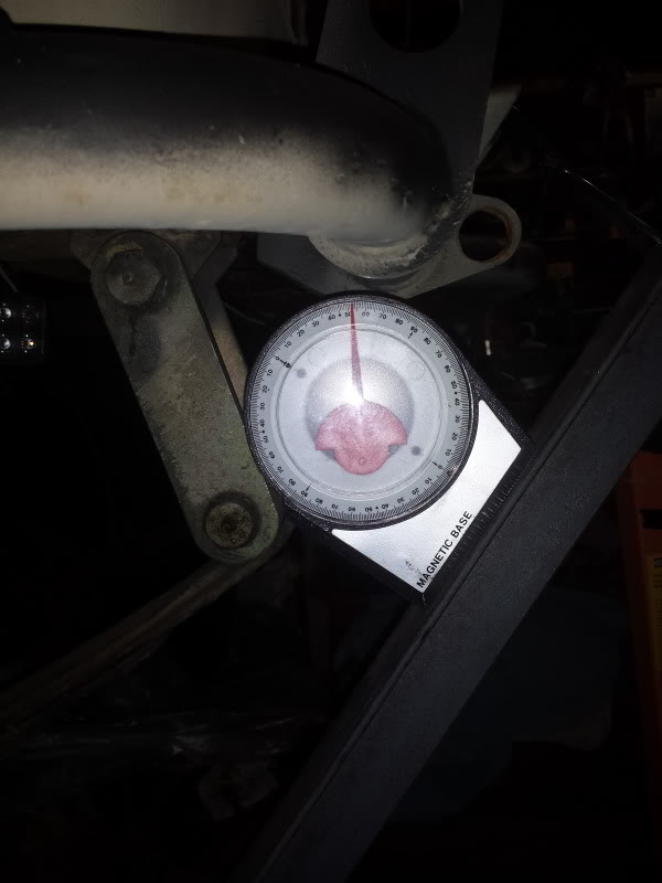

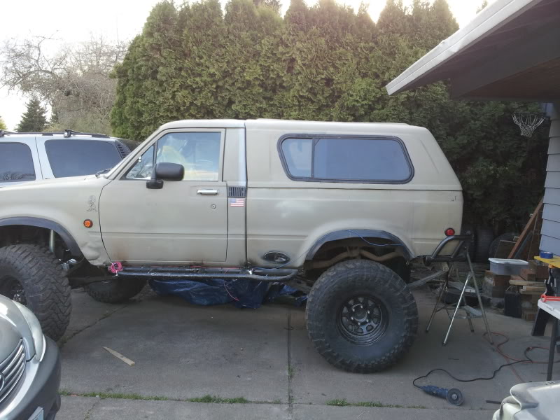

well I bobbed the bed for a couple of reasons
a big one was that someone on another forum told me it would open a huge can of worms working with the fiberglass. .I took that as a challenge..it far from perfect but I am happy for the most part with how it came out. I figure I will flop the truck someday and it will either give me an excuse to put another cab on the frame or use the parts for the 3rd Gen X-cab I want to build some day.
another reason was I kept dragging the bumper on some trails I run so it was a good way to double my departure angle. It is now around 53*. Before it was about 25*
if I redid my bumper I could probably get it past 65* but dragging my butt hasn't been a problem since the bed was bobbed

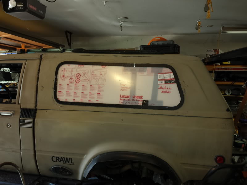

Got a little time to work on the replacement windows.
made a stencil and cut the lexan
epoxied the frame back together
Going to let it sit overnight before installing it.

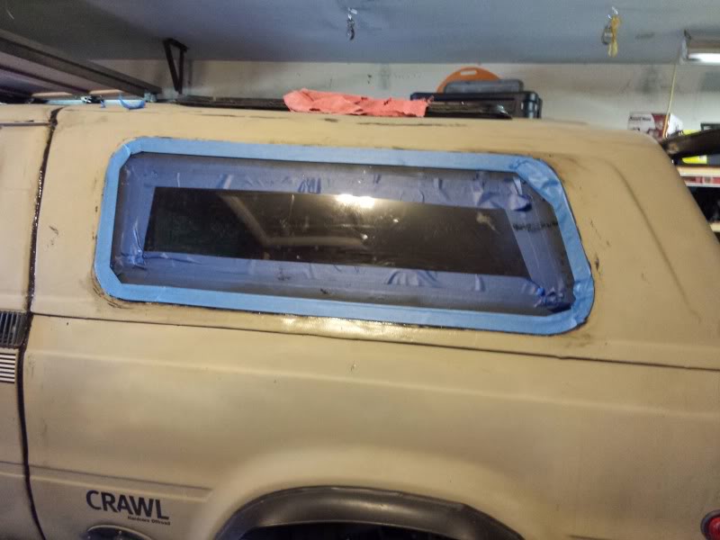

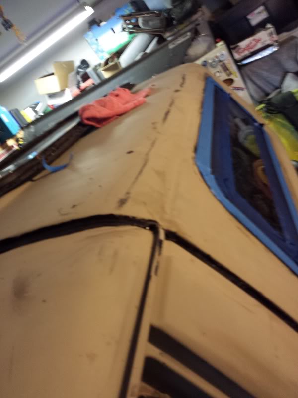

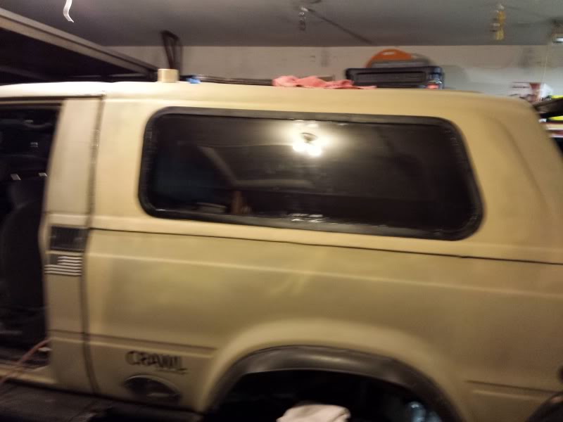

So the window refit project has taken me forever...but today it is finally done. Fingers are crossed my leaks are cured.
I don't know why I didn't noticed this before but evidently I got pretty close to a tree or rock on a recent trip..rain gutter is tweeked and a good stratch down the l/s of the roof.
got lucky I didn't fubar the fiberglass..
Window in and masked for touch up
Cleaned up and installed
I tinted the lexan with some rustoleum tail light tint as an experiment. .. not sure how I like it but stuck with for now...
